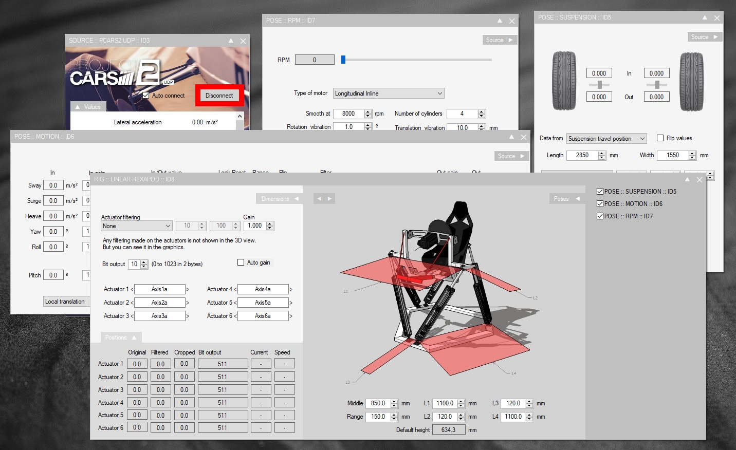

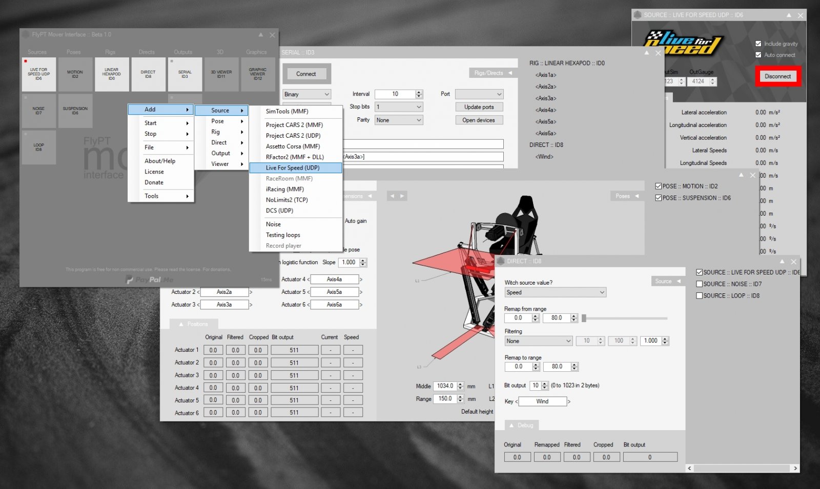

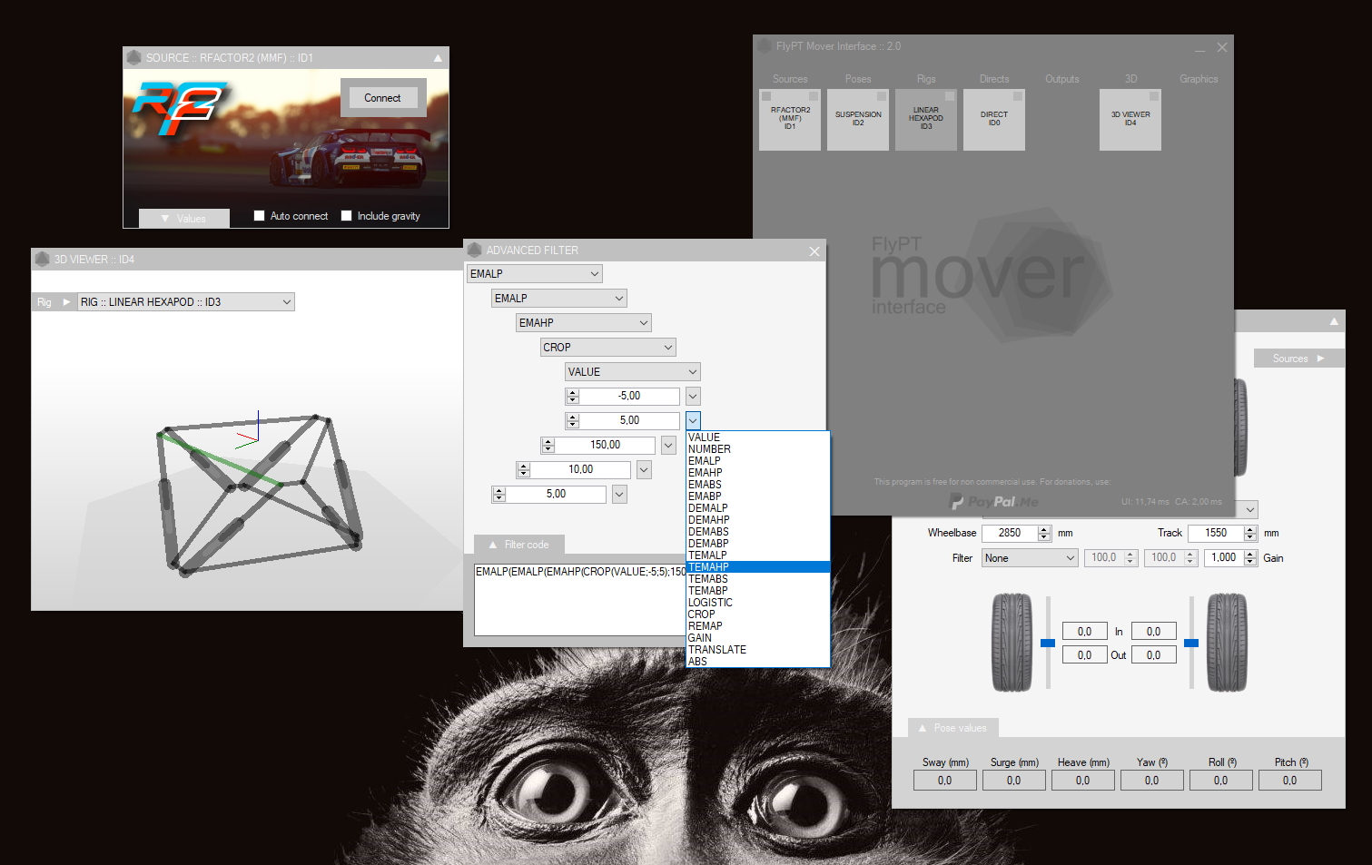

    MAIN WINDOW

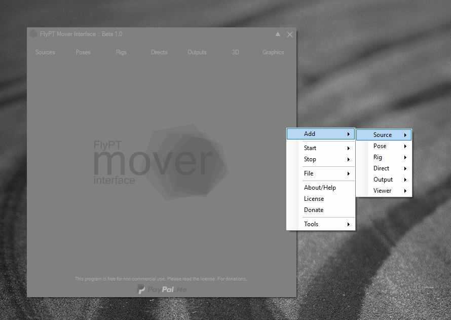

    You start the program with the main window:
    The window has nothing.
    To access the menu, just right click on the window.
    From there, you can add modules. Those modules are displayed in the main window.

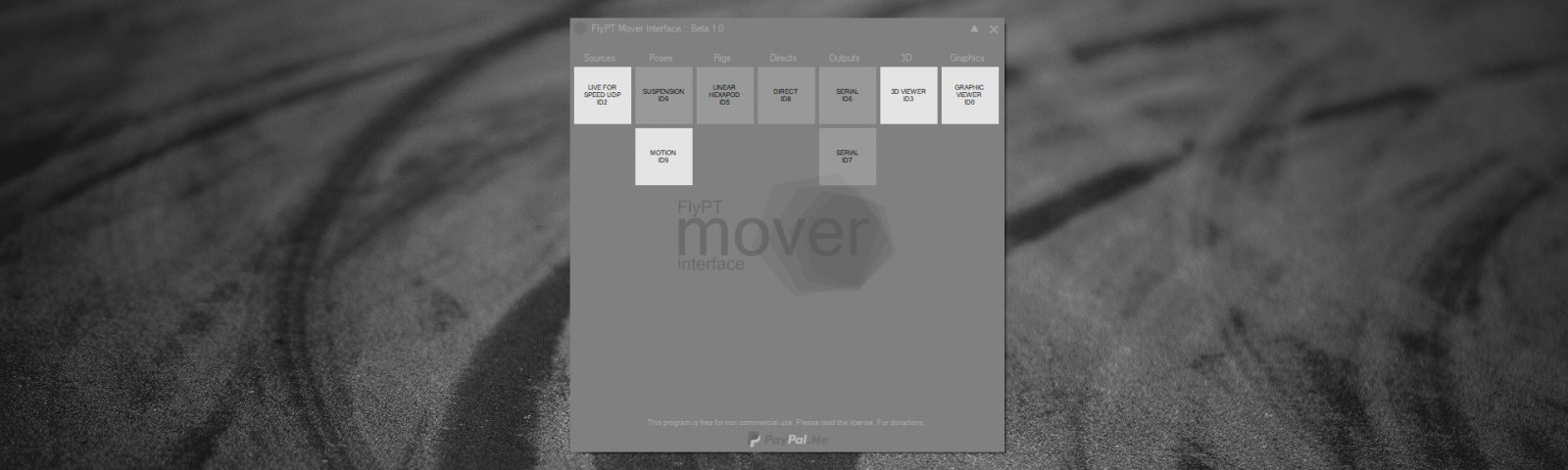

    Here you can see the main window populated with modules:
    So each time you add a module, a new window shows, where you can setup that module.
    Each component receives and outputs data.
    If you close the module window in the X, you are removing the module.
    You can hide the module by pressing the arrow in the window, or by clicking in the square of the module in the main window.
    So light squares are visible modules/windows, while darker ones are just hidden.
    You can see the modules are ordered by type, each column is a type.
    Calculations are made in the order of the columns and can't be changed.

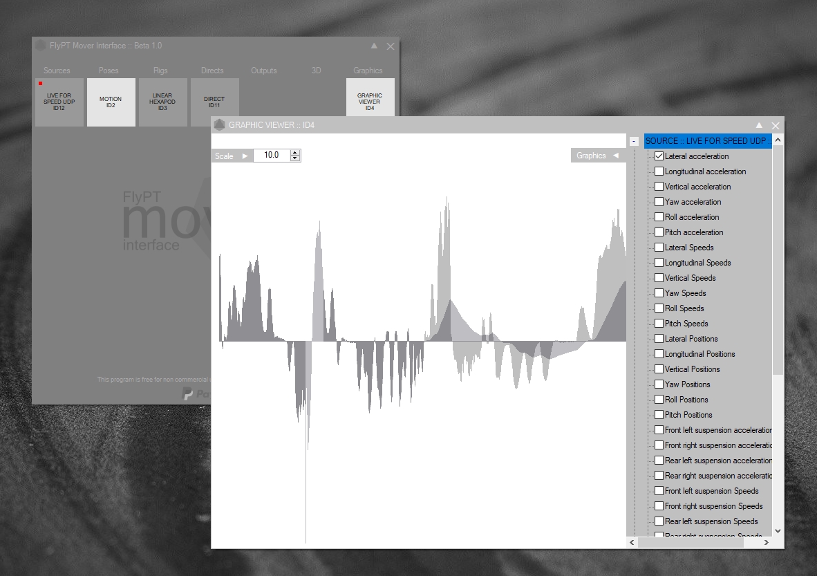

    Graphics
    For graphics visualisation from selected values.

    Start/Stop
    Source and Output modules show a small square that can turn red.
    When red, it means that module is connected (receiving or sending info).
    You can start/stop all at the same time in the menu.

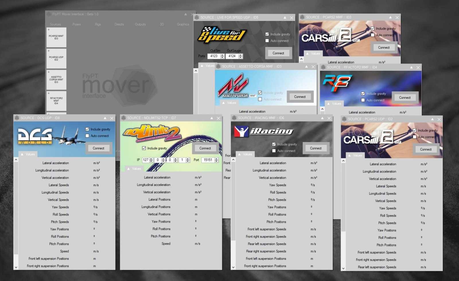

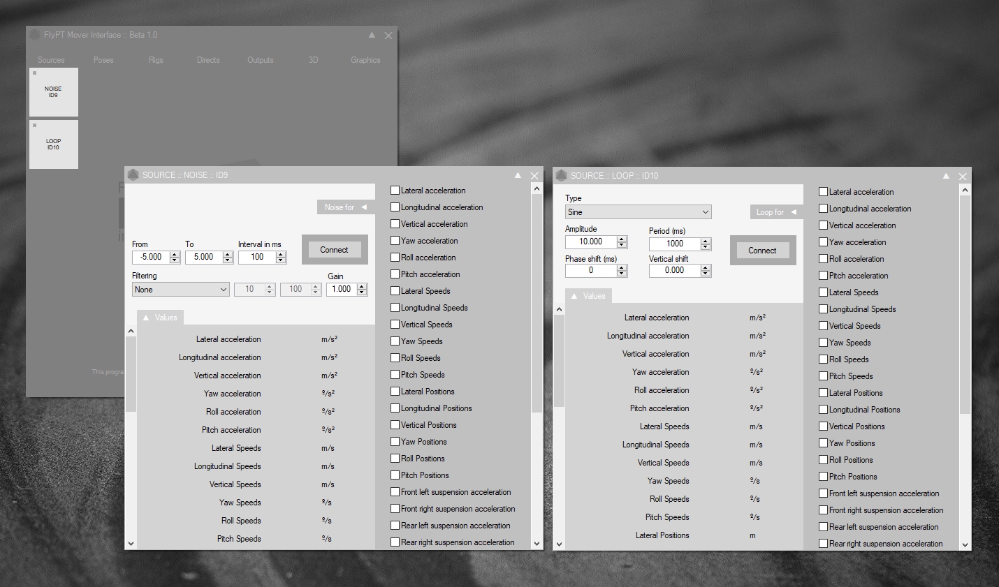

    SOURCES
    We have multiple types of sources.
    They can be info from games/applications or info generated by internal code.
    Current sources are:
    Noise (generated noise for one or more values)
    Loop (generated loops for one or more values)
    Record player (soon in a future update)
    SimTools (MMF) for more, see this post.
    Project CARS 2 (MMF)
    Project CARS 2 (UDP)
    Assetto Corsa (MMF) --> Should be compatible with Assetto Corsa Competizioni
    RFactor2 (MMF + DLL) --> Requires specific DLL!
    Live For Speed (UDP)
    RaceRoom (MMF)
    iRacing (MMF)
    No Limits 2 (TCP)
    DCS (UDP) --> Requires Lua script! For more, see this post.
    Where:
    MMF is data received from a memory mapped file (shared memory)
    UDP is data received by UDP protocol
    TCP is data received by TCP protocol​

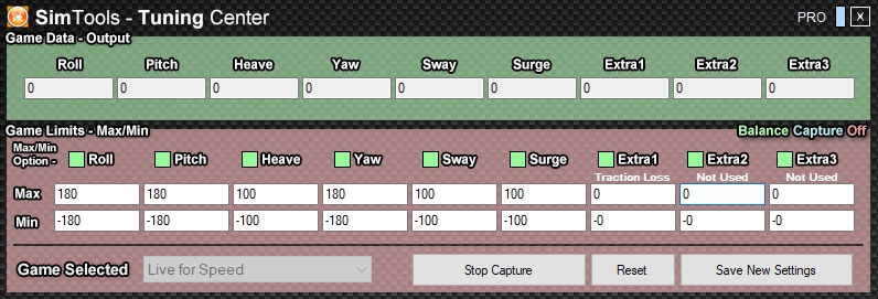

    There's a big difference compared to SimTools here.
    There's no tuning center, all values are received as they are. Just converted to the same units.
    And that affects how we receive data from SimTools.
    So if you are using SimTools as a source, I recommend to setup the tuning center with the following values:
    This way we receive the values without cropping or scale.
    Rotations from -180 to 180 and accelerations up to around 10g's.
    Those are not mandatory values. But a guide of what I think is best.
    For more on SimTools source, go to this post.

    Besides the sources from applications, you can generate internal sources:
    Noise - Random noise
    Loops - Based on Sin, square, triangle or saw curves
    Those effects can be generated just for one or more of the 33 values presented above. Just check them in the list shown at the right.
    Don't forget you can have multiple sources of those types.
    Also important is that in loops, all sources use the same timing, so you can adjust phase shifting to generate some interesting effects.

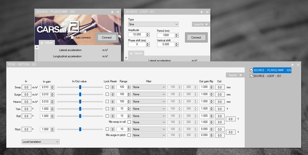

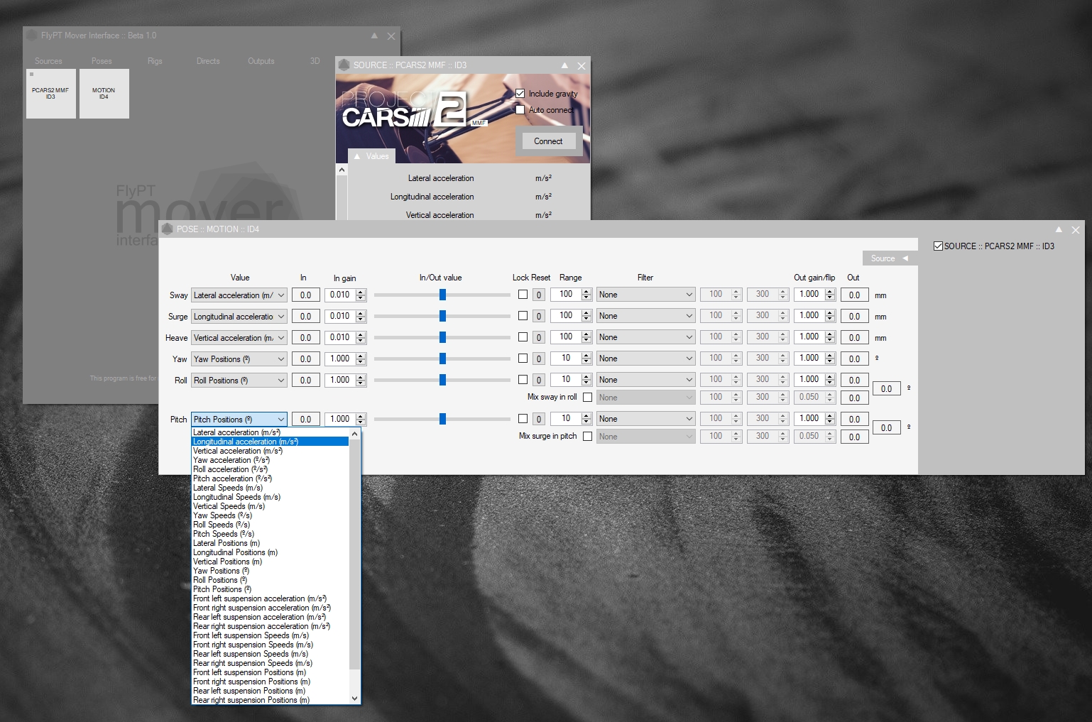

    POSES
    So we have our sources.
    We are receiving information about positions/accelerations and we want to generate a pose.
    A pose is the orientation/position that the rig will make to represent that info.
    So here is where we have the motion cueing alghorithm.
    Right now we have the following poses:
    Pose from motion
    This is where we setup the motion cueing alghorithm.
    Select the source of data from the right (you can select more than one to add them).
    Also, select witch value you want to use for each pose component.
    Now you can select acceleration, speed, position or any other value to generate the pose.
    Don't forget you can generate more than one pose and add them on the rig.

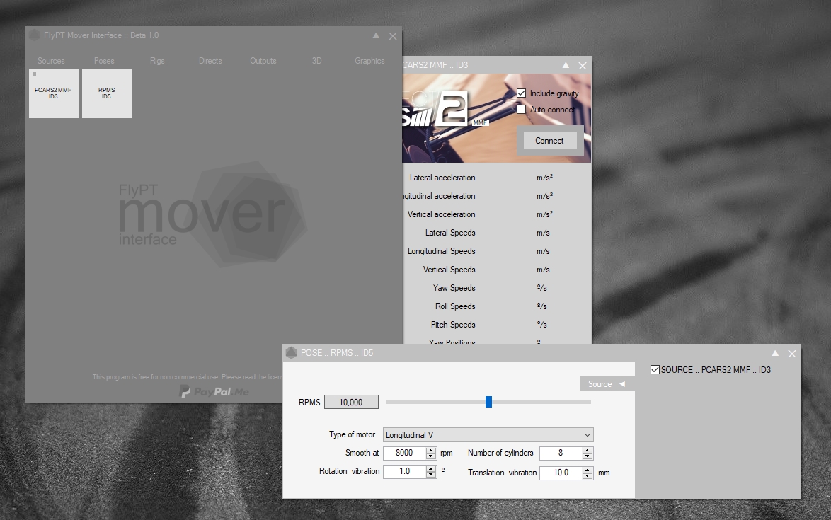

    Pose from RPM
    Generates a pose from the received RPM of the motor to simulate vibration due to RPM.

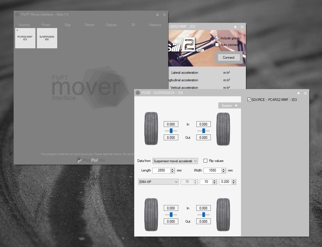

    Pose from suspension
    Generates a pose from the suspension info of a car game.
    Will become useful for other types of rigs besides hexapods.
    So we can play with this!
    Let's add motor vibration and suspension travel to the motion cueing.
    If your actuators can work at high frequencies, you can even replace tactile transducers... Well, maybe in my imagination.

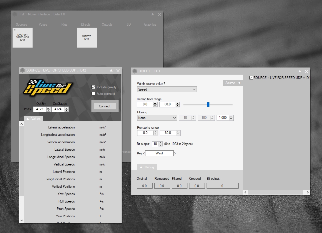

    DIRECTS
    With directs, you pick a value from the source, treat him and create an "actuator".
    That actuator can be used in the outputs to send data to the hardware.
    In the above picture, is an example for wind.
    We select Speed value from the selected source on the right.
    Use some filtering/remap.
    Convert it to a specific bit range and give it a key.
    Now that key is available in the output modules.
    This allows also the possibility to control your rig like we do in SimTools (or almost, needs testing).

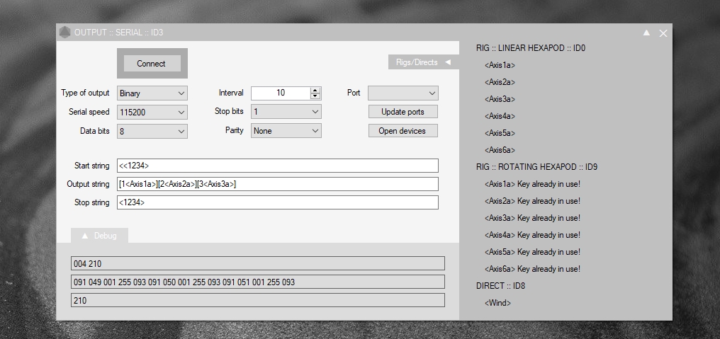

    That's where we send/receive data to/from the hardware.
    For now we can only send data by serial output.
    Soon, it will be added UDP and also receive data from hardware.
    With serial output, we can send by serial, the pretended position of the actuators.
    We add a serial output module for each board we are using.
    The interface looks like this:
    We can see:
    - On the right, the actuators available. They come from rigs or directs.
    The names/keys shown for each actuator are defined by the user on the rigs or directs.
    If a key is repeated, you can't use that actuator. If you use that name, only the first occurrence of that key is accessible.
    - On the bottom, we can see the sequence of bytes sent to the boards (debug).
    Each value separated by spaces is the value of one byte.
    - On the top, you specify the connection settings.
    Port shows the available ports. Don't forget that if you change the board to another USB port, this port might change.
    Interval is the time between each data sent to the board.
    Type of output, can be binary or decimal.
    In decimal, you convert the values to a string and send the byte values of the chars. So for example value 1234, uses 4 bytes to be sent in decimal.
    With binary, you send only the necessary bytes to define the value. So 1234 fits inside 2 bytes.
    See about strings bellow, to understand how binary can send values.
    - Strings sent to the boards are defined in the 3 text lines.
    One when you connect, one when you disconnect and the normal work string.
    You can use any char to compose the string. Only < and > are reserved for the keys.
    To use a key, you can drag the key from the right column to where you want her in the text.
    If the key inside the <> is not recognised, the chars are ignored.
    The number of bytes used for the keys are specified in the rigs and directs.
    The way they are sent, depends if you use binary or decimal.
    You can also send fixed values.
    If you use <54>, the value 54 is sent in one byte (for binary).
    But you can send 54 in 4 bytes, just put <<<<54>.
    For example, 1234 doesn't fit in one byte. Send it with <<1234> it generates two bytes to hold this value.
    If you send it with <1234>, the value overflows and you can't send the high byte, only the low one.

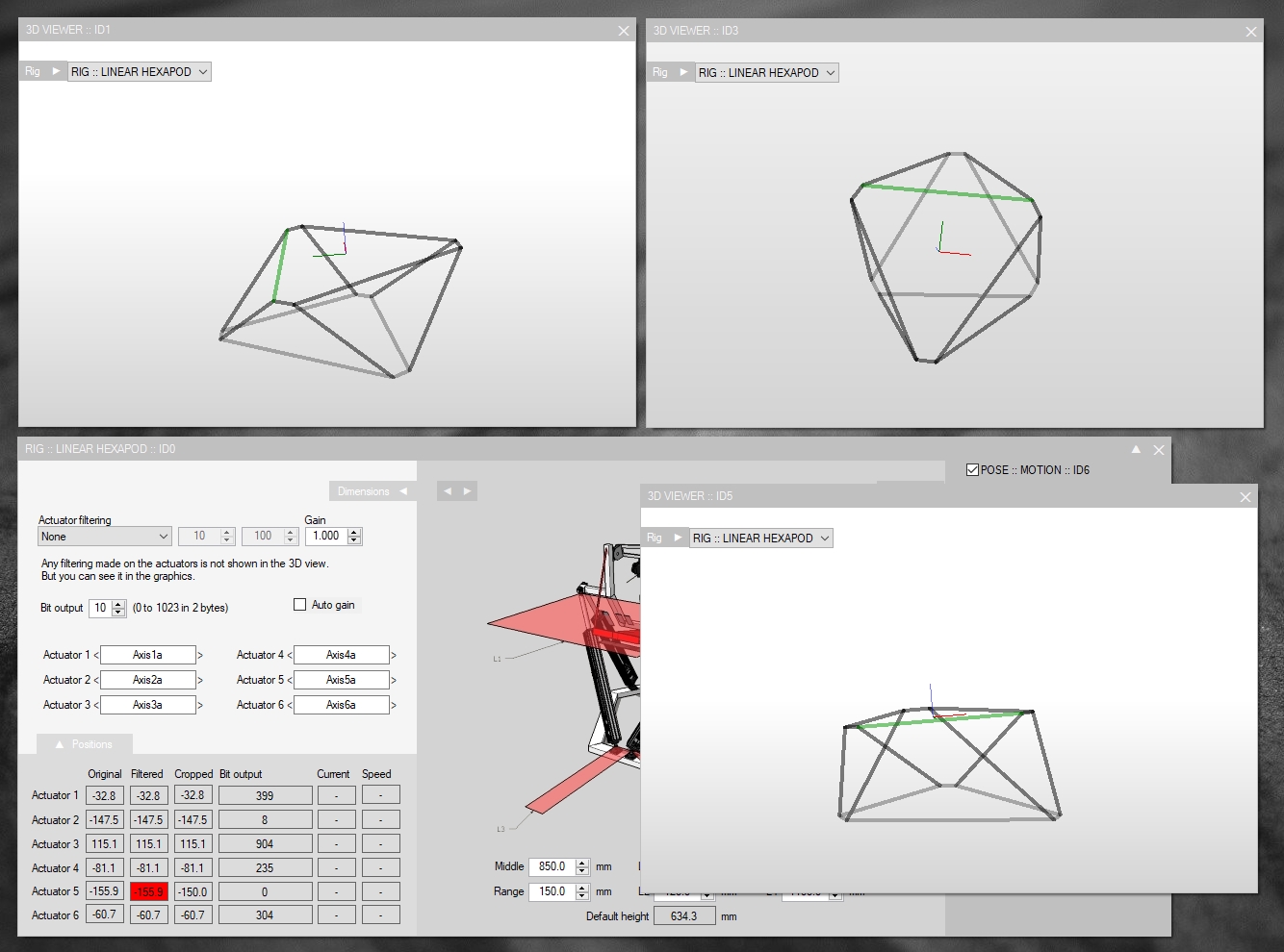

    3D Viewer
    Add one or more 3D viewers to visualize your rig behaviour.
    Don't forget, that the shown position is before applying any gain or filter to the actuators.
    You can add how many viewers you want to see the rig in different perspectives.
    In case you have more than one rig setup, you can choose witch one to view on the pull down menu.
    Use the mouse to rotate the rig, and the wheel mouse to zoom.
    Those are "heavy" tasks, so close the windows if you don't need them for better performance.
    Graphic viewer
    Some bug here (sorry).
    Still needing work.
    On the right you have all the available values to show on the graphic.
    Check the ones you want to see.
    Values are draw, all in the same scale, that you can define in the top left corner.
    This brings a problem, because the values can have big differences in ranges. So take it into account when using graphics.
    Also, for optimisation and speed, if you change selection or scale, only the new values have those new settings. History is kept unchanged, just scrolling left until it disappears (and I don't think it's going to change).
    Also for optimisation reasons, values are shown in translucent areas instead of lines.
    As I said, it needs work.

    One of the features of this interface is the possibility to add many items to the data processing.
    There's many things happening visually, to help on the setup of the rig.
    When you achieve satisfying results, you should hide all windows and remove the ones you don't need to avoid updates on the interface.
    Any extra info update increases lag. So, use only what you need.
    Run the program in "minimal" mode for better performance.
    Also hide panels that show resulting values to avoid those updates.

    FILTERS
    Maybe the most important part of Mover.
    It's also important that you understand what each filter does to make it easier for you to use them.
    To learn, the best is to use the graphic viewer and a loop source.
    You can see the results of the filters over the original value.
    Please try, it's the best way to understand them.
    Mover uses a new filter system:
    We can compose the filter with multiple operations and specific values.
    This allows users to crop/limit values received.
    And also play with a multitude of filtering solutions.
    Filter can be generated in the combo boxes visually or by writing the code in the text box.
    Here's a quick reference of the filtering system:
    ADVANCED FILTERING
    Advanced filter is composed by a series of operations.
    Each operation can have parameters.
    Those parameters can be numbers or other operations.
    Possible operations:
    VALUE
    Is the value received.
    No parameters available.
    NUMBER
    To specify a numeric value.

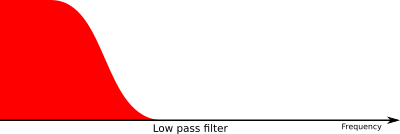

    EMALP
    Exponential moving average low pass filter.
    Parameter 1 is the value we want to filter.
    Parameter 2 is the number of samples used in the filter.
    Use this to smooth a signal by removing high frequency variations.
    Only low frequencies pass (look at figure bellow).
    The number of samples define where we have the cutoff.
    Cutoff is not a vertical line, only in ideal filters this happens. Reality is a progressive change like the curve shown in the figure.

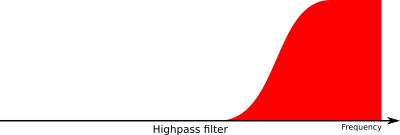

    EMAHP
    Exponential moving average high pass filter.
    The high pass filter is the value we want to filter less the low pass filter for the specified samples.
    So the number of samples specified, define the low pass filter used.
    Here, only high frequencies values pass.
    Low frequencies changes/smooth changes are removed, depending on the selected number of samples (see image bellow).
    The formula for this filter is:
    EMAHP = VALUE - EMALP(VALUE)
    EMABS
    Exponential moving average band stop filter.
    Parameter 2 is the number of samples used to define the start of the band (filter #1).
    Parameter 3 is the number of samples used to define the end of the band (filter #2).

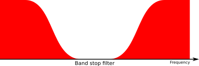

    This filter, removes all the frequencies between filter #1 and filter #2.
    So we get low frequencies and high frequencies.
    Filter #1 and filter #2 define the start and end of the band of frequencies we want to remove.
    EMABS = EMALP(VALUE) + EMAHP(VALUE)

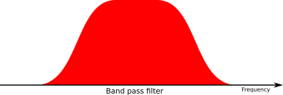

    EMABP
    Exponential moving average band pass filter.
    This filter, only allows frequencies between filter #1 and filter #2.
    So we remove low and high frequencies.
    EMABP = VALUE - EMABS(VALUE)
    DEMA...
    Double exponential moving average filters.
    Like EMA filters, but "2nd order".
    Compared to EMA, those filters have less lag, but they also overshoot (see TEMA figure bellow).
    Formulas are:
    DEMALP = 2 * EMALP(VALUE) - EMALP(EMALP(VALUE))
    DEMAHP= VALUE - DEMALP(VALUE)
    DEMABS = DEMALP(VALUE) + DEMAHP(VALUE)
    DEMA BP = VALUE - DEMABS(VALUE)
    TEMA...
    Triple exponential moving average filters.
    Like EMA filters, but "3rd order".
    Faster response compared to DEMA, but even more overshoot (see figure bellow).
    Formulas are:
    TEMALP = 3 * (EMALP(VALUE) - DEMALP(VALUE)) + EMALP(DEMALP(VALUE))
    TEMAHP= VALUE - DEMALP(VALUE)
    TEMABS = DEMALP(VALUE) + DEMAHP(VALUE)
    TEMA BP = VALUE - DEMABS(VALUE)
    LOGISTIC

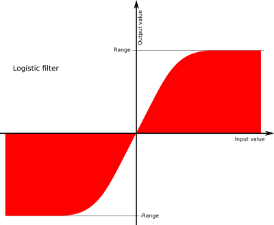

    Logistic is a case of the sigmoid filter.
    Here we use a faster simplification.
    Parameter 2 is the range (minimum/maximum value allowed).
    Parameter 3 defines the S shape. High value makes is a more vertical slope while low values make it more horizontal.
    Use this filter to fit values to a specific range
    Reaching and surpassing the maximum range, values are "compressed" to fit the specified range.
    The S slope defines how fast and how much we compress the values.
    64816
    CROP
    To define minimum and maximum for a value.
    Parameter 1 is the value we want to limit.
    Parameter 2 is the minimum value we allow.
    Parameter 3 is the maximum value we allow.
    REMAP
    To remap a value from a range to another range.
    Parameter 1 is the value we want to remap.
    Parameter 2 is the start of the range where we have the received value.
    Parameter 3 is the end of the range where we have the received value.
    Parameter 4 is the start of the range where we want to have the received value.
    Parameter 5 is the end of the range where we want to have the received value.
    GAIN
    Is a multiplication operation.
    Parameter 1 is the value we want to modify.
    Parameter 2 is the gain we want to apply.
    Use this to invert values by using negative numbers.
    TRANSLATE
    Is an addition operation.
    Parameter 2 is the amount we want to move the value.
    ABS
    Get the absolute value.
    Parameter 1 is the value we want to turn into absolute value.
    SPIKE
    It's a basic filter to remove spikes from a signal.
    This filter, calculates the difference between the last value and the current one.
    If the value is inside the allowed difference (defined in the second field of the filter), we let that value pass.
    If it's out of the limit, than we let's pass just a certain amount of that value (defined in the third field of the filter).
    If you put zero in that field, the value stays the same it was.
    If you put 0.5, then the old value is added by half the difference between the old and the new value.
