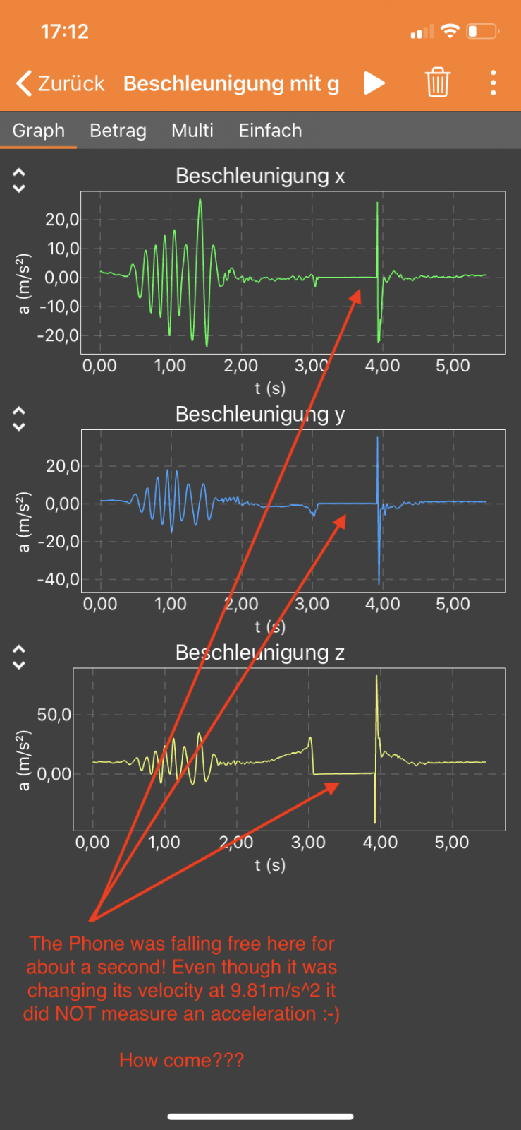

    Do an experiment with your phone:
    - Download the app Phyphox
    - Take a look at "Accelerations including G"
    - Wiggle the phone around a little (just to get the scale adapted to higher values)
    - Throw the phone up into the air and catch it
    You will see that the phone does not measure ANY accelerations while falling freely.
    The opposite is the case: It will START to measure an acceleration as it approaches terminal velocity :)
    I know this is counter-intuitive, but rest assured you are in very good company if you have a hard time fitting this in with the rest of what you know about the world. When asked what his greatest achievement was, Einstein answered "the equivalence principle". It was his realization that an acceleration is not necessarily a change of velocity, but can also stem from the curvature of space. More precisely: The curvature of spacetime under the influence of a large mass. Curved space and acceleration are the same thing --> equivalent.

    • the explanation for the phone app result is the following:
    the phone sensor measures a force applied to its cantiliver piezzo
    it doesn't measure an acceleration along an axis (ddx/dt²)
    while free falling, gravity and acceleration substract,
    hence phone sensor says = 0
    it's the feeling of weightlessness
    • In Newtonian physics, free fall is any motion of a body where gravity is the only force acting upon it.
      According to this definition, the sentence "a free falling object doesn’t accelerate." is false. But apparently you're using "free fall" not in a strict sense. So we disagree :D
    https://en.wikipedia.org/wiki/Free_fall

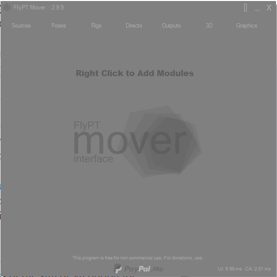

    Hey guys. I'm trying to help a friend get FlyPT mover working on his 6DOF.
    His motion sim uses Ethernet UDP. Do we have a way to send the output of Mover via Ethernet UDP yet? If not, is this something we could reasonably add?
    In the UDP output of FlyPT Mover there is no place for the IP address of the sim or an option for "network" such as in SimTools so my best guess is we just haven't had a request for this to be added yet.
    Also @pmvcda Because I have not had a working motion sim for many months I just loaded it up for the first time in a long while. The new features look fantastic! It will be interesting to see how I have to set it up for the G-seat.
    I do have one small suggestion @pmvcda just to help brand new users. When a new person loads up Mover for the first time they see a window with all of the options dim and grey so there is no obvious way to start. I'm certain this causes some people to just give up. I would recommend you add text to give them a hint to right click. I made an image to show my suggestion.

    The udp output, broadcasts data to all ip's, so you just need to set the port.
    It also broadcasts to all the network cards attached to the pc.
    The idea is to make it simpler to use.
    I will add the text on the empty window.
    Curous to see your rig working.

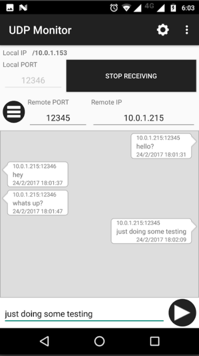

    To see if Mover is sending data out, you can use an app on your phone to see if you receive data.
    Something like UDP monitor:
    On the top left, set the port you use in your rig, and press the button to receive.
    See if you get data from Mover.

    The monitor app DOES receive packets as soon as I "connect" in Output::UDP and stops when I disconnect.
    My output string is copied from SimTools and reads: <Axis1a><Axis2a><Axis3a><Axis4a><Axis5a><Axis6a>
    I don't need a start or stop string in SimTools.
