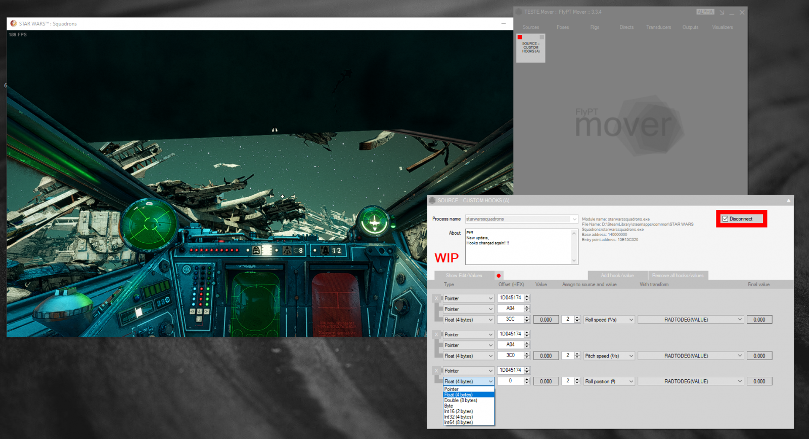

    In the next build:
    We can set custom hooks.
    So users can update the values in the source, and share the souce file.
    Now I don't need to update Mover just to update the hooks in a game.
    Yes, I know, everyone can see them and copy them. But I hope we get some sharing here ;)

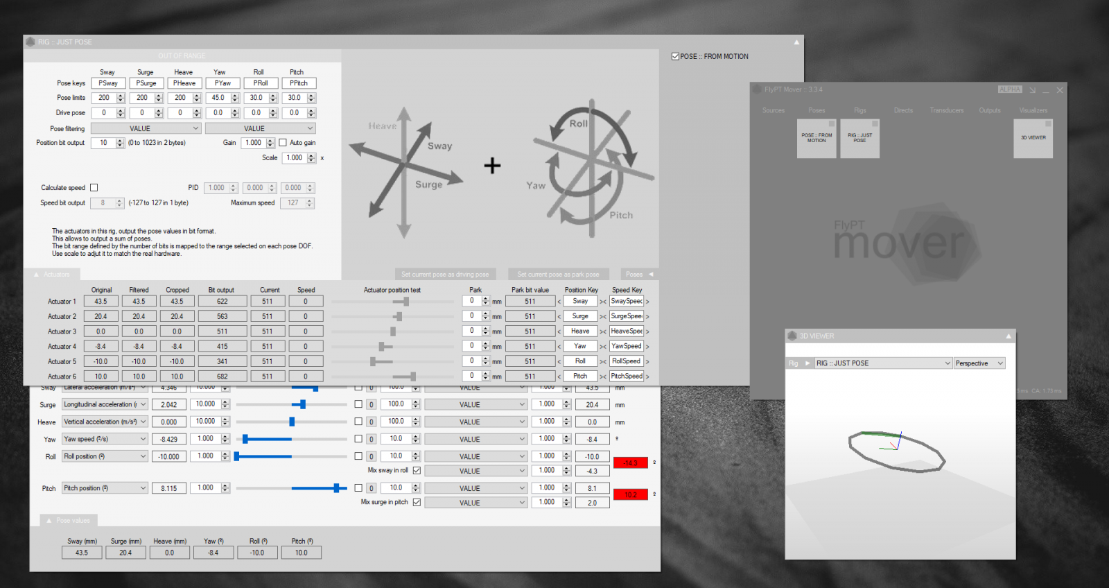

    Mover 3.3.4 ALPHA
    Download in first post.
    See post above with new source for custom hooks.
    Now outputs position of actuators in mm or º besides bit value:
    <B...> Bit value
    <P...> Position value
    <S...> Speed bit value (WIP)
    Corrected some errors in the rig "Pose" and added 3d representation:
    Some other bugs solved
    • Winner Winner x 3

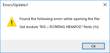

    This window everytime show at launch FlyPT. What's wrong???
  10. pmvcda
    pmvcda aka FlyPT
    Nov 3, 2010
    2,296
    Portugal
    16,036Coins
    +2,746 / 18 / -0
    Open the setup, correct it and save again.
    It's because of the updates.
    Some fieldhas changed and is making this error, probably a debug field

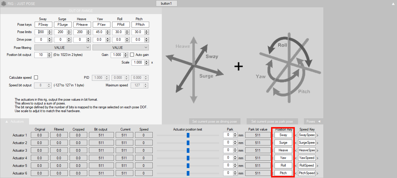

    Speed is the only key that works in my current setup. And moving the sliders in RIG::JUST POSE translates absolutely perfect in smooth movement of my physical rig (but each axis in only one direction and back to middle).
    I probably haven't understood the naming conventions we use in RIGs "Pose Key" and "Speed Key" fields. Sorry for asking three questions:
    a) In the popup explanation for "Speed Key" you say the name should be "unique" ─ meaning they should NOT be identical to the <keys> used in the Output string?
    b) When you warn about keys already "in use", we should NOT use them in the Output string?
    c) what's the purpose of the new fields "Receive from port" in OUTPUT::UDP receive from port.png ?

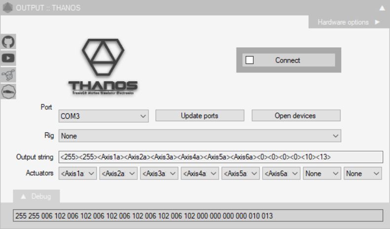

    hello!
    i gave a try on 3.3.4 and noticed a few things.
    first, in output::Thanos, the output string does not take into account new BPS values
    they should now be " <255><255><BAxis1a><BAxis2a><BAxis3a><BAxis4a><BAxis5a><BAxis6a><0><0><0><0><10><13> " ...depending on your rig actuators order of course.
    Second, when I add or remove poses while rig is online, it slowly moves to very strange extreme positions. I think it appends since Version 3, but not sure...
    And.. that's all, All the work done is working incredibely well. I'm really impressed !

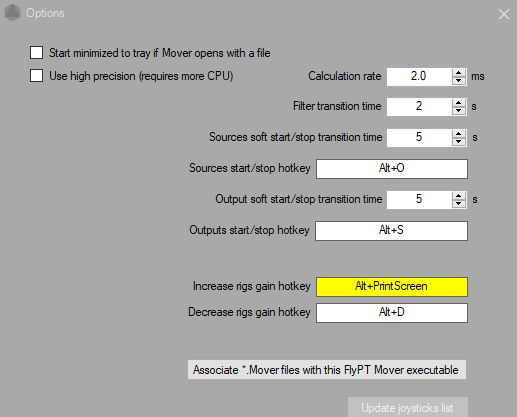

    Ah, and yes, I would love to have the option to link rig gain to an analog value between min/max caped values.
    I guess it would need a highly filtered input to prevent strange or bumpy behaviour, but i can deal with this.
    if it's not too long to add, I think it worths the try.
    many thanks !

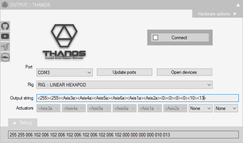

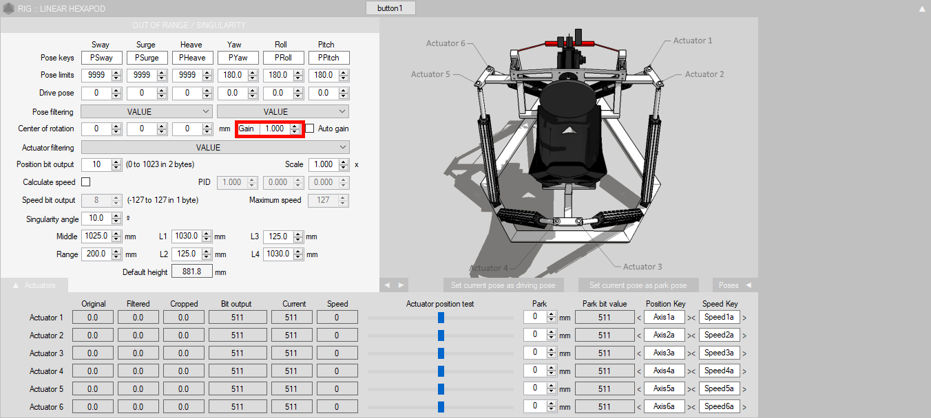

  16. C1500
    C1500 Active Member
    Nov 19, 2018
    165
    1,120Coins
    +86 / 1 / -0

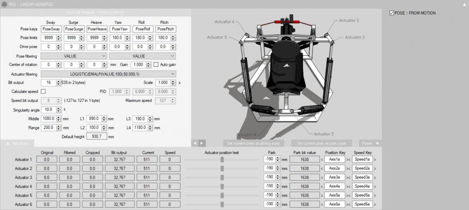

    AC motor, 6DOF
    Hi
    I have some problems with the understanding and configuration of the AMC-AASD15A controller.
    My rig configuration looks like this:
    I have connected AMC-AASD15A channel 1 to the motor "actuator 1" as shown in the grafic.
    I could manually config the actuators. Then it looks like this:
    Then the movement of the rig seems to be correct.
    But if I select "RIG :: LINEAR HEXAPOD" at the rig option, it looks like this:
    The actuators are in wrong order
    Is this a bug or is the connection to the AMC-AASD15A in this order as shown in the last pic above?
    kind regards
    Peer

    The new fields in the output are not 100% yet.
    They are meant to have feedback from the rig
    In the future, you can specify an input string and update values with the value received from the rig.
    It will allow calculation of PID in Mover.
    We receive current position of the actuator from the rig, and knowing the desired position, we can calculate the speed we want on the actuator. That speed depends on the PID values inserted in the fields.
    For UDP communication, we need to set the port where we are listening for data.
    Currently, the calculated speed is always relative to the middle of the actuator, since feedback is not working yet. We don't know where we have the actuator without feedback.
    Also the speed is sent as a "bit" value. This means there's no negative values.
    If I use a 8bit value for speed, it means speed is between 0 and 255.
    So from 127 to 0 is negative values and from 128 to 255 it's positive ones.
    This should be handles by the controller.
    I will also add an output in m/s, and this one is going to have negative values.
    It's just like position of the actuator.
    This is why you don't have negative values.
    Don't use speed for now.

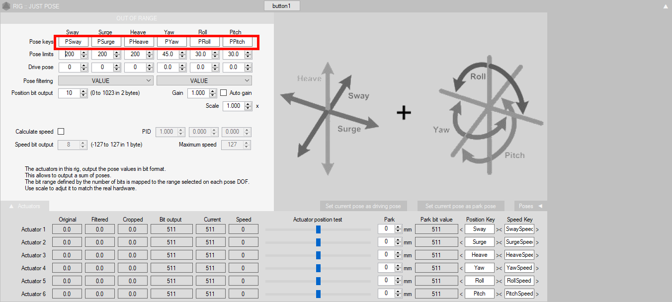

    The pose rig is a bit different from others.
    The output instead of an actuator position is a DOF position. Or better, the actuators are DOF's.
    The problem you are seeing is that by default I also output the rig pose and I use the same key.
    Keys are a way to identify the value you want to use, and when it repeats, you get that message.
    So if you set that key, only the first occurrence of that key is identified, the repeated ones are ignored.
    I allow the definition of some keys, not all. And that might be my error.
    Sometimes to much freedom ends in some strange issues.
    I have to rethink it, but for now, I'm going to change some of the default keys to solve it.
    Those BSway, BYaw, .... are repeated (B means bit value).
    If you go to the rig window, you can change the pose output here:
    or the "actuators" here:
    That way they don't match. I will change it in the next build, to have different names by default.
    Problem is I'm appending B P or S on the actuators output, depending on the desired value.
    To set each key, I would need 3 fields for each actuator, or even 4 when I get speed in m/s. It would be to much.
  18. pmvcda
    pmvcda aka FlyPT
    Nov 3, 2010
    2,296
    Portugal
    16,036Coins
    +2,746 / 18 / -0
    It's not a bug.
    It's a mess :D
    When I started making the rig, I always followed the order:
    Actuator #1 first one on the front/right
    Next actuators in clock order.
    This is what you see in Mover images.
    Thanos follows a different order. It's clock order, but #1 is the first on the rear left(not 100% sure right now).
    So what I have done is keep my order.
    But in the output of Thanos, I reorder the actuators to the order used by Thanos.
    In reality, if you connect the actuators to the controller in Mover order, you have to keep it in the hardware also. That's why if you set it to 1 2 3 4 ... it works, because that's how you connected them in the controller.
    But in the Thanos discord and manuals he says to connect it in a different order.
    I would recomend to use Thanos order in the "hardware" connection, when using the Thanos output.
    For hexapods there's no difference, but in rigs with traction loss, he uses a specific order with internal spike filters acting on the actuators.
    Resuming:
    -In the controller, connect the actuators to the plugs in the order recommended by Thanos.
    -In Mover use the Thanos output, select the rig and keep that order.
    Sometimes we try to simplify and in the end we make it complicated.
    Idea here is: Don't think to much... :confused:
  19. pmvcda
    pmvcda aka FlyPT
    Nov 3, 2010
    2,296
    Portugal
    16,036Coins
    +2,746 / 18 / -0
    Sorry, not understanding it 100%
    In the rig you can set gain:
    And you can go to options and set a keyboard key or joystick button to change the value (changes in all rigs used):
    This allows you to do it manually.
    Maybe you are speaking of the auto gain. To add a minimum/maximum value?

    Oh, I have to look at those.
    That's why some people are having problems with the output.
    Good catch on the keys
