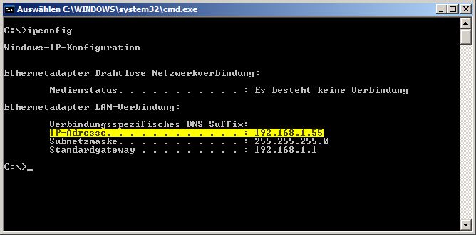

  • Check the IP address of your 2nd PC with ipconfig.exe:
[Windows key]-R → type cmd → on the prompt type ipconfig → read the the ip address

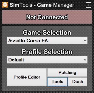

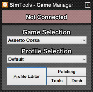

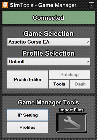

  • Start Game Engine on the 2nd PC.

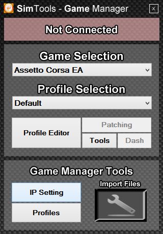

  • Start Game Manager on the game PC
  • Game Manager should read “Not Connected”.
  • Click on Tools and an additional Game Manager Tool set will appear.

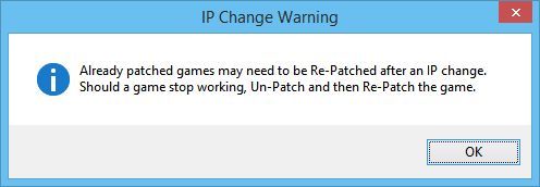

[GARD]

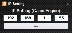

  • Click on IP Setting and read and internalise the warning.
  • Enter the IP address of the 2nd computer:
  • Click on Save. The IP Setting dialog box will disappear and the Game Manager will now read Connected:
  • Make the Game Manager Tools disappear by clicking on Tools again.

SimTools Game Manager
Game Manager
Checking the State
The game manager has three states that it can be in and is displayed in the top bar as follows:
·         Not Connect – (red) which states that the game manager is not connected to the game engine, normally meaning the game engine is not running, please start the game engine and it will then automatically connect itself.
·         Connected – (green) which states it is connected to the game engine and is ready to go.
·         Game Running– (blue) this states that it has connected successfully with a game plugin and is sending data to the game engine which in turn will be sending data to the interfaces if you have set them correctly.
These three states help you recognize what process step the Game Manager is in.

Using the Tools
Include in the Game Manager is a list of tools, their functions are as follows:
  • IP Settings – If using two computers with the Manager separate to the Engine.
  • Profiles – Access to all your game profiles stored in the Game Manager.
  • Import Files – A simple Drag and Drop to import Game Manager related files.
IP Settings
  1. Open Game Manager from the status bar.
  2. Press Tools.
  3. Press IP Setting
  4. Press Ok.
  5. In the next window please change the IP setting to match the IP of the Game Engines location.
  6. Press Save.
Changing the IP in Game Engine

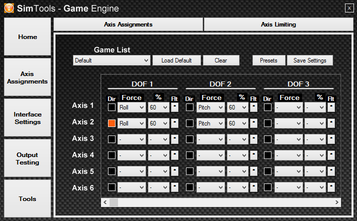

SimTools Game Engine
Home Screen
Here in the Home Screen we can set a picture of our simulator or a picture to make our setup look personal to our tastes.

Axis Assignments
The axis used by the Game Engine are important to setup correctly as this will decide how your simulator will act to the input coming from the Game Manager.
You can gain access to these by pressing the button marked Axis Assignments located on the top line.
Looking at this page you will notice on the left hand side a list of Axis 1 through to 6; these are the Axis that you may setup to be used by the Interfaces that you will select in Interface settings. They represent the actuators/motors within you simulator as you may guess for a 2 DOF unit you will setup two axes and so on to a 6 DOF unit where you will setup all six axis.
In the center box is a list of DOF which allows you set the forces you wish to act on each axis and can be a collection of up to six allowing for a very complicated axis profile to be easily written. Along with just selecting the forces to use you can apply filters and the % of the total axis movement to be used by each force.
For now we will setup the default axis as this is the most important one to setup first before moving on and installing any game plugin.
Setting up your Default Axis
It is recommended that we first setup our Axis, to test the simulator before testing any game output. So when we actually test a game we only have to fine tune the result.
  1.  Open SimTools Game Engine
  2.  Press Axis Assignments
Now we can build an axis table that looks like this below. The default axis settings are used for any new game plugin that is installed later.
Setting the Default Axis
From this you can see that both axis pitches and move in the same direction to create a pitch down and up movement, and for roll they move in an opposite direction to create a roll movement.
Method for setting the default axis settings:
  1. Click on the Game List box and Select “Default
  2. To check what is set for the AxisRoll and Pitch, noting that roll has one axis is inverted.
  3. Click “Save Settings” to save the changes to the Sim Engine.
Now we have just set our Default (Base) axis for all new games that are added to the Game Manager but remember we can always come back and change these values for a specific game.
Now what we have actually set in the above Default Axis profiles is for our sim to use 60% of the actuators movement to Roll (Tilt left to right) and to use 60% of the actuator travel to Pitch(tilt forward and backward) and both Roll and Pitch act on both Axis(motors). Please not if only one Axis(motor) controls the Pitch and one controls the Roll you will need to change the Default Axis to represent this.
Due noted that we haven’t included any Surge (longitudinal) and Sway (lateral) or Heave (vertical) to our default axis settings this can be done as well by adding it to the default profile to create a true motion cue.
This also can easily be set by using the supplied presets or from a preset that someone has sent you. This can be handy when copying some else’s design and wish to use the same setting as they have. We will explain below how to select a preset and how to save your own if you wish to send it to someone to try and test.
Selecting a preset for Game Engine
To use a supplied preset:
  1. Press the button – Presets.
  2. Press the drop box under  Load a Preset.
  3. Select a preset for example  SimForceGT.
  4. Close this window with the  X.
  5. Press Save Settings to save these values to the Default.
Now we have saved the above settings from the SimForceGT profile to our default axis profile. To be a perfect world we would have a list of all types of profile preset to use but to be fair we are able to create our own and save this so that we are able to send them to each other to make our journey through SimTools a pleasant one.

Here my axis settings for the model attached:
Axis Assignments

Contained in the Game Engine we have a button list on the right hand side as follows:
  • Home – This is where a picture of your simulator will be placed, explained in Chapter x. Please refer to this and makes your copy of SimTools personal.
  • Axis Assignments – Here you can setup the axis of the simulator as in how you want the forces to act when everything is running
  • Interface Settings – This will be where you enter the details for setting up the motor controllers, etc. that you will to use with SimTools.
  • Output Testing – Here you will be able to test your interfaces without using a game output. The Default axis settings are used here.
  • Tools – Here is where we can use tools selected for Game Engine to use, clear our home page, Manage our presets and set the priority of the Game Engine.

Game Manager
The Game Managers main task is to patch games and transfer this information to the Game Engine for processing to the Interfaces setup by your settings and for creating game profiles and setting up the of the Game Dash.
The buttons contained in the Game Manager have the following functions:
  • Top bar shows the status of the Game Manager, whether it is connected to the Game Engine or if a game is currently running.
  • Game Selection – Allows you to select a game plugin that you have installed via the Plugin Updater.
  • Profile Selection – As it states you can select the default profile to run when a game starts or a custom profile that you have written in the Profile Editor.
  • Profile Editor – Is where you can build a custom profile that can be selected via the Profile Selection and can be change live while in the game and can be modified while still live in the game selected.
  • Patching – As it name suggests is where you patch a game with the plugins so that Game Manager may send data to the Game Engine.
  • Tools – Here we can select tools that you have setup in order to help you in the Game Manager and also contain the area where you can access the profiles created in the profile editor, so you can copy and send them to someone else to use. Also contains the area where you can drop profiles that you have obtained by someone else all these operations.
  • Dash – Allows you to initiate the Dash out available in certain games as well be able to set an IP address if the dashboard is on another IP Address.
