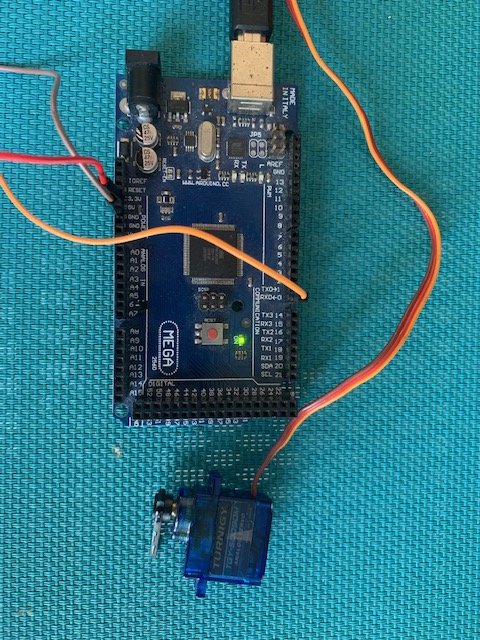

    Hi everyone, I read and study as much as possible. I feel I am close to my first small goal. Simtool output testing Arduino and 2 servos. Ultimate goal is a small prototype of 6 dof using RC servos like many of you have built. and use that to learn motion settings before buying linear actuators AMC controller and building the real thing. So far I have installed and licensed Simtool 2.5. I read some thread and copied settings. When I go to Output testing and turn on the servo, it vibrates. But moving the slider does nothing. Arduino is Mega 2560. code is attached. Not sure what pin i need to attached the 2 servos. 0 and 1 ? See attached pictures for my Simtools settings. Thank you!

    Here is the wiring:

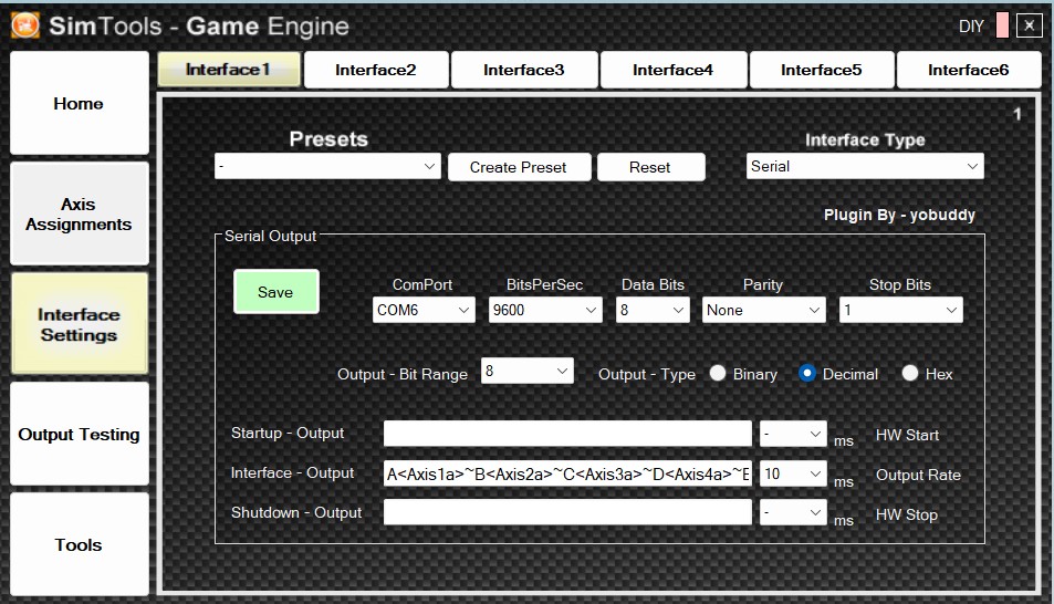

    Thank you noorbeast for the diagram. I did correct my error and connect my servos on 4 and 5. On the Simtools game engine, Output Testing, when i click on Turn On the servos move a little and the game engine closes. Any suggestions? Thank you for your patience dealing with a newbie.

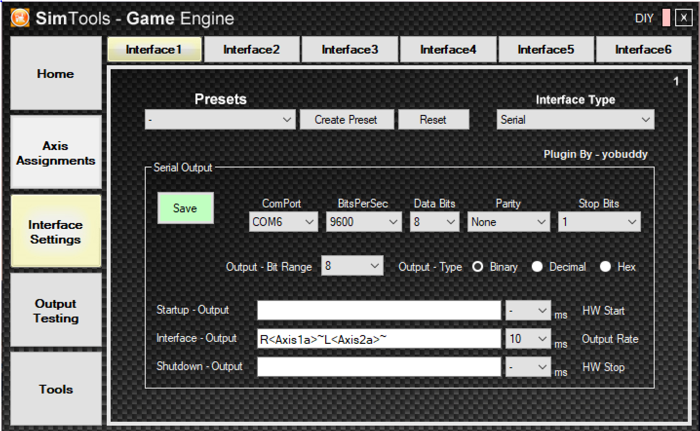

    Yes sir. But i notice something. Inside the RC Model folder there is a test interface config file with baud rate, bit etc. The output type in that file says Decimal. My Simtools interface setup is set to binary. I am not in front of my simulator computer to test it but is it suppose to be decimal? Thank you!
    21,514
    150,704Coins
    +11,018 / 55 / -2
    Please see @eaorobbie's instructions:

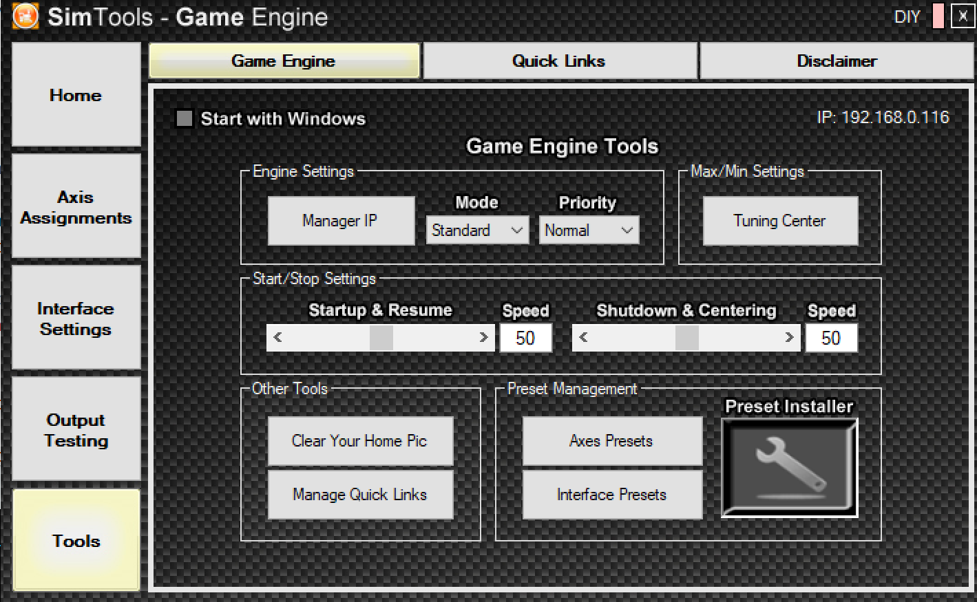

    Please install the RC Model Test_InterfaceConfig.cfg to Game Engine - Tools - Preset Validator. After that the preset can be selected in the Interface Preset box and you just need to specify the Comport Number of the Ard and then Test the Output will work correctly.

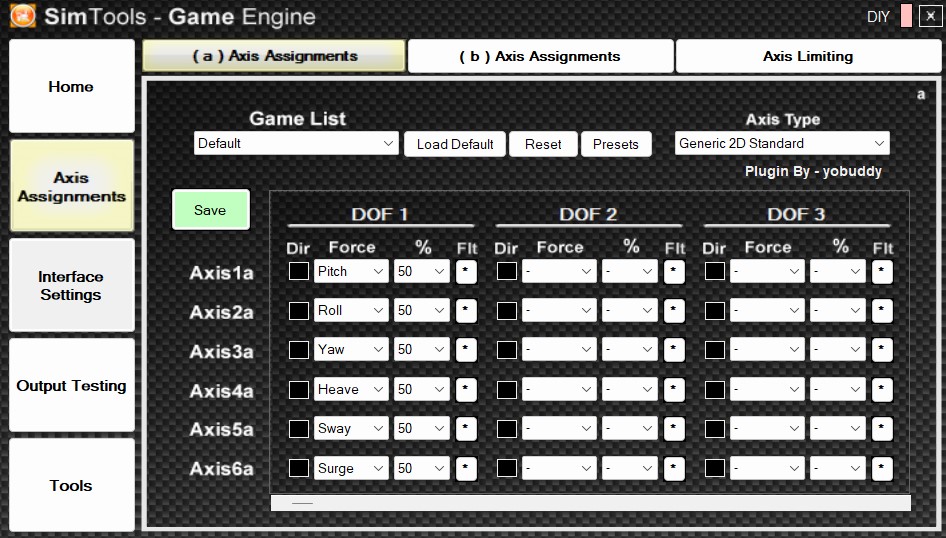

    Interface Settings should be Decimal, like this with whatever is the correct com port:

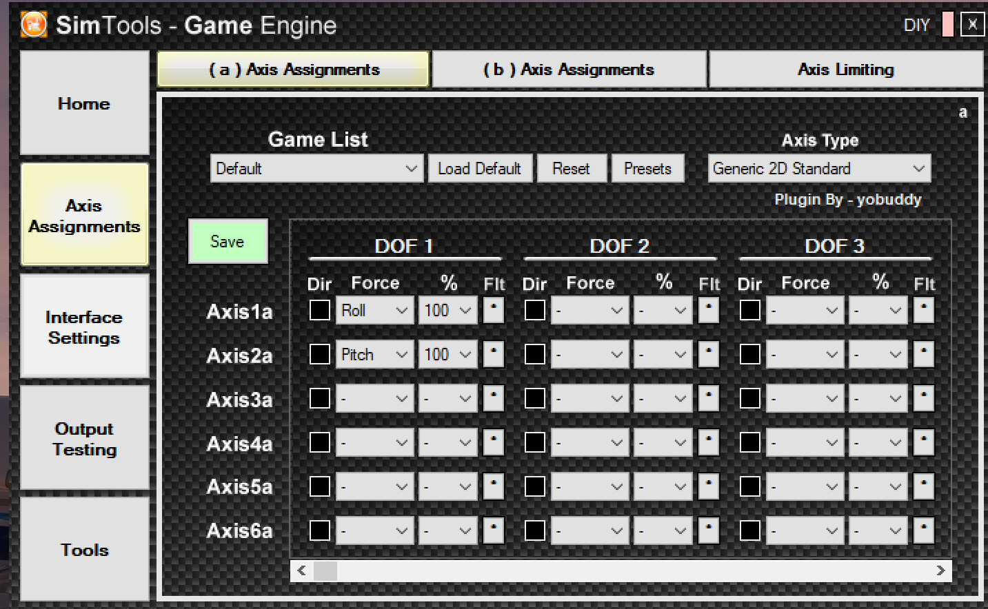

    For Axis Assignments below is incorrect, grab a copy of the SimTools manual and keep it handy for reference: https://www.xsimulator.net/community/faq/rtfm-start-with-the-official-simtools-documentation.117/
    For a 2DOF,use DOF1 and DOF2 for each axis, and Axis1a and Axis2a for each direction of each axis.
    Try and keep the Axis Assignment % total to around 100% total, below totals 200% and does not yet include sway, surge and heave: https://www.xsimulator.net/community/faq/axis-assignment-percentage-totals.120/

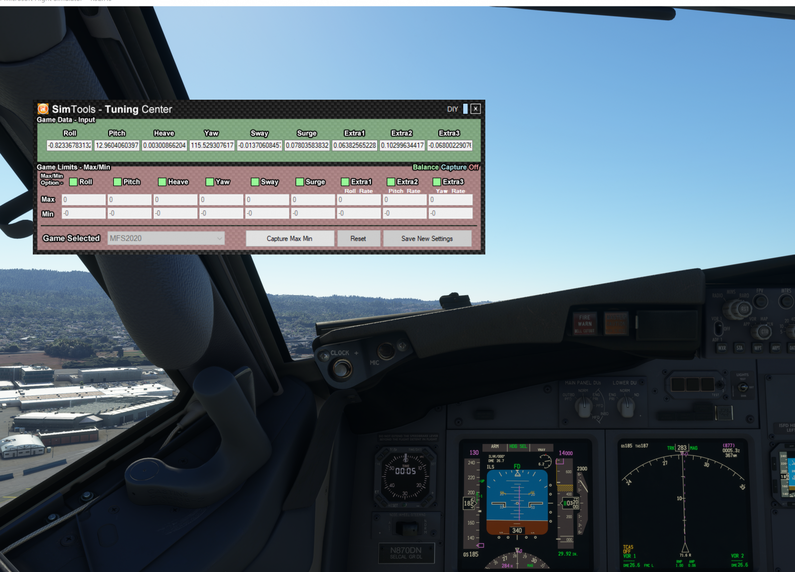

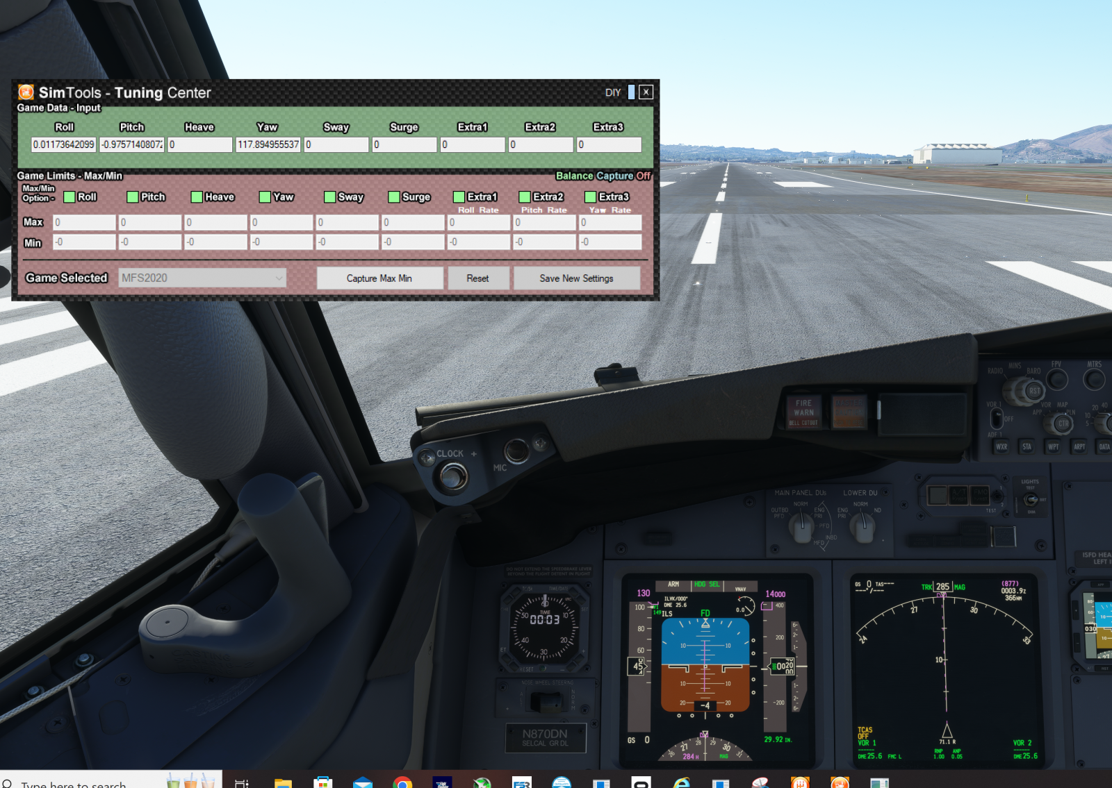

    With MSFS2020 if data is present it is likely a setting issues with respect to Axis Allocation, which can be larger for flight sims, and capturing then refining Tuning Center values. Again please post pictures of all settings.

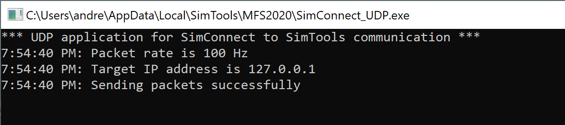

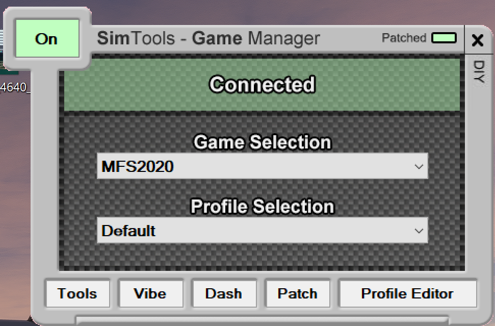

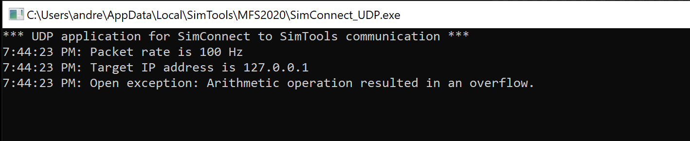

    Ok Here are my settings for MS2020. Sorry I don't understand why to me everything look good but no servo movement. Thank you.
    Capture.PNG Capture2.PNG error.PNG Game engine.PNG Game manager.PNG simconnect.PNG Capture.PNG Capture2.PNG error.PNG Game engine.PNG Game manager.PNG simconnect.PNG Capture2.PNG error.PNG Game engine.PNG Game manager.PNG simconnect.PNG
  13. yobuddy
    5,384
    50,381Coins
    +5,154 / 18 / -0
    Looks like you need to Capture Max/Min values is all.
    Click "Capture Max Min" and fly around a bit, you will see number getting captured, then click Save New Settings. That should get you going buddy.

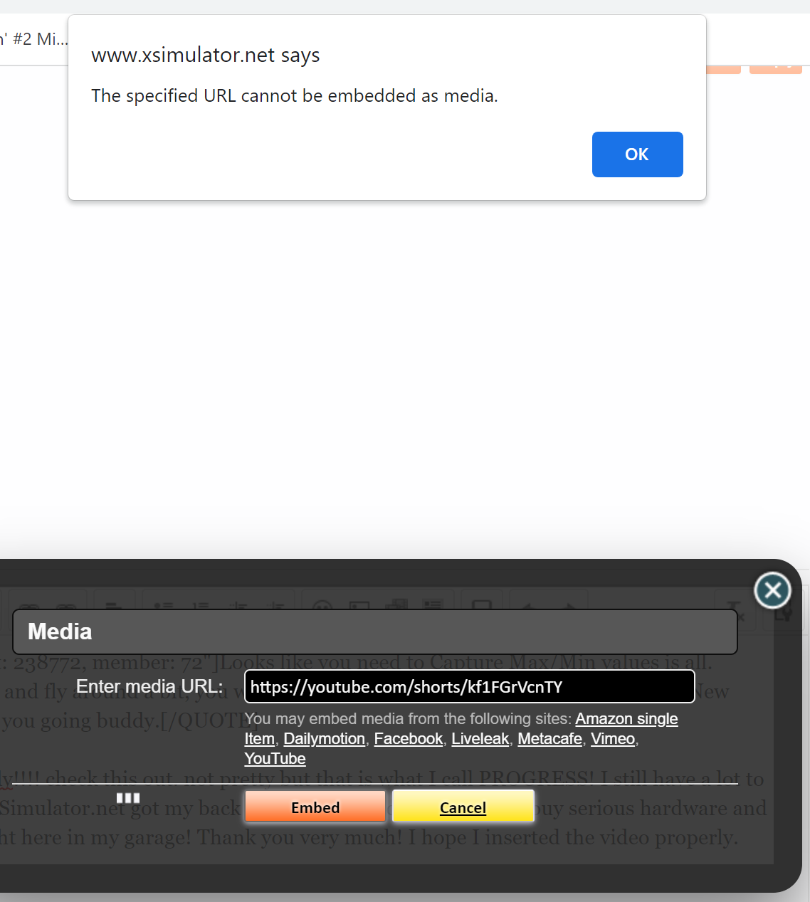

    hummmmmmm. I tried to embed the video from youtube but I get this error. What am I doing wrong?

    You can't use a 'short' YouTube url, you need to insert a main page YouTube url.

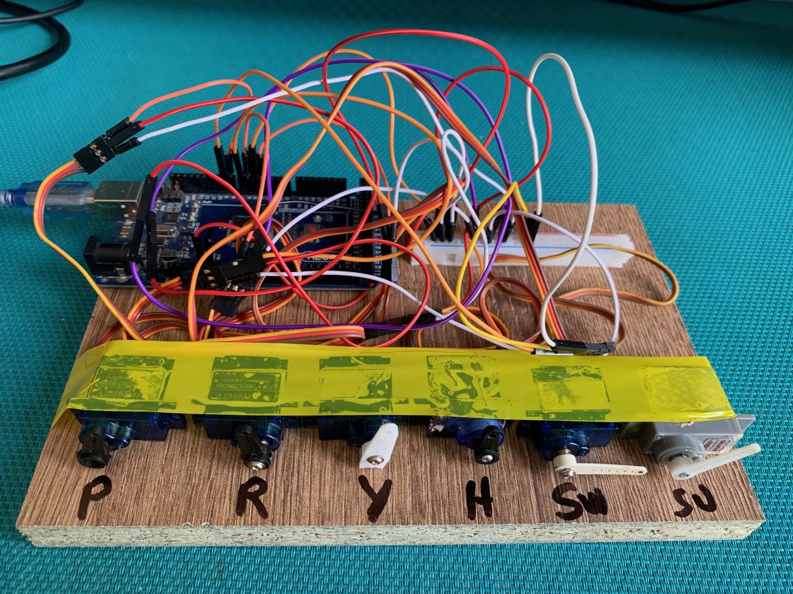

    Hi guys, ok. I am expanding! lol. Thank you for the great links. using the guidance provided I am trying to get th 6 servos wotking. First working with Output testing before attemting the game.
    All servos connected 4 to 9. I use the code MM_stewart_test4.zip that seems to be ready for 6 servos.
    The full output sequence is:
    A<Axis1a>~B<Axis2a>~C<Axis3a>~D<Axis4a>~E<Axis5a>~F<Axis6a>~
    Sorry for the wire mess. I usually build very clean but this is just a quick proof of concept. Attached are pictures of my settings. Can you see what I am missing? Why under output testing nothing move?
