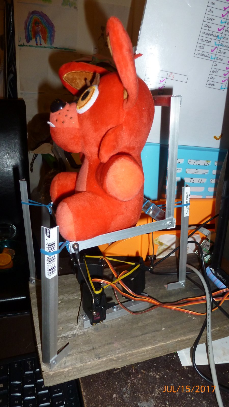

    Here is my first concept model. Made on a shoe-string budget, so it's a bit rough and looks ridiculous - but I'm happy with it! My daughter volunteered Foxy to be the test pilot.
    P1070041.JPG I have used a Raspberry Pi running a simple python script to interface with the GameEngine via LAN. The PWM for the servos is provided by an Adafruit PCA9685.
    Here is a video of Foxy's first test drive.
    and a closer looks at the servos in action:
    The reason I have used a Raspberry Pi is simple because I had one sitting around gathering dust. I used the network to interface it because this was the easiest way to achieve this with the Pi, since they don't have a serial port as such. The Adafruit PCA9685 is a 16 channel PWM controller - primarily designed for controlling LEDs. It does the job for RC servos although the movement resolution is not great.
    To explain breifly for anyone wondering - the PCA9685 has a 12-bit timebase, so each PWM cycle is divided into 4096 'steps'. The RC servos require a 50Hz PWM signal, which is 20ms per cycle. (So each 20ms is divided into 4096 steps). The normal range of motion on these servos requires a pulse between approx. 1ms - 2ms. So there is only about 1ms difference in the pulse length between one end of movement to the other. We are only using about 1/20th of the 4096 steps. This equates to around 200 steps for a 90 degree movement - which is not too bad I guess. In practice most servos can move somewhat beyond this - and also can run a slightly higher frequency which helps too.
    I chose to use Python for scripting the software, although this was not my first choice. I only chose this because there was a ready made Adafruit library for interfacing the PCA9685. I was concerned that there may be some lag doing it this way - but it seems ok.

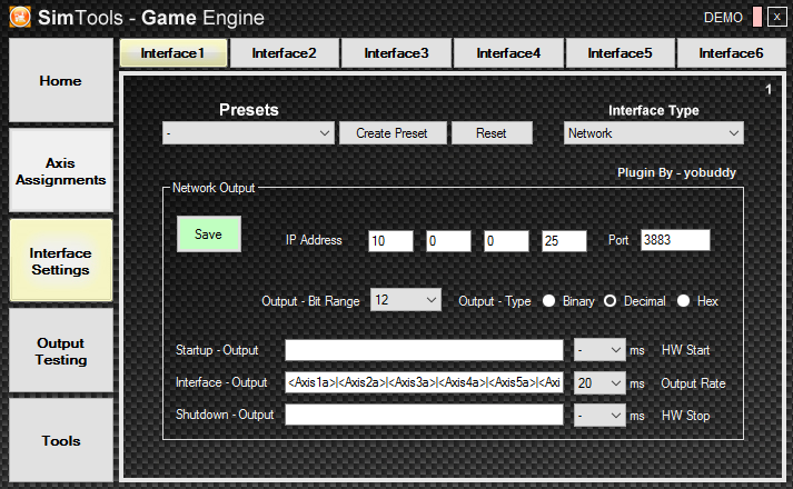

    @Mmcool here is the script. You will also need to enable I2C (can do this with raspi-config on Raspbian) for the PCA9685. A quick google will show you how this is connected to the GPIO header.
    The Adafruit library for this is on GitHub - see comments in code.

    The GameEngine settings I used... (note: yaw is not used)
    Axis settings:
    Interface settings:

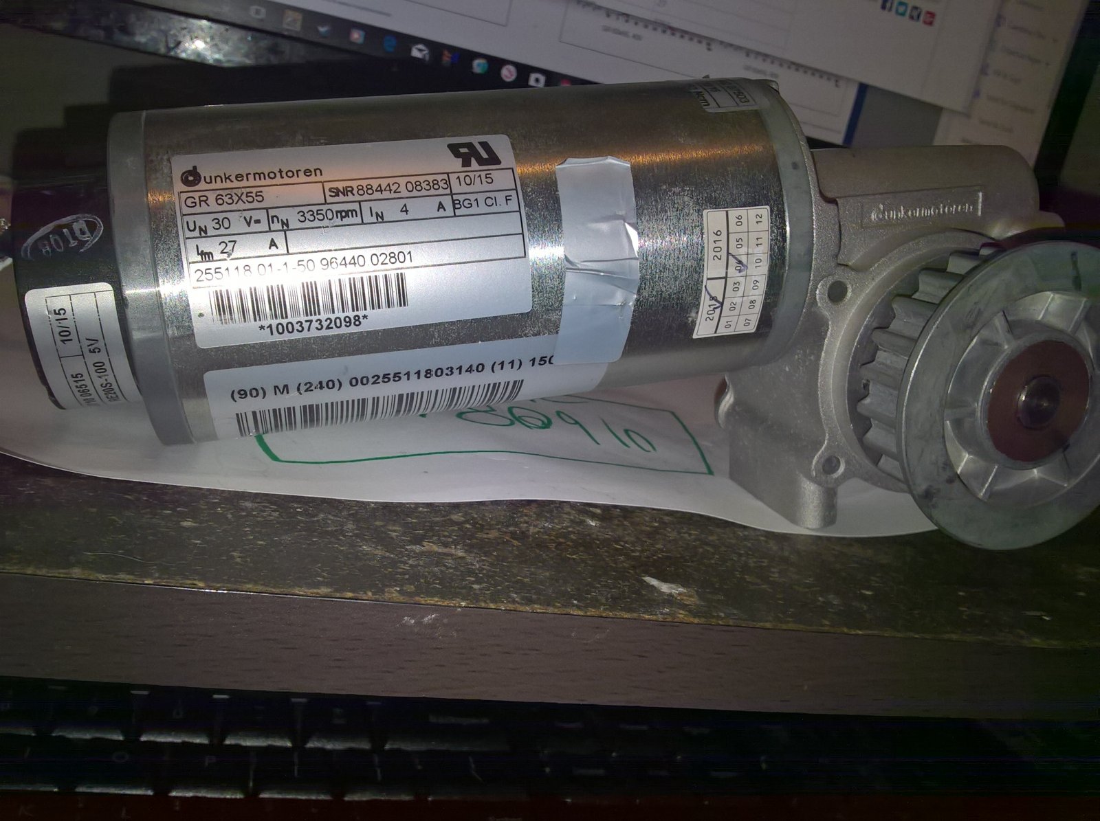

    Just scored some nice geared motors, so the next phase can begin. Apparently they are off some kind of garage door opener. 300W peak and 100W nominal @24V and a 15:1 gearbox. They also have a nice 100 step optical rotary encoder already fitted. They might run a little fast to attach the servo arm directly to the motor, but I'm thinking with the drive belt cog that's already there I might be able to run a belt to another bigger cog to give it more reduction. WP_20171023_19_08_36_Pro.jpg

    What type of cnc actuator is that ? Are they expensive ?
