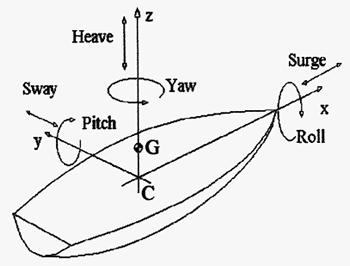

Nomenclature of movements in SimTools by @value1:
http://www.xsimulator.net/community...r-simtools-api-documentation.4612/#post-44027
Pitch is the tilt of the car forwards or backwards in [°]
Roll is how much the car is dipped to the left or right in [°]
Yaw is the heading of the car (north, east, south, west) in [°]
Surge means the acceleration of the car in longitudinal direction [g]
Sway means the acceleration of the car in lateral direction [g]
Heave means the acceleration up and down [g]

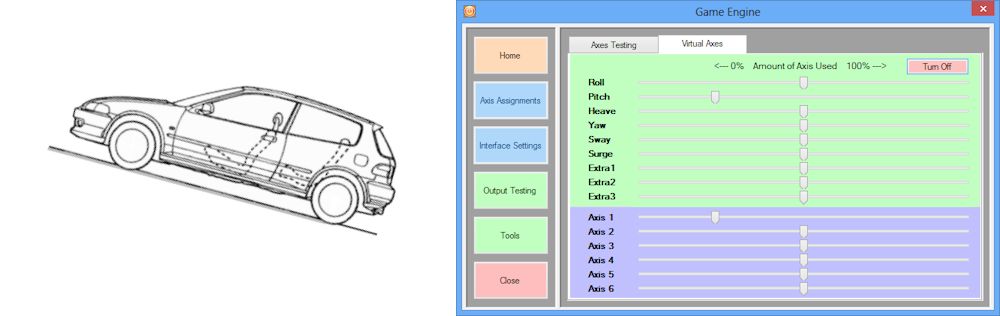

Direction of movements in SimTools

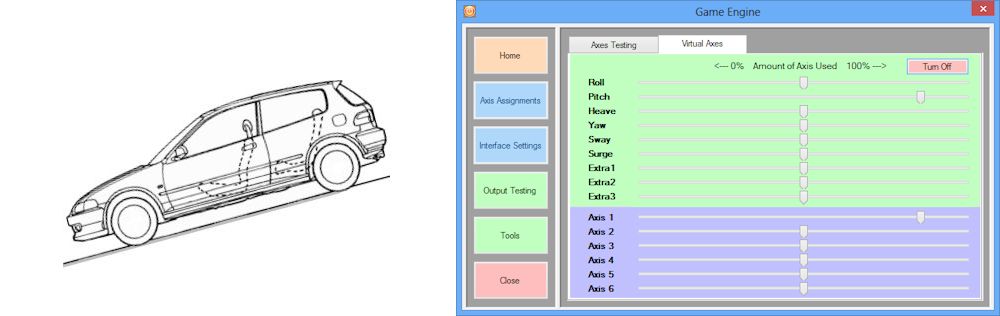

Acceleration → pitch slider moves to left, surge slider moves to right
Deceleration (braking) → pitch slider moves to right, surge slider moves to left

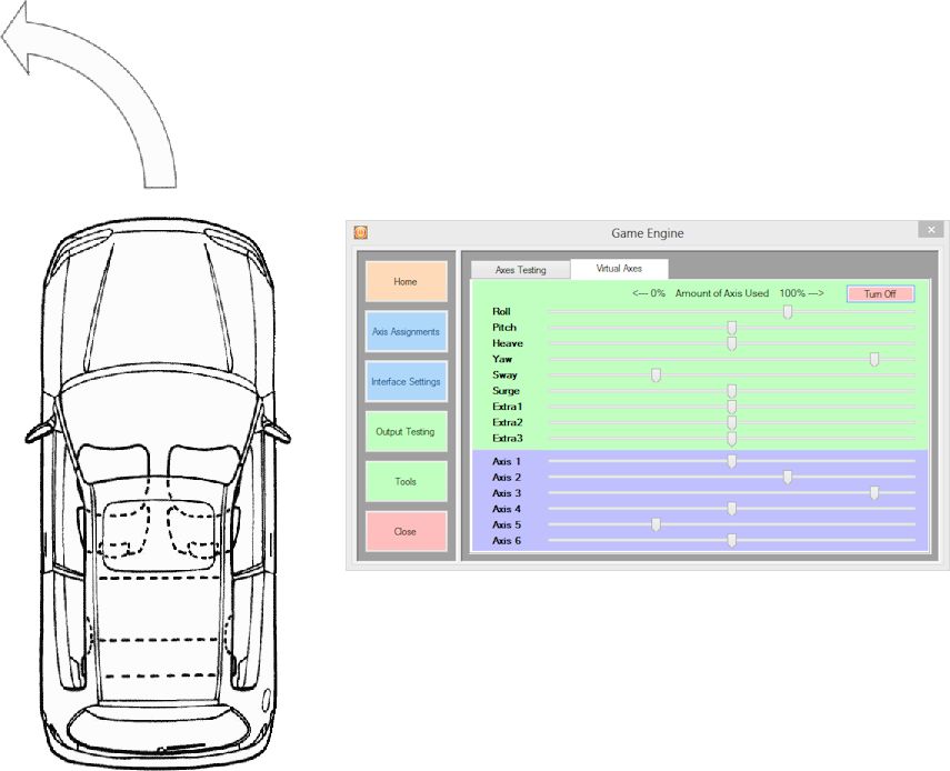

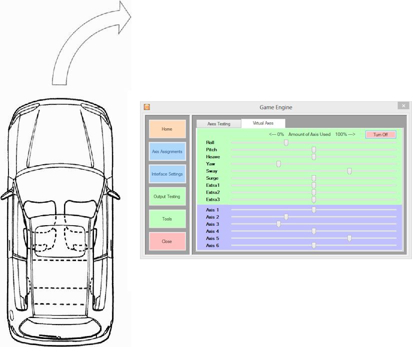

Right turn → roll slider moves to left, sway slider moves to right, yaw slider moves to left
Left turn → roll slider moves to right, sway slider moves to left, yaw slider moves to right
Driving downhill → pitch slider moves to right
Driving uphill → pitch slider moves to left

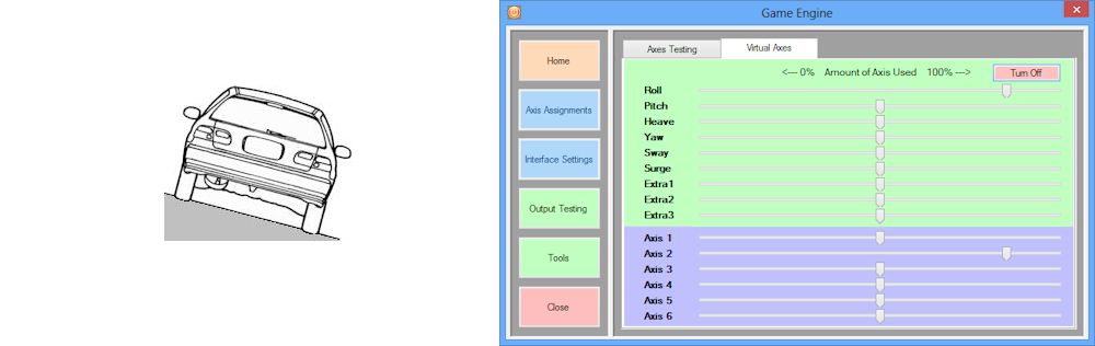

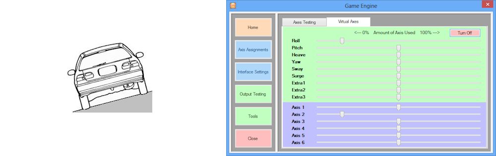

Tilted to the left → roll slider moves to left
Tilted to the right → roll slider moves to right
