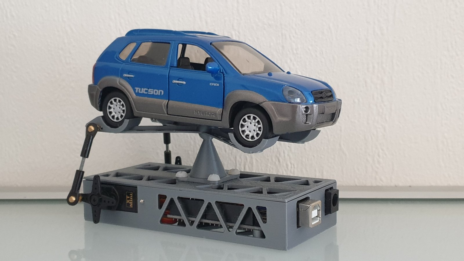

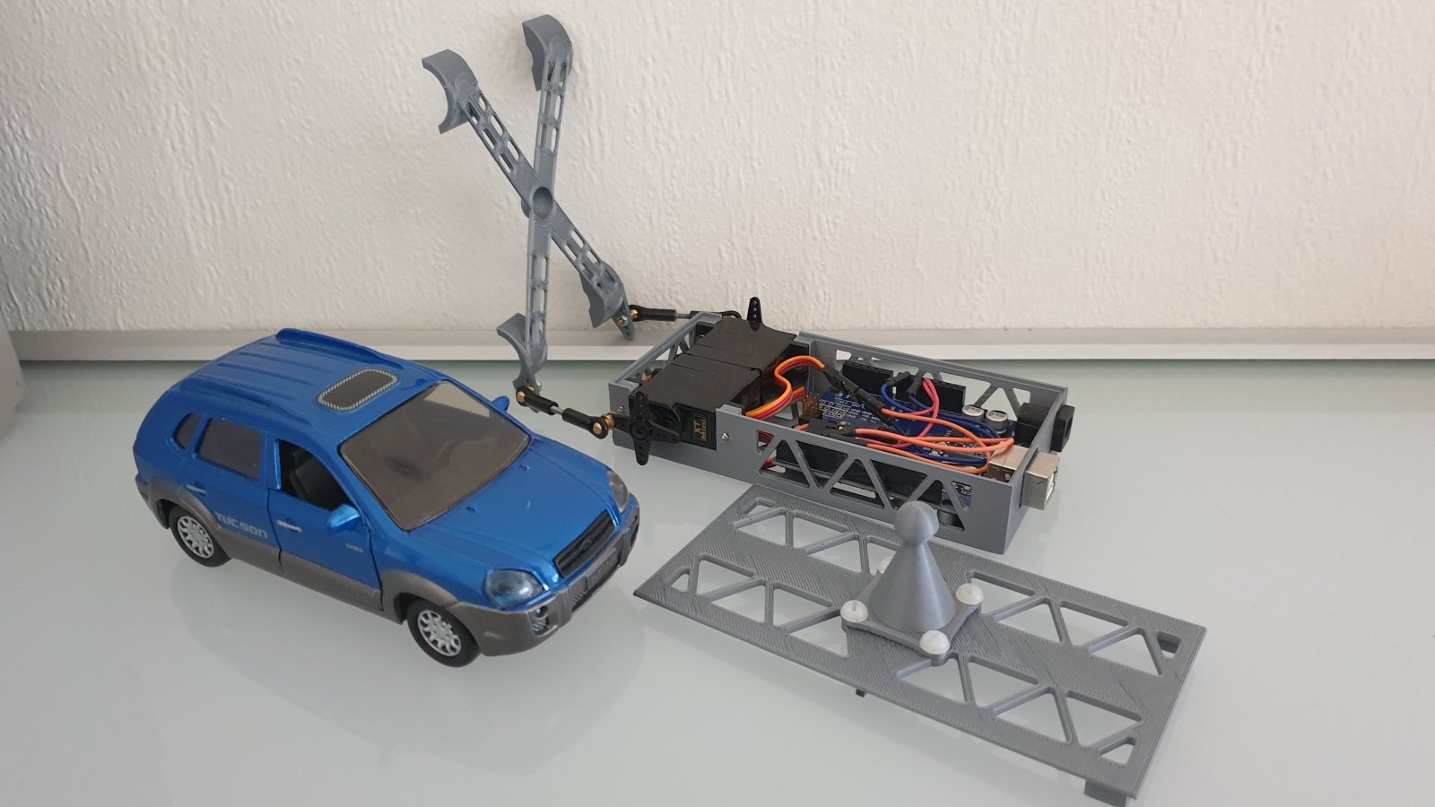

    Hello everybody.
    My name is Håkan and I am a total beginner in building my own DIY simulator. I apologize if my English is not good but I hope you all can still understand what I am writing. I ask all of you who may answer that you use simple language and simple terms so that I have a chance to understand what you mean. I learn all the time ...
    I have managed to build a small 2DOF RC car simulator with the help of what I managed to read here and there on this forum. I enclose a picture of it and it works quite well. Have tested it on LFS and link is here:
    [​IMG][​IMG]

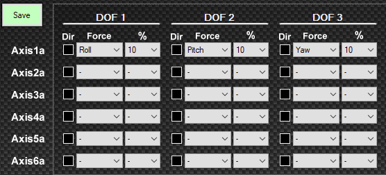

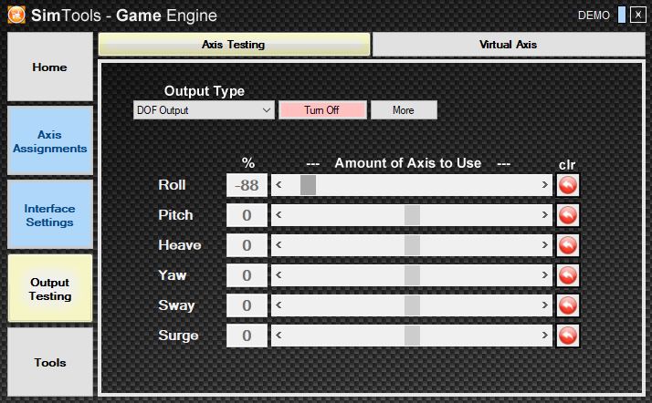

    I mainly have two problems that I do not understand.
    1. If in "Axis Assignments" I have a value higher than 20%, the servo jerks sharply when I in "Output Testing" pull the slider to a low value (to the left side of slider). The higher the%, the earlier the jerk comes.
    For example. if I set Axis1a to 22%, the jerk comes at -88% slider value. If I instead set Axis1a to 40%, the jerk will already be at -55% slider value. Positive values are not a problem. This phenomenon applies to all 6 axes, Axis1a to Axis6a.
    Why can I not enter a value higher than 20% without getting these twitches? The higher the percentage, the earlier the twitches come. With a low percentage, I also get a much smaller movement on the servo arm than the servo can handle and a simulator that moves much less than I want.

    Thank's for the reply.
    I have read the manual v. 2.5 from top to bottom, over and over again, and tried most things but still can not understand my problem. That's why I'm asking for help here.
    If this is the case that the servos are downward in each DOF and not horizontal as I thought then how come the following?
    This setting of forces only gives movement on servo one when I move the sliders for Roll, Pitch and Yaw:
    This setting of forces instead gives movement on servos one, two and three when I move the sliders for related force Roll, Pitch and Yaw:
    I thought that Axis1a corresponds to servo one, Axis2a corresponds to servo two and so on. Is that completely wrong?

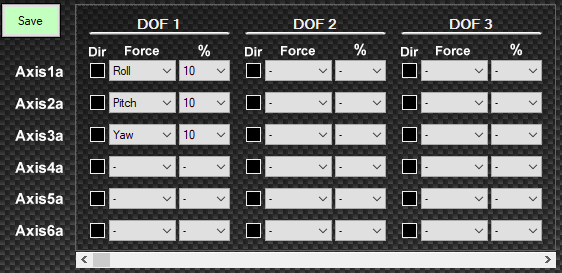

    You need to repeat this format 6 times so each servo axis (Axis 1a, Axis 2a, Axis 3a, Axis 4a, Axis 5a, Axis 6a) is configured:
  6. Kahala
    Kahala New Member Gold Contributor
    Jan 28, 2021
    9
    18Coins
    Ok, got it! It's completed now.
    But jerks, the wrong neutral position and less than 20% value remains. What to do about that?

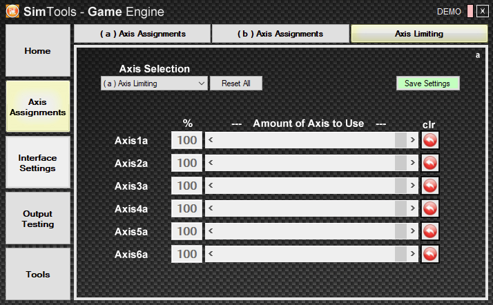

  8. Kahala
    Jan 28, 2021
    9
    18Coins
    Axis Assignments:
    Axis1a: Roll +10 / Pitch +15 / Heave -15 / Yaw -15 / Sway -15 / Surge +15
    Axis2a: Roll -15 / Pitch 0 / Heave +15 / Yaw -15 / Sway 0 / Surge +15
    Axis3a: Roll +10 / Pitch -15 / Heave -15 / Yaw -15 / Sway -15 / Surge +15
    Axis4a: Roll +10 / Pitch +15 / Heave +15 / Yaw -15 / Sway -15 / Surge -15
    Axis5a: Roll -15 / Pitch 0 / Heave -15 / Yaw -15 / Sway 0 / Surge -15
    Axis6a: Roll +10 / Pitch +15 / Heave +15 / Yaw -15 / Sway -15 / Surge -15
    Interface Settings:
    Serial / COM20 / 9600 BPS / 8 DB / None P / 1 SB / 10 O-BR / Decimal O-Type
    Startup - Output: [A<128>][B<128>][C<128>][D<128>][E<128>][F<128>] 10ms
    Interface - Output: [A<Axis1a>][B<Axis2a>][C<Axis3a>][D<Axis4a>][E<Axis5a>][F<Axis6a>] 10ms
    Shutdown - Output: [A<128>][B<128>][C<128>][D<128>][E<128>][F<128>] 10ms
    Axis Limiting:
    100% for all axis
    20,520
    144,950Coins
    +10,770 / 52 / -2
    Can you please post pictures of ALL of your current settings.

  12. Kahala
    Jan 28, 2021
    9
    18Coins
    Thank's noorbeast for your efforts to help!
    If I change the Bit Range to 8, absolutely nothing happens when I test if it works in the Output Testing window.
    It also does not matter if I write,
    [A <Axis1a>] [B <Axis2a>]. . .
    or
    A <Axis1a> ~ B <Axis2a> ~. . .
    But by changing Startup - Output to:
    A<128>~B<128>~C<128>~D<128>~E<128>~F<128>~
    The wrong neutral position is gone. But unfortunately the jerks at high or low % amount still remains when output testing.
  13. noorbeast
    20,520
    144,950Coins
    +10,770 / 52 / -2
    Do not add additional spaces like you have here: A <Axis1a> ~ B <Axis2a> ~
    There should be no spaces: A<Axis1a>~B<Axis2a>~C<Axis3a>~D<Axis4a>~E<Axis5a>~F<Axis6a>~
  14. Kahala
    Jan 28, 2021
    9
    18Coins
    I have no extra spaces, must have happened when I copied and pasted the text from simtool to here.
    Sorry for that.
