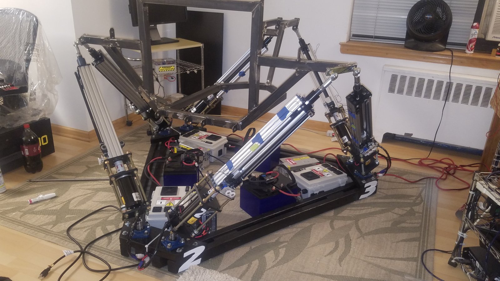

  2. hannibal
    hannibal Active Member
    Sep 29, 2018
    677
    4,492Coins
    +298 / 4 / -0
    looking like something..
    • Like Like x 5
  3. SilentChill
    2,645
    20,604Coins
    +3,570 / 34 / -0
    Awesome dude !! Well done, your so nearly there :) not quite as long as Pierre took either :D

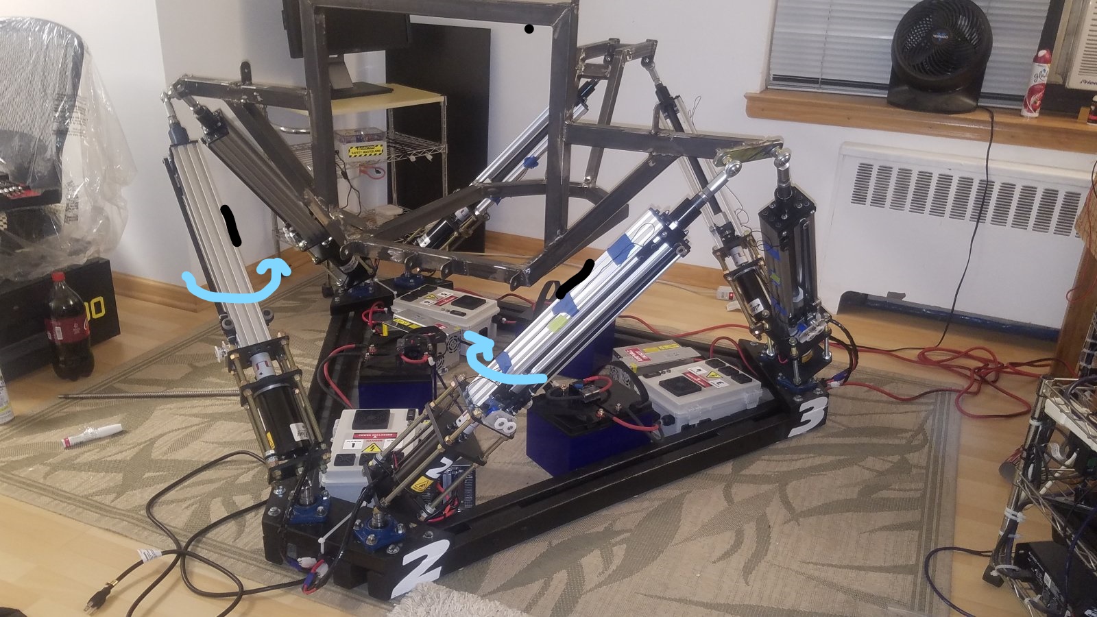

  6. Flymen
    May 19, 2018
    353
    Montreal, Canada
    2,491Coins
    +195 / 2 / -0
    DC motor, 6DOF
    Like the pic , if not your support pedal will hit where are the black line , 15-30 degree are the rotation of actuator 1 and 2 like the blue arrows.
    the pedal support depend how you like your position of your legs …. straight or no ,, depend if your seat is hight . but lower support dont help to hit your actuator 1 and 2 .

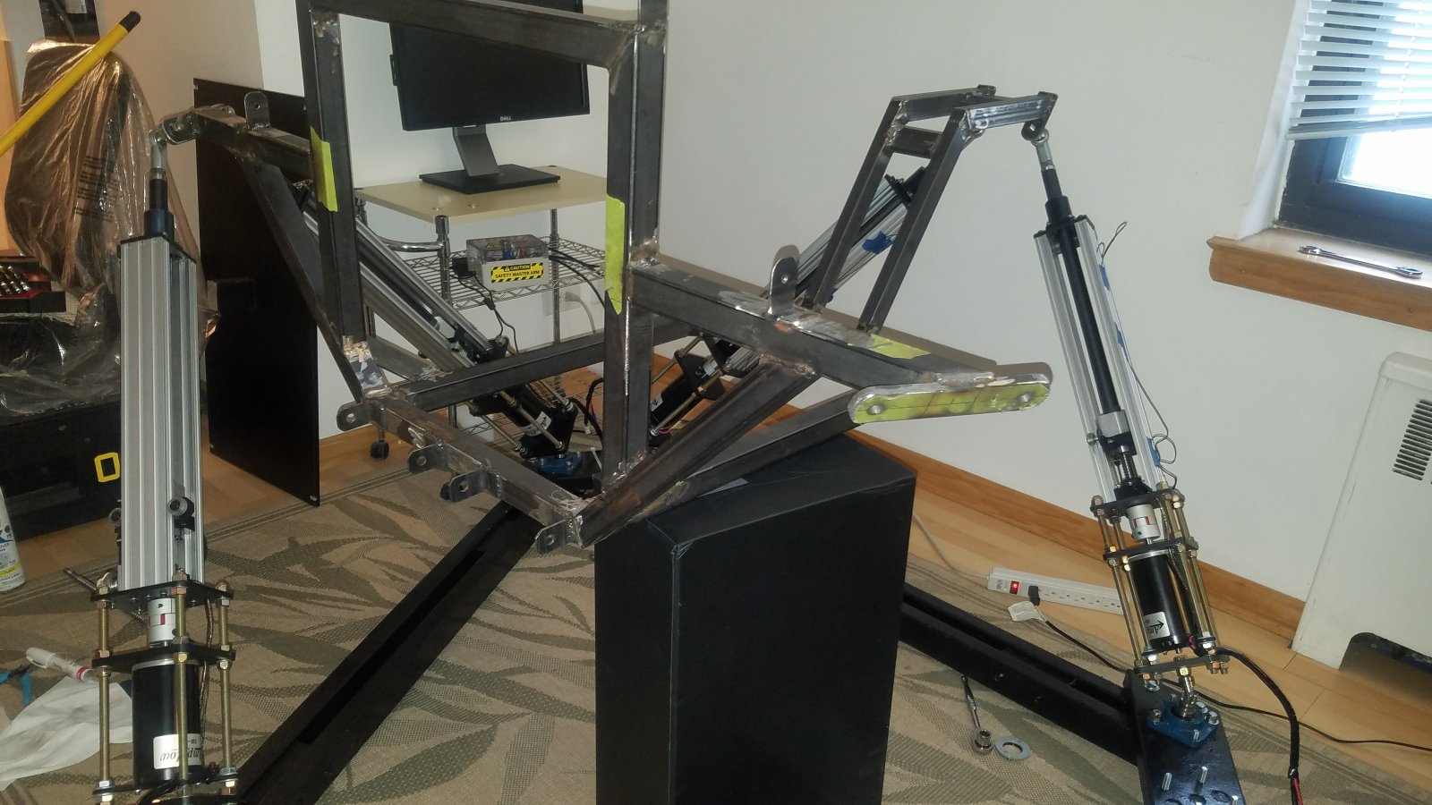

  16. PeterW
    PeterW alias Wickie
    Oct 21, 2018
    230
    Dipl. Ing. Mb (FH)
    1,767Coins
    +428 / 3 / -0
    Hi Hanibal
    I wanted to say congratulate to your successful running the 6DOF !!! Isnt I a great feeling after so much work?
    I also love your welded upper frame. It looks super strong, but not too heavy. Are you confident with the dimensions of your steel tubes? (I think they are 1 1/2", so aprox 40x40mm?).
    My second question: I saw you also use car batteries on your rig. How did you connect them with the power suply? parallel? Diodes? How would you rate your solution after the first tests?
    I am asking this, because I am a step before making final decisions regarding my new battery-PSU-solution and also welding the upper frame....
    Thanks a lot!!!
    Wickie
  17. hannibal
    Sep 29, 2018
    677
    4,492Coins
    +298 / 4 / -0
    thank you @PeterW
    yes, it is definitely a great feeling.
    for your first question, so far i feel good about the construction.
    i used steel tubes 1-1/2" x 1-1/2". mostly 14 guage, though at first i was going to go for 11 guage (1/8") but felt it could have been heavy at the time. looking back, i think it would have been OK to go with 11 guage. but i am happy with results of the construction. how it performs is another story since i have yet put all the accessories, seat etc. will get back to you on that.
    second: i used mighty max 35Ah batteries (6x) and LED power supplies @24V. for the most part i followed @SixDegreesOfFlight 's circuit design, and because i used sabertooth 2x60, the batteries were required as per manufacturer of the sabertooth. i even emailed dimenson engineering if i can decrease the number of batteries since i was using LED P/S in parallel, but said the sabertooth should have 35Ah..
    i used pretty much all the components that @SixDegreesOfFlight but added a delay circuit for the arduino since you the sabertooth has to be on first before arduino to establish serial communications. wiring pretty block diagram here in video
    tests are going well, just configuring requires research to get the 6dof to work as expected.
    i jumped on the 6dof on one test with nolimits2, it was jarring, but solid. (have to tweak the smoothness of movements)
    At this point in time, im just trying to get telemetry from my perferred games, dirty rally 1 plugin seems to be broke at this time, and i have to better configure nolimits2, the motion behavior is not like what it should be in game.
    i will say that power i solid, and frame seems to be solid at this time...
    hope this helps!
