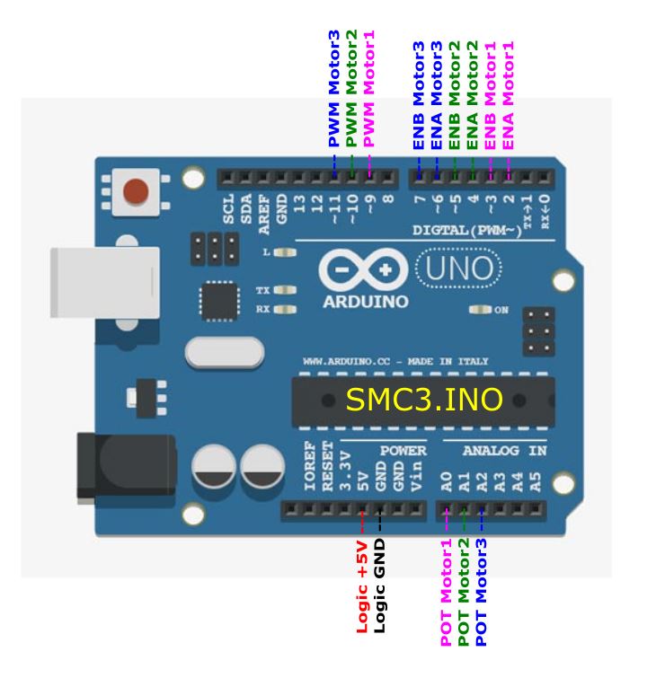

    SMC3
    The SMC3 is a "Simulator Motor Controller for 3 Motors" written for the Arduino UNO R3. At the time of writing this it has not been tested on any other Arduino model. The SMC3 uses a PID motor control loop. The PID algorithm has been optimised for this application and achieves 4096 PID updates per second for all three motors giving smooth precise motor control with well tuned parameters. Some characteristics of the controller:
    • Designed specifically for use with Simtools motion control software
    • Controls the position of upto three motors using analogue feedback
    • Hard (reverse) braking if motors move beyond defined limits
    • 10bit accuracy (1024 steps) for both "target" position commands and position "feedback"
    • Extensive command set to setup and monitor the parameters for each motor
    • A second serial port for (optional) real time "live" monitoring/configuration
    • 4096 PID calculation updates per second for each motor
    • Companion windows software to configure and monitor the SMC3
    There are currently two MODES of operation that are configured by a single line of code at compile time before uploading to the Arduino.

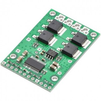

    MODE1: Supports the more common H-Bridges used in the forums. This mode has a PWM output pin plus two Motor Direction output pins. Examples include the MonsterMoto shield.
    REFER TO POST #3 BELOW IF YOU NEED MORE POWER
    MODE2: Designed for H-Bridges that require direct drive of Highside and Lowside switch inputs. In this mode one switch is driven as a direction pin and the other with the PWM output however the PWM duty needs to be inverted whenever the motor changes direction with the direction pin. (An alternate approach would be to switch the PWM between inputs as direction changes) An example H-Bridge that uses this mode is the cheap 43A IBT-2 found on ebay.
    Software Setup
    As the SMC3 is an Arduino motor controller the first thing you need to do is get the software onto your "Arduino UNO R3".
    1. Download the SMC3 software attached to this post (SMC3.ino)
    2. Get the Arduino IDE tools installed on your computer if you don't already have them. Follow the Arduino Getting Started guide found here: http://arduino.cc/en/Guide/Windows (Note the step for installing the drivers!)
    3. Open the SMC3.ino with the Arduino IDE
    4. Edit the code at the top if the file to select the MODE you will be using
    5. Compile and Download the SMC3.ino program to your Arduino UNO R3
    If you want, you could now jump to the Windows SMC3 Configuration software and check communications before proceeding further. (Refer next post)
    Wiring Details

    //                  +-|PWR |--------------| USB  |-----+
    //                  | +----+              +------+    o|
    //                  |                                 o|
    //                  |                                 o|AREF
    //                  |                                 o|GND
    //                NC|o                                o|13    TTL (software) Serial
    //             IOREF|o  +----+                        o|12    TTL (software) Serial
    //             RESET|o  |    |                        o|11~  PWM Motor 3
    //              3.3V|o  |    |                        o|10~  PWM Motor 2
    //                5V|o  |    |    Arduino             o|9~    PWM Motor 1
    //               GND|o  |    |      UNO               o|8
    //               GND|o  |    |                         |
    //               VIN|o  |    |                        o|7      Motor 3 ENB
    //                  |   |    |                        o|6~    Motor 3 ENA
    //   Motor 1 Pot  A0|o  |    |                        o|5~    Motor 2 ENB
    //   Motor 2 Pot  A1|o  |    |                        o|4      Motor 2 ENA
    //   Motor 3 Pot  A2|o  |    |                        o|3~    Motor 1 ENB
    //                A3|o  |    |                        o|2      Motor 1 ENA
    //                A4|o  |    |                        o|1
    //                A5|o  +-/\-+                        o|0

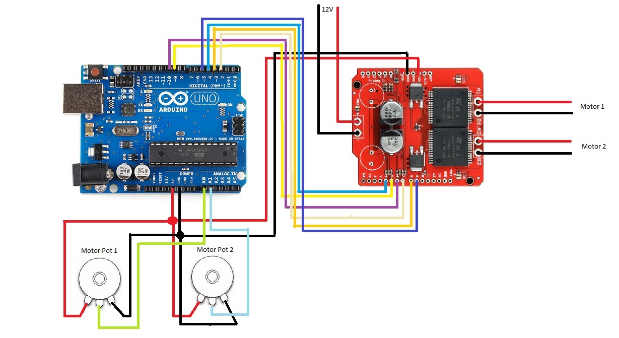

    MODE1:
    Example wiring details for Monster Motor Board (again thanks to @eaorobbie for drawing)

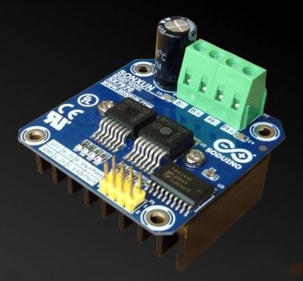

    Arduino to H-Bridge (Chinese 43A)
    ENA ----> IN1/RPWM
    ENB --+-> EN1/R_EN
    +-> EN2/L_EN (ie connect ENB to both R_EN and L_EN)
    PWM ----> IN2/L_PWM
    n.c. ----> IS1/R_IS
    n.c. ----> IS2/L_IS
    +5V ----> VCC
    GND ----> GND
    The image below shows wiring for two motors... Thanks to @eaorobbie for getting me started with the image :thumbs

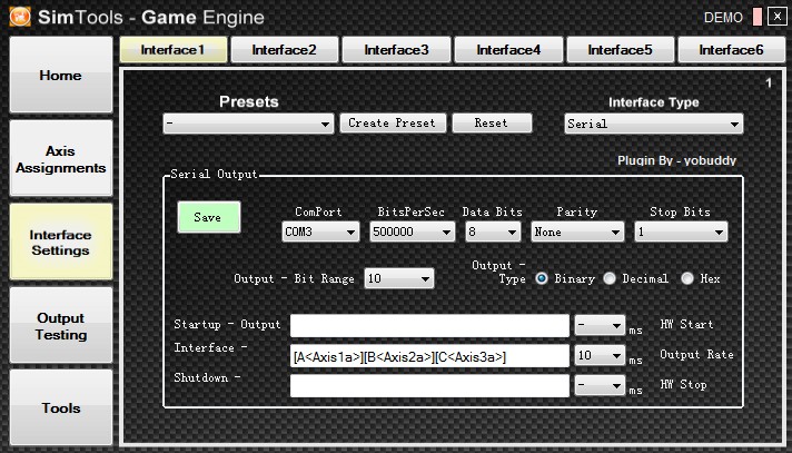

    Simtools Setup
    Setup for Simtools 2 is very straight forward:
    Interface Type - Serial
    ComPort = the Arduino ComPort, you can find it in Windows Device Manager.
    BitsPerSec - 500000
    Data Bits - 8
    Parity - None
    Stop Bit -1
    Output Bit Range - 10
    Output Type - Binary
    Interface Output - [A<Axis1a>][B<Axis2a>][C<Axis3a>]

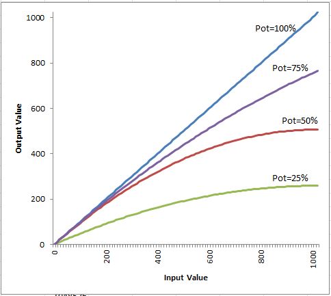

    • Added a POT scaling input that can be used to scale the motion output based on the POT position
    • POT scaling can be setup as one of two modes - Linear or non-linear
    • DO NOT ENABLE POT SCALING UNLESS POT ATTACHED TO ARDUINO
    • AN5 used for POT scaling input
    • The non linear scaling is designed to try and reduce the overall motion but maintain the "smaller" movements as best possible - ie road noise and stuff, but scale back on the huge side to side motion you get in higher power cars.

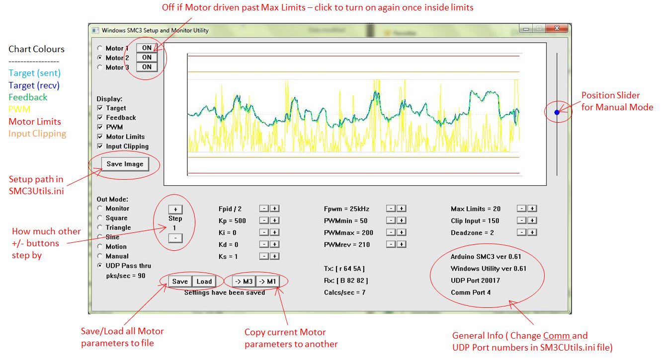

    SMC3 Windows Utilities
    *** NEW VERSION SMCUtils v1.01.zip AVAILABLE 29 Sep 15 ***
    Installation
    Simply unzip the SMC3Utils (attached) into a directory of your choice and run from there.
    Edit the SMCUtils.ini file with notepad or a text editor to setup your serial comm port used to connect to Arduino.

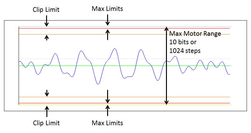

    Tuning Parameters
    OK, now that you know your motors aren’t going to race off in the wrong direction you can start tuning the parameters. Again this is done with the Windows SMC3 Utility software – so far we haven’t gone near any sim software! If you have experience tuning PID control loops then you can probably jump in and setup to your liking, however it would be worth scanning the following steps to get familiar with the clipping, limiting, and braking parameters
    Clip Input Used to create a band at either limit of the target range beyond which any values sent to the SMC3 are clipped. In addition to this clipping, if the motor feedback does move beyond this range (typically through inertia), the SMC3 will attempt to brake the motors hard by driving them in reverse until they are back out of this limit zone. The value can be anything from 0-255 (however can’t be less than the current limit setting). Reverse braking is applied in the band between the Clip Input and the Max Limit settings. Reverse braking can be disabled - refer to PWMrev.
    Max Limits Used to create a band at either limit of the feedback range beyond which if the motors move (typically through inertia) the SMC3 will automatically shutdown the drivers and keep them disabled until reset. This is essentially a safety mechanism if something goes wrong. The value can be between 0-255 (however can’t be greater than the current clip setting).
    Deadzone This creates a hysteresis zone for the motor feedback If you need values greater than 1, you probably have too much “slack” in your mechanical setup.
    Fpid / By default the PID loop performs 4000 calculation updates per second. This divider enables you to reduce the number of PID calculations per second by the divided amount. Sometimes this can help if the motor windings are producing audible noise. The approx number of calcs per second is displayed in the center bottom of the SMC3 Utils window. (This may jump around a bit as it is just an indicator)
    Kp The proportional term of the PID loop. Essentially the larger the value here the “harder” the SMC3 controller will try to drive the motor to bring it to its target position. It is scaled by the distance away the motor is from its current target position, again the further away the harder it is driven (within the constraints set by other parameters) This is typically the main tuning parameter and the greatest effect – this can even be used alone with Ki and Kd set to 0. The setting will be very dependent on the motors, H-bridges, and mechanical loads however values in the range 300 to 500 would not be uncommon with the SMC3. Allowed values range from 0-1000.
    Ki The integral term is useful to help get the steady state error closer to zero. Generally speaking for sim designs I have found that if you have large enough PWMmin and Kp values the need for Ki is reduced and it can often be set to 0. Too large a Ki can cause the position to overshoot and oscillate.
    Kd The derivative term is great for reducing overshoot on fast step changes in position... The negative effect is that it can slow down the movement particularly when the target undergoes a step change.
    Ks This is a "smoothing" parameter for the Kd term. Essentially the Kd parameter is only computed when the loop counter matches this value. So a Ks of 5 means the Kd term will only be updated once every 5 times the other parameters are calculated.
    Fpwm The frequency of the selected Motor PWM. Note Motors 1 and 2 are tied together and will always have the same PWM frequency and have more selection options than Motor 3. This is a limitation of the microprocessor used on the Arduino Uno.
    PWMmin This is the minimum duty cycle that is used to drive the motors to their target position. For example if the motors are already close to target they will not need to be driven as hard as if they are a long way from target (or they may overshoot and oscillate). The reason we don’t just use 0 is that due to friction, loads, and other factors, the motors will need a certain minimum current just to get them moving. This helps us set that minimum. Settings are in the range 0-255 (which are mapped to the range of 0-100% duty cycle) however cannot be greater than PWMmax setting.
    PWMmax This is the maximum duty cycle that is used to drive the motors to their target position. As the target position gets further away from the actual position the control loop attempts to increase the motor drive (PWM) to get it to the target position. It will increase the PWM until it reaches PWMmax.
    PWMrev This is the PWM duty cycle that is used to drive the motors in reverse (hard brake) if they enter the limit zone. Higher values here will brake the motor harder but will draw more current and heat the H-Bridge more. It may also cause an abrupt jolt in your sim as it tries to change direction. Setting this to a similar value as PWMmax would make sense. If you want to disable the revers braking then simply set this value to 0 and the position will be driven by the normal PID algorithm. Settings are in the range 0-255 which are mapped to the range of 0-100% duty cycle.

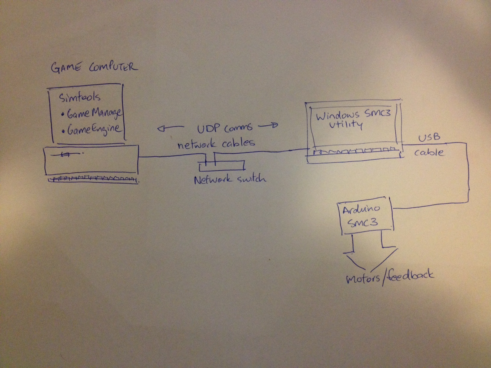

    Connecting to Simtools via UDP
    Simtools has the great ability to output the motion data over your network via UDP instead of (or as well as) sending data via a serial port. The Windows SMC3 Utility software now has the ability to receive this network UDP motion data from Simtools and pass it onto the Arduino SMC3. So why setup such a complicated arrangement? Well it’s not actually that complicated and it allows you to perform real time monitoring and setup of the controller while Simtools is running without the need for the second serial port hardware mentioned above. If this approach is used it is still recommended that a second computer be used to run the Windows SMC3 Utility software (especially if you are just starting out with Sim software).

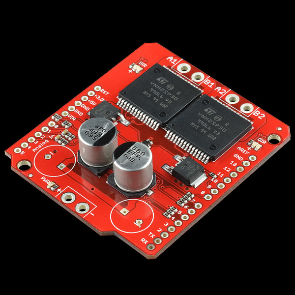

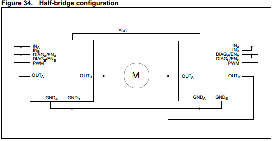

    WANT MORE POWER??
    Thanks to @Pit's experiments he has worked out how two connect two Monster Moto output drivers together to drive a single motor using SMC3, thus increasing the available power available to drive the motor.
    His full thread and discussion can be found here: http://www.xsimulator.net/community...cts-as-a-single-motor-driver-more-power.5482/
    And the main post has been included below for convenience to get you started.
    The Monster Moto (MM) from Sparkfun or dx.com (Hummer Driver) uses the VNH2SP30-E motor driver, these bridges will be used as a high power full (double) bridge driver normally. If someone is using strong motors like winches (as the mines) you need more powerful h-bridges: The VNH2SP30 can be used as a half-bridge. The famous jrks12v12s works great but are expensive (~100$ one sample). The Monster Motos are cheap (one bridge about 17$ at Aliexpress.com) and easy to use with an Arduino as a controller (17$).
    The VNH2SP30 has a maximum current rating of 30 A and a continuous current of 14 A. As a half bridge (using two VNH2SP30 for one motor) you "double" the power of your h-bridge. That means, if more "Ampere" is needed, the MM can handle it. "Volt" is being left unchanged.
    This tutorial is an addition to the SMC3 Arduino 3DOF Motor Driver and Windows Utilities code. Not tested but probably working the Arduino UNO/Duemilanove 2dof firmware (caution notice: different wirings to the Arduino needed!!).
    To get one Monster Moto working you have to wire the two boards described as follows:
    Remark: The wiring meets the specifications of the MM. This is important to prevent any short circuit.
    SMC3 code can access up to 3 motors using one Arduino. If you want to connect 3 MM please wire described as follows:
    Arduino -------- Monster Moto
    2 (Motor 1 H-Bridge ENA) ---------------7 and 8 (INA1 and INB1)
    3 (Motor 1 H-Bridge ENB)----------------4 and 9 (INA2 and INB2)
    9 (Motor 1 PWM) --------------------------5 and 6 (PWM1 and PWM2)
    Arduino -------- Monster Moto 2
    4 (Motor 2 H-Bridge ENA) ---------------7 and 8 (INA1 and INB1)
    5 (Motor 2 H-Bridge ENB)----------------4 and 9 (INA2 and INB2)
    10 (Motor 2 PWM) --------------------------5 and 6 (PWM1 and PWM2)
    Arduino -------- Monster Moto 3
    6 (Motor 1 H-Bridge ENA) ---------------7 and 8 (INA1 and INB1)
    7 (Motor 1 H-Bridge ENB)----------------4 and 9 (INA2 and INB2)
    11 (Motor 1 PWM) --------------------------5 and 6 (PWM1 and PWM2)
    The outputs:
    A1 and B1 will have the SAME polarity
    A2 and B2 will have the SAME polarity, too.

    I would use a cross-over cable rather than a network switch.
    you can put a second network card in the SimTools PC (if you still want internet from the first nic), and then use a cross-over cable between the SimTools and the SMC3 PC.
    (static network settings needed)
    This would give that fastest possible connection and may improve the output speed a bit.

    Good point... it is always worth highlighting the various options, different approaches may work better for various individuals. (I already have a 1Gbit network switch between computers so didn't even occur to me there maybe other possibilities).
    Note wireless could also be used. Probably the slowest overall but if that is all you have it would be worth doing some tests before committing loads on extra hardware.
    As the final link in the communications chain is serial running at 115200baud it will take 1.3ms to transfer 3 packets of data for all three motors and Simtools has a 1ms delay minimum between position commands. From experience the speed if this connection is not super critical. Trying to send data packets at a rate faster than this is unnecessary as the PID loop won't be getting any benefit from the extra data. What is more critical is the lag that is created from the game motion output to the sim movement. Of course minimising unnecessary delays in comms setups is always good practice though.

    I would use SMC3 in MODE1 which can drive the Pololu board in its "Sign-magnitude (drive-brake)" mode
    Connections would be:
    SMC3 <----> Pololu Board
    GND <----> GND
    PWM ----> PWM_H
    ENA ----> DIR
    ENB ----> not connected
    not connected ----> PWM_L
    It is always a good idea to first test using a cheap toy motor and a 1.5V battery (may need 6v lantern or 9v battery for this board to power the logic!) if you have them handy. (manually turn the feedback pot and the motor should speed up, slow down, and change direction as you adjust the pot around the target position.
    I note the board in question has no over temp or over current protection so be careful, and keep them cool. Start out using a PWMmax setting below 200 until you get things working well and see how hot everything gets.
