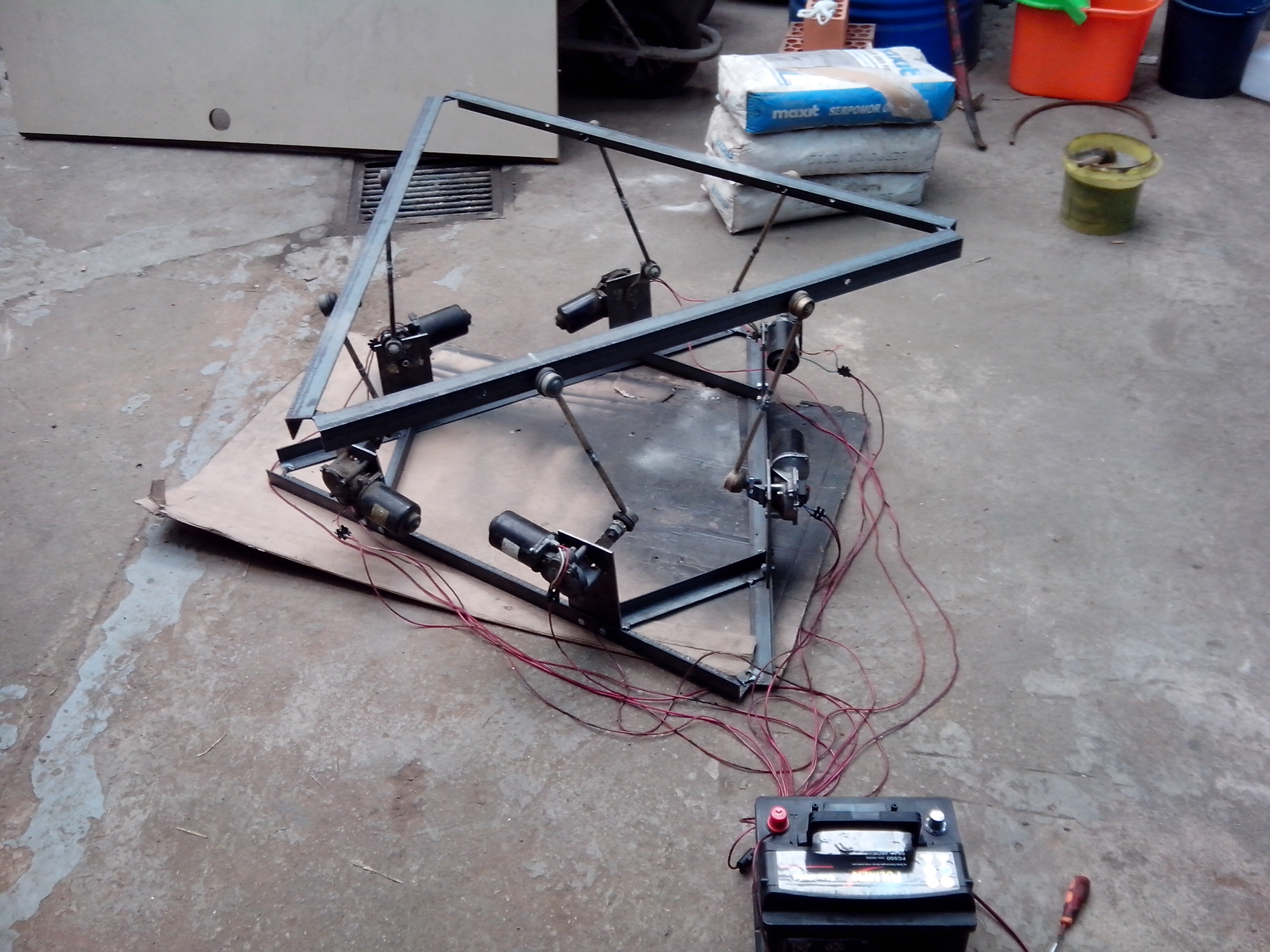

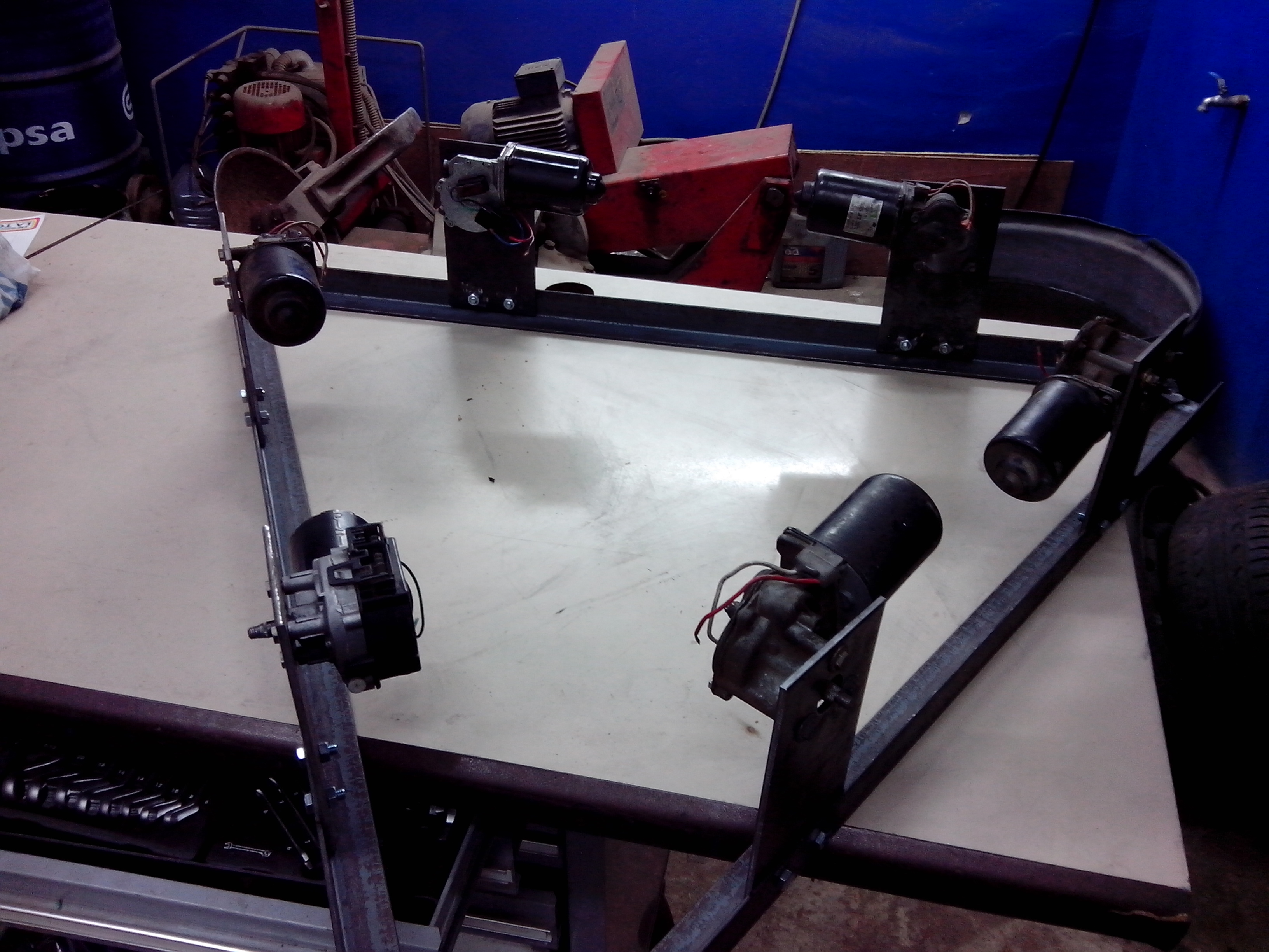

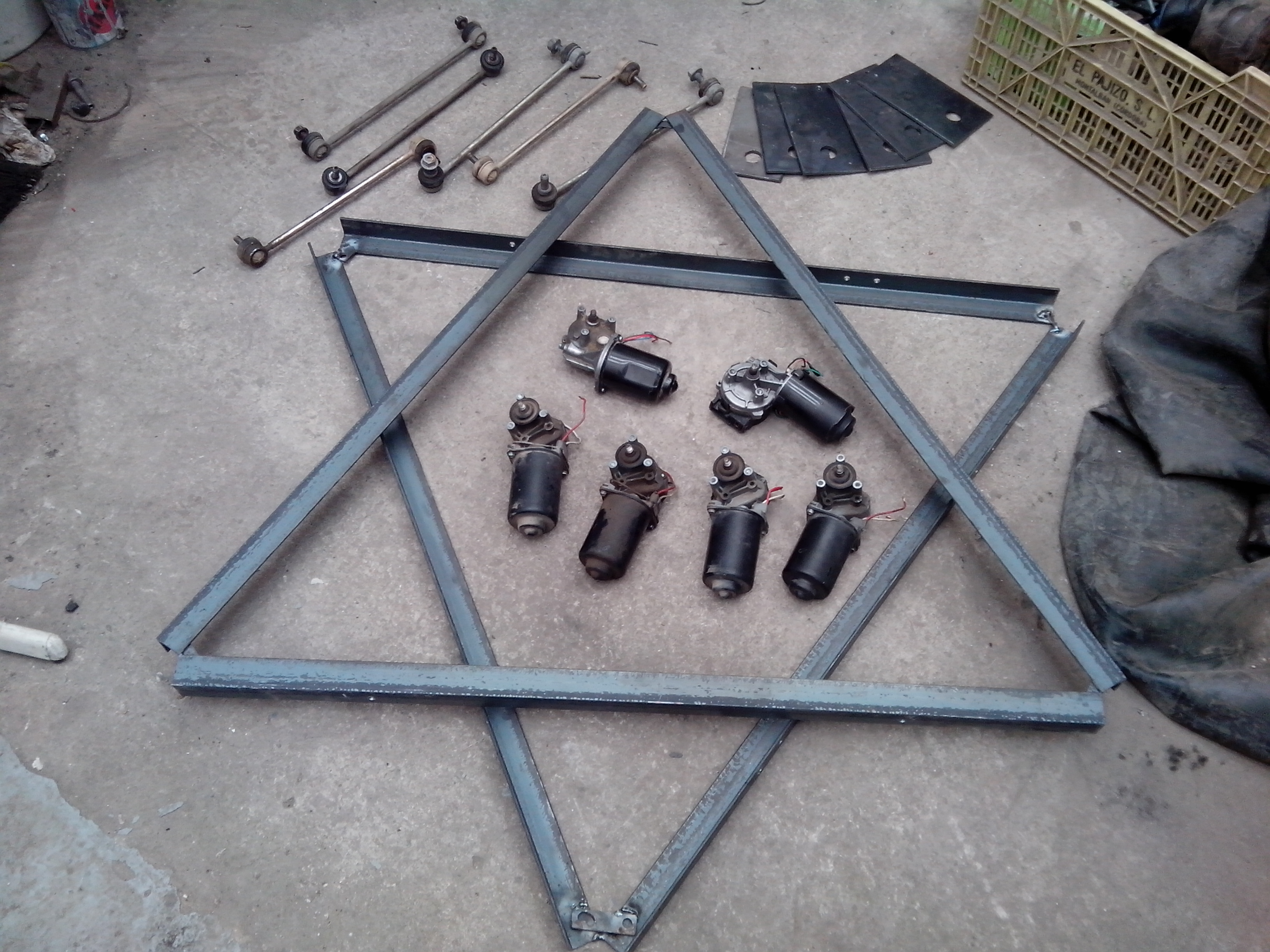

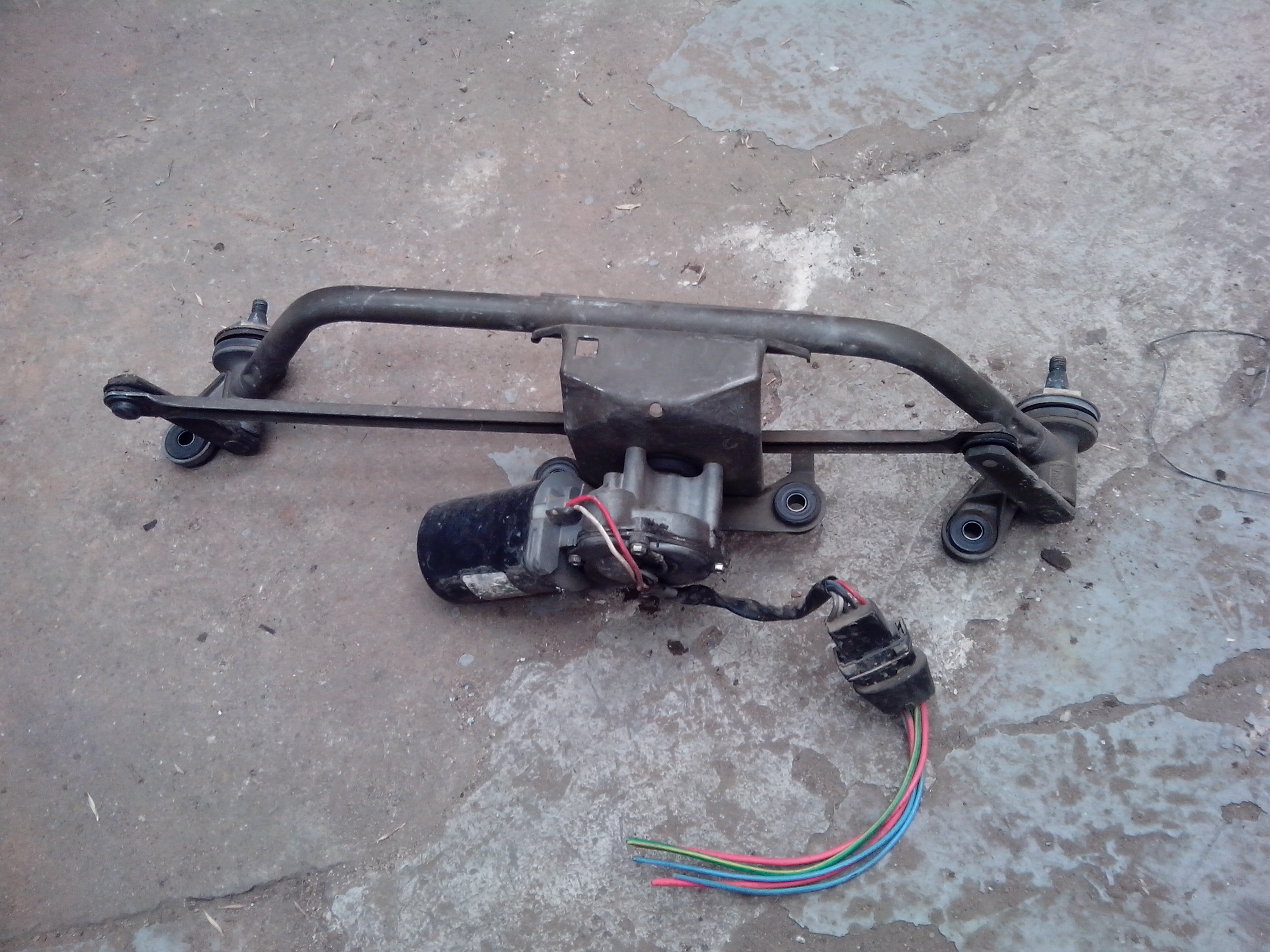

    A year ago or so I made a 2DOF simulator and then I added the loss of traction , and now wanted a new challenge, see the behavior of a 6DOF , but after reading and saw that he had read much spent a lot of money so I I been collecting recycled materials to prototype and the result is much better than expected.
    I used three Arduinos unoR3 and three monstermoto shield .
    6 wiper motors (not the 6 equal , there are 4 equal , and 2 different ) .
    Software XsimCtrl " Prilad " and SimTools .
    I want to thank all the community for all the selfless help and especially Prilad who offered me their help and Historiker for caring about my project and help me SimTools settings .
    I have to keep working on it because I think it can get better results with a little more angle effects but it'll take a while to restart the project , for now I'm very satisfied with the results .
    I hope that with this project is removed the idea that we must gastarle thousands and thousands of dollars to make a 6DOF because these engines are about 12v 50w , so putting them at 12v rather larger , or better 24v I would work well and fairly angle.

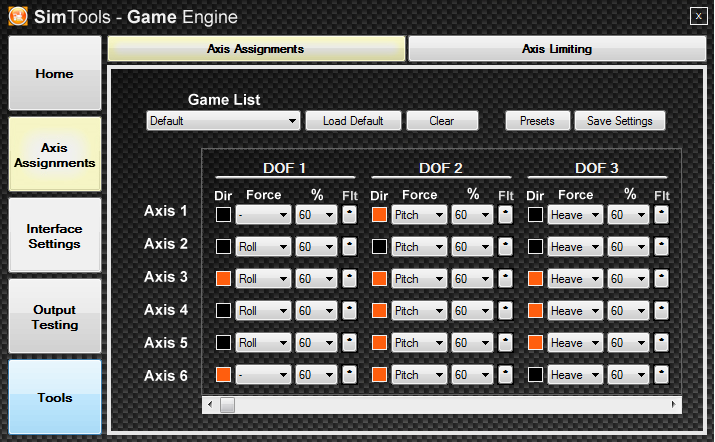

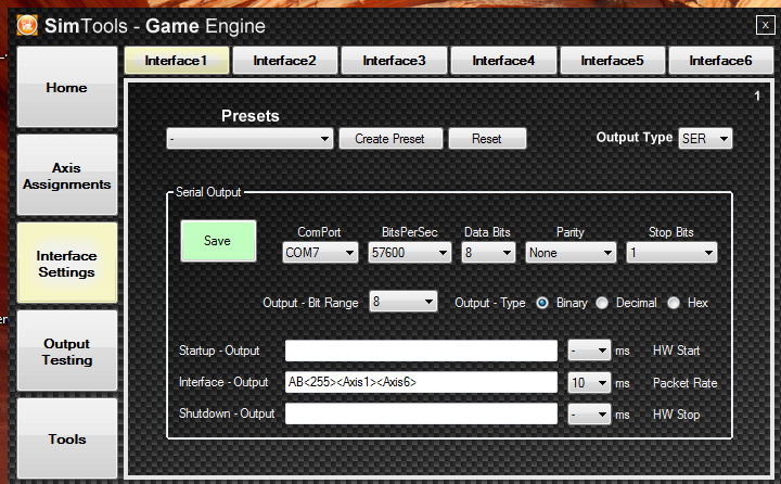

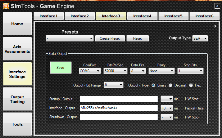

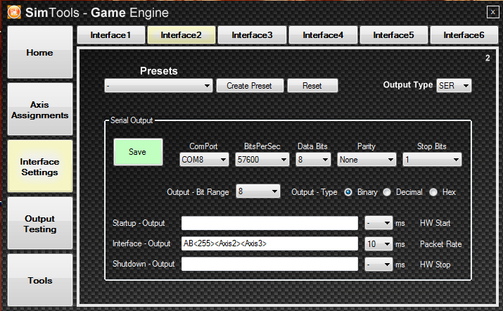

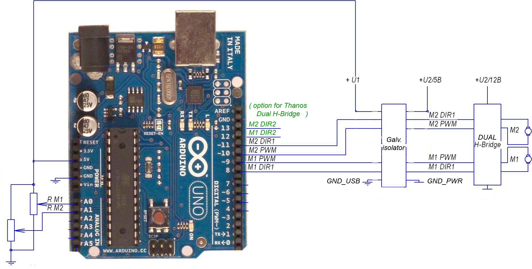

    Some pictures of the connection (through a Prilad)
    Configuration of simtools (through a Historiker).
    Connections.
    ARDUINO----------MONSTER
    M1PWM-----------PWM1
    M1DIR1------------INA1
    M1DIR2------------INB1
    M2PWM-----------PWM2
    M2DIR1------------INA2
    M2DIR2-----------INB2
    Arduino------------Motomonster
    Motor 1
    pin 8 --------------D7 Dir1
    " 12--------------D8 Dri2
    " 9---------------D5 Pwm
    Motor 2
    Pin 11---------------D4 Dir1
    " 13--------------D9 Dir2
    " 10--------------D6 Pwm

    In action.
    In a video I put more aggressive, with more rapid movements and another for the smoother.

  4. RaceRay
    Nov 8, 2006
    4,657
    Hamburg, Germany
    23,876Coins
    +2,044 / 13 / -0
    Amazing!!! I am really impressed about using cheap wiper motors, directly connected and not using any bungee cord, or other compensation helpers because of having the need to move too much weight.
    Did you already measured the maximum payload? Whats the power consumption when you sit on the platform, not more than 50W for a single motor?

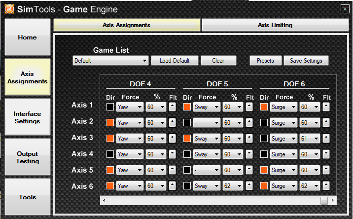

    I do not pretend that this is an official 6DOF, it's just a prototype that is doing better than I believed, and I am going to work more on it to get more performance.
    I am from Spain.
    The work of assigning axes in SimTools is Historiker.
    [​IMG][​IMG]

  12. RacingMat
    2,237
    21,031Coins
    Hello merchan-e!
    Congrats for your works!
    Could you tell us how long exactly is your motor's rod ? (I'm talking of the one which looks about 5 cm)

    2DOF, 6DOF
    Thank.
    I have two holes in the rod engine, 3,5 and 5cm. In the video is in the 3,5 cm.

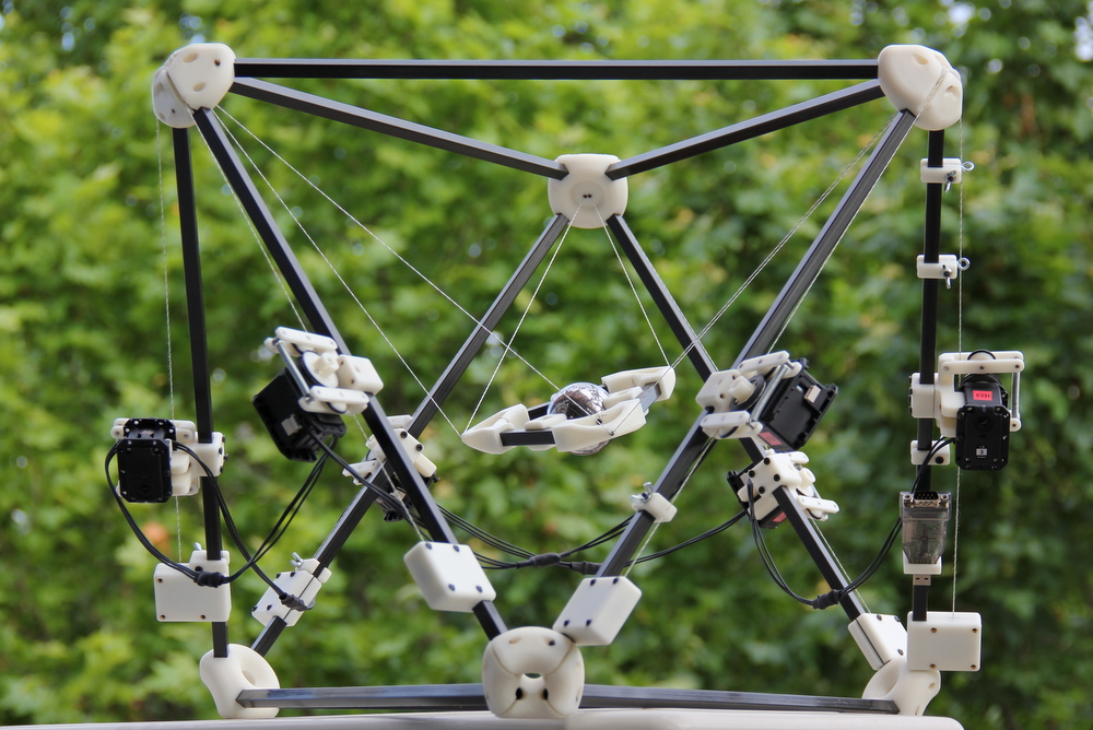

    Sorry to pollute your topic @merchan-e but your work got me thinking about removing actuators altogether and inverting the platform. I found some research into the matter here: http://www.iri.upc.edu/people/ros/CableDriven/
    There are some issues with cable slack as you can see in this video:
    But they fixed that:
    Inverted cable driven Stewart Platforms removes some weight from platform and the power needed from the motors will be less! Using winches instead of wiper motors in such a system looks like the perfect solution as they already have the proper... well... winches :)
    What do you think?

    It's much mess, but you have much inclination angle. Good thinking.
