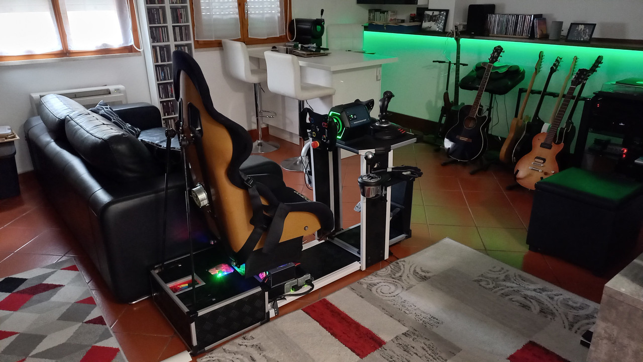

    EDITED FIRST POST TO REFLECT LAST STAGE OF THE RIG
    LATEST UPDATE: V3, September 2023 (rewired, motors box, pulleys, T818, updated modded SMC3 code, pot scaler)
    I edited this post so that, should anyone wanted to see the actual 'state of art' of my rig, wouldn't have to dig through the pages of the thread.
    More pics here
    Previous versions here, here and here

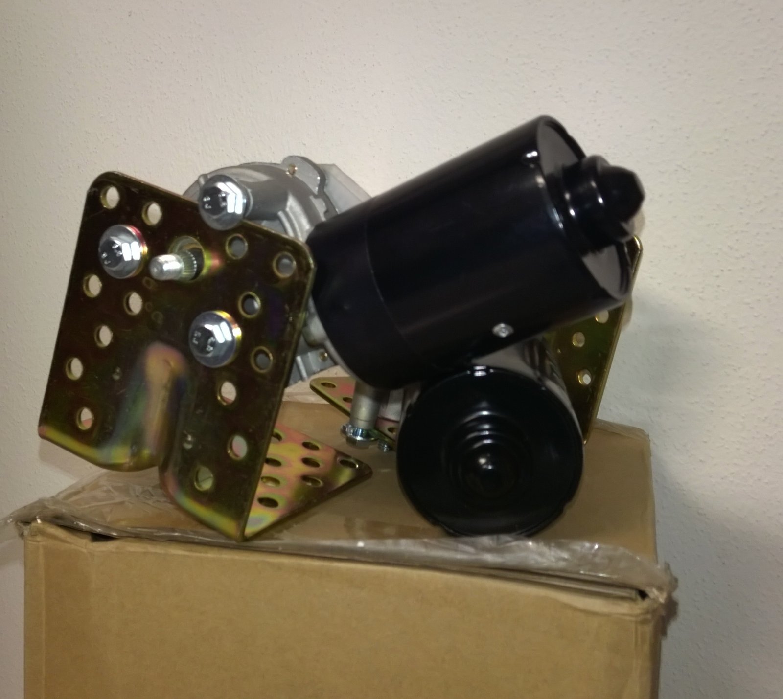

    Hey guys,
    first of all I want to thank all of you because reading hundreds of your posts I learnt a lot about a field I dind't know at all.
    I finally decided to start my own 2DOF projects after seeing all of your wonderful DIYs.
    First choice I had to take was if go with JRK or Arduino. Well, since I'm a software developer and I even wanted to start learning the Arduino side I chose the last. Still I think JRKs could be there in a not far future, let's see how this one go...
    Then the choice was if use metal or wood. Since I can't weld at all, even if I'd like to, I decided to start with a wood frame, meanwhile I'll buy myself an inverter and let's see the damage I can do.
    I already got the Arduino UNO and I started enjoin' it with some basic stuff. I'm waiting for the motor monster to be delivered and one wiper motor too.
    I said one cause I already bought a couple of motors but they just delivered me one, the project hasn't started with the right foot...
    I also bought the well known DPS-600PB as my PSU (12v 47A, 575W) and some other stuff that is on the way.
    This is just an "OK let's start" post, I'll keep you updated with pics and news as soon as I got all I need.

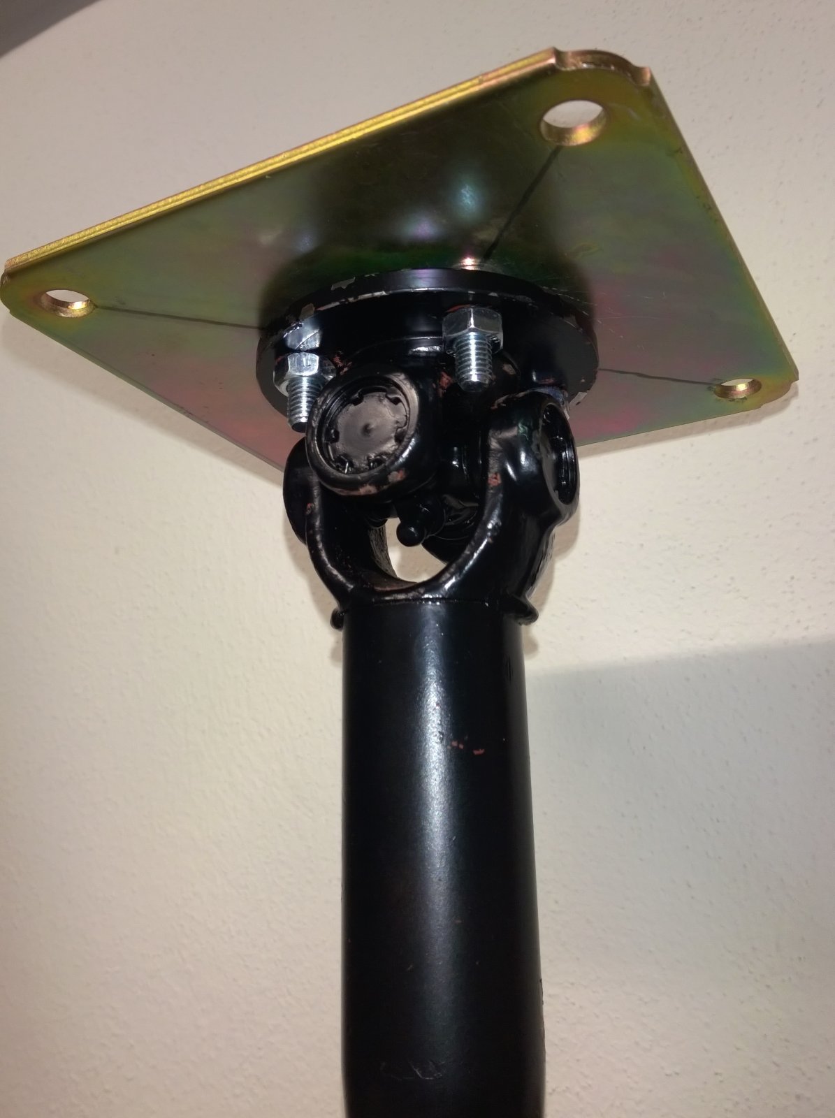

    Its already gone, but from a translation, is a drive shaft of sorts, and yes it looks to be good for a pivot, you would need to cut it down though
    EDIT : just read your entire post above

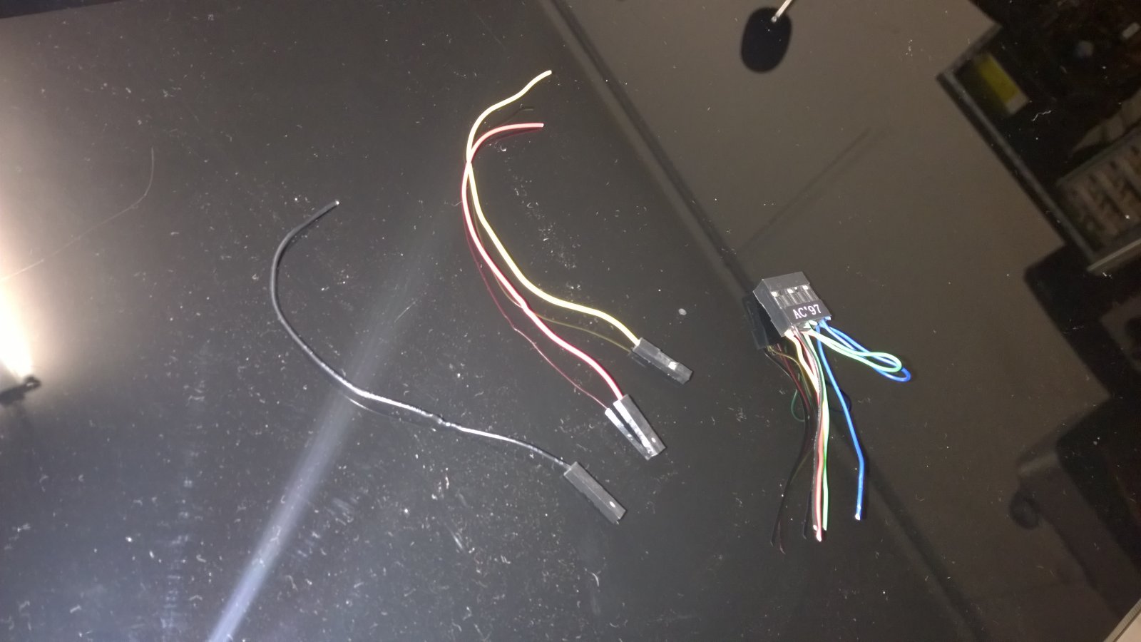

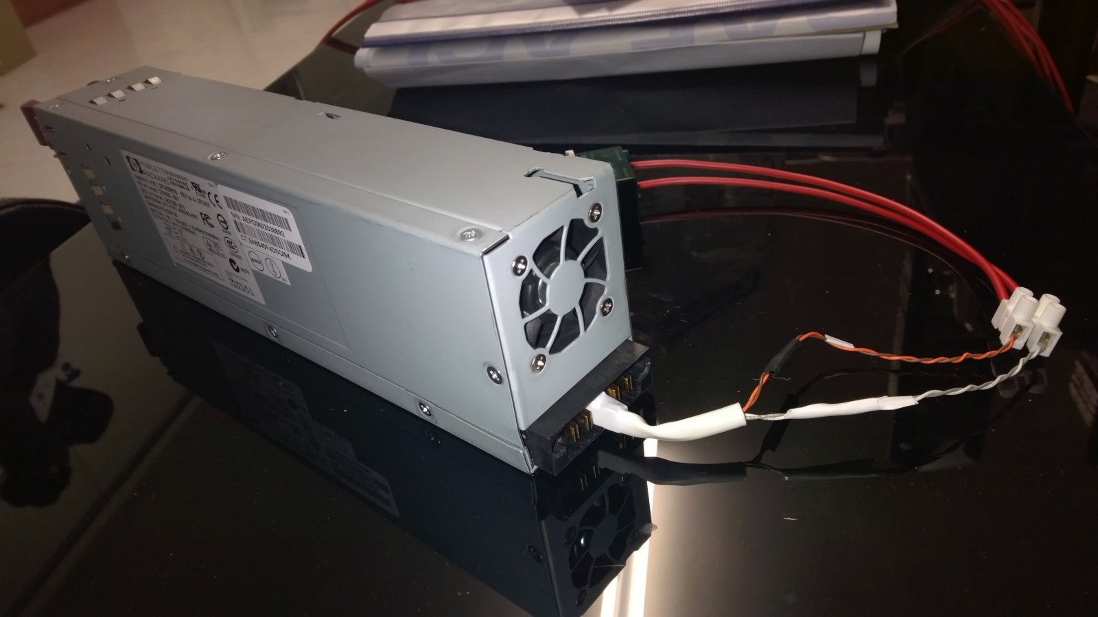

    Ok, the building of my DIY 2dof has finally begun. I almost got it all, still waiting for a couple of things, but I just wanna start building it.
    I'll go for a compact desk chair, just to start things off and then we'll see how it develops.
    First ingredient for the recipe is the juice.
    My PSU is the DPS 600 PB that most of you already know and suggest.
    in the following pics you can see how I connected the pins.
    I used an old AC97 wires from an internal sound card, connected pin 6-10 and 4-8 for power it on and keep the fan low.
    Everything - well, just the psu right now - works. Let's see how it goes with the rest...
  16. Nick Moxley
    17,056Coins
    +2,506 / 30 / -2
    Not only does the fan mod keep the fan noise down, But from extensive testing with this PSU, the RCgroups guys have confirmed under Full load the Fan will Boot Up Speed to ensure thing's stay cool as a cucumber. :thumbs

    yes it's auto adaptive. So good for a pretty cheap psu, I paid more for delivery than for the psu itself.
    one question: Is it normal that the fun runs even if psu is off (only connected to power)?
  18. noorbeast
    21,611
    151,323Coins
    +11,034 / 56 / -2
    Yes that is normal when connected to power.
  19. Nick Moxley
    17,056Coins
    +2,506 / 30 / -2
    Yes Normal, Fan's on but no 12v on the Rail.
