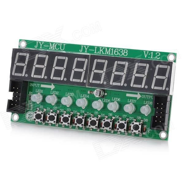

    As you can see I also took the time to configure the 2-colors 2-modules TM1638. The leds lit from the center to sides first in greenn then - keeping the green on - in red. Should anyone care I'd post the Arduino code.
    Also, if someone wants to suggest some pattern to lit leds, I'd appreciate it

    Dude that looks awesome. I wish i had a place to put one of those, Height relation from my wheel to screen wont allow me to tuck it between the wheel and below the screen, there's just no room for it.
    can u give a break down on which 1638's you used ? as far as i can see there's 3 different 1638's
  11. Blame73
    Blame73 Well-Known Member
    Nov 6, 2014
    1,210
    8,255Coins
    +1,105 / 2 / -0
    Here you are, I bought it at dealextreme: http://www.dx.com/p/8x-digital-tube-8x-key-8x-double-color-led-module-81873
  12. Nick Moxley
    17,054Coins
    +2,504 / 30 / -2
    damn i grabbed the wrong one. I got this style, cuz it was like 3$ from one of the HK shops i was already buying something from. I guess ill order up a pair of the ones you have and try and find a place to stick em. Thanks bud,

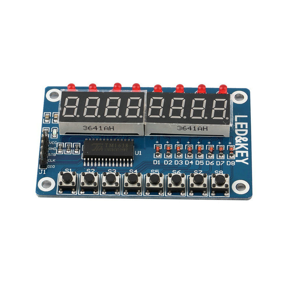

    I used these ones before. They got just one light (red) per led and are way smaller.
  14. Nick Moxley
    17,054Coins
    +2,504 / 30 / -2
    yupp it sure looked small when i pulled it out of the package. Thinking to myself....."hrmm what will i do with this now....." oh well 3$ well spend on a lesson learned.

    Thinking about it, a two colors module would fit better my idea 'cause I'd use increasing green leds for showing better times and vice-versa red leds for worse times. One led for each 10 cents of gap
