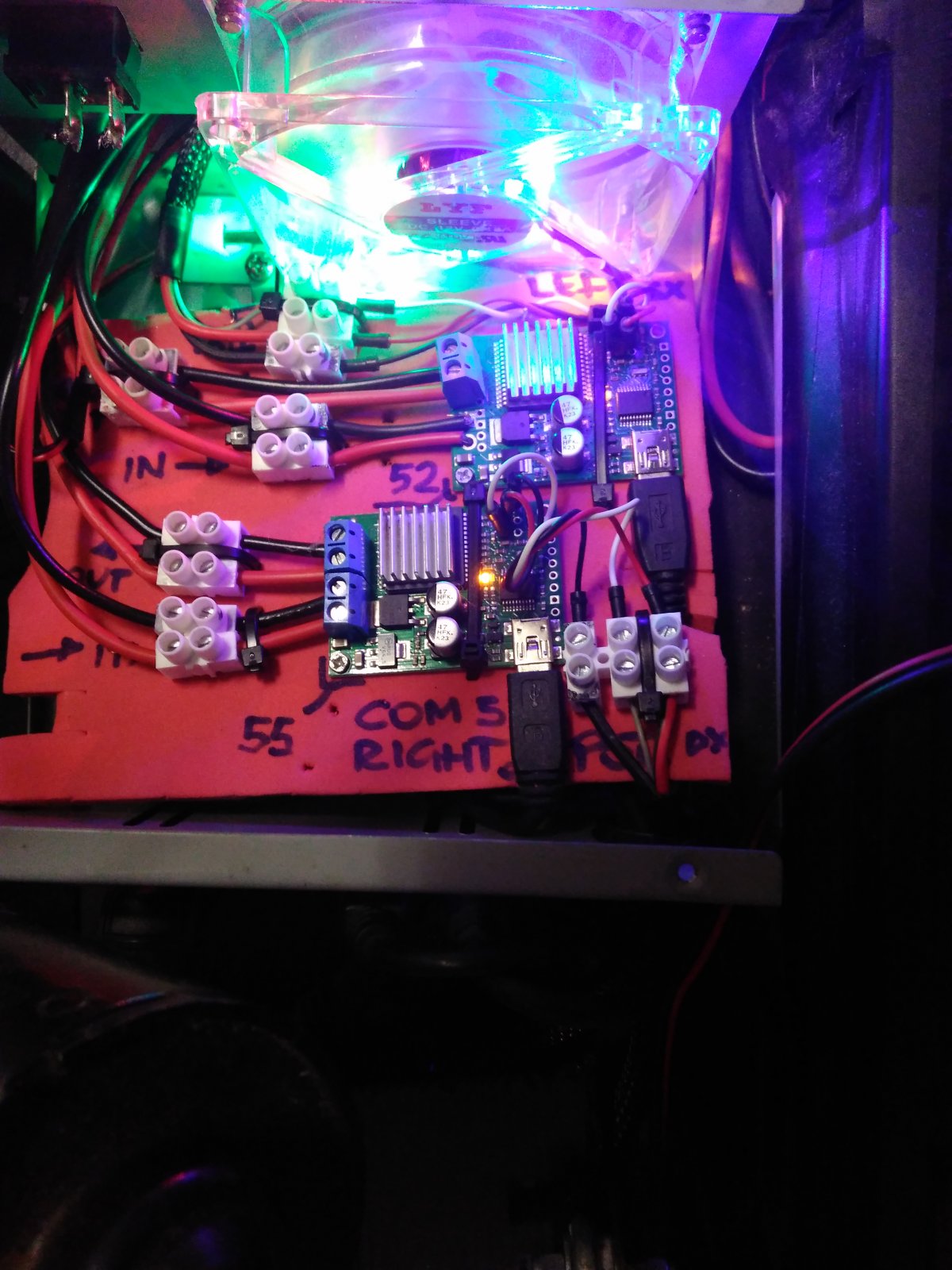

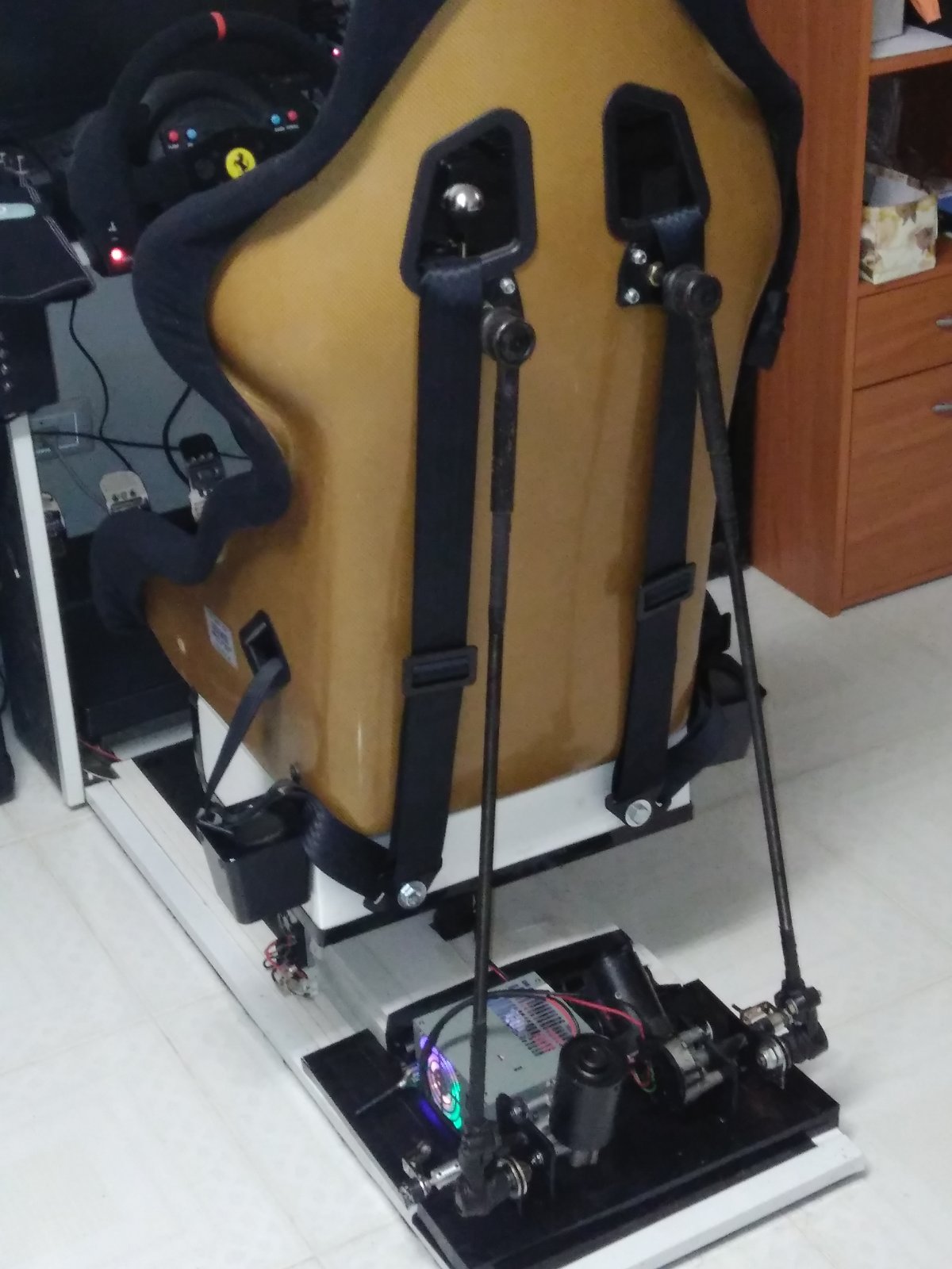

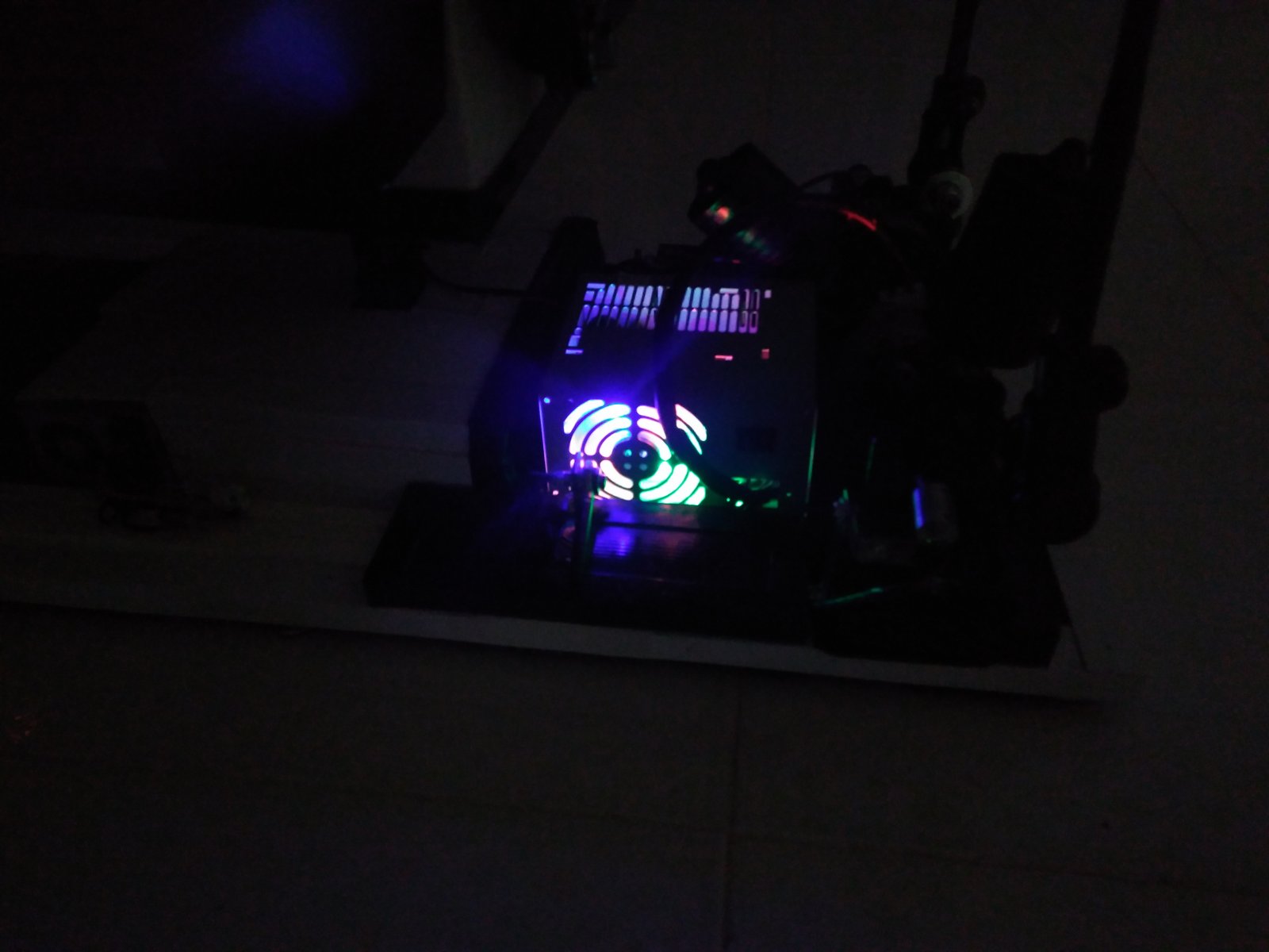

    Yeah! I menaged to fix the JRK :thumbs
    Since I was there I made a new box for electronics using and old PC PSU so that I'll be able to switch motors faster as soon as I get my new 60:1 guys
    and with the new harness belts
    I'm still unsure if keep the shoulder mount with the new motors or make the rig smaller movin them in front of the seat.
    Any advices?
  6. Nick Moxley
    17,057Coins
    +2,507 / 30 / -2
    what was the problem ?
  7. Blame73
    Blame73 Well-Known Member
    Nov 6, 2014
    1,216
    8,314Coins
    +1,139 / 5 / -0
    @Nick Moxley as for the other one, the mini usb connector was loose (I don't know if it's the right English word) and just by moving it a micron, it lost connection and didn't work anymore on the USB port it was connected to.

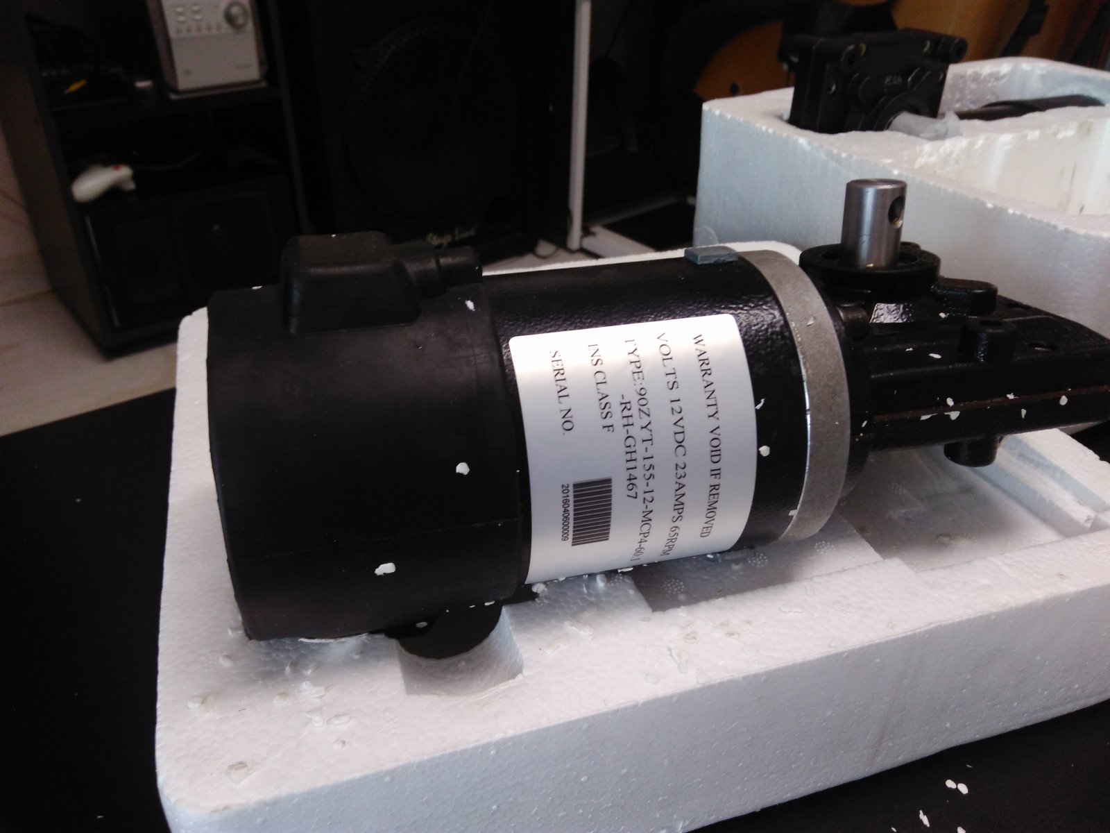

  12. Blame73
    Nov 6, 2014
    1,216
    8,314Coins
    +1,139 / 5 / -0

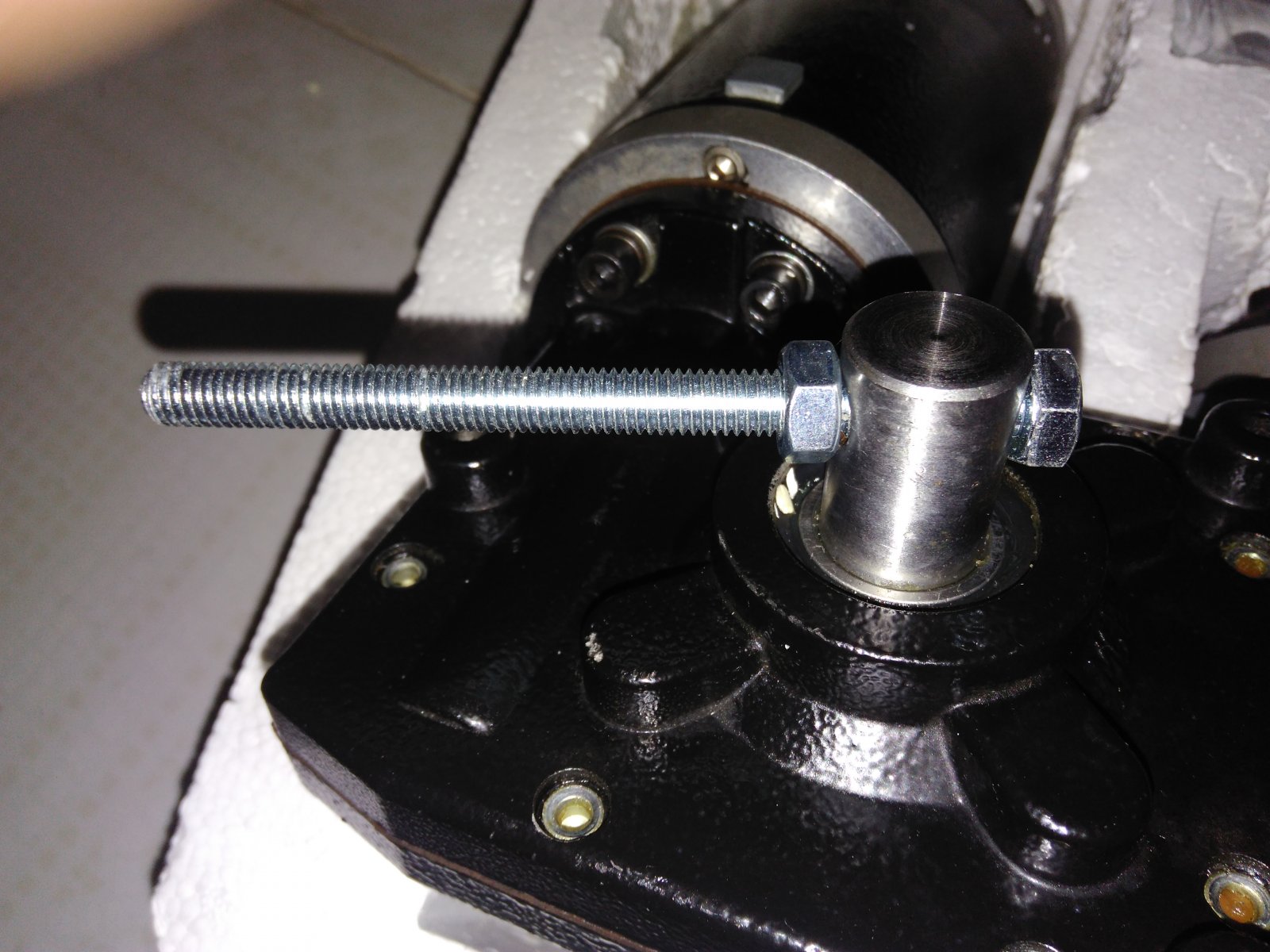

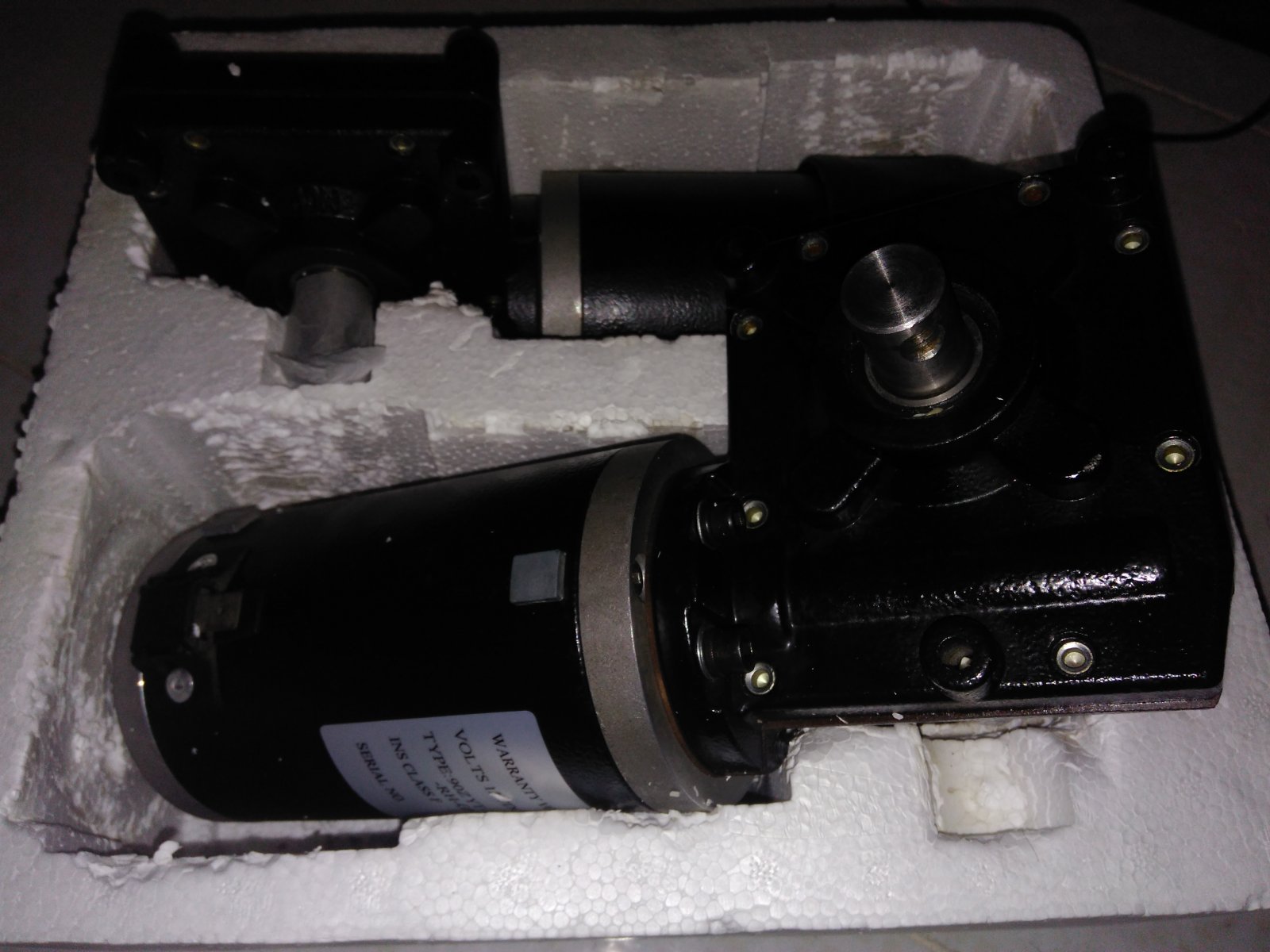

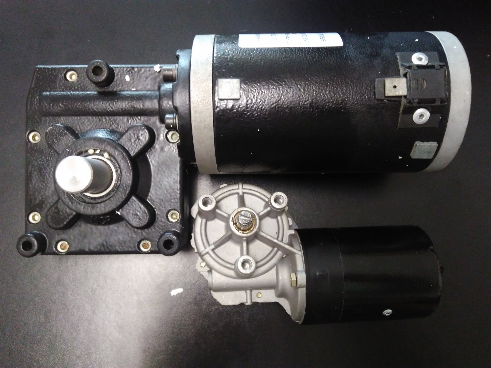

    Got back home... SURPRIIIIISE!! A box was waiting for me :D
    Ok, wiper motors look really tiny now!
    Now I just have figure out how to attach the levers...
    I was thinking about something like this (a shorter one) with a rose joint at the end of it:
    Any tips @Nick Moxley @noorbeast ?

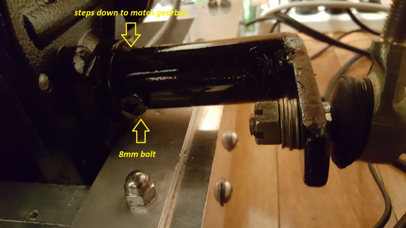

  13. noorbeast
    22,086
    154,124Coins
    +11,170 / 57 / -2
    For mine I was concerned about maintaining strength when the shaft had a 8mm hole in it.
    So I machined an interference fit tube which is quite thick and a step down has been machined at the gearbox end, just after the 8mm securing bolt, to be able to fit into the gearbox opening.
    It is hard to see because of the poor lighting, but here is a picture:

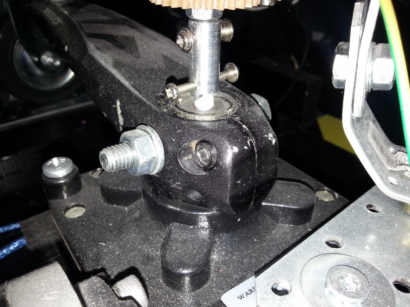

  14. Pit
    3,007
    30,512Coins
    +3,098 / 31 / -0
    You could mount a bike crank as I did.

  16. Blame73
    Nov 6, 2014
    1,216
    8,314Coins
    +1,139 / 5 / -0
    Thanks @Pit, have you got a bigger picture of the shaft?

    Love the motor's....Hate the Bolt/Level Idea. :grin
    I would look into Either Pits or Noor's fabricated solution.
    Being a seat mover, there isn't CRAZY high load forces on the motor's...but a solid solution is better than one that will fail in the future.
  18. Blame73
    Nov 6, 2014
    1,216
    8,314Coins
    +1,139 / 5 / -0
    Ok, I see what you've done. It's just I don't own a welding machine for the shaft

  20. Pit
    3,007
    30,512Coins
    +3,098 / 31 / -0
    Are you drunken?:cheers
    Here you go
