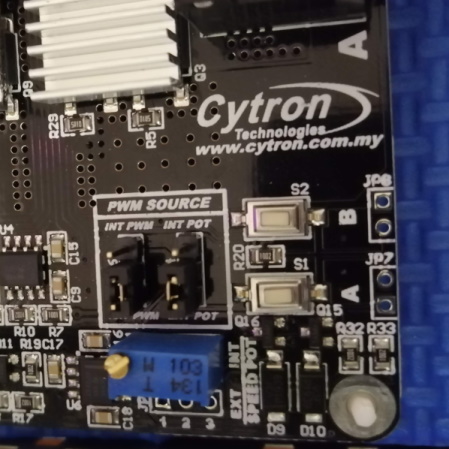

    On the MD30C manual it's not mentioned you have to use a battery in parallel when using it but I'm doing it anyway. Don't motors produce regenerative corrent anyway when braking/changing direction/... ?
    MD30C doesn't have IN1 and IN2 as the MDSS30 does but just an IN (GND, PWM, IN), nor has DIP switch. Seems to be more direct to use, just change the jumpers and you're done.

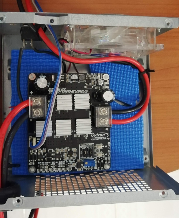

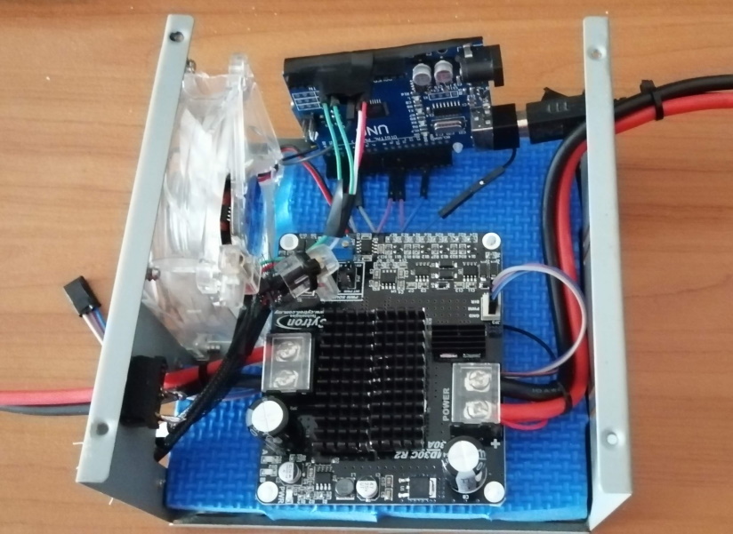

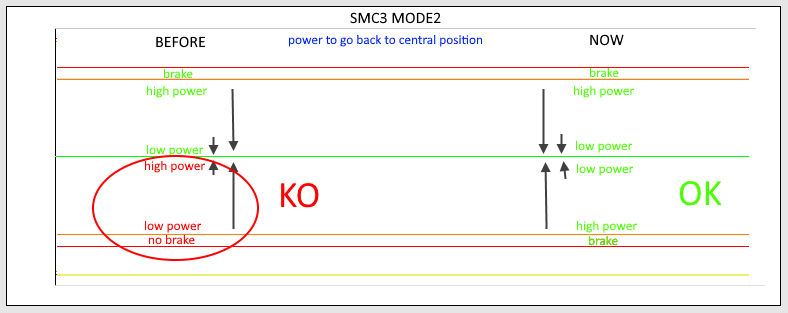

    EDIT: I MODIFIED THIS POST IN ORDER TO HAVE ALL INFOS IN ONE PLACE
    CYTRON MD30C (works with MDDS30 too)
    First test with a wiper motor (I'm now using heatsinks on the motor driver even if it doesn't heat up, they won't hurt for sure)
    You can find all my modifications to SMC3 searching for Blame73 inside the .ino
    I uploaded it on Mega, grab it from >>>>> SMC3_Cytron_MD30C.zip
    UPDATE: new version with fixes and pot scaler that works with Cytron here
    It uses MODE 2
    Basically I modified directions and brakes that were inverted on half side of the range
    Like this:
    EDIT: removed
    Also, commented out there are modifications to scale the feedback range (I had found this trick here in the SMC3 thread), in case you have the pots mounted on the shafts (as I do):
    Wirings are correct:
    PIN settings:
    The drivers in their boxes:
    I'm probably using the third Cytron for traction loss (one of these months...)
