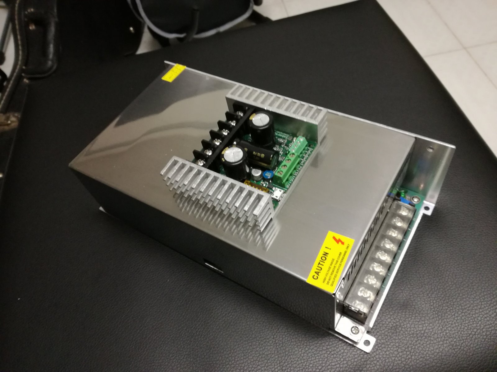

    I didn't think Sabertooths were this big, especially compared to JRKs

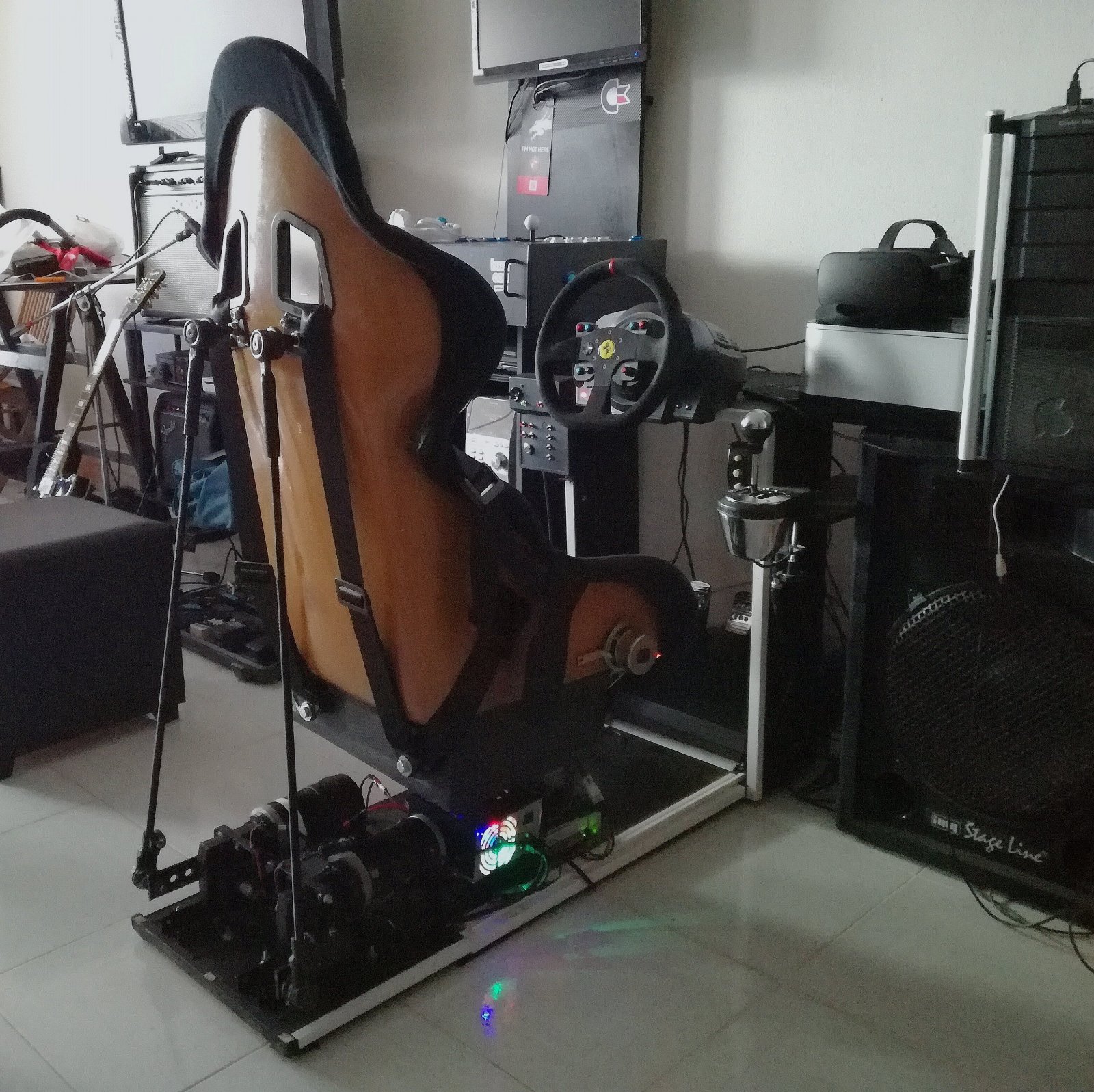

    This time I forgot to update my thread with latest changes.
    After I got the Sabertooth 2X32 I switched the PSUs from the DPS to the Led PSU + a moto battery in parallel with @BlazinH 's SMC3-SPS Sabertooth Packet Serial PID motor driver w/SoftStart
    After one week the Sabertooth stopped working. I contacted Dimension Engineerig and they told me it could have taken a short and I've been offered a no charge repair (wow), but having to send it back to the USA I also contacted the reseller (RobotShop.com) that also was so kind me to offer me a free replacement even paying the courier for returning the broken Sabertooth. They sent me a brand new 2X32 even before I sent the broken one back! Thank you guys!!
    Right now is working great and I'm enjoying my rig again (so glad I didn't sell it because now I'm having to travel for work less than before)
    A pic I took with the phone today, I'll take some better ones one of these days:

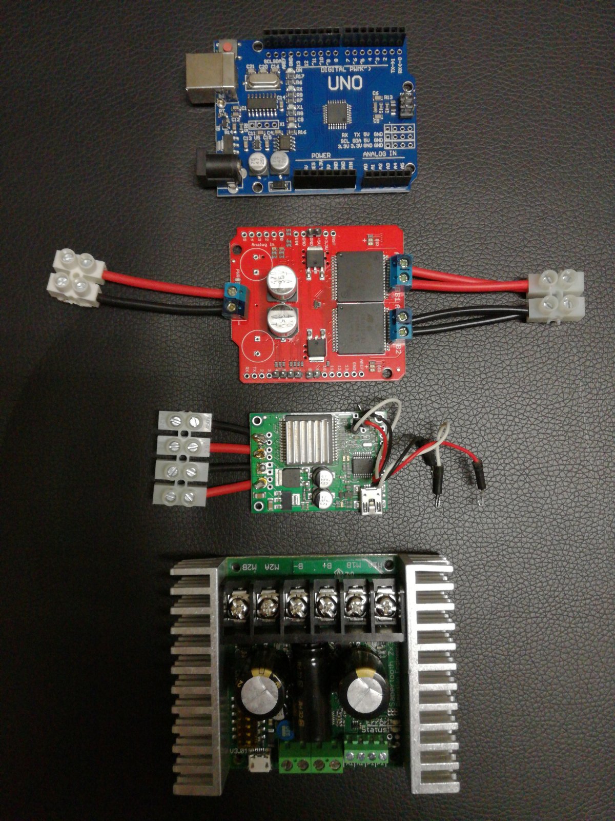

    Just got the two Cytron MD30C R2
    As always a comparison picture against the JRK 12v12, the Sabertooth 2x32 and the Sparkfun MotoMonster:

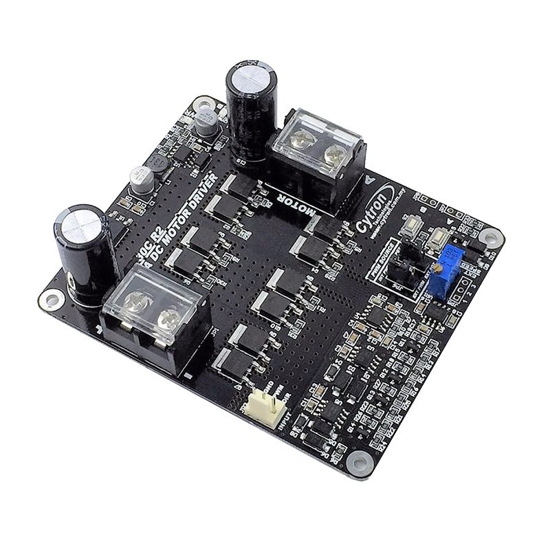

    I had more time today and tested the Cytron again.
    What I didn't noticed yesterday is that motors are running slowly in one direction.
    I tried with wipers and 'big' motors, same problem. Swapping leads makes motors go slow in the opposite direction, so it's not a motor problem
    I also tested it with different Arduino Uno and the problem persists, so I would say it's not the Arduino either...
    Any ideas what the cause could be?

    Motion platform
    do they have an onboard pot ? maybe its not off
    is theres a jumper on there that my disable the onboard pot ?
    Edit closer look i see you have set jp6 and jp4 both to external, but jp4 when set to external points to the solder on pot at jp5 could it be that you need to remove the jumper completely?
    i am guessing as ive not used these boards before

    Yes, it's got an onboard pot but it's excluded via jumper (and anyway it's excluded when connected to a controller)

    ok was just a guess lol have you tried to remove jp4 completely ?

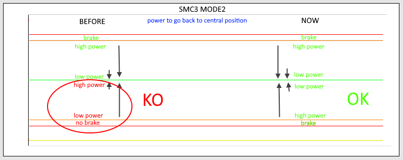

    A quick test of one of my new Cytron MD30C (R2) made with my old wiper motor (and Arduino UNO) before installing it on my rig where I have 23A 12V motors.
    Don't mind how I installed the pot, it's just a quick test to see if it's all working the way it should.
    I had to modify the base SMC3 in order to have it properly working with the Cytron controller, I'll public it later should someone else would be interested into using the Cytrons too.
    Basically it wasn't working right on all the range:

    Yes, I had to modify the SMC3 code because as you can see from two posts back it wasn't working correctly on one half of the range (forces were inverted). I'm going to share it tomorrow if you want to, I don't think it would cause any damages anyway.

    Heh, glad to here you haven't had another burn out :) I was reading through the manual of the MDDS30 last night and found this....
    MCU Mode
    LOCKED ANTI-PHASE Motor stops when the input signal is 2.5V. Motor moves in one direction when the input is < 2.5V (0 - 2.5V) and in another direction when the input is > 2.5V (2.5 - 5V).
    SIGNED MAGNITUDE AN1 and AN2 controls the speed of the motor. Motor stops when the input is 0V and run at full speed when the input is 5V. IN1 and IN2 is digital inputs and it controls the direction of the motor respectively.
    And wondered if it related to the SMC3 issues. The manual for your board doesn't mention the option but I remember reading that SMC3 in Mode 2 had to reverse the polarity of the PWM (or something) in order for it to work with the IBT2. Anyways, thought it might be relevant.
