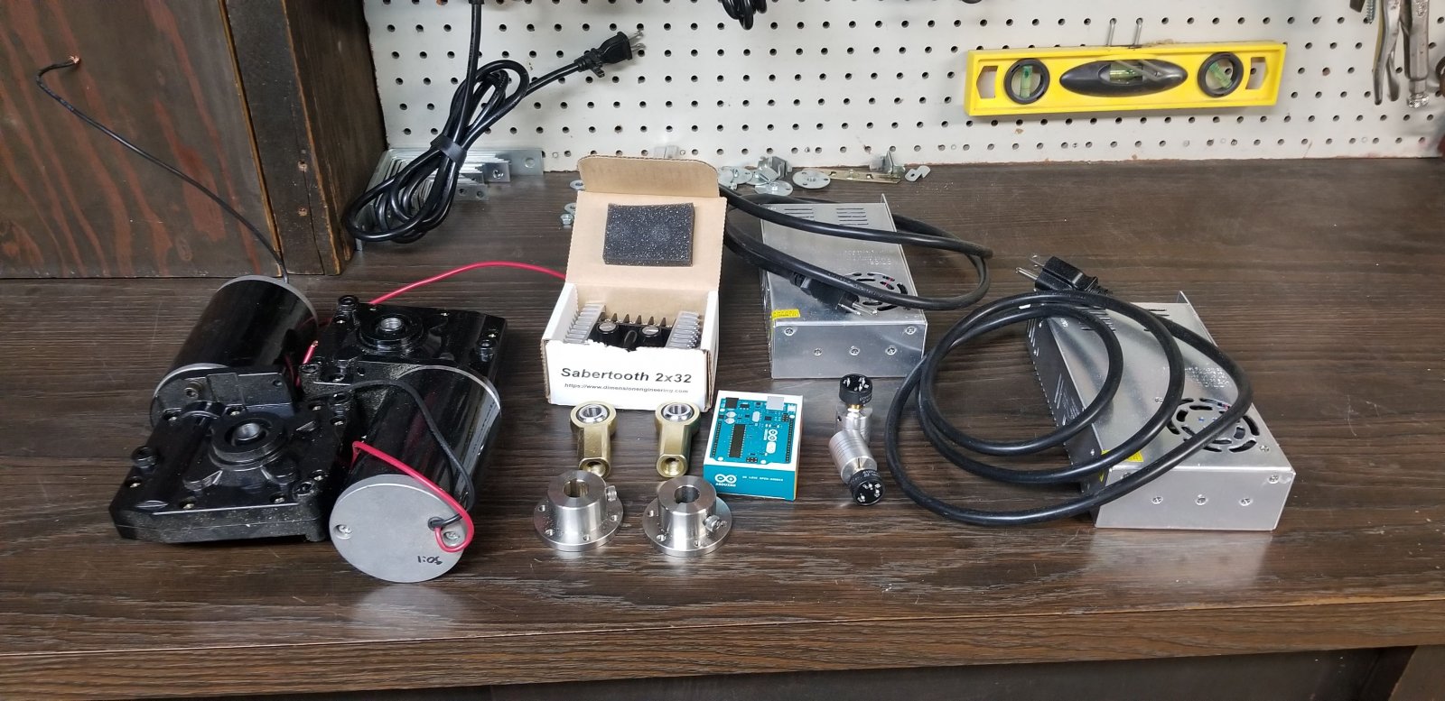

    Parts:
    Gear Motors: https://www.ebay.com/itm/371596157992
    Price: 2 units x $100
    Specs:
    - 12 volt DC
    - 180 watts
    - Output Speed 75 - 80 RPM
    - Load Between 50-60 N.M
    More: http://vi.vipr.ebaydesc.com/ws/eBay...descgauge=1&cspheader=1&oneClk=2&secureDesc=0
    Hall Sensors: https://www.newark.com/tt-electroni...-hall-effect-single/dp/85R4162?st=6127V1A180L
    Price: 2 units x $15
    Power Supplies:
    Price: 2 units x $21
    Specs:
    - 12V 30A 360W
    Motor Controller: Sabertooth 2x32
    Price: 1 unit x $120
    Arduino Uno: R3:
    Price: 1 unit x $21
    Flexible shaft Coupler:
    Price: 2 units x $13
    U- Joint Kit:
    Price: 1 unit x $15
    Flage Yoke to place the U joint in:
    https://www.amazon.com/gp/product/B00IVQPU5A/ref=ppx_od_dt_b_asin_title_s00?ie=UTF8&psc=1
    Price: 2 units x $25
    12mm Set Screw Key Hub: https://www.robotshop.com/en/12mm-set-screw-key-hub.html
    Price: 2 units x $18

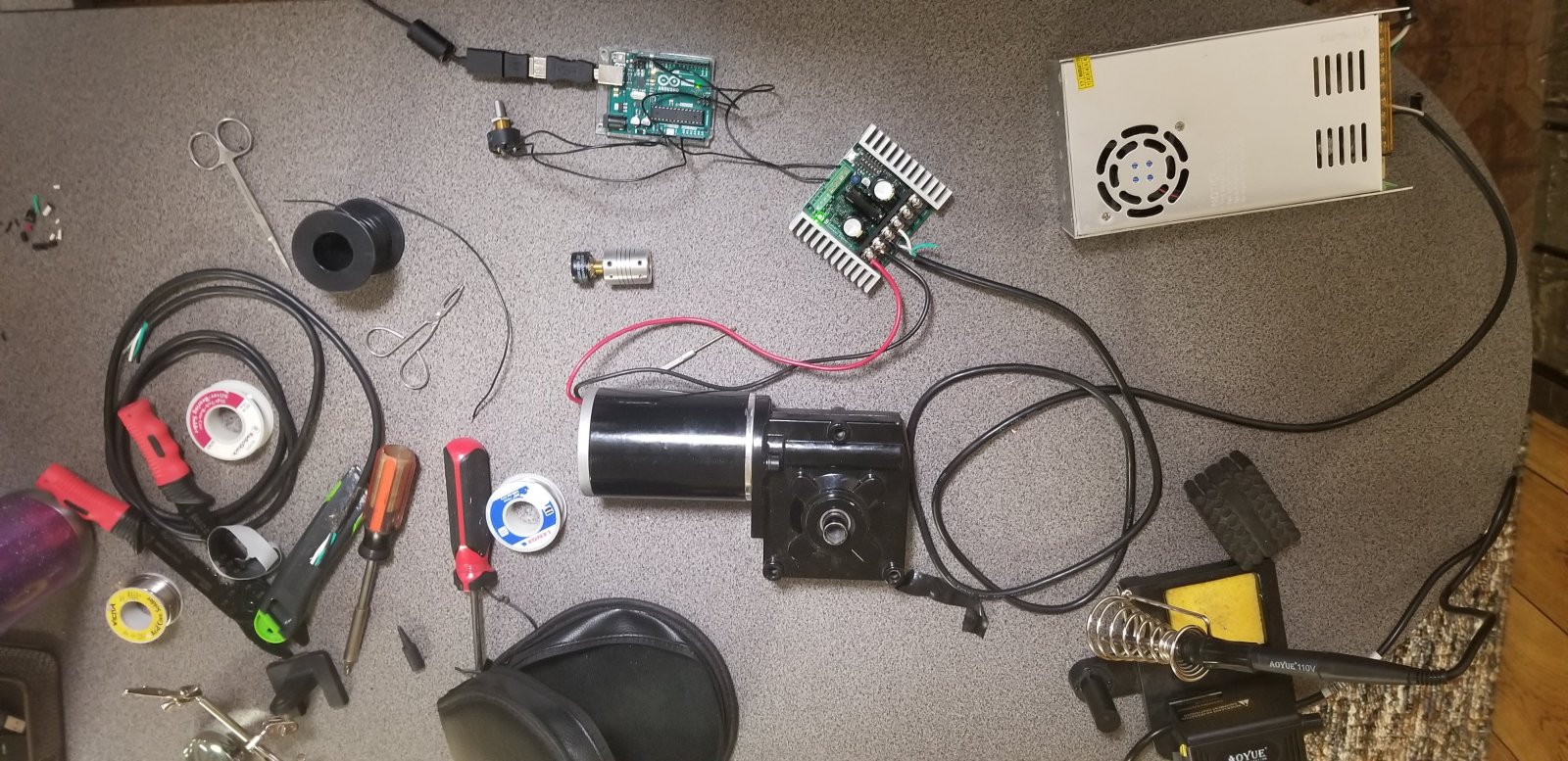

    20200410_184629.jpg 20200410_184724.jpg 20200410_184737.jpg 20200410_184809.jpg 20200410_184836.jpg 20200410_184844.jpg 20200411_171559.jpg 20200411_171609.jpg 20200411_171623.jpg 20200413_193649.jpg 20200413_193713.jpg 20200413_193717.jpg 20200413_193731.jpg 20200413_193736.jpg 20200413_193757.jpg

    My current status in the build:

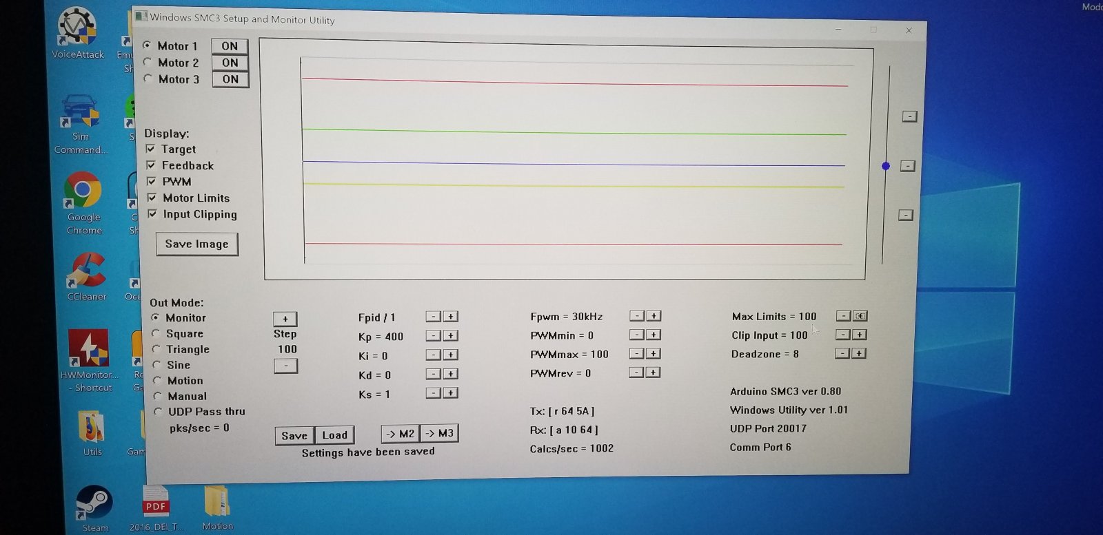

    1) I have installed DEScribe, connected my sabertooth and arduino, and adjusted the settings follwoing the guide by BlazinH for one of my hall sensor/motors. I will need to do the same for the second.
    I am able to adjust the settings using SMC3Utils and see those changes reflected in the motor movement.
    2) I have started to mount the motor mounts and the seat frame onto the base frame and will be doing calculations using SimCalc when everything is in place to determine the lever length.

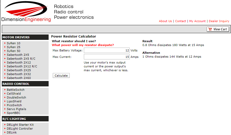

    Questions regarding electricity :
    My motors are 12v 180 watts. I believe that means it will draw 15 Amps. My power supplies are 12V 360 watts and can output 30 amps.
    1) I have used the resistor calculator recommended by dimension enginering to determine that I need a 0.8 ohms resistor that dissipates 180 watts at 15 amps. Is that correct?:
    https://www.dimensionengineering.co...r?batteryvoltage=12&current=15&calc=Calculate.
    2) In the Sabertooth Manual(https://www.dimensionengineering.com/datasheets/Sabertooth2x32.pdf), The sections covering the Motor Outputs Tab states:
    "Current Limit
    This setting sets the maximum current for the motor output. If the system tries to draw more current than the setting, the output duty cycle will be reduced. For Sabertooth 2x32, each motor output can be limited individually in a range between 0A and 64A. This is a soft current limit, and will slow acceleration but allow motor motion to continue. There is also a fixed hard current limit above approximately 70 amps which protects the Sabertooth from a shorted motor."
    If this allows me to set the maximum current to my motor, can't it replace to need for a resistor?

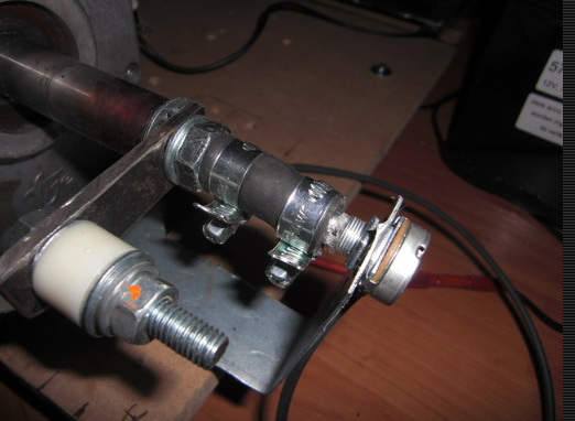

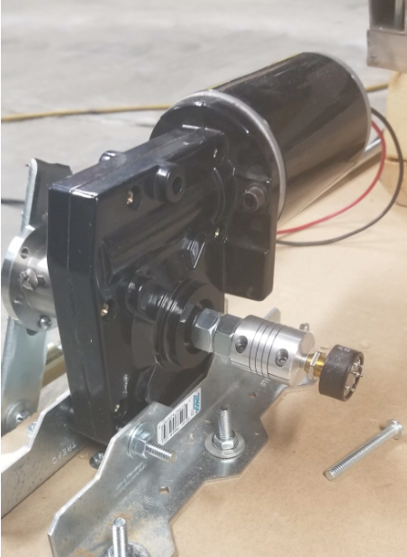

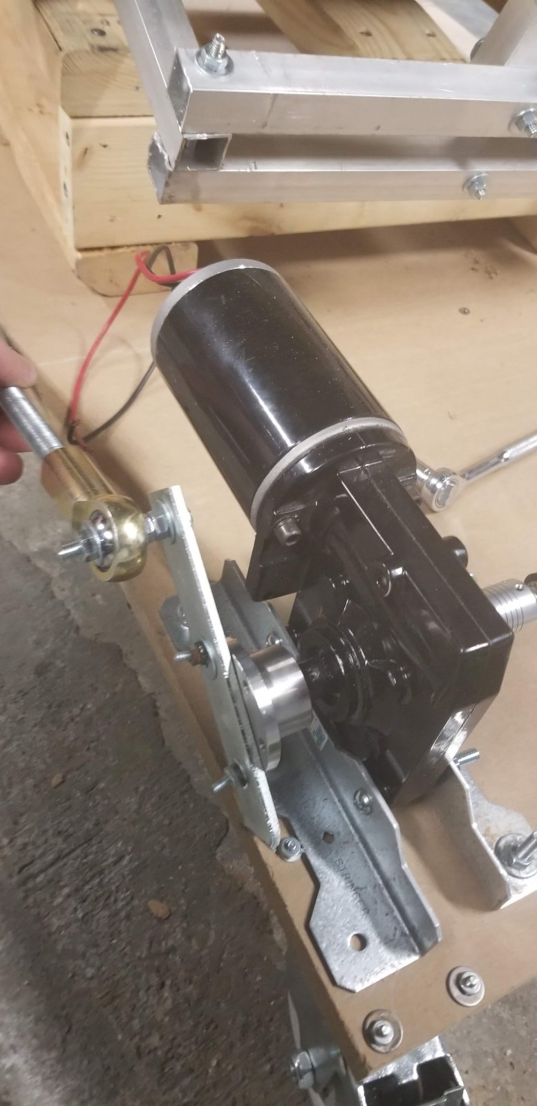

    1) I have seen on many, many builds a peice of metal that attaches to the potentioneter shaft and back onto the rig. Is that necessary for hall sensors as well?

    I do not use any resistors at all. And I have a lot of weight to move...
    As said before no resistores needed.
    I assume that you know what to do making the power supplies in series mode. Don't worry about drawing power from the Sabertooths, they manage it perfectly.
    I don't really understand your issue, hall sensors are not different from other sensors in terms of handling...easier to use due to the non-contacting position sensor. Probably you can be more precise with your question?

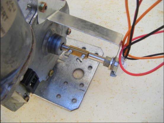

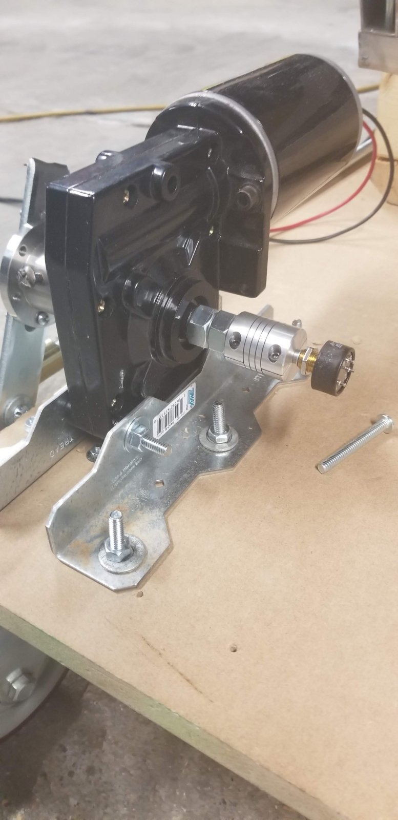

    2) "I don't really understand your issue, hall sensors are not different from other sensors in terms of handling...easier to use due to the non-contacting position sensor. Probably you can be more precise with your question?"
    In the FAQ: https://www.xsimulator.net/community/faq/how-to-connect-protect-a-potentiometer.13/
    There are several pictures of the potentiometers mounted to the motors, but the also have a angle bracket supporting/connecting them to the frame:
    My questions is:
    1) Is this angle bracket for neccessary for hall sensors or only potentiometers.
    2) Will using a flexible shaft coupler provide enough support or is it recommended to use the angle bracket as well?
    Any thoughts are appreciated.

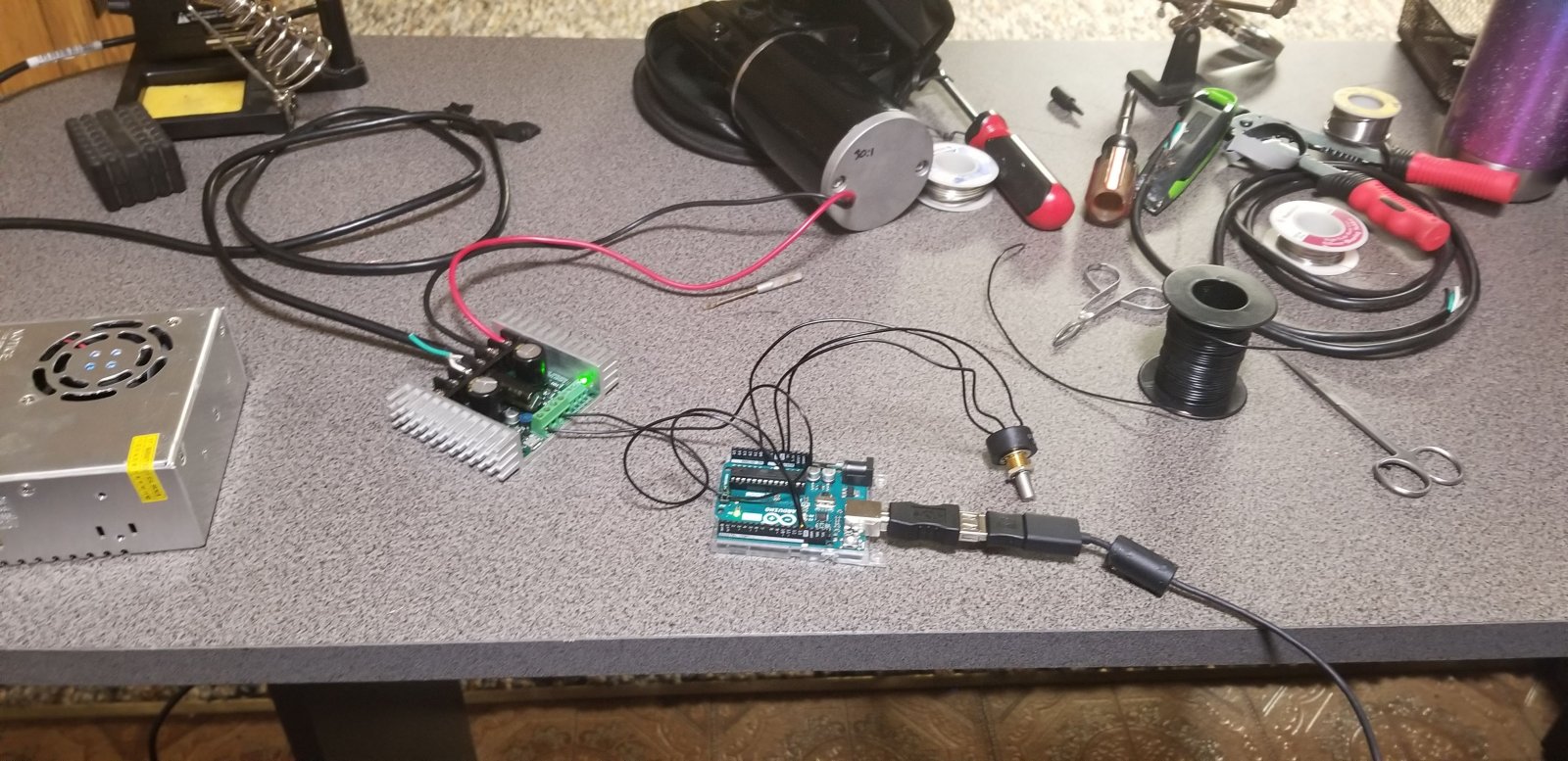

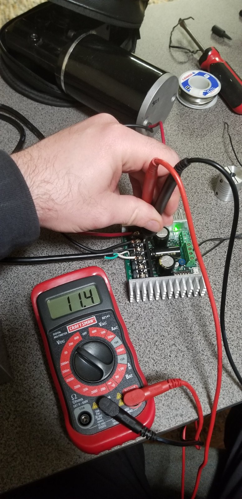

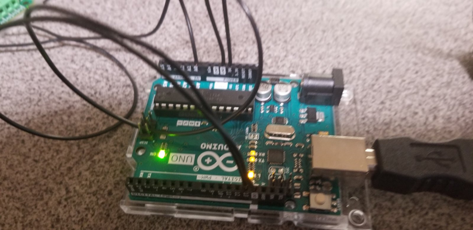

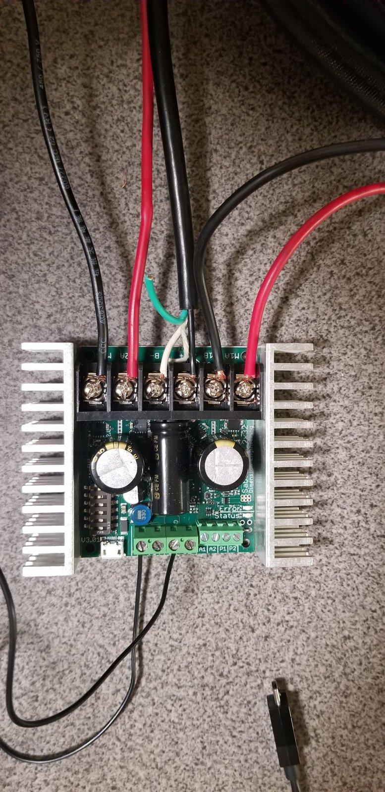

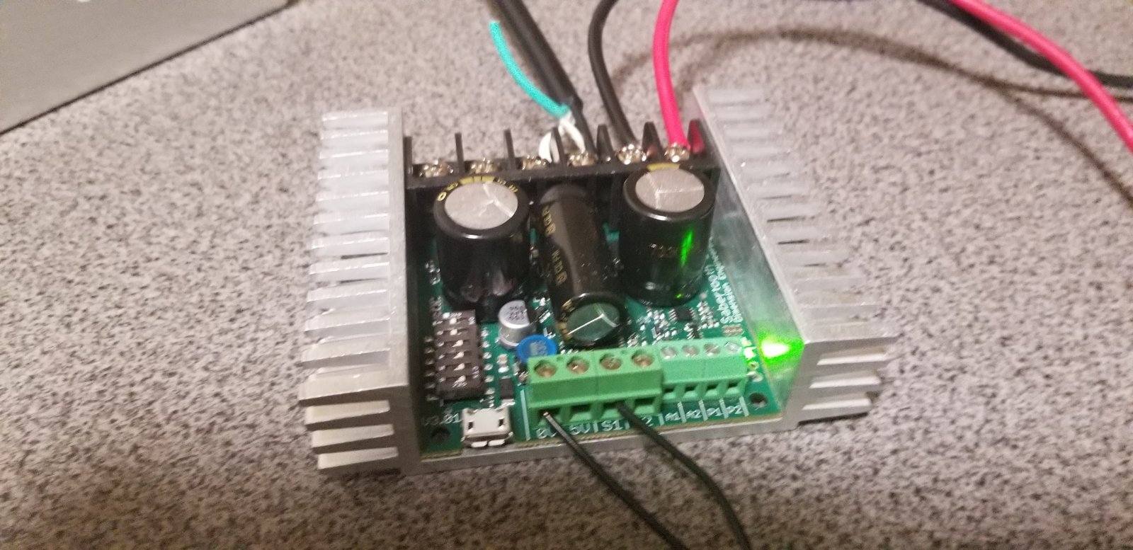

    Current Status:
    I've connected both motors to the sabertooth 2x32 which is using one power supply right now. I have both hall sensors connected to the arduino and I am able to use SMC3Utils to montior adjust settings.
    Here is short video showing the hall sensors controlling the direction of the motors:

    It's not about what the sabertooth needs, it's about what the motors are rated for. If you have 12V 180W motors they will need 12v. 24 volts might ruin them in short order.
    The base of the hall sensor needs to be fixed otherwise it will just spin with the motor! So yes, you'll need an angle bracket.

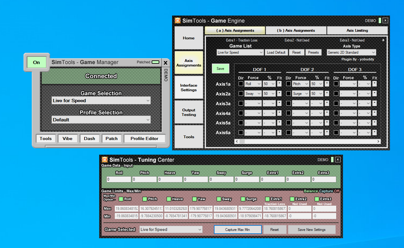

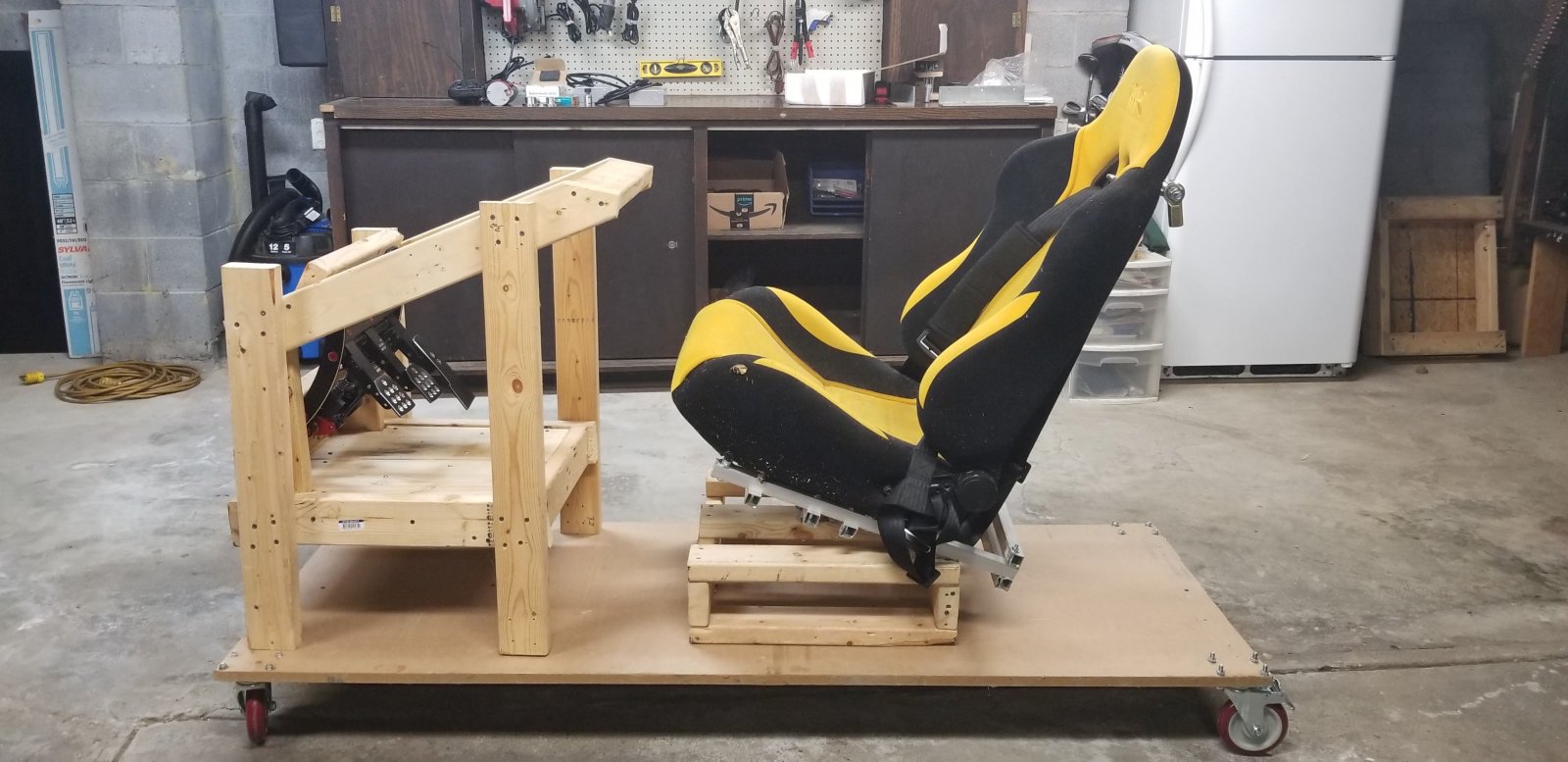

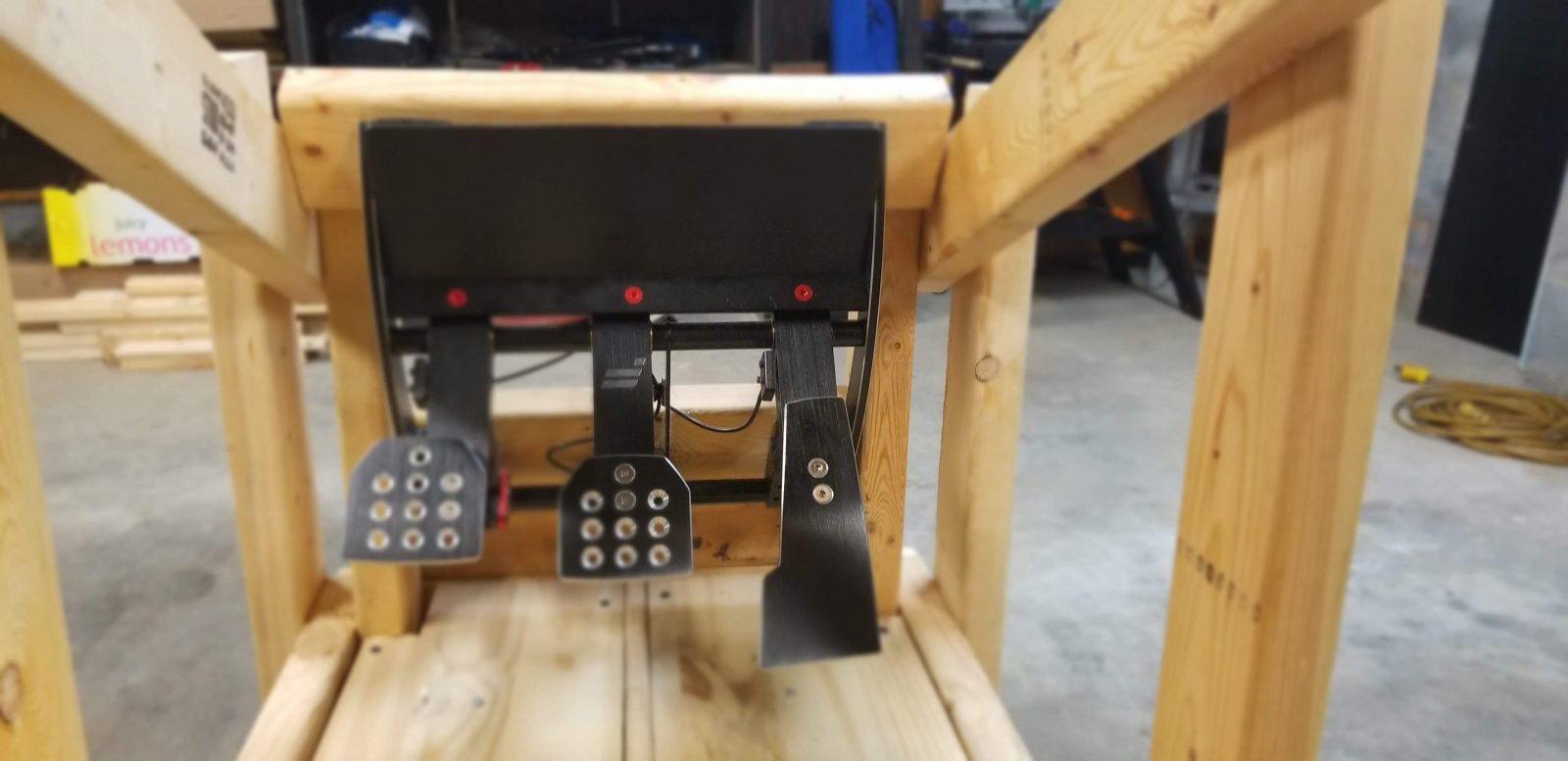

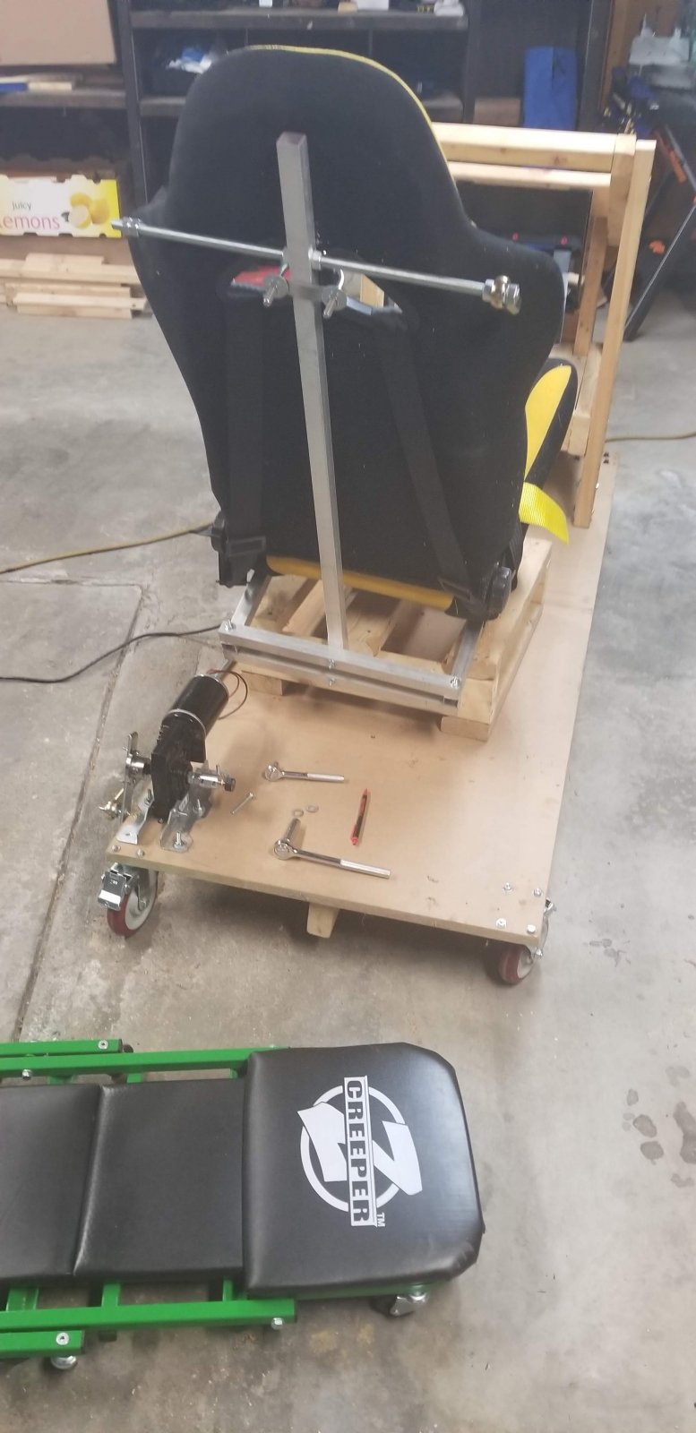

    I've made some progress this evening:
    • I've installed LiveForSpeed demo version.
    • Installed SimTools GameEngine Demo Version
    • I've patched LiveForSpeed
    • I'm able to run LiveForSpeed with GameEngine and GameManager synced together.
    • LiveForSpeed is sending telemetry to GameEngine/GameManager and through the serial connection to Arduino/Sabertooth and controlling the motors.
      • Video of the game sending information to the motors:
    Remaining Tasks:

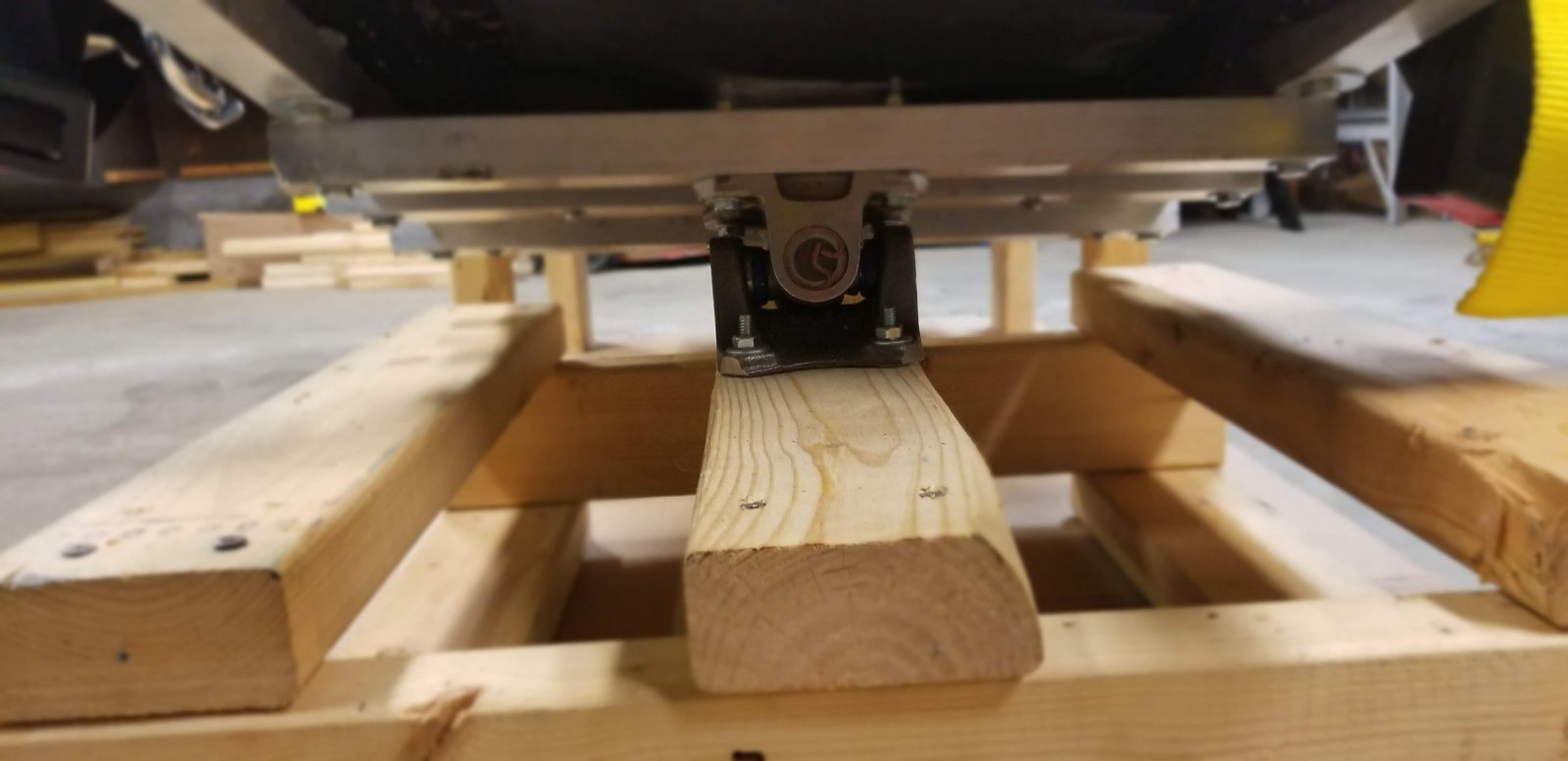

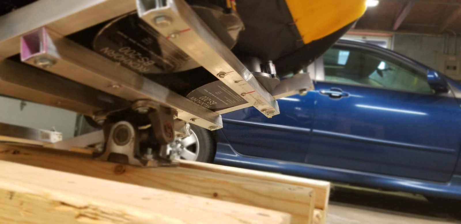

    • Build a better base frame. The image that has my seat and pedals shows that it is laid atop a inch piece of MDF that has 1000lb caster wheels. The MDF has 1 2x4 screwed down the middle as a makeshift spine to prevent flexing but it is not sufficient. I will be building a much more sturdy wooden frame to lay the MDF on top of without flex.
    • I need to drill holes in my CTC levers so that they can be mounted to my key hub assembly. I don't have steel drill bits so I may need to purchase some.
    • I only bought enough brackets to mount half of my motors. I wanted to make sure they were sturdy before buying all of them. I will need to pick them up.
    Questions:
    • What is the order of launching things? I was not able to get LFS and the GameEngine because SMC3Utils was open. I figured out that SMC3Utils was stealing the serial connection from the GameEngine so the game was not able to send serial data to the arduino/sabertooth. I am still not certain what the sequence should be. Correct me if I am wrong:
      • Launch GameEngine
      • Launch GameManager - Make sure it is connected
      • Launch Game
        • Correct?

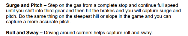

    • For Axis Assignments, Should I be setting roll as: Roll and second Roll with the Dir flag set(signifying negatvie), or should the roll axis be Roll and Sway?
    • Same question for Pitch. Is it Pitch and second Pitch with Dir flag set(signifying negatvie), or should the pitch axis be Pitch and Surge?
    • I am confused becuase I see other's axis assigments all using Pitch/Pitch, Roll/Roll. But when I run the game and monitor the Virtual Axis I see the Sway/Surge axis outputs match what the car is doing much more accurately.
    • Also the Manual states the following: manualCapture.PNG
    • So, should I follow other people's examples because they've tested and know what their doing, my own eyes, or the game engine manual when setting the axis force settings.
    • When I run a lap around LiveForSpeed, the motors are turning constantly. I think that if it detects that the pitch or roll is not = to 0 then the motor should be turning. I imagine there is a max setting somewhere that says. If pitch/roll is greater than 0 but less than 10 turn, otherwise don't turn. Can anyone point me to that setting? I've been reading the SimTools v2.4 manual, the simtools quickstart( https://www.xsimulator.net/simtools-quickstart/ ) and the simtools game engine documentation (https://www.xsimulator.net/simtools-game-engine/#Output-Testing) but I must have glossed over it.
    Thanks for any comments or advice and thanks for reading. I feel like I am making a great amount of progress on something I've been dreaming about for years and it is very exciting.
  10. Dave Irwin
    Dave Irwin New Member Gold Contributor
    Jun 21, 2016
    23
    Weirton, WV
    154Coins
    Ah, I think I understand the difference pitch/surge and roll/sway now.
    So my question is can these effects be layered? Can I use all for effects or do I have to choose 2?
    21,493
    150,578Coins
    +11,017 / 55 / -2
    There is no need to run SMC3 and SimTools at the same time, as you have found all that does is create a port conflict. The SMC3 utility is just for doing configuration for the code, it has nothing to do with SimTools itself.
    I use the Launcer application to start SimTools, then start the game: https://www.xsimulator.net/community/marketplace/simtools-v2-launcher.202/
    The Dir being checked orange or not determines which way each axis moves. Roll and sway are set opposite in the Axis Assignments, sway leans away from the corner, roll is the opposite. This is how SimTools expects a axis to be configured: https://www.xsimulator.net/community/faq/which-way-to-set-simtool-axis-movements.230/
    All rigs are unique and we all have personal preferences, so best to learn how to refine a motion profile, it takes time but the results are well worth it: https://www.xsimulator.net/community/faq/steps-to-create-a-motion-profile.228/
    Your Axis assignments are messed up. Each axis should be configured once for Axis 1, then again below in Axis 2, with the Dir boxes determine which way that axis moves.

    Progress Update:
    I have assembled my rig, hooked up and tested my bass shakers, and connected the sabertooth, arudino, power supply, motors, and control arms.
    Functionally, the setup "works":
    I am have issues that I am hoping someone can help me out with.
    Issue #1)

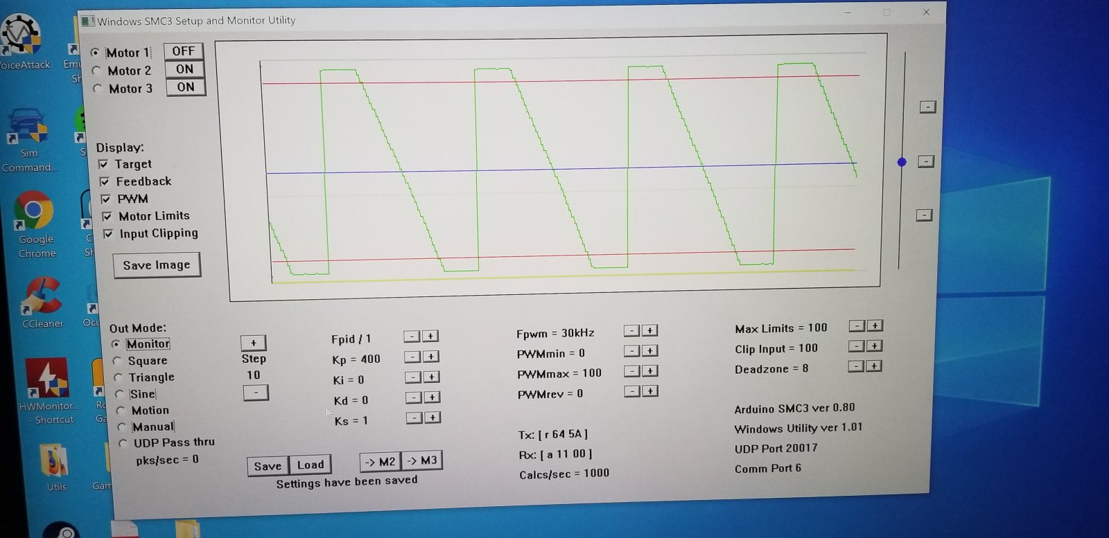

    I can control the motors when using SMC3 to adjust speed settings. When I close SMC3, the motors continue to turn non stop. The only way for me to stop the motors from continuing to rotate is to disconnect the power supply OR open SMC3, and change the Max Limits setting to such a small amount that the motors move into that range and shut down.
    What am I doing wrong? I expect to be able to change settings in SMC3, close the application and the motors to stop until I launch a game and begin racing.
    This is the tutorial I've read for setting up SMC3: https://www.xsimulator.net/communit...ket-serial-pid-motor-driver-w-softstart.9277/, but I did not see step or setting to stop the motors after adjusting settings.
    Issue #2)
    When using SMC3 the motors rotate 360 degrees, is there a setting in SMC3 that will limit the axis. The max limits shut down the motors when the reach the limit, but is there a setting that stops the motor at 45 degrees from center in either direction without shutting off the motors?
    Thanks everyone for reading and giving advice.

    One of the issues that I haven't figured out is that each time I open SMC3, the PWMax setting is defaulted back to zero. If I set the max to 100 and then close the application, the motors will continue to run. I then open SMC3, I see the PWMax setting is zero again. The motors don't change speed until I adjust the PWMax setting again. Then the change is recognized by the motors.
    Here is an example of the settings I've been trying to use. I don't normally see that pattern, it's usually a straight blue line, like this:
    Here is a quick video of me closing SMC3 but the motor continues to run as if it were still open(sorry for the horizontal to vertical orientation switch):

    Yes, I believe so. Here is what I did to test this:
    • Start SMC3 and select motor 1.
    • Set the PWMax to 0 so that the motor is not being driven by the sabertooth.
    • Set motor 1 to On.
    • Turned the motor shaft by hand.
    • The result was that the green line moved up the screen, reflecting the amount of rotation I was able to turn by hand.

    I tried swithcing the positive and negative connections based on your suggestion. I didn't notice any difference in behavior. What would be different, or more simply, how would I know that changing the postive and negatives solved anything?
    I'm going to re-read the instructions and go through all the steps again in the tutorial https://www.xsimulator.net/communit...ket-serial-pid-motor-driver-w-softstart.9277/. I have to be doing something wrong.
    The main questions I have are:
    • When smc3 is behaving like it is supposed to. Am I able to set the values of PWMax without the motors spinning?
    • If the motors always spin when adjusting PWMax in SMC3, are they supposed to stop spinning when the applicaiton is closed?
    • If the motors always spin when PWMax is set to a high value, is there something I'm supposed to do to stop them from spinning until Simtools takes over and controls the motors?
    • There is an On/Off button on the top left hand side of SMC3. It is used to toggle the motor on. Is there anyway to toggle the motors off within SMC3?

    I've started from scratch:
    At this point. I have set the settings according to the tutorial.
    Here is a video showing what the target line and feedback line look like when I adjust the PWMax to 20. It also shows the motor rotating and pushing the control arm.
    What I don't understand is:
    How do I set the PWMax to 100 or 200, close the SMC3 application and launch simtools without the motors constantly turning?
    • Are they supposed to stop automatically when SMC3 application closes?
    • Is there some setting in the Arduino code that I need to change?
    • Do I have to set a deadzone in the SMC3 software and hand turn the motors so that they fall within the deadzone in order to prevent them from moving?
    In the Tutorial: It says after you've set the PWMax you are done. When are the motors supposed to stop turning? https://www.xsimulator.net/communit...ket-serial-pid-motor-driver-w-softstart.9277/
    • 17 - Now slowly, increase PWMmax… at some point the motor should start to move. When it does check the “Green” feedback line is moving toward the “Blue” target position.
    • 18 - Set Step back to 100 and repeat steps #13, #14, #15, and #16 above for motor 2
    • 19 - Motor driver setup is now complete but the PID controller will still need to be turned to work properly with your particular setup. This will be done later though and is not included in the scope of this tutorial
    Is the green feedback line in my video not "moving toward the blue target line". The are both moving horizontally across the same axis but my feedback line is not moving across the vertical axis to meet the target line.
    Thanks for taking the time to read and for any possible suggestions.
    Dave

    I think that while you have pwm at 0 or motor 1 or 2 off on the utility. You should loosen your flex coupling and adjust the "hall effect" pot to the center line independent of lever arm (motor position). Step one. Then rotate the lever arm (motor) to a position your seat or ujoint is at the middle point of it's travel (your choice where you figured it should be at rest.) Only than should you bring up pwm or enable the motor. If it doesn't follow moves over your limits you've set than it may be reverse leads time. You'll know as it turns motor off (top left utility). In my sketch is a line "//reverse motor" remove the // to reverse the motor if your problem is/was like mine. Hope it helps. No feedback in your video from the pot should be moving. As you adjust the pot by hand as before you'll see it move on the utility or it's not wired correctly/bad pot...
