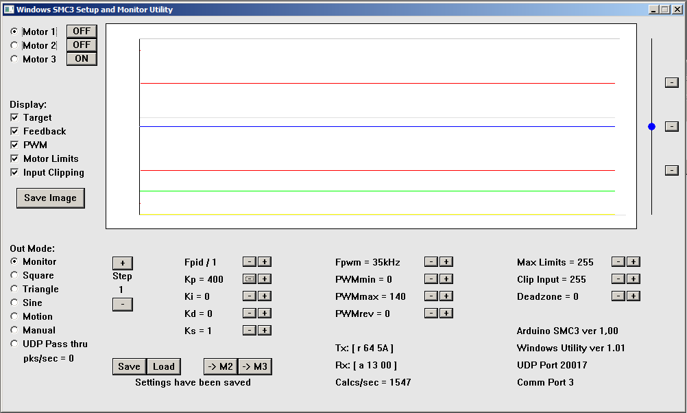

  16. giorgionrg
    giorgionrg New Member
    Feb 2, 2020
    8
    Technician
    92Coins
    Hi Noorbeast,
    i've a new problem...
    I've done several tests but the issue I'm facing seems to be not connected to a bad wiring.
    Now when I turn on the system the motors move but after a short rotation they stop(both pot are connected to the motors).
    As I try to move whatever pot manually it doesn't do anything. The motors seem to be stuck.
    I debugged the feedback positions in arduino monitor and found out that those have not reached the limit values set in the code.
    In details:
    -Motor1 moved from 512 to 214
    -Motor2 moved from 512 to 771
    (both pot were initially set to middle position).
    Moreover when I run Simtools the motors do not move.
    any suggestion?
    thank you in advance.
  17. noorbeast
    21,659
    151,608Coins
    +11,043 / 56 / -2
    SMC3 has to be fully configured and working as expected before using SimTools.
    Are the motors ground isolated?
    Do the motors rotate freely in either direction if directly connected to power?
    Double check the pots, their wiring and please post pictures of all of your settings.
  18. giorgionrg
    Feb 2, 2020
    8
    Technician
    92Coins
    Hi noorbeast,
    the motor are ground isolated and rotate freely in either direction if directly connected to the power (pots disconnected).
    Settings attached below.
    Thankyou
  19. noorbeast
    21,659
    151,608Coins
    +11,043 / 56 / -2
    Are the motors getting power when they get stuck, if not check if PSU has been tripped.
  20. giorgionrg
    Feb 2, 2020
    8
    Technician
    92Coins
    No, when the motors stop don't receive current. The PSUs are ok, I measure both at 12V.
    I made more tests and i noticed that, unplugging the pots to the motors, all seems to work properly.
    I've a question: is it normal that when I power on the system the motors spin without me giving any commands?
    Note: I didn't modified the .ino code.
    Thankyou.
