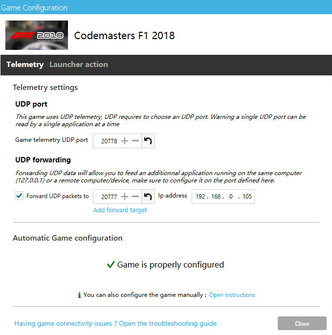

Usually UDP data can be received by only one application, so to get around this limitation and take profit of any other app you may want, SimHub offers you to "forward" the udp data to another port and/or computer, as explained on the SimHub GitHub page: https://github.com/SHWotever/SimHub/wiki/Sharing-UDP-data-with-other-applications
Here is @Petemnz's F1 2021 example: https://www.xsimulator.net/community/threads/f1-2021.16527/page-2#post-223054

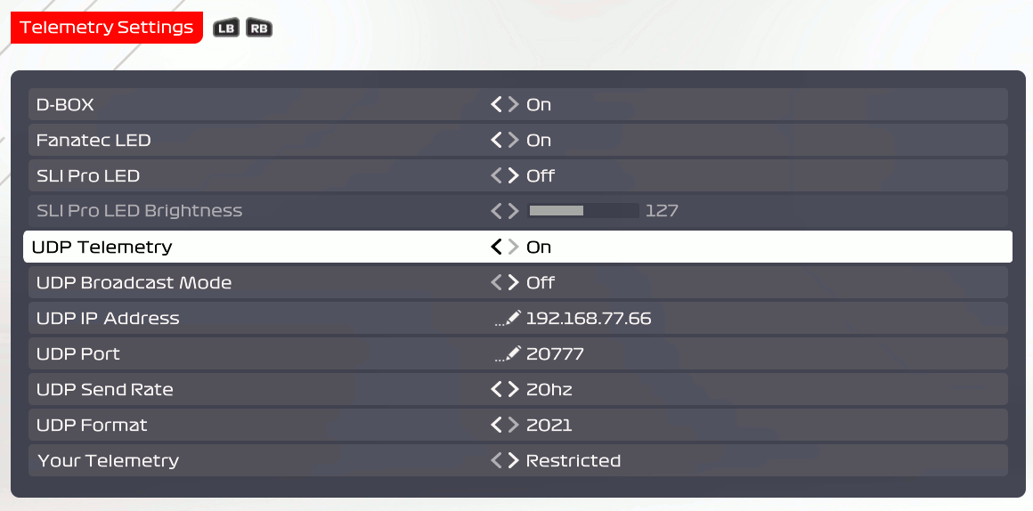

[​IMG] [​IMG]
UDP On
UDP Broadcast mode On
UDP IP address 127.0.0.1
UDP port 20778
UDP Send Rate 60Hz
UDP Format 2021
Your Telemetry Public
Used 127.0.0.1 for same pc
Ignore title it is for F1 2021
