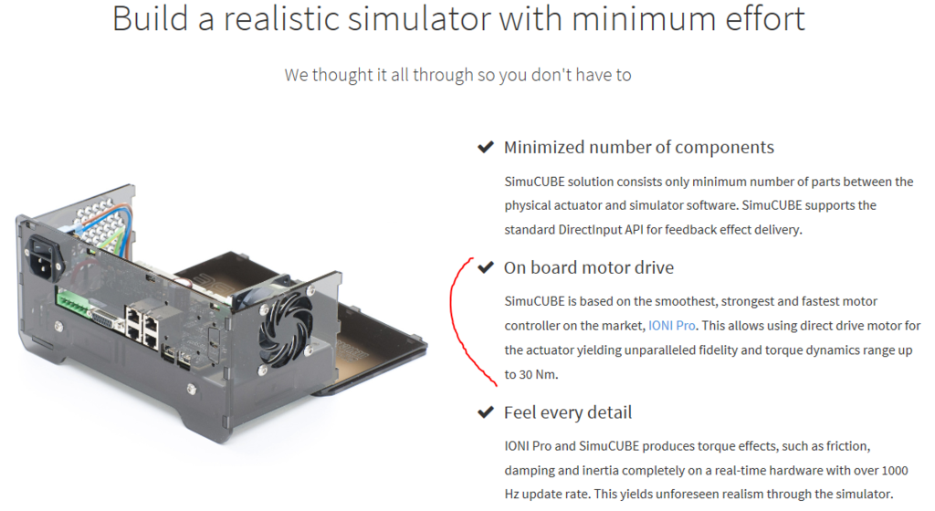

    Well it look like OSW/DD wheels are here to stay, so we might as well start our Own Build thread and Info base,
    Ill start out with a basic build list and links for more detailed info on How to make your Dreams come true with REAL 1:1 force.
    wiki available here
    https://granitedevices.com/wiki/SimuCUBE
    The most important part being the Cube, Aka Granite devices Simucube, In combo with the Ioni Pro HC makes this a combo you cant compete with.
    https://granitedevices.com/store/simucube-force-feedback-controller-board.html?options=cart
    https://granitedevices.com/store/ioni-pro-hc-servo-stepper-drive.html?options=cart
    If you can click in a GPU to a Mobo, You can install a Ioni Pro HC.;)
    Next up is PSU, You need a minimum of 48v and from 480w upwards of 1000+ watts if you want to get crazy with the Overclock and have a Big mige. Ask for details if curious.
    I went with a 600w cheap Ali Express PSU which ran me 60USD.
    Mounted the Cube on 15mm stand offs and Drilled the stand offs into the PSU case.
    I decided to torture myself and make this custom box, which in the end was a fun project as much as I bitc* about it. :p
    Nice and square edges to work with
    Panel all cut out for connections,
    You'll need a Fan on the Cube as well. 5v 80mm did the trick nicely, Mounted it to the PSU intake side and tested with my E cig how the Air flow went through the case, Cube is Nicely chilled. Mission successful.
    And Finished product
    Motors of choice can be found here, I HIGHLY HIGHLY suggest the small mige with a 600w PSU exactly as i did for OC'ing reasons.
    https://granitedevices.com/wiki/List_of_motors_for_SimuCUBE
    If you Want a link to Get ahold of Mige motor mfg Directly, PM me and i can put you in contact with a Sales agent.
    Next up will be Motor Wiring and Encoder wiring.
    You'll want to pick up a Couple Ferrite sheilds (also work great on Motion controllers) And wrap up the power wires for the motor. As well as a DSub15 2 row
    Encoder wiring for Small Mige.
    Next Motor mount, Ya sure you can go buy a Fancy pivoting mount, but my whole wheel deck pivots, so no need to waste 100$ on a fancy mount, Ill just make my own....Enter some 1" square Alum Bar,
    Next will be Quick releases and Wheels which are very open to the imagination, Anything from a Converted Fanatec BMW/Porsche/Formula 1 wheel can be converted for as cheap as the QR of your choice and a Teensy LC chip. Teensy being a whopping 12$ and the QR can vary pending which style your after.
    Here's a little teaser of something to come. Shameless plug Check out OpenSimRigs.com for more details
    I cant think of much else for right now, but ill edit this post with needed info as i remember.:p
