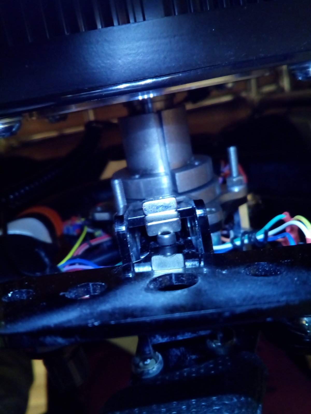

    impressive job, and very accurate
  3. RacingMat
    2,234
    20,895Coins
    +2,084 / 21 / -2

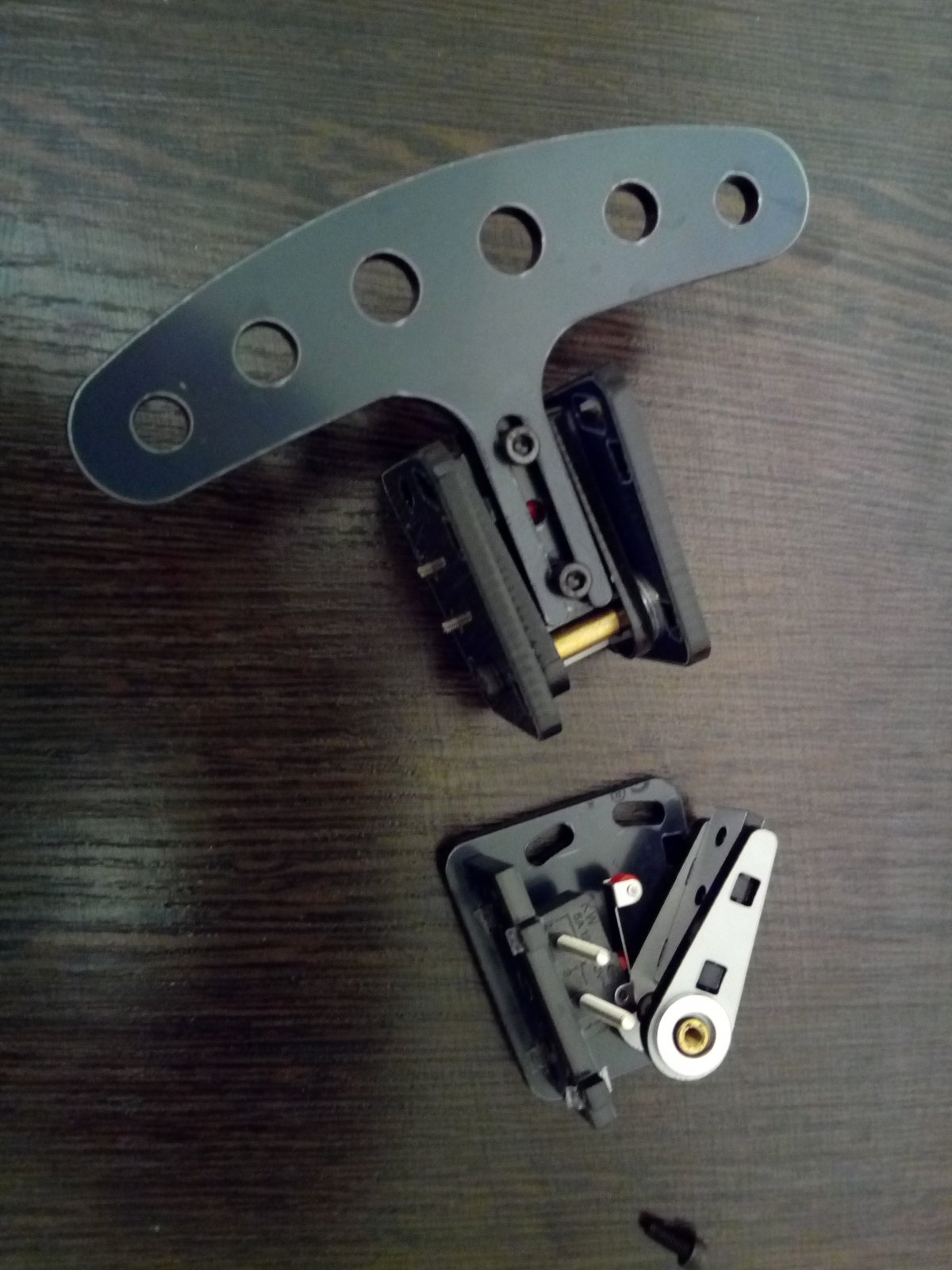

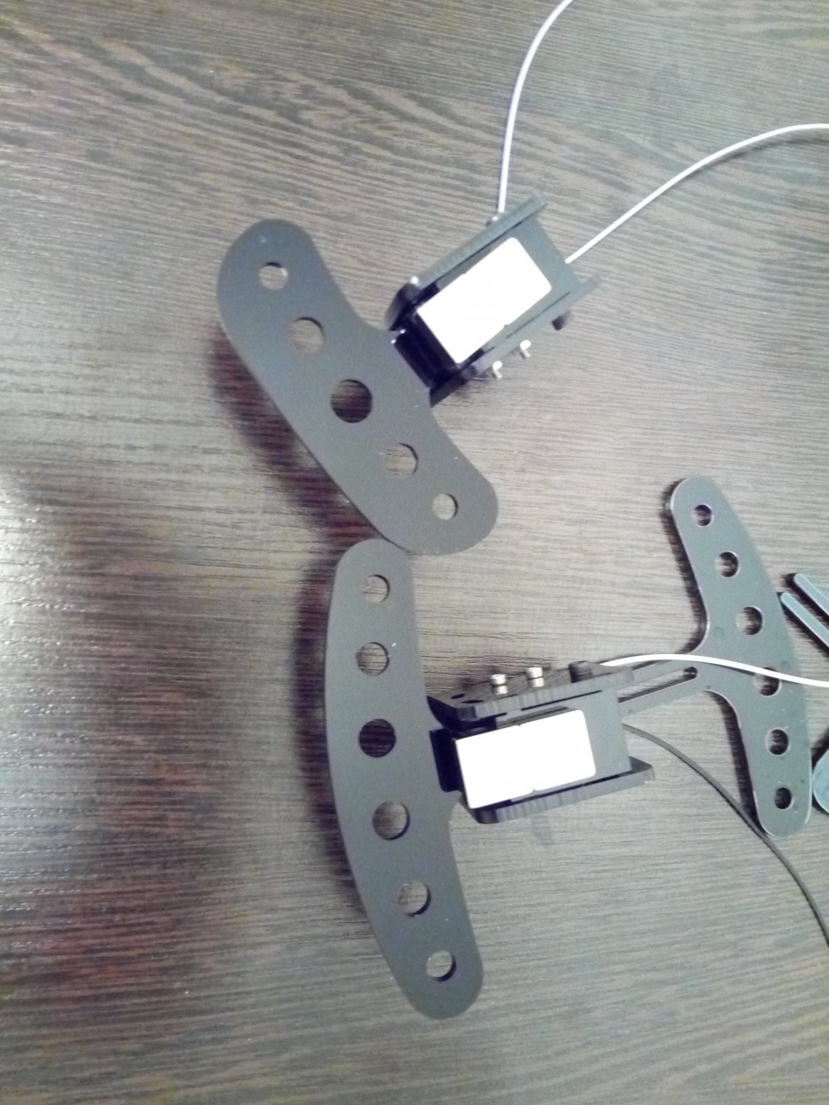

    @TOPMO3 : nice wiring!
    nice magnet paddles! you have designed the paddles yourself?

    @RacingMat , yes its my design, 1st version. Fortunatly for me they are comfortable enough, but I'm going to change design a little bit for more tuning options :)
    @Nick Moxley , no QR yet. I have only one rim, so no need for QR (at least for now ))

    Cool! What is the cutting technic? and the material please ?
  7. TOPMO3
    TOPMO3 Active Member
    May 12, 2015
    133
    Russia
    890Coins
    +201 / 0 / -0
    Its laser cutted 3mm acrylic. Its not so nice as carbon of course, but does job well and very cheep - both paddles cost me ~ $10 :)

    Thank you for sharing these drawings.
    What kind of magnets have you used?
    I guess you have just glue them to the top part?
  13. TOPMO3
    May 12, 2015
    133
    Russia
    890Coins
    +201 / 0 / -0
    @prodigy
    yes, I glue them to the top part. In fact, there are 3 pieces of magnets - 2 of them glued to the top and one is between those 2 and a bolt. Its hard to take good picture but I tried
    Last time I used neodim magnets, 2 on top - 15x15x5 with 5.31 kg force and 1 in between - 15x8x5 with 3.41 kg force.
    They are bigger than in OP
    I know 3 pieces of magnets is not so optimal design and may be in next version I switch to standart 2 pieces

    @TOPMO3 .have you copied these from somewhere. i get my ascher paddles tomorrow so will see how the magnets are on those
  15. TOPMO3
    May 12, 2015
    133
    Russia
    890Coins
    +201 / 0 / -0
    Its my own design (not very optimal) if you mean this.
    I believe Martin's and probably every other shifters use two magnets - one on the top and second on a paddle itself, so magnets interacts with each other. In my version magnet interact with bolt on a paddle.

    yes i can see it now. the first picture threw me as i wasn't sure what i was looking at
