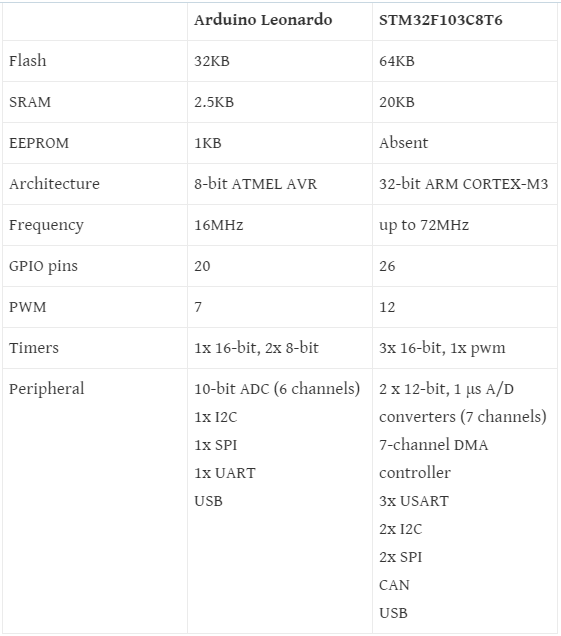

    For the project I choose little STM32F103C8T6 minimum development board. Its more powerfull and cheeper then Arduino. For example, here is brief comparison with Arduino Leonardo board
    One big drawback is that you need additional external programmer. But its not expensive also, total price for mini board + programmer is still comparable with Arduino clones.

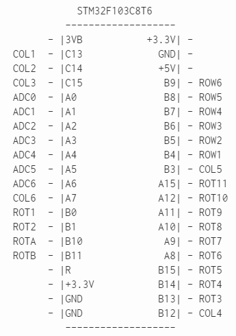

    Schematics of the board
    Here is pinout you get after flashing the firmware first time:
    Also I programmed small PC-based app named OSHStudio, which allows you to choose a function for each pin. Pins’ functions can be selected in the «Pins Configuration» tab, also here you can choose your board type. Here is how the initial pinout looks in OSHStudio, when you click «Get Config from Device»:
    Buttons
    When buttons wired in matrix, columns have to be connected to Button Matrix COLUMNS pins, rows — to Button Matrix ROWS pins. Single separate buttons (not matrix), can be connect to «Single Button +3,3V» or «Single Button GND». If you connect button to «Single Button +3.3V» than connect the other side of button to +3.3V, if you connect button to «Single Button GND» than connect it to GND. Here is an example of matrix wiring:

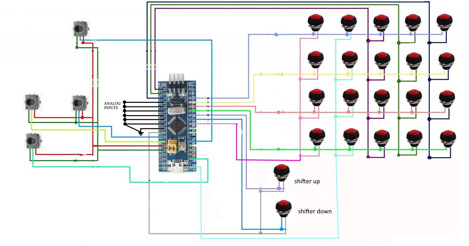

    TOPMO3 i have a problem.
    I had to reassemble the button box as some buttons where not working and my supplier also mixed up a few n/c buttons in my order.
    sorted out the buttons to be all n/open and all working.
    Now my issue is none of the buttons will work :(
    The encoders work fine.
    The 2 shifter buttons are working but show the same button number in the game controller properties.
    Hope you can advise and possibly show me where i have gone wrong.

    Hi @razzor13bt
    You know, your layout seems correct to me. Can the problem lie on a hardware side - i.e bad connection/soldering etc?

    sat late this afternoon with it.
    Resoldered with new thicker wire, not the wire breadboard jumpers the electronics shop supplied.
    also used a multimeter and checked continuity and also put it on ampmeter to use to bridge terminals on the board.
    noticed occassionally a light lit up on the game controller display, was when i bridged col6 with row1 or row2.
    Turns out its the same light that lights up when i touched the row 1 or 2 terminals. cant recall properly but it was number 27 or 29 in the game controller display.
    Will try again tomorrow evening after work.

    I had a chance today to work on it. spent last 3 hours checking everything.
    I only get the following buttons to work as per pinout pic in the 1st post.
    As mentioned before all 4 encoders work.
    I get b4-row1 working with col1-c13, col2-c14, col3-c15, col5-b3, col6-a7.
    col4-b12 does not work.
    row2, row3, row4, row5, row6 all do not work with any of the columns.
    Have to try and get off work to go and buy another board in case it is the faulty part.
