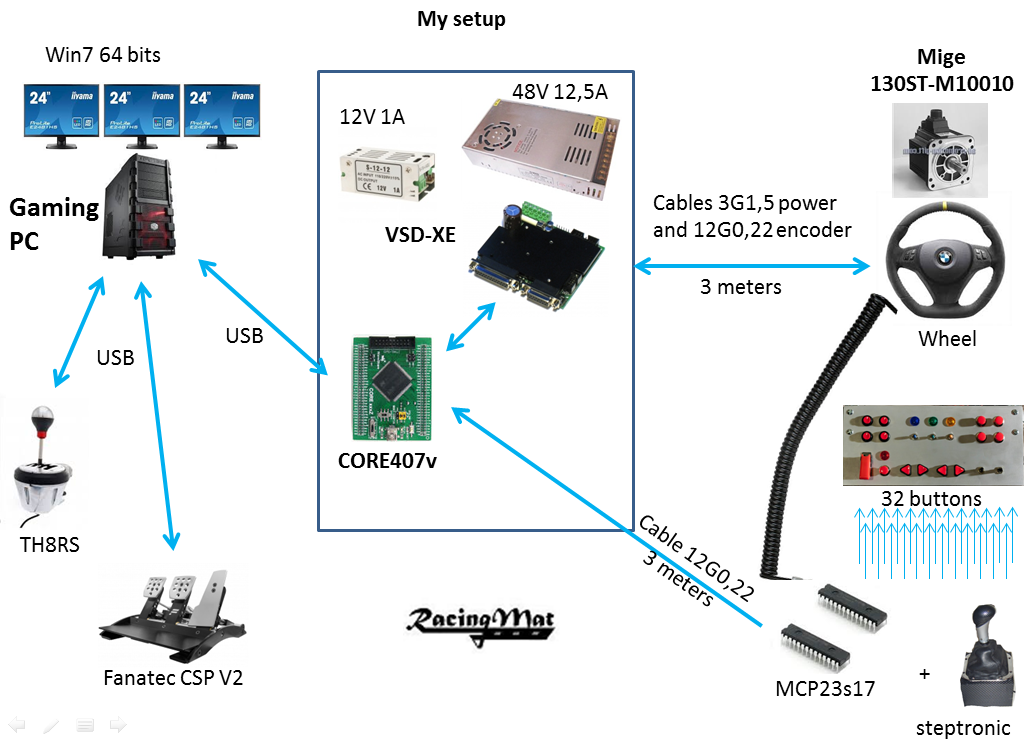

    Principle:
    Serious DIY steering wheel are based on boards (LPC1768 pack, disco STM32...) which are programmed to be seen as USB HID device.
    Then the board read Direct input information sent by the game to windows. Straight and forward!

    Shopping List:
    - VSD-E
    : motor driver that convert 48V DC into 3 phases power
    + FTDI cable 5V to setup the driver
    GraniteDevice http://granitedevices.com/
    VSD is out of stock at Granite but can be found elsewhere.
    The IONI is expected soon to replace that board ;-)
    - 12V 1A power supply
    - Moteur Mige 130ST-M10010
    [​IMG][​IMG]

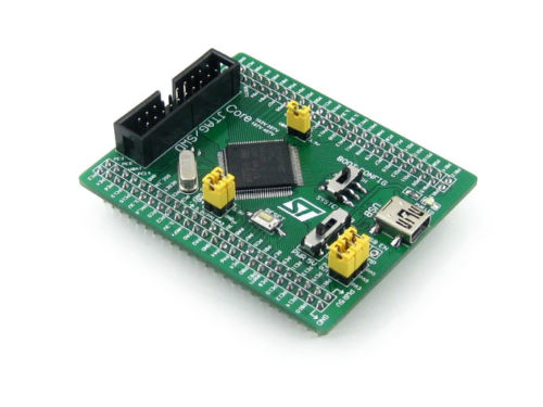

    - STM board CORE407V STM32F407VET6
    http://www.aliexpress.com/item/STM3...d-Suitable-to-meet-the-user-s/1294139642.html 24€
    http://www.ebay.com/itm/Core407V-ST...937?pt=LH_DefaultDomain_0&hash=item3cc78d6be1 22€

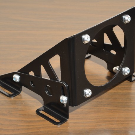

    - 48V 12A Power Supply
    - power dissipation resistor 200W 10ohm or 2 resistors 100w 5ohm
    [​IMG][​IMG]

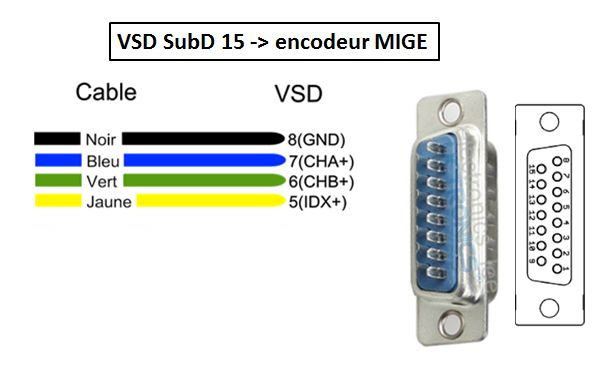

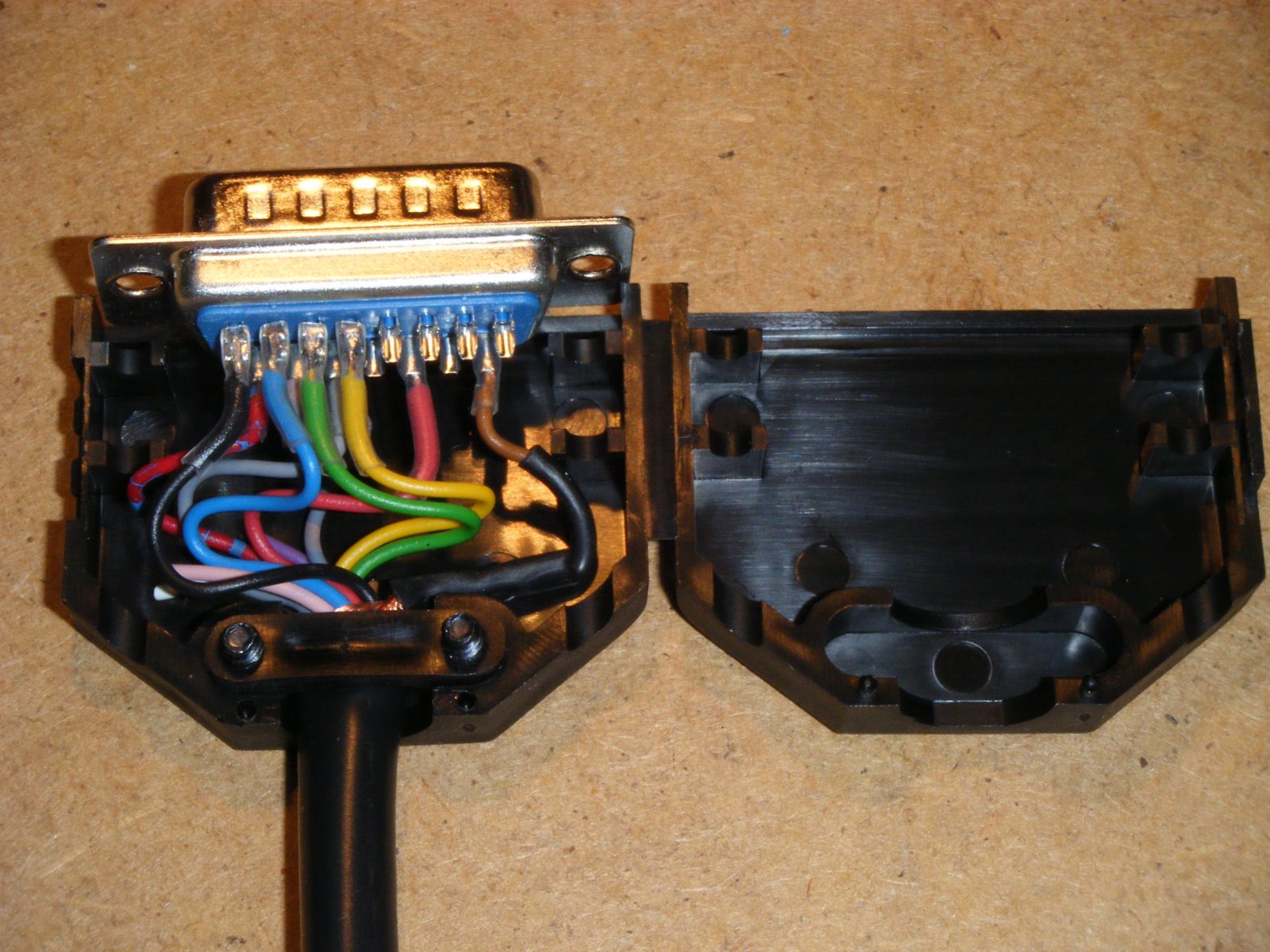

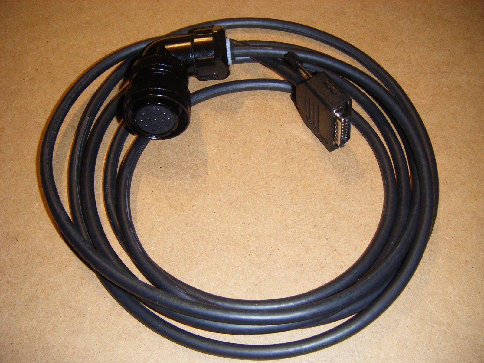

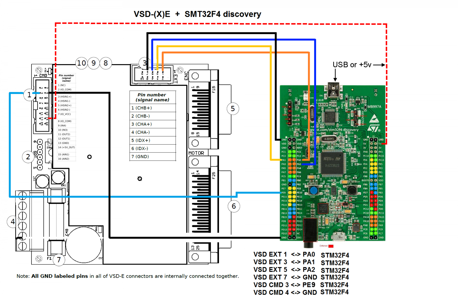

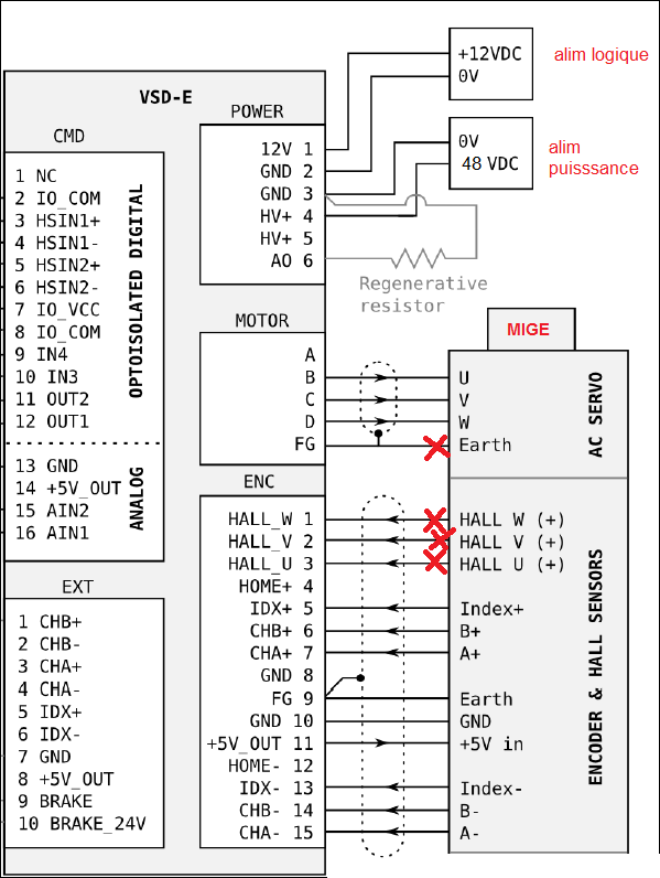

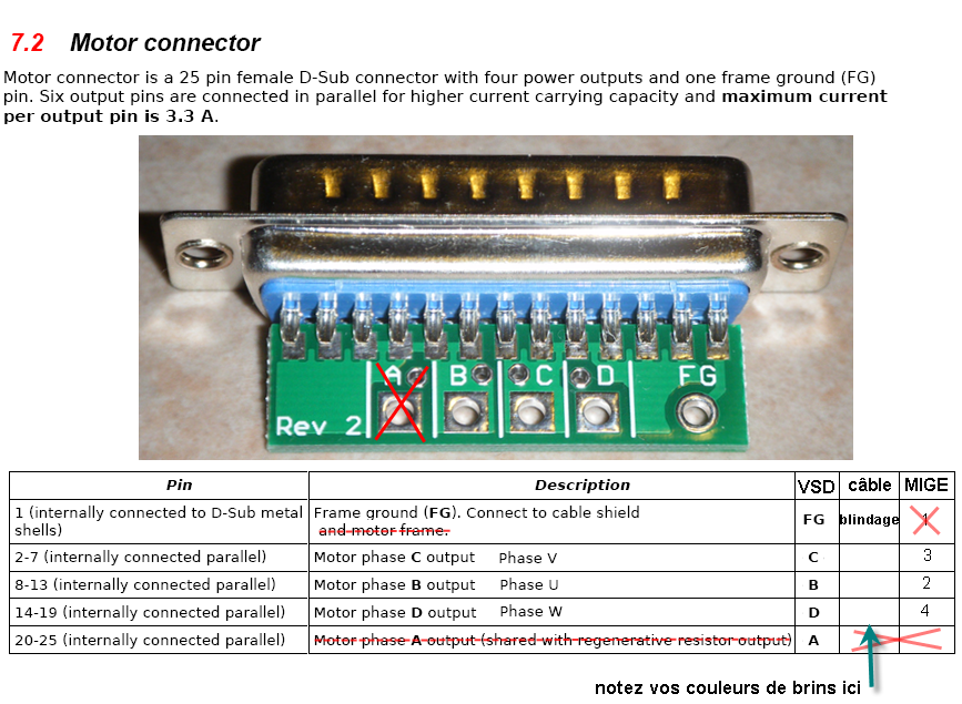

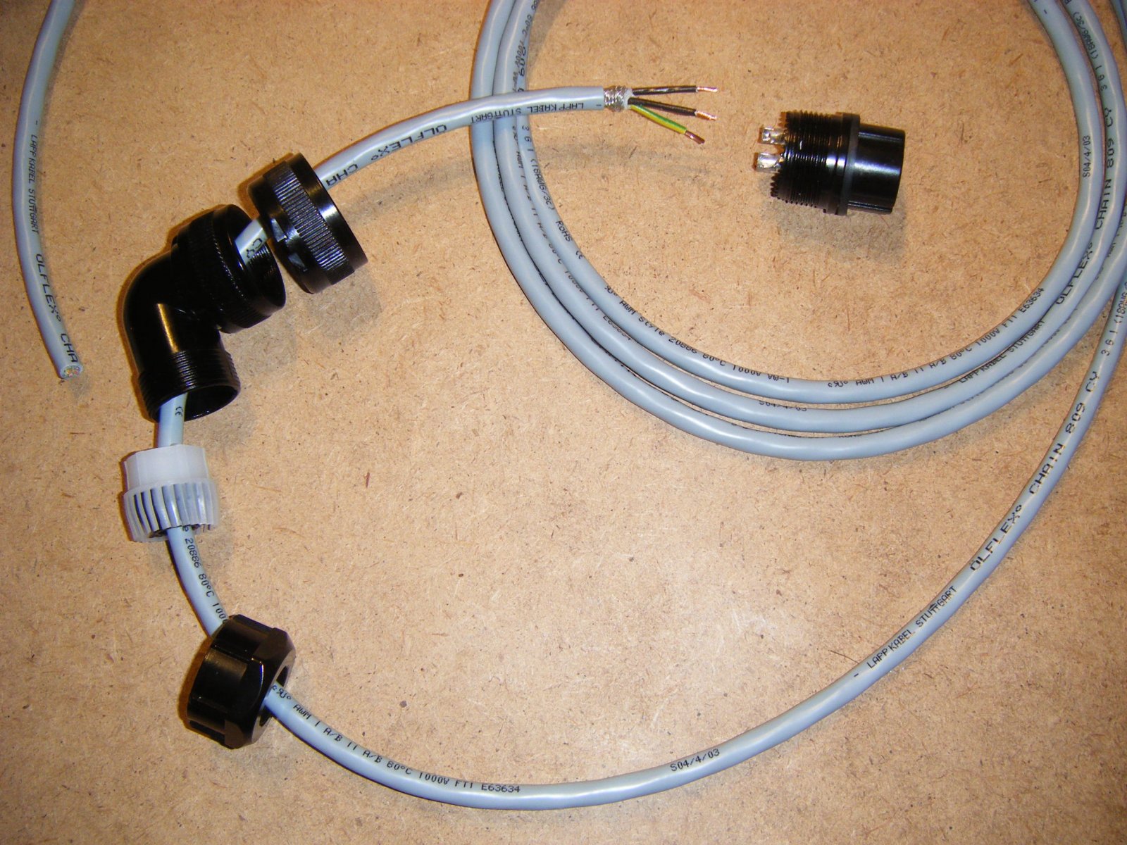

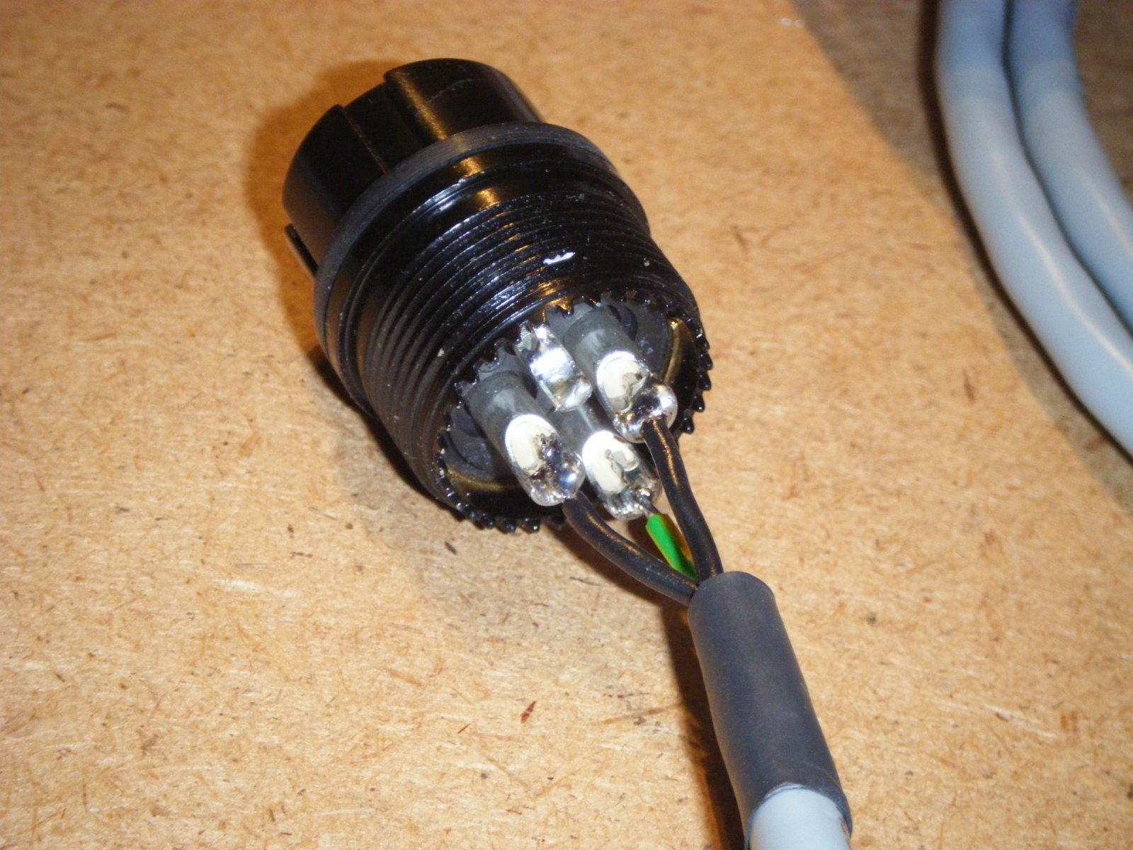

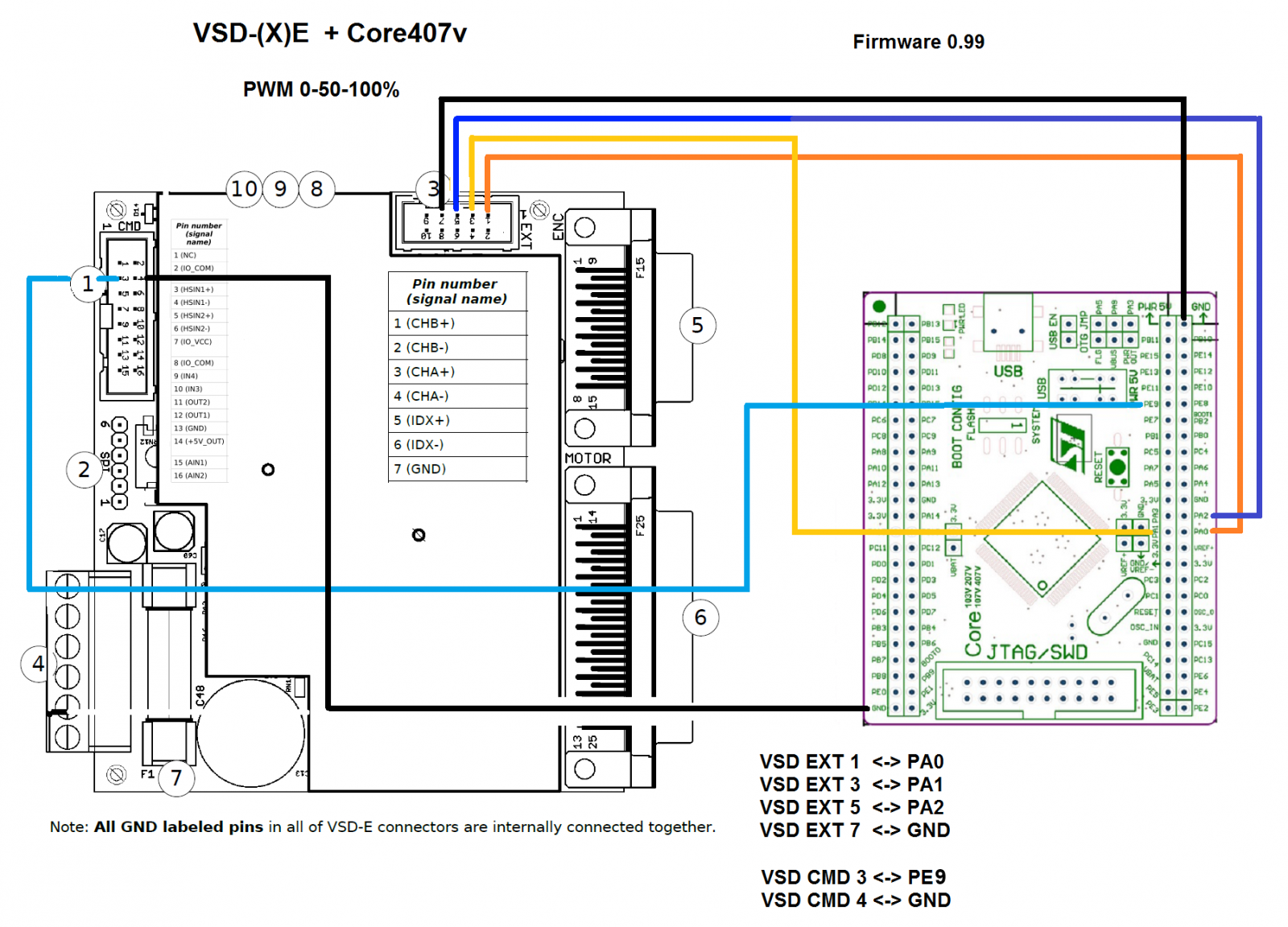

    Wiring between STM32 and VSD:

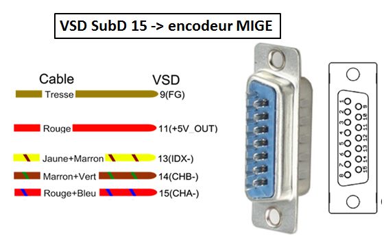

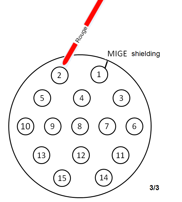

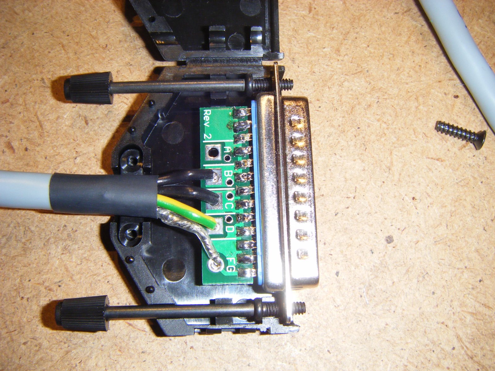

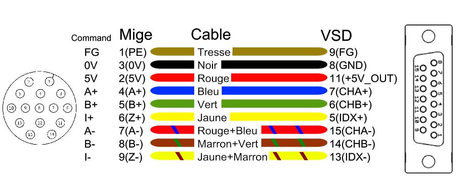

    Wiring between driver (VSD) and motor : power 3 phases
    Wiring between driver (VSD) and motor : encodeur
    741446CblageEncoderMIGE44.png 471819CblageEncoderMIGE34.png 707185577001CblageEncoderMIGE24.png 184772DSCF9753.jpg
    __________________
    I recommand to use a Core407V versus Disco to have a simplier setup (only 1 cable) but if you use the Disco: here is the wiring diagram

  15. RacingMat
    2,237
    21,035Coins
    VSD and Argon are working similarly with the USB STM35 board. The wiring is available on MMos topic or bberger's
    Argon uses the 230VAC to turn it into 3 phases
    VSD needs 48V DC to turn it into 3 phases​
    VSD + PSU 48V is cheaper than Argon
    VSD is running out of stock and is replaced by IONI (not yet available, still under beta test by Granite)

    @RacingMat Is that VSD the E or the XE?
    Also the ioni, asked them back in jan, no date, just asked again so well see.
    How come you aren't using the discovery stm board?
  20. RacingMat
    2,237
    21,035Coins
    since nov 2013, VSD-E is flashed as VSD-XE: no difference
    i'm using SMT32 core407v but it's basically the same as disco SMT32F407
    same chip but different form factor
