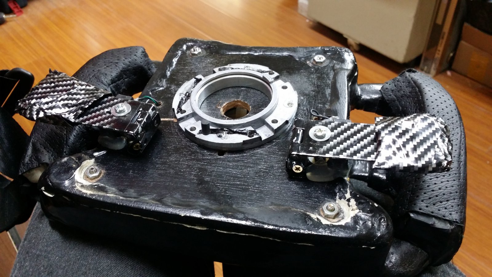

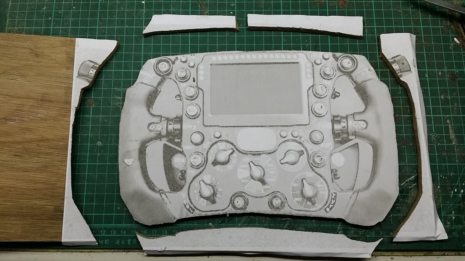

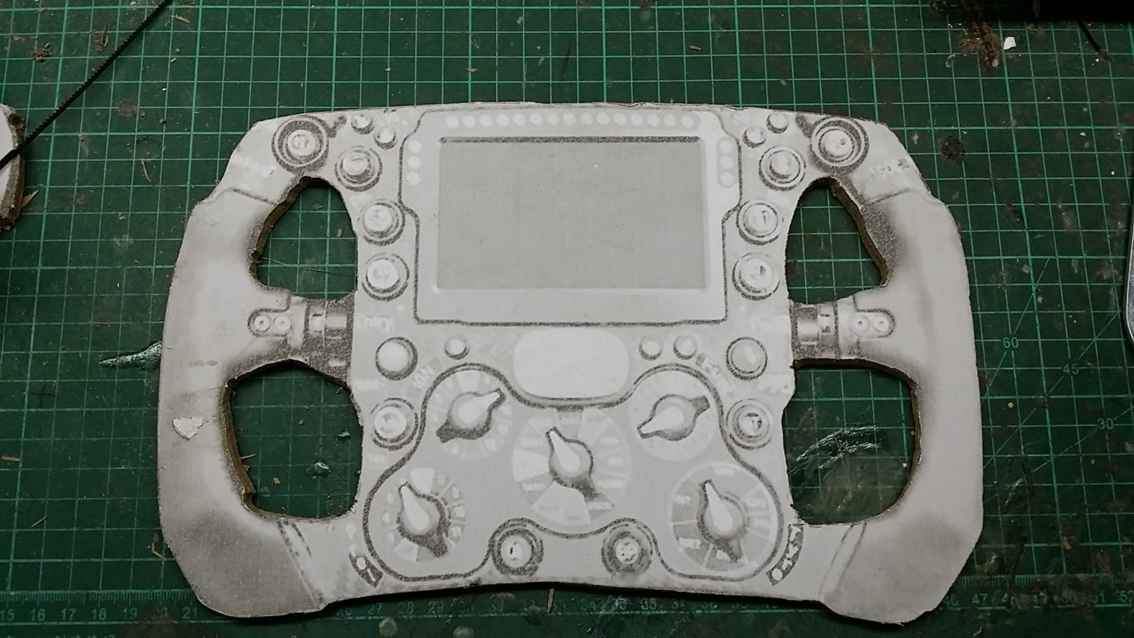

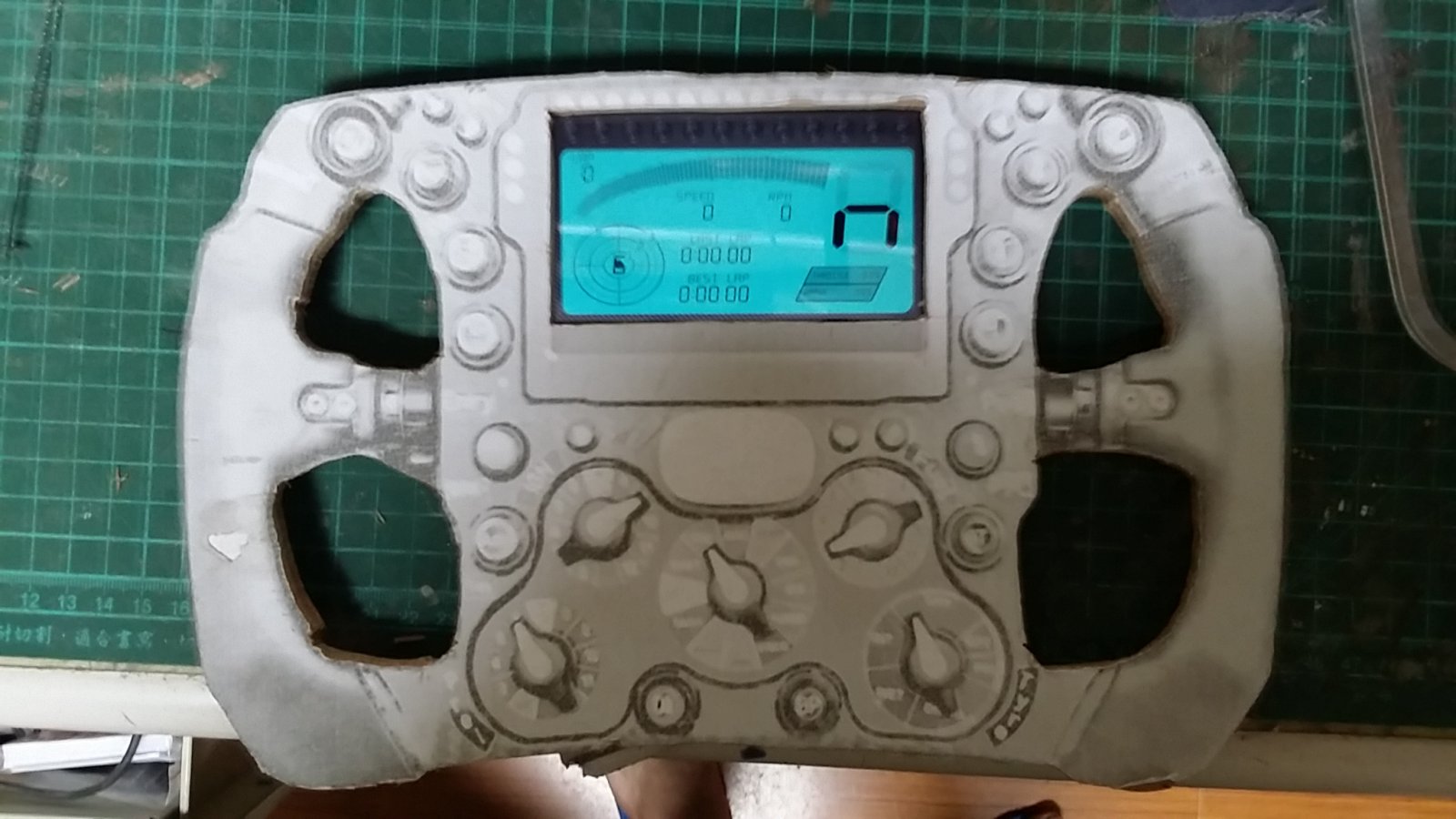

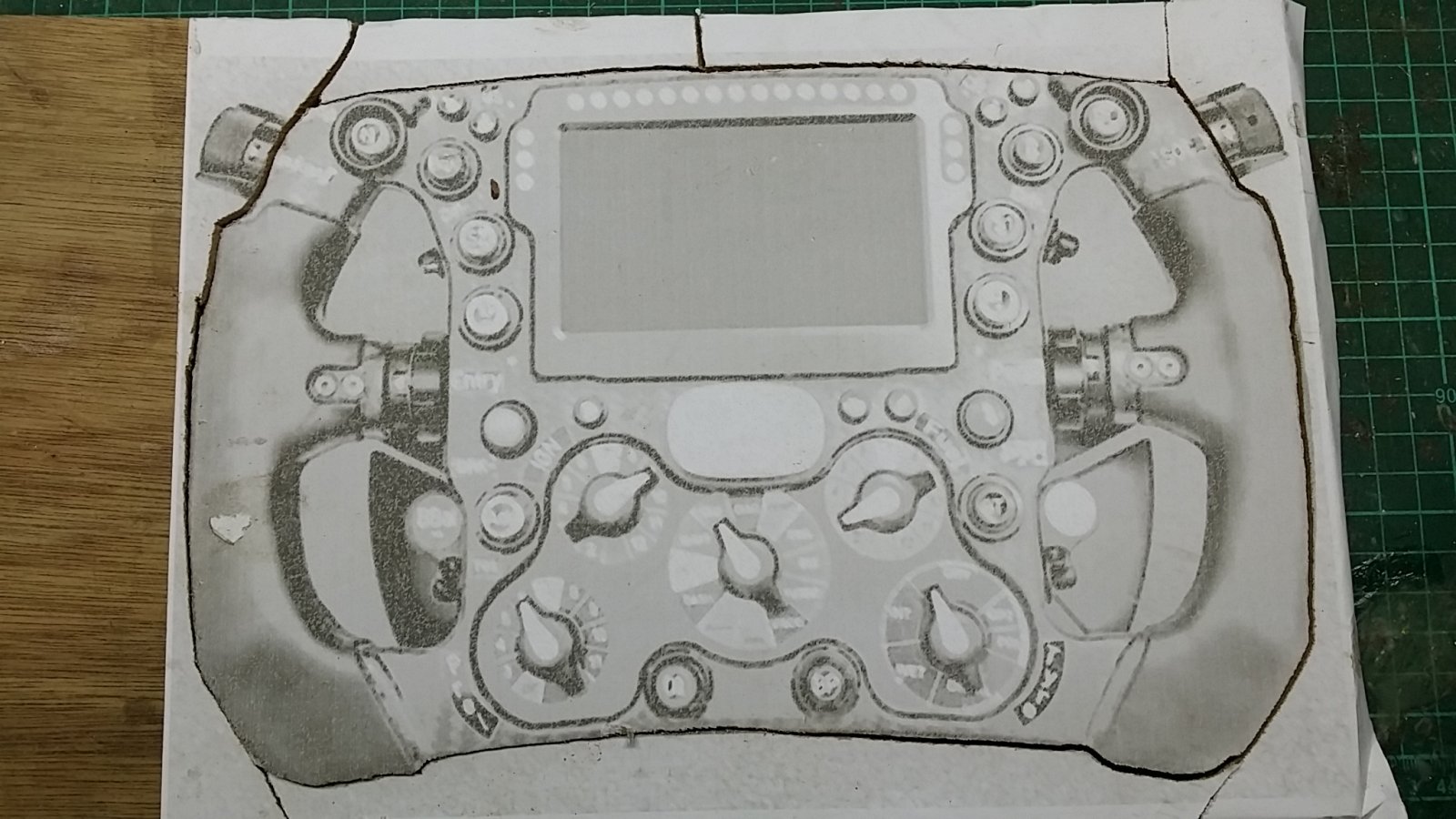

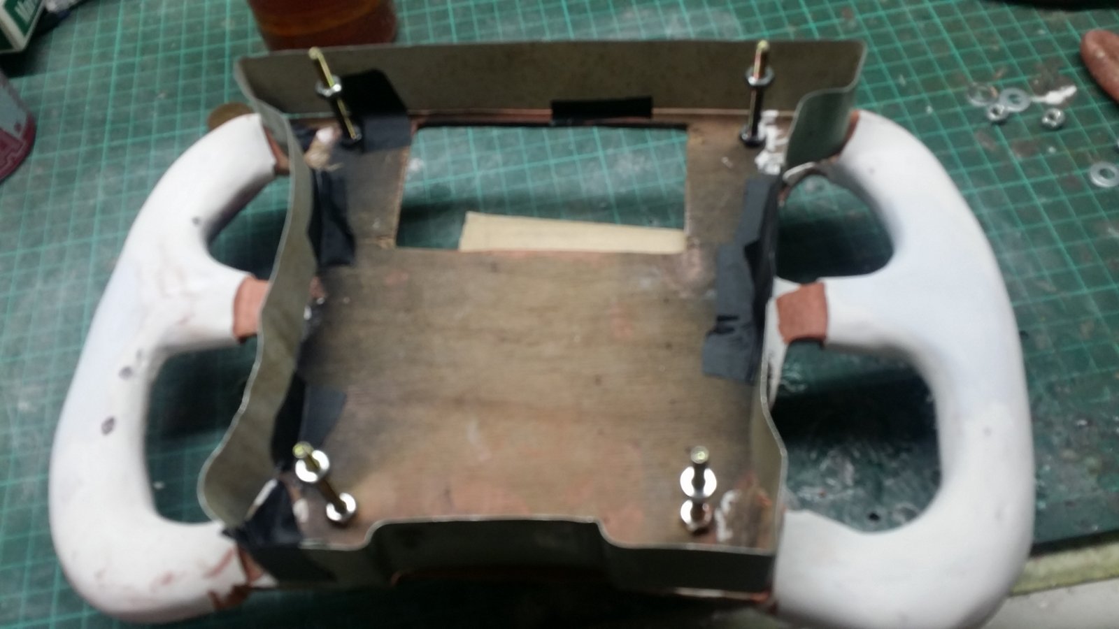

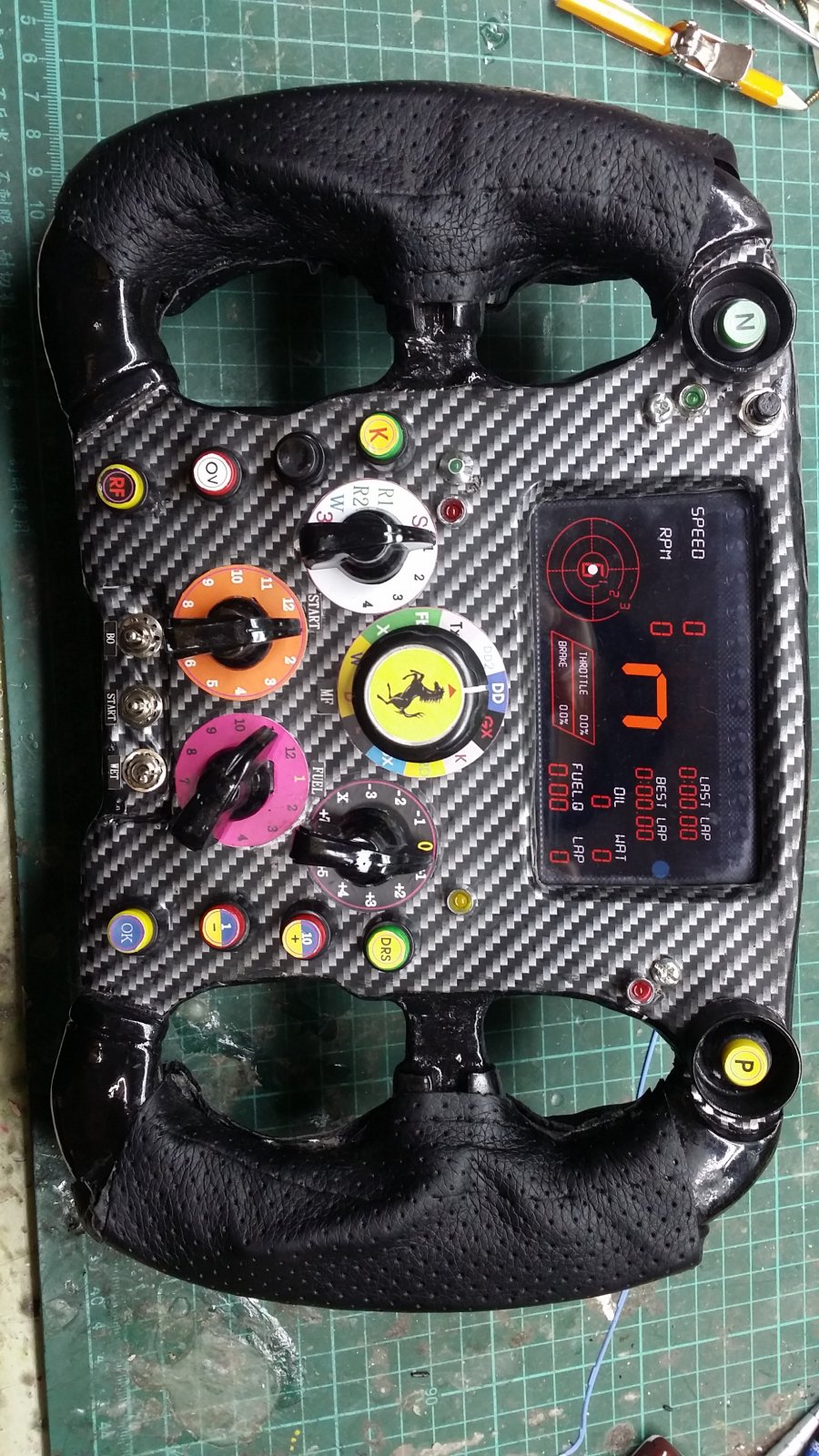

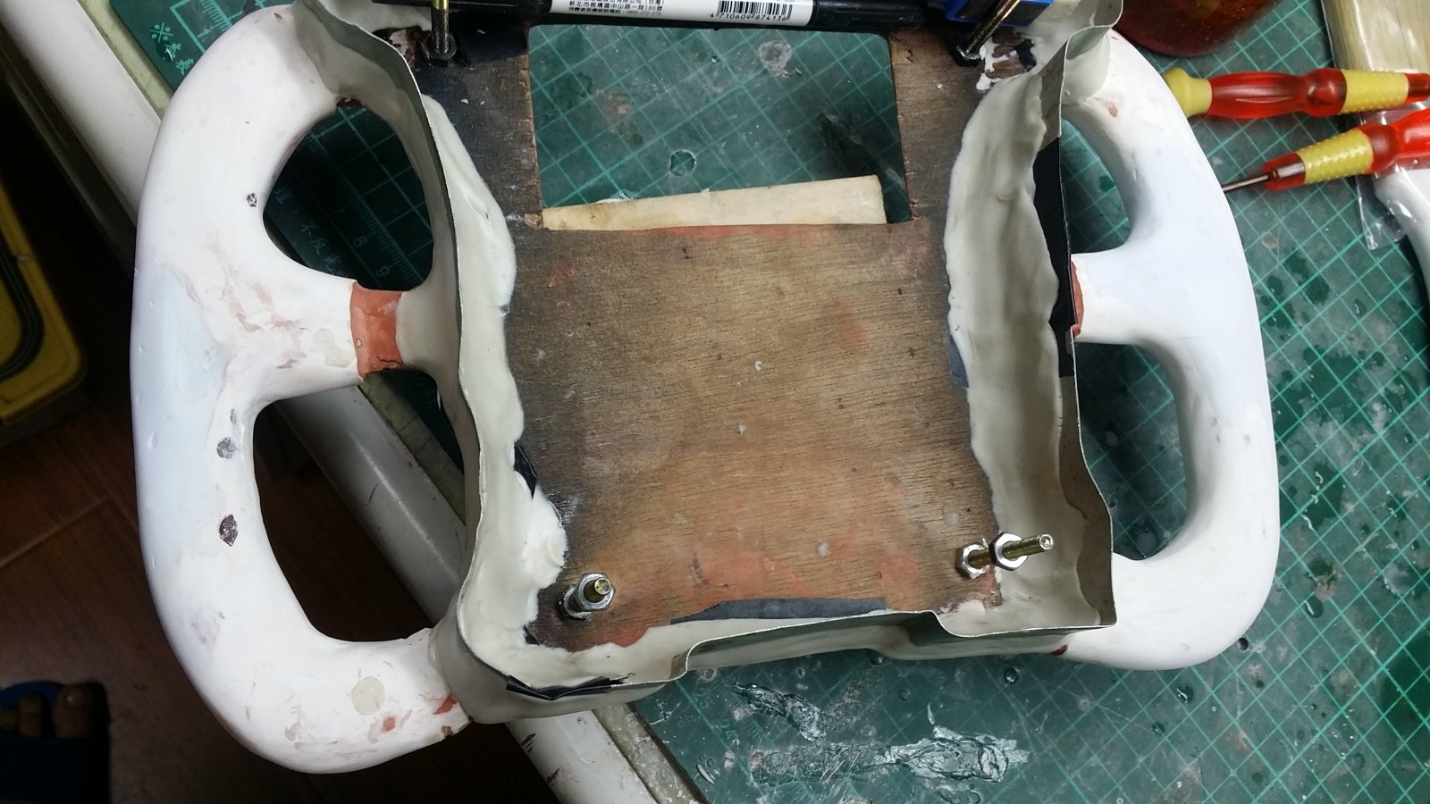

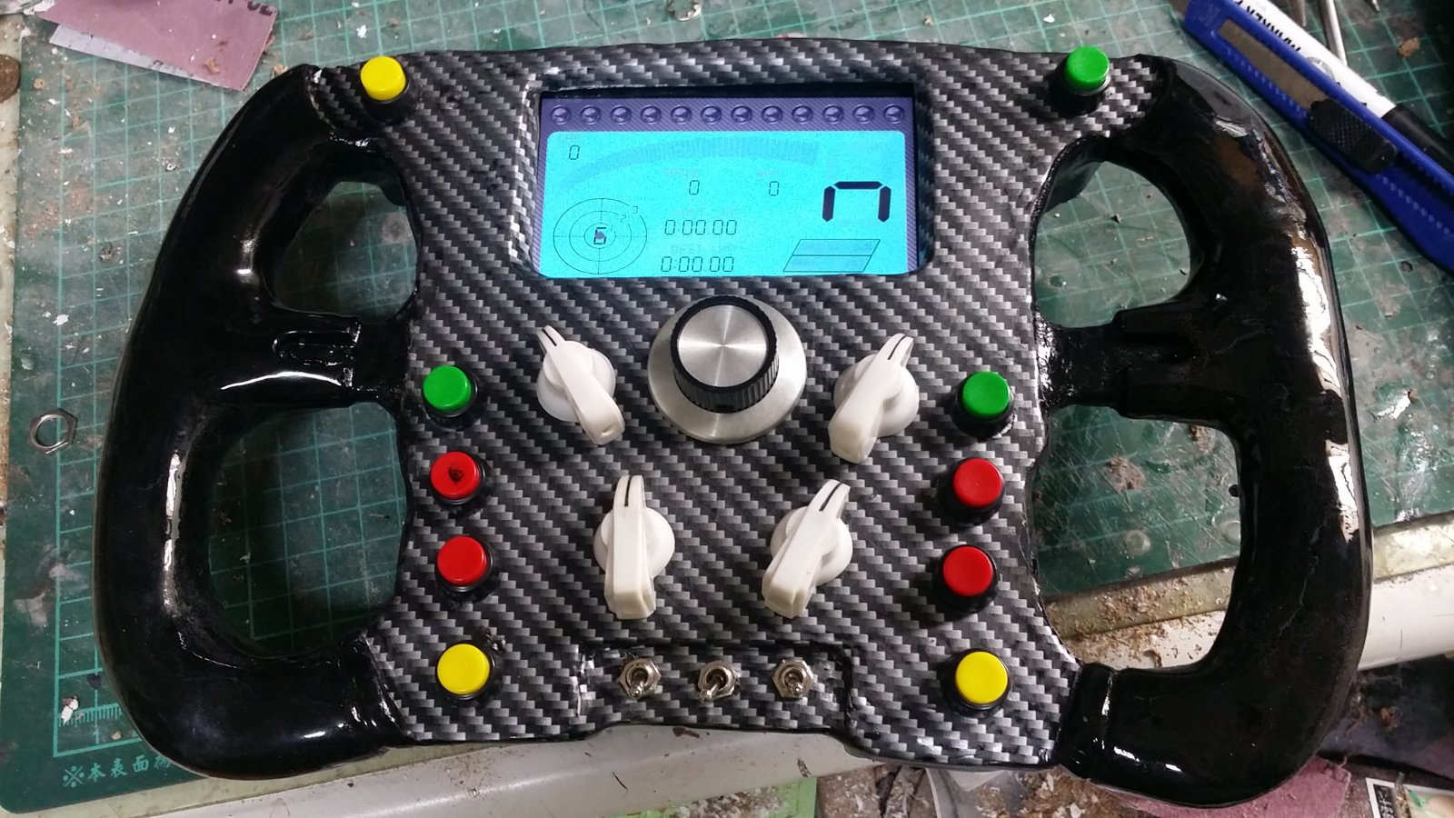

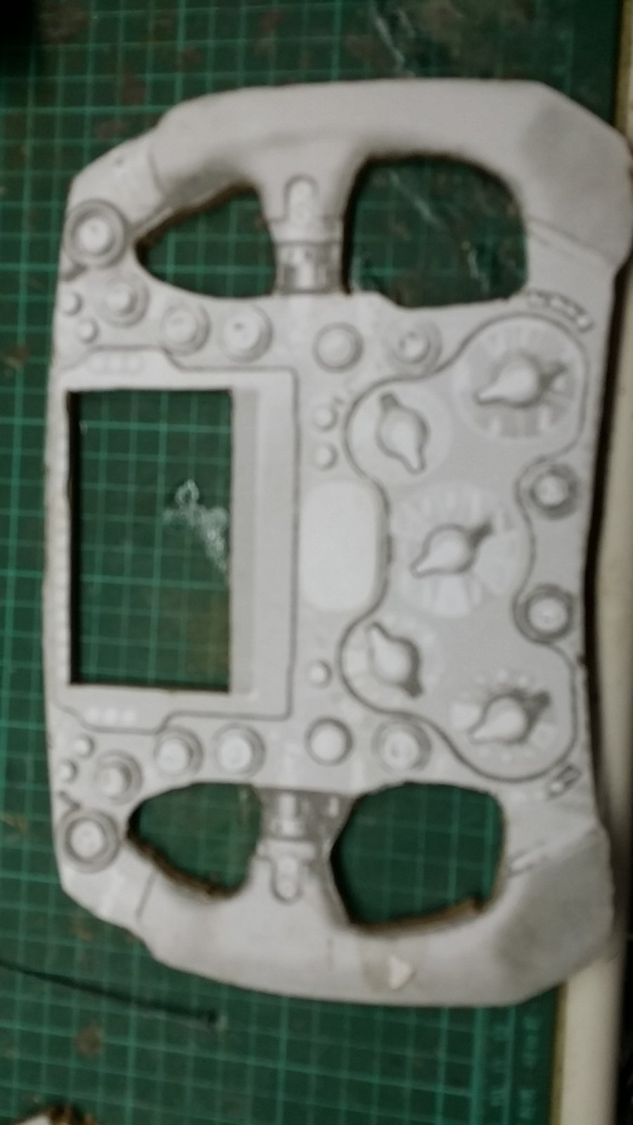

    1.Read csw sell dedicated f1 steering wheel g27 does not sell and market to find f1 to transform the shape of the dish did not see they have to do the Wood or plastic material is clay mud old phone a quick-release steering wheel game controller circuit board connectors aviation Button Rocker Switch Find a favorite picture on the web plate attached to the woodblock print down
    20150923_164021.jpg 20150923_164032.jpg 20150923_165538.jpg 20150923_171450.jpg

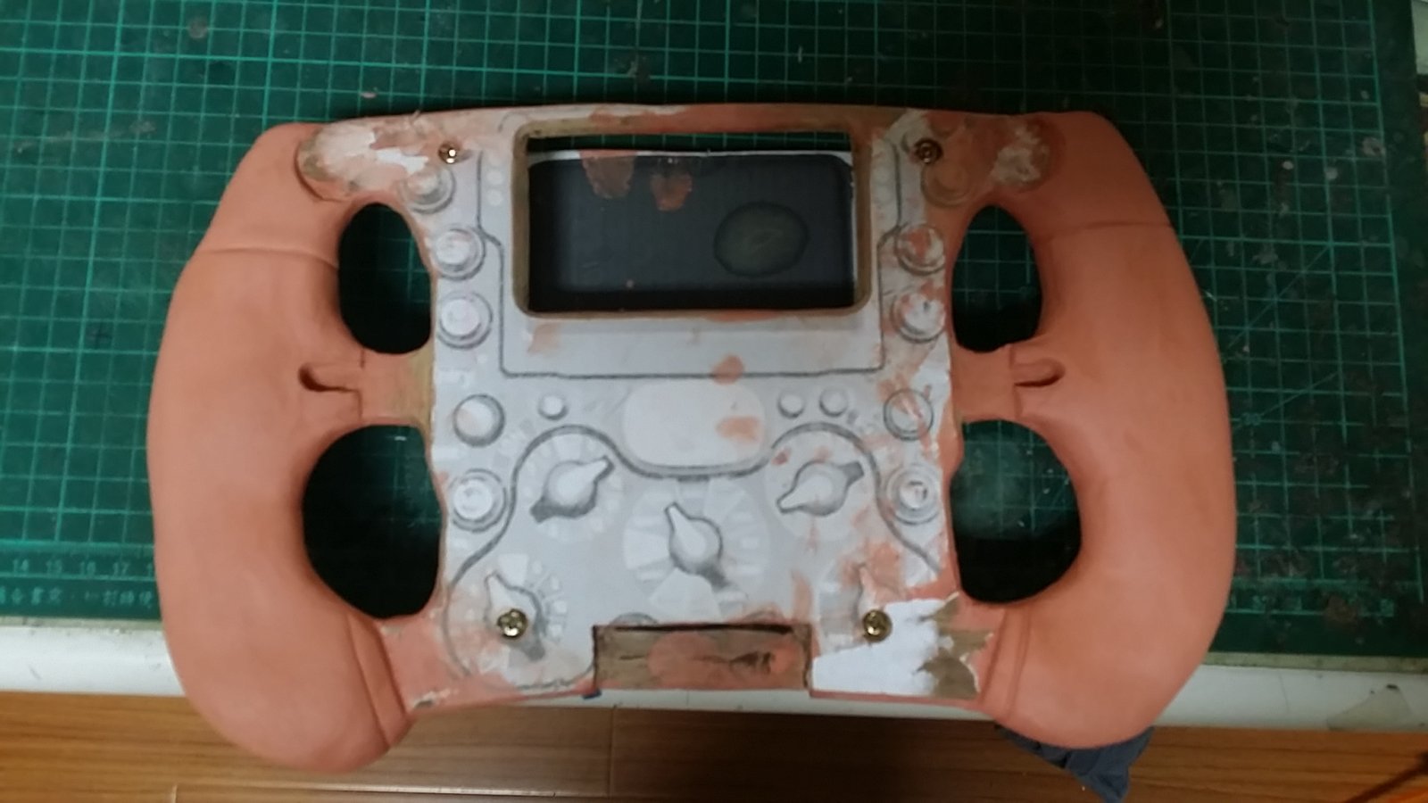

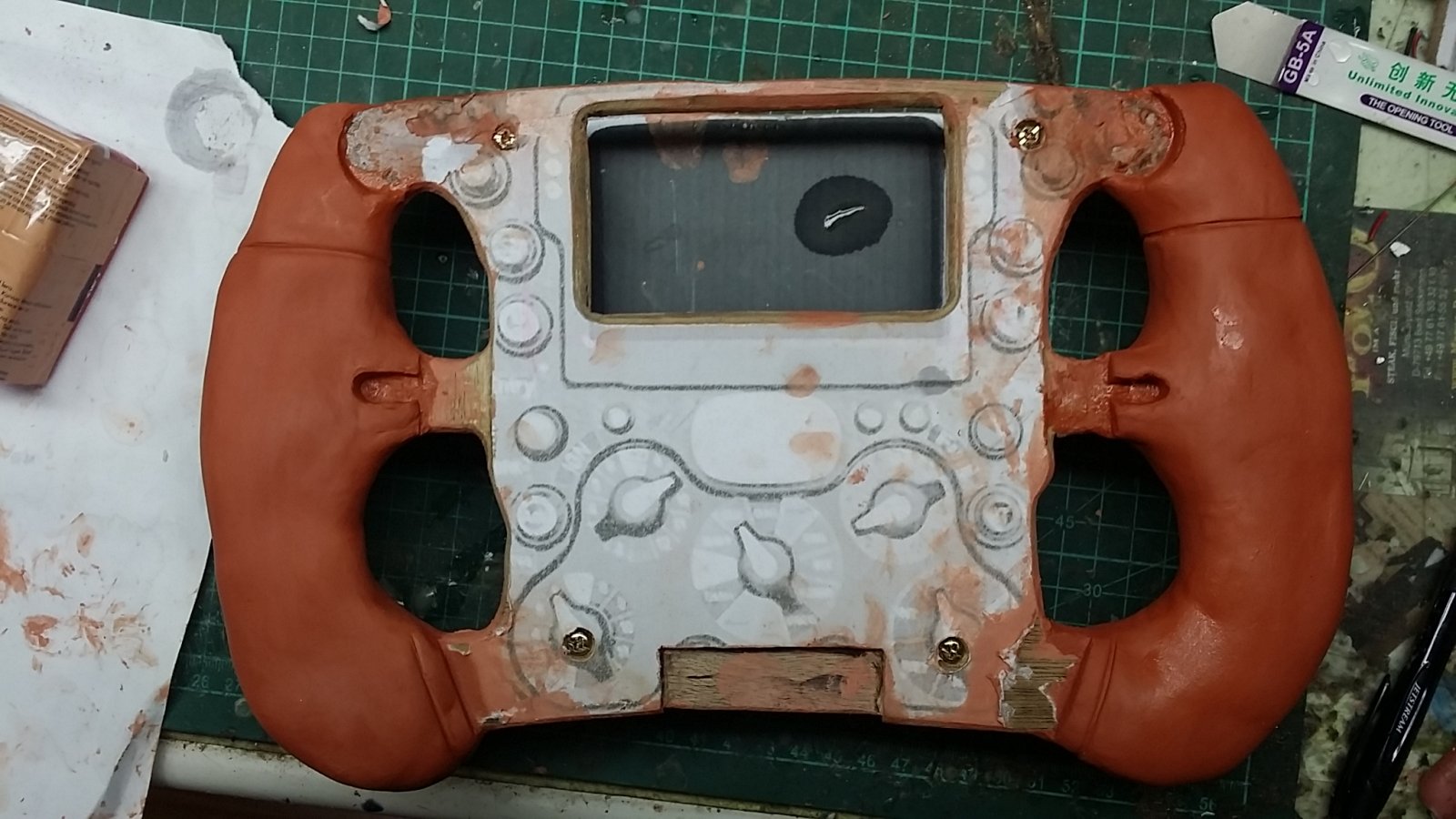

    2.

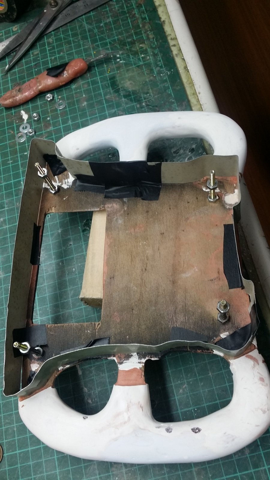

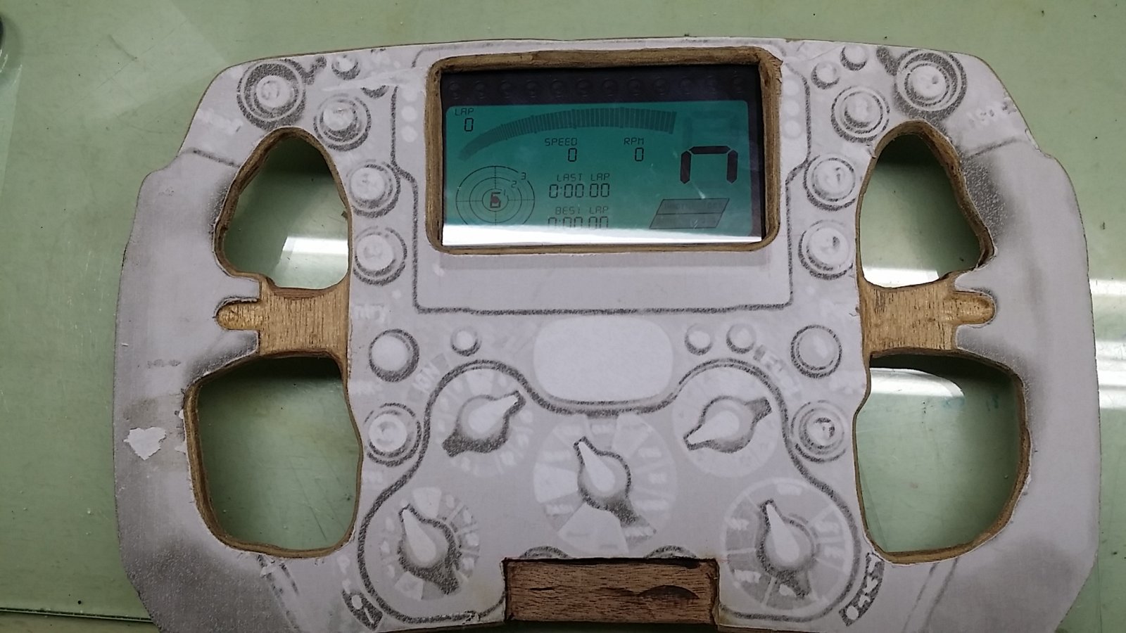

    Plastic or clay soil and shape quest Niechu

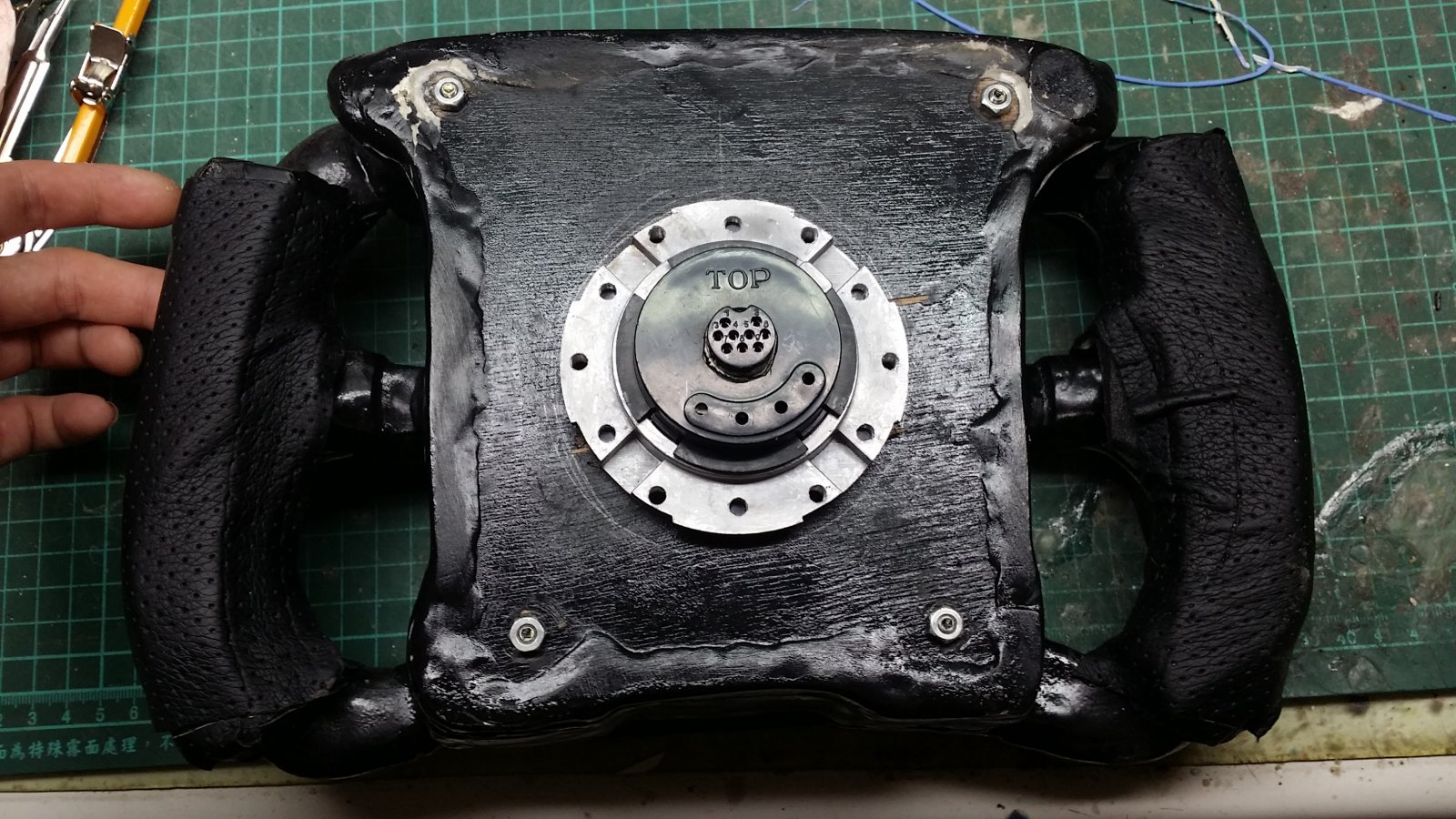

    3.
    The back surrounded by a soft iron also sticky mud fixed on steel

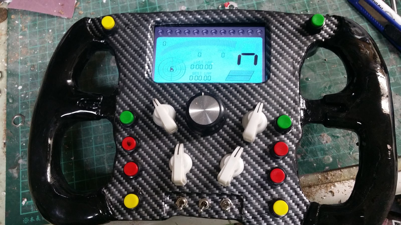

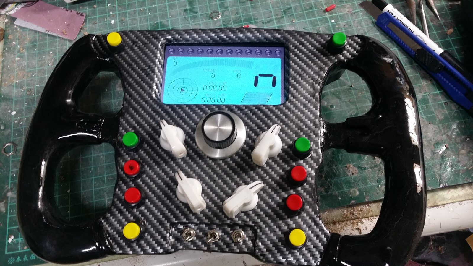

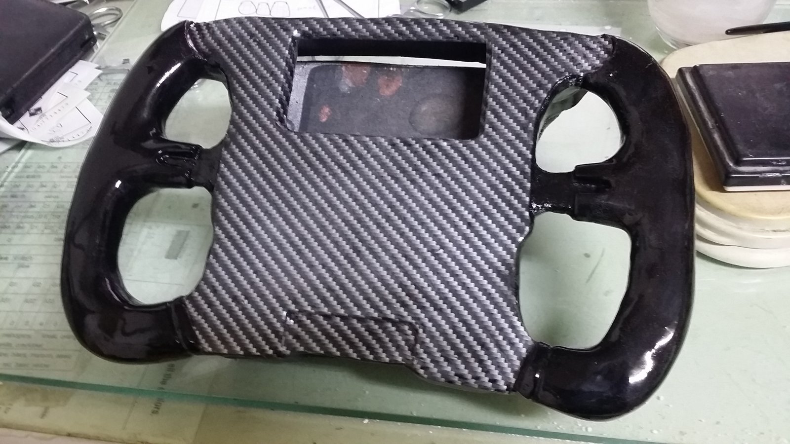

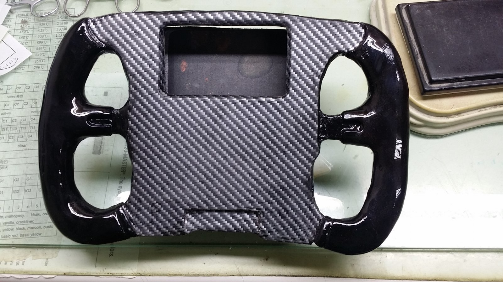

    4.

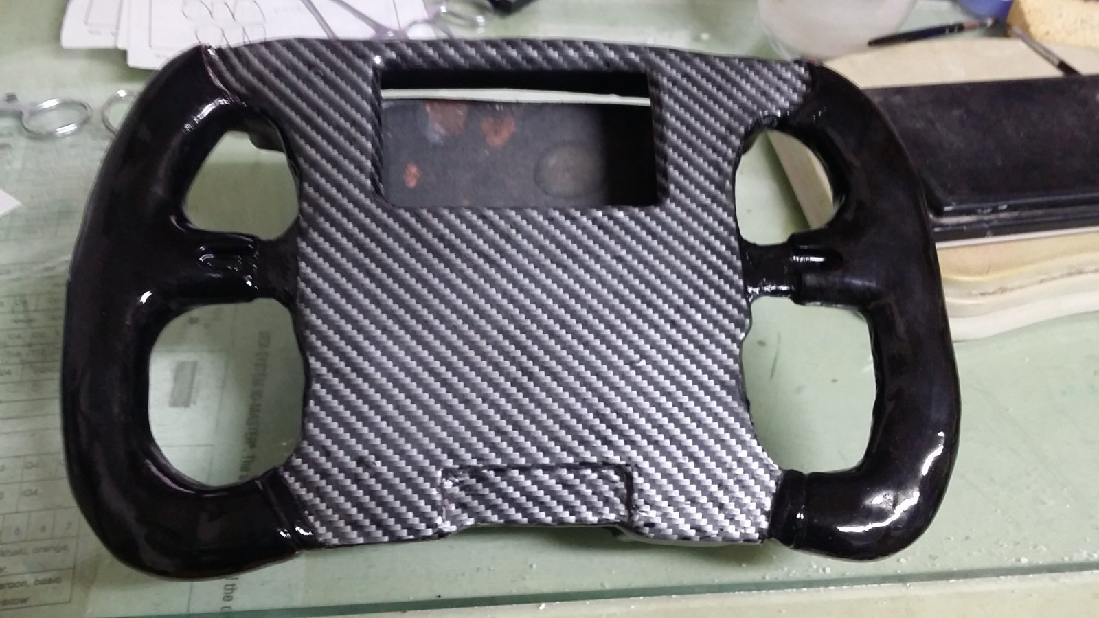

    Painted stickers stickers
    20151001_172139.jpg 20151001_172144.jpg 20151001_180309.jpg 20151002_190933.jpg

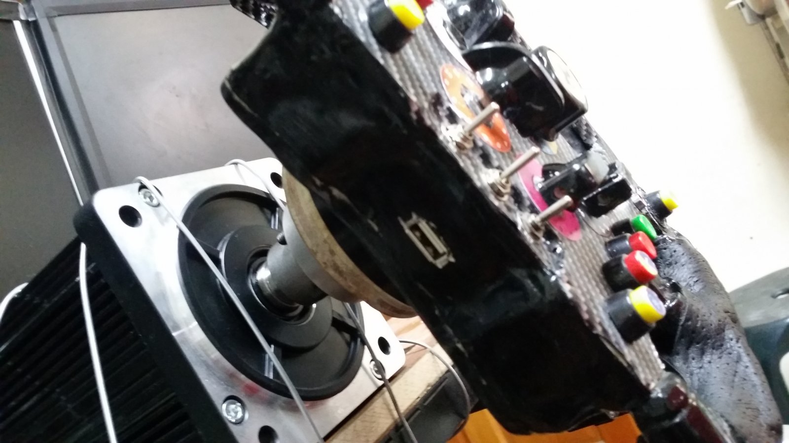

    5.
    Drilling button switch fitted with a mobile phone
    20151002_191001.jpg 20151003_022933.jpg 20151003_022943.jpg 20151017_112731.jpg

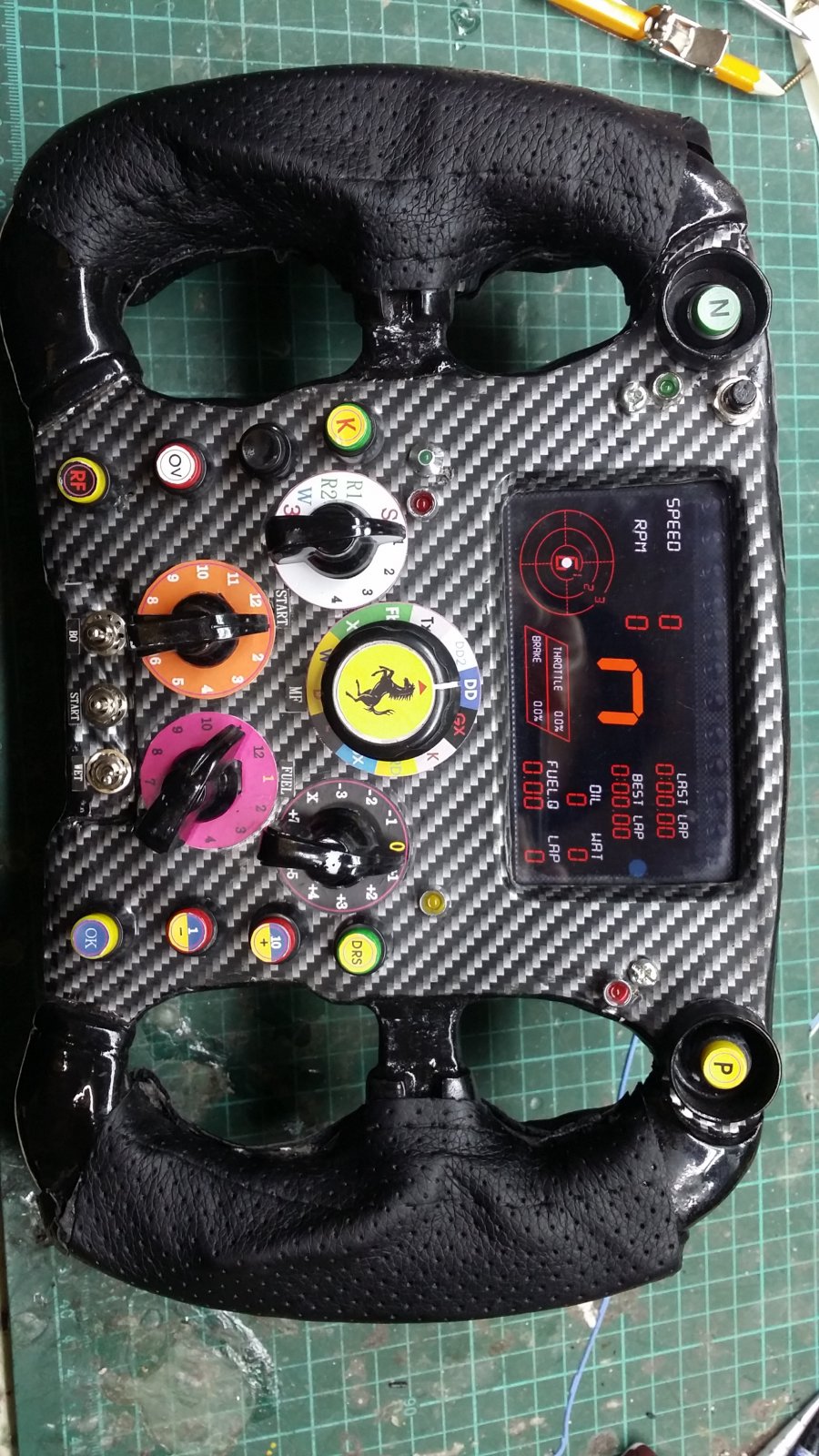

    6.

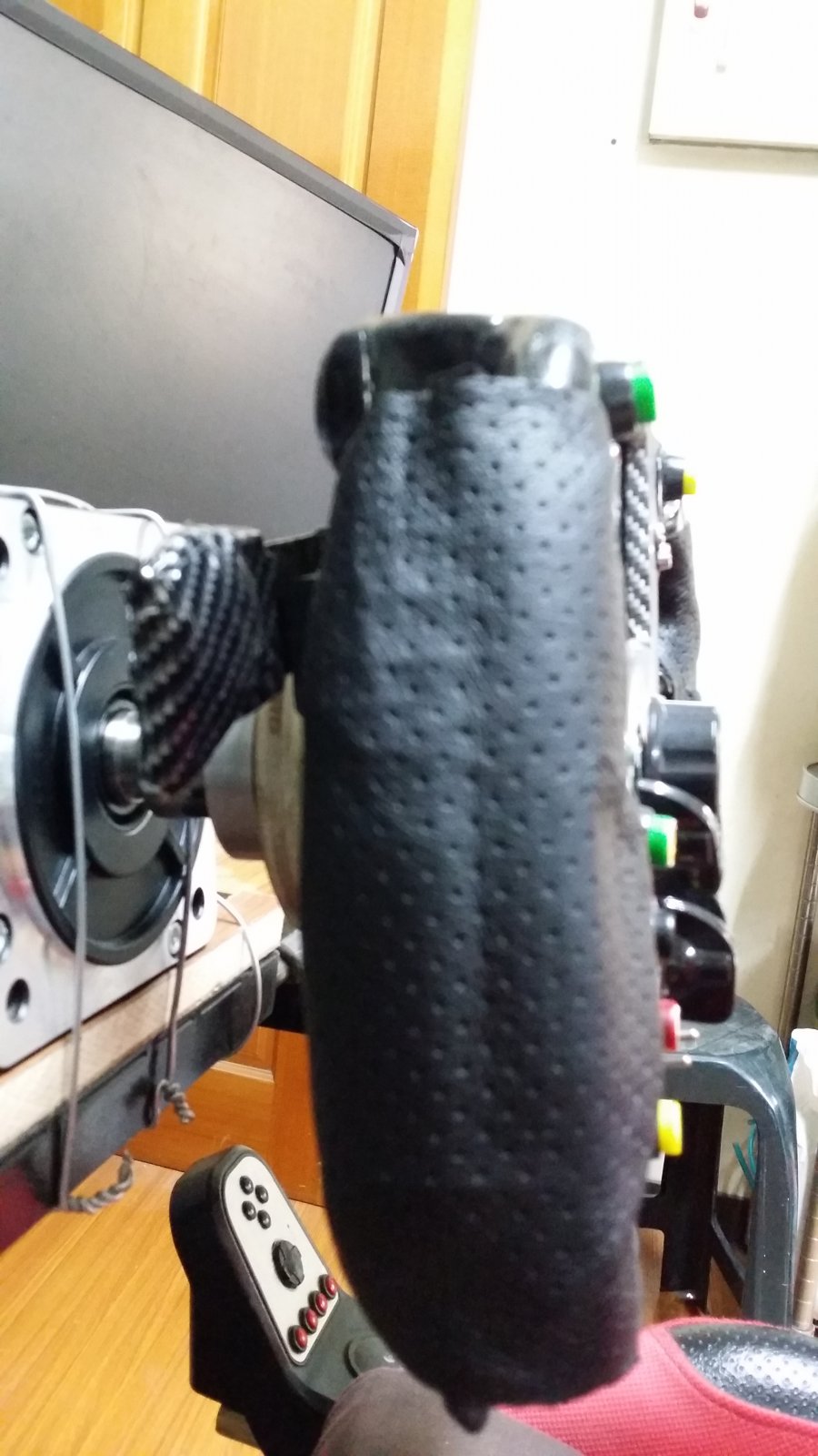

    There are Bluetooth keyboard circuit board wiring kneaded paste button sticker too thin soil and feel good grasp of the package a little ugly skin do not know what a good way to forget the camera directly jump completed
    20151017_112735.jpg 20160331_120042.jpg 20160331_120116.jpg 20160331_120144.jpg

    congratulation for your steering wheel ! could tell me what bluetooth circuit do you use exactly and are you happy with it , i mean no loss signal or lag ?

    what material did you use for the soft grips of the wheel?
