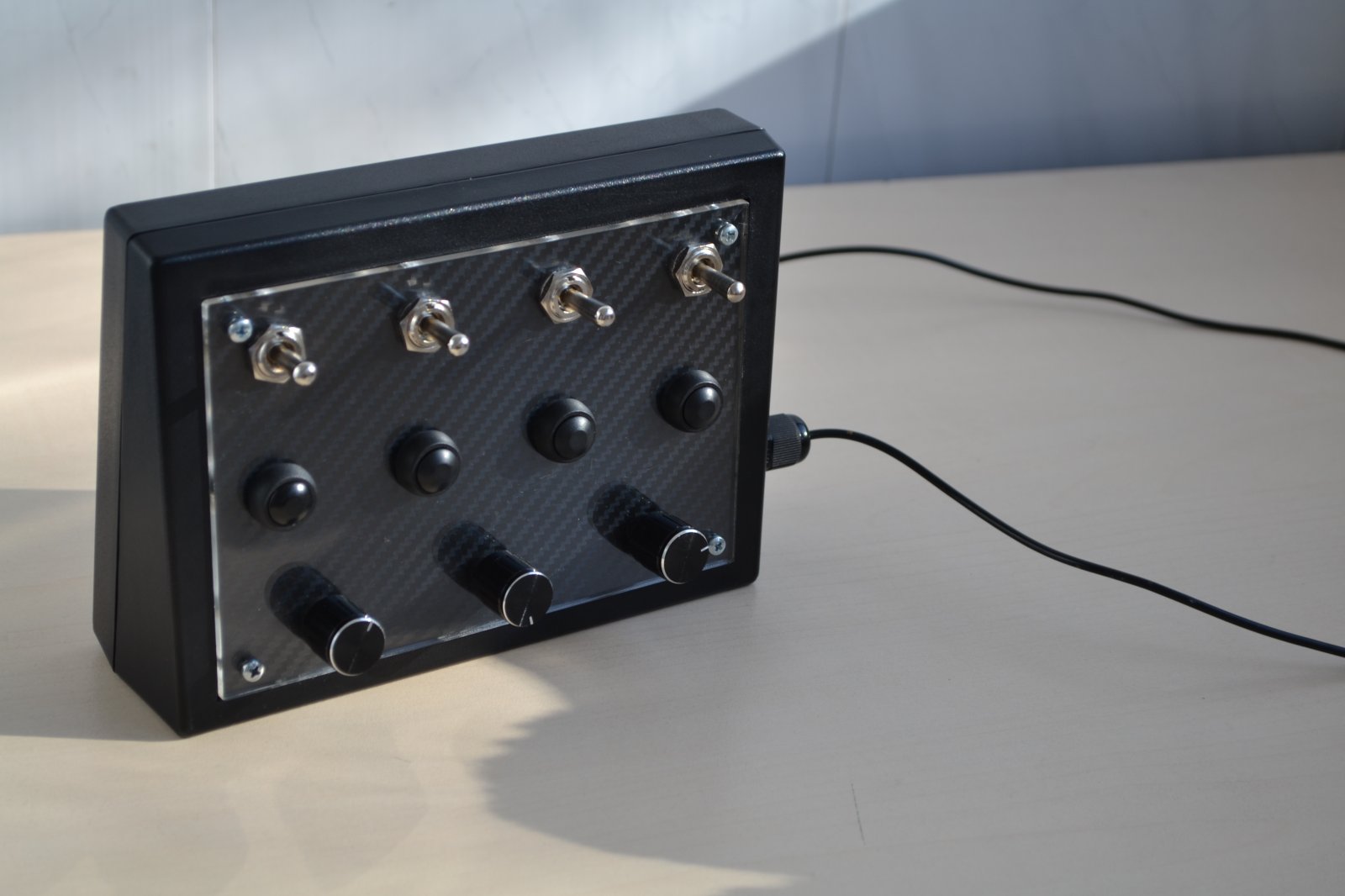

    Hi all!
    I know, a lot of diyers use Teensy for building buttonboxes, but more choices is better, right? :)
    So I decided to share my ard's sketches.

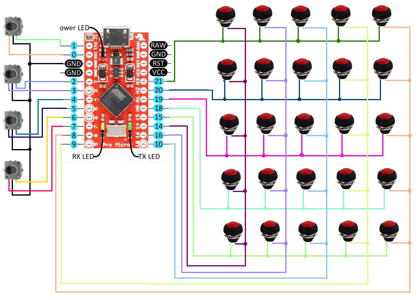

    1st version is standard universal buttonbox. The sketch supports up to 25 buttons and up to 4 encoders.
    I use:
    - Arduino Pro Micro
    - 4 switches like this
    - 4 buttons like this
    - 3 encoders like this
    - box from local supplier
    Wiring is quite simple:
    You can use any number of buttons up to 25 and any number of encoders up to 4 - no sketch modification is needed!
    For example, I use only 15 buttons (4 switches + 4 buttons + 3 encoders buttons), so my matrix is 4x4 and I wired it`s rows to 21, 20, 19, 18 pins and columns to 14, 16, 10, 9 pins
    Buttonbox acts as standard keyboard, it send chars which are defined in struct "buttons"

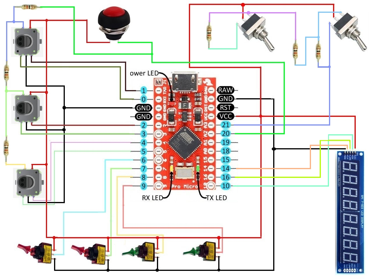

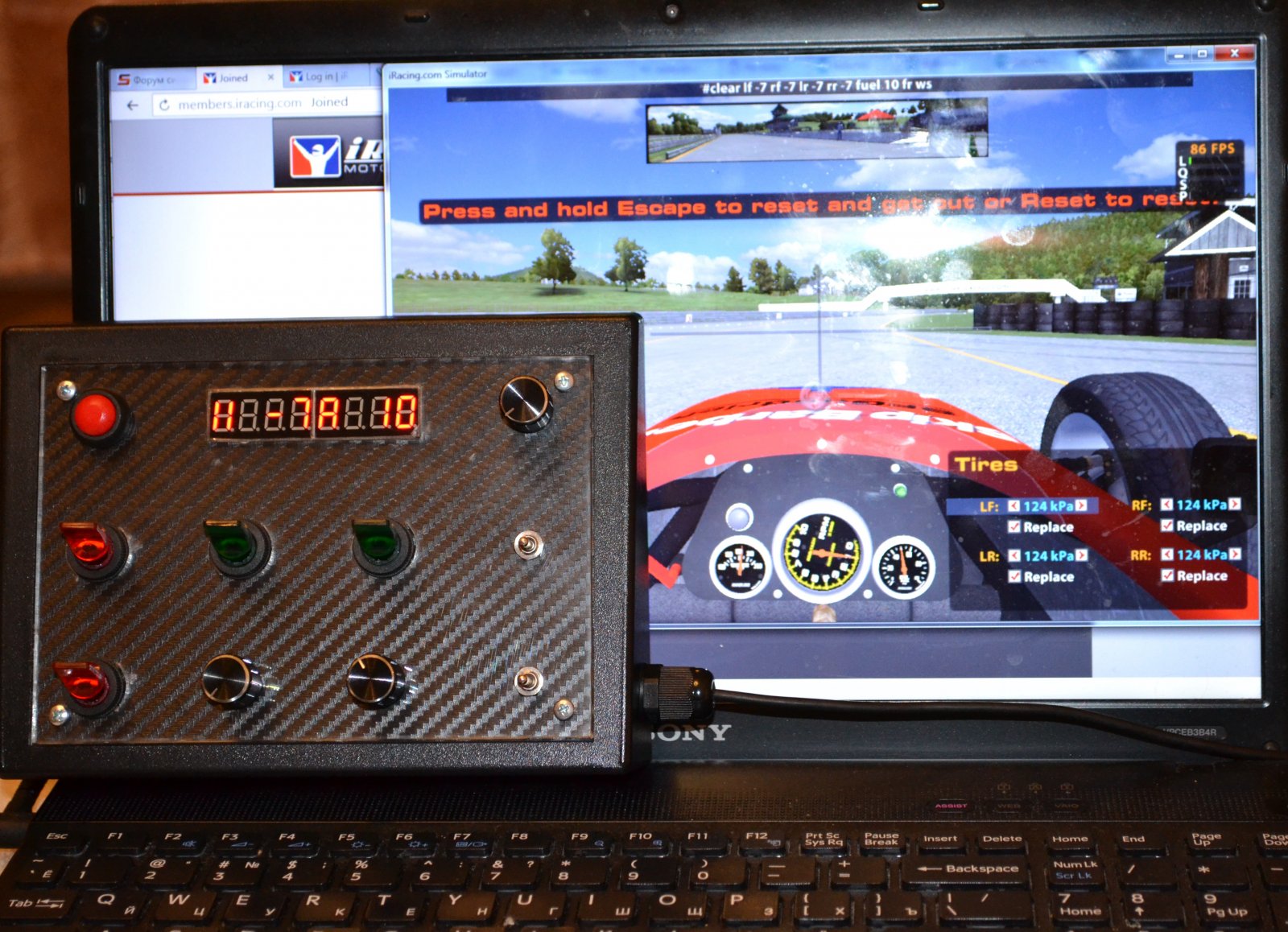

    2nd version of buttonbox was build for iRacing pitting service. Idea is to form pit combo by special switches/encoders and then just push button and viola - pit combo was send!
    Short description:
    - red ON-OFF switches used for request to change tires - front (top one) and rear (bottom one)
    - green ON-OFF switches used for request to clear windscreen (left one) and fast repair (right one)
    - bottoms encoders acts like right & left arrow keys (left one) and up & down arrow keys (right one)
    - 2 spring return switches on right side used to request to increase/decrease tire`s pressure
    - encoder on the top-right used to indicating how much fuel to add
    - red button serves to send pit combo to iRacing
    Also I added led screen to view and check what pit combo will be. So on the pic above it shows (from left to right):
    - decrease both front & rear tires pressure by 7
    - change both & rear tires, clear windscreen and made fast repair
    - add 10 litres of fuel
    On the pic you can see corresponded pit combo sended to the game
    Wiring:
    I use:
    - 4 ON-OFF switches
    - 3 encoders
    - 1 max7219 based display (like this)
    - 6 1kOm resistors (used for OneWireKeyboard)
    Sketch is attached, you need to download RotaryEncoders library

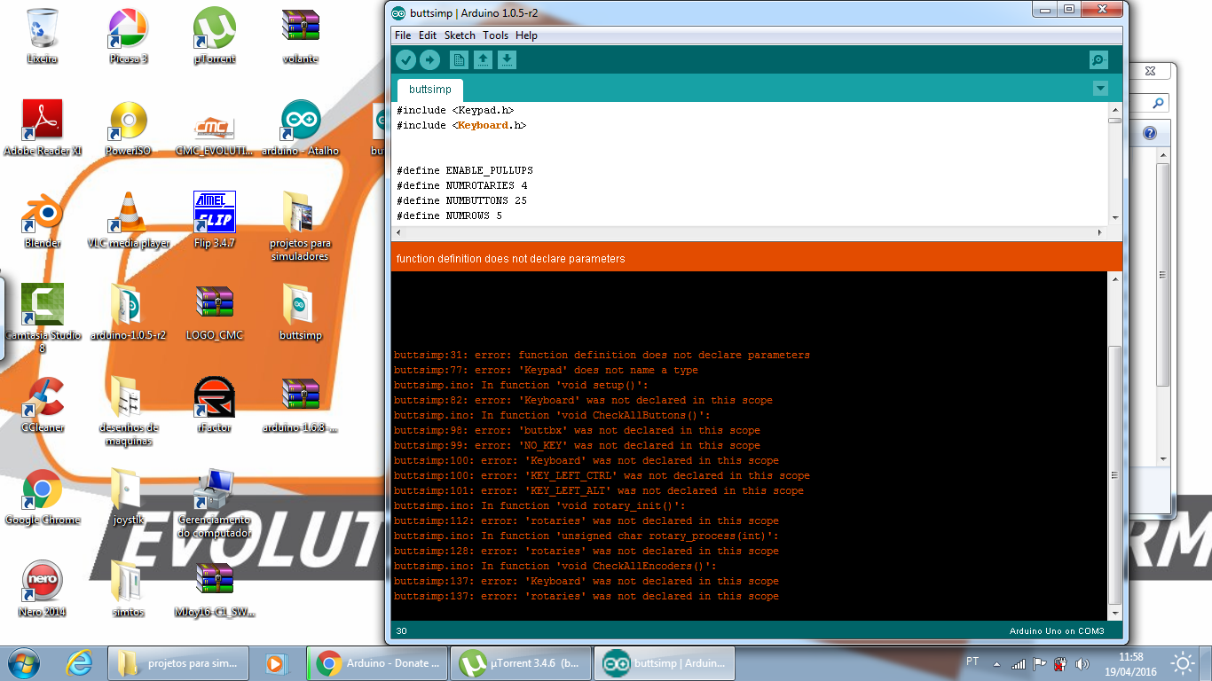

    ola @TOPMO3
    I could be using one Arduino r3?
    I tried to use the codgo in one arduino but of an error in both versions!
    I will take a picture and show you ok?

    buttpit.ino:1:24: error: LedControl.h: No such file or directory
    buttpit:57: error: 'Rotary' does not name a type
    buttpit:58: error: 'Rotary' does not name a type
    buttpit:59: error: 'Rotary' does not name a type
    buttpit:85: error: 'LedControl' does not name a type
    buttpit.ino: In function 'void setup()':
    buttpit:95: error: 'lc' was not declared in this scope
    buttpit:112: error: 'Keyboard' was not declared in this scope
    buttpit.ino: In function 'void ProcessPitCombo()':
    buttpit:141: error: 'Keyboard' was not declared in this scope
    buttpit:176: error: 'KEY_RETURN' was not declared in this scope
    buttpit.ino: In function 'void ShowPressures()':
    buttpit:189: error: 'lc' was not declared in this scope
    buttpit:195: error: 'lc' was not declared in this scope
    buttpit:202: error: 'lc' was not declared in this scope
    buttpit:209: error: 'lc' was not declared in this scope
    buttpit.ino: In function 'void CheckButtons()':
    buttpit:225: error: 'Keyboard' was not declared in this scope
    buttpit:225: error: 'KEY_ESC' was not declared in this scope
    buttpit:230: error: 'Keyboard' was not declared in this scope
    buttpit:230: error: 'KEY_TAB' was not declared in this scope
    buttpit:235: error: 'Keyboard' was not declared in this scope
    buttpit.ino: In function 'void CheckChangeEncoder()':
    buttpit:257: error: 'r3' was not declared in this scope
    buttpit:259: error: 'Keyboard' was not declared in this scope
    buttpit:259: error: 'DIR_CCW' was not declared in this scope
    buttpit:259: error: 'KEY_LEFT_ARROW' was not declared in this scope
    buttpit:259: error: 'KEY_RIGHT_ARROW' was not declared in this scope
    buttpit.ino: In function 'void CheckFuelEncoder()':
    buttpit:266: error: 'r1' was not declared in this scope
    buttpit:268: error: 'DIR_CCW' was not declared in this scope
    buttpit:269: error: 'DIR_CW' was not declared in this scope
    buttpit.ino: In function 'void CheckControlEncoder()':
    buttpit:275: error: 'r2' was not declared in this scope
    buttpit:277: error: 'Keyboard' was not declared in this scope
    buttpit:277: error: 'DIR_CCW' was not declared in this scope
    buttpit:277: error: 'KEY_UP_ARROW' was not declared in this scope
    buttpit:277: error: 'KEY_DOWN_ARROW' was not declared in this scope
    buttpit.ino: In function 'void ShowNumber(int, byte)':
    buttpit:288: error: 'lc' was not declared in this scope
    buttpit.ino: In function 'void ProcessSwitches()':
    buttpit:328: error: 'lc' was not declared in this scope
  11. TOPMO3

    Hi @Claudemir ,
    sorry, but you cant use UNO.
    You need Atmega32U4 based board - ie Leonardo, Micro, Esplora, Yun or Due and Zero. Only these Adrs can appear as a native Mouse and/or Keyboard to a connected computer.
