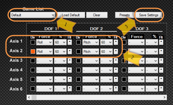

    Hi.
    I will post pictures this weekend of the current state. It's almost done :)
    I've been testing and playing with Simtools but I have one problem: it seems that the pitch axis (the one that controls acceleration and braking) is inverted. Did I connect something wrong in the Arduino/SMC3?

    Halloween2go,
    Thanks.
    Just out of curiosity...why did the axis needed to be inverted?
    Did I connect something wrong in the motor drivers?
    What should I invert to prevent needing to invert in the software?

    The DIR boxes being checked orange or not determine which way each axis moves, do if the pitch axis is inverted you can fix it with the DIR settings, this is what SimTools expects: https://www.xsimulator.net/community/faq/which-way-to-set-simtool-axis-movements.230/
    For race sims be mindful of the Axis Allocation totals: https://www.xsimulator.net/community/faq/axis-assignment-percentage-totals.120/
    Once you get the rig moving seeing the tuning tips here: https://www.xsimulator.net/community/faq/steps-to-create-a-motion-profile.228/

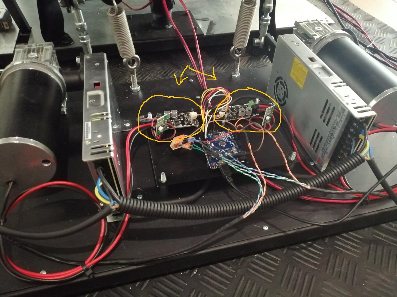

    Hello friend, what would those plates be for? thumbnail_IMG_20210405_090348.jpg

    3DOF, DC motor, Arduino, Motion platform, 4DOF
    Hello! Based on the description on the first page, these are Cytron MD13S drivers for motors.
