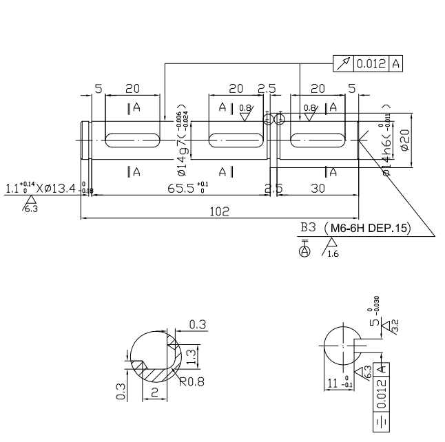

    Ok....one last question before I place my order:
    They seem to come with a single output shaft but they can modify as needed.
    What kind of shaft should I ask for?
    Edit: I've attached the gearbox shaft schematics
    21,722
    152,045Coins
    +11,062 / 56 / -2
    Shaft selection really is a question as to how you mount the levers and pots.
    This is the levers for solid shaft keyway motors on my compact rig: https://www.xsimulator.net/community/faq/how-to-attach-levers-to-wormdrive-gearboxes.182/
    And I drilled and tapped the shaft on the flush end to take a bolt with the head cut off, which I attached the pot to with a flexible coupling: https://www.xsimulator.net/communit...ountdown-to-2dof-build.6177/page-2#post-68381
