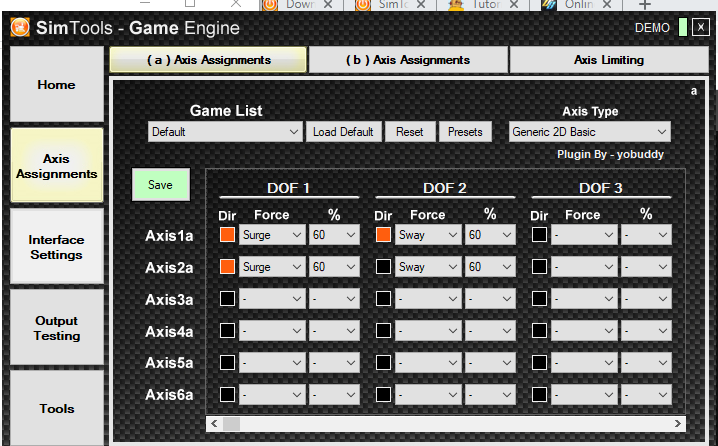

    Hello
    Newbie here. I have few questions to ask. I have started my project with 2x 12v toys motor with 1 motomonster and Arduino UNO. I am using SMC3 for my Arduino code and I have followed exactly the setup for SMC3 like in this thread
    https://www.xsimulator.net/communit...3dof-motor-driver-and-windows-utilities.4957/. From the steps mentioned, after I set the KP to 400 and slowly increase PWMmax to 50, both of the motors start to move so I believe my setup is correct.
    I later install LFS and Simtools 2.5 and I use VirtualSim which I download from here https://www.xsimulator.net/community/threads/simple-application-to-analyze-the-axis-setting.10430/ and seems that all working fine. I can see the rig movement in VirtualSim tool.
    But I still cant make my motors running after I change to Serial COMport in Simtools. I have attached the screenshot of simtools setting and my current setup.
    I have few question.
    1) In order to make the motors running, do I need to change anything in SMC3 tool? Currently I set all to 0 except for KP to 400 and clip input 255 and max limit 255. If I change the PWMmax to 50, the motor will start to move but if I leave with that setting when running LFS, the motor will always moves before I start the LFS.
    2) Do i need to connect the POT to the motor in order to make the motor moves? For now all I want is to just see the motor moves when start the LFS to make sure there is communication between my motor setup with SMC3 and Simtools.
    Any advice greatly appreciated.
    Thank You
    21,517
    150,722Coins
    +11,018 / 55 / -2
    You should have the pots connected, as they give positional feedback, and complete SMC3 set up before moving on to SimTools, such as setting your max and clip limits.
    In SimTools Interface Setting set 10bit for the Output Range, and 10ms for the Output Rate.
    Then make sure everything works in SimTools Output Testing. after you have configured a Default profile in Axis Assignments. This is how SimTools expects Axis Assignments to be configured: https://www.xsimulator.net/community/faq/which-way-to-set-simtool-axis-movements.230/
    Finally, ensure you run LFS before patching it for motion: https://www.xsimulator.net/communit...run-in-first-person-mode-before-patching.365/

    Tq noorbeast for the reply... just to confirm, even if I did not connected the pot to the motor, how do I check if there is a communication between motor and Simtools? because seems like the motor did not move at all if I move the slider in output testing in Simtools. I assume the motor should show some response if I move the slider right? or maybe I am wrong and the pots really needs to be connected before it can show any response?
    because for now it does not matter for me if the motor move in wrong direction as long as it shows some response then that is enough for me because I just want to learn how simtools and SMC3 and motor communicate between each other.

    so I have connected the pot to the motor.. and I can see when testing the motor in smc3, when I increase the pwmmax, the green line move toward the blue line and then the motor stop.
    I then close the smc3 tool, and open simtools. In output testing, when I move the slider, nothing happen with the motor. Is that a correct way to do output testing? or is there anything missing? i have attached the video if that may help..
    21,517
    150,722Coins
    +11,018 / 55 / -2
    You are making progress, but a few issues remain.
    First you must complete the SMC3 settings and Save them, returning them to zero will result in no output.
    Second, you can't have SMC3 and SimTools running at the same time, it will cause a port conflict, which is the beep you hear when using Output Testing. So do not run SimTools while doing the SMC3 settings, and when those settings are done shut down the SMC3 Utility before starting SimTools.
    Your Interface Settings now look correct.
    Keep in mind the MMs will need cooling for a motion rig.
    And it pays to test MMs before use on a rig, to ensure they are not faulty: https://www.xsimulator.net/community/faq/monster-moto-testing-before-use.158/

    Thanks Noorbeast.. finally its working... the motor start moving with simtools output testing and also moving with LFS too..I did exactly what you advised.. I think I can start looking for real motors now and need to do some research as I still confuse which motor should I buy as my goal is to build 3dof rig with heave although for now i will start with only 2dof..
