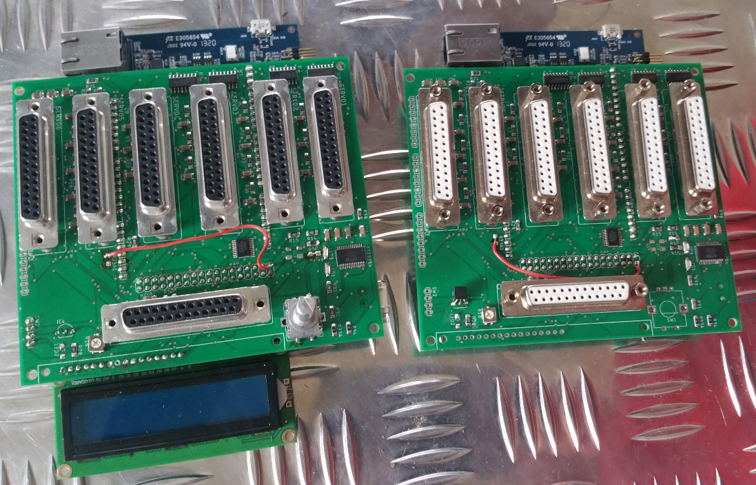

    I greet the community of the movement platforms.
    Advanced servo motor control unit for up to 7 motors
    For AASD Series servo motors
    Due to the corona crisis, I found time with the submission and idea of the great thanos controller to develop another. thank you thanos for your great work. My controller has been specially developed for 6dof flight simulators. But it can also be used for all other simulation platforms. The aim was to use the high resolution of the servomotors for a very fine movement with the highest possible resolution in order to achieve a very
    realistic flight simulation, but without losing speed and responsiveness.
    The controller was mainly designed for the AASD servos. However, it can also be used to operate other servomotors. It can be used to operate all servomotors whose amplifiers are operated by the Step / Dir function.
    The following functions are operated by the controller:
    Hardware functions
    1. Control of up to 6 + 1 servo motors (opt.)
    2. Pulse speed up to 550 kHz
    3. Step / DIR mode
    4. Query and evaluation of torque (for calibration) and error status
    5. Display of parameters via LC display 16x2
    6. Operation via rotary encoder with push button
    7. Switch for signal reception
    8. Emergency stop switch for servo functions
    9. Power switch for USB signal (in development)
    10. Serial USB connection for data transfer
    11. 32 bit processor
    12. Storage of the setup data
    13. 2 LEDs for status display
    14. Housing
    15. Control unit can be installed 3m away
    16. LC display and encoder can also be installed on the mainboard
    Software functions
    1. Monitoring the status of the motors
    2. Automatic calibration of the servomotors
    3. Service function for repairing or checking the engines
    4. Manual control of each motor individually for testing
    5. live Scaling the output signals (master gain)
    6. Filtering of the output pulses (EMALP / SPIKE)
    7. Offset function for each motor (especially for rotating actuators)
    8. Variable parking position
    9. Actuators individually adjustable (electronic translation, length of the act., DOF system)
    10. Calculation of different gearboxes
    11. Calculation of different directions of rotation (CW / CCW)
    12. Actuator parking can be set individually.
    13. Speeds for calibration, slow speed and high speed freely adjustable (max. 550 kHz)
    14.Inverse kinematics with> 1000 calculations per second (for linear and non-linear actuators)
    15. Geometry for steward platforms with 6 DOF and 6 actuators individually adjustable
    16. Support for rotating actuators and linear actuators
    17. Separate scaling and filtering for Surge Sway Heave Yaw Roll and Pitch
    18. Reinforcement, EMALP filters, logistics filters
    19. Wash-out filter for each axis (adjustable in strength)
    20. Evaluation of 24 bit input data (Simtools / Mover)
    21. Calculation in 32/64 bit for maximum smoothness of movement
    22. 2 different operating modes: direct or firmware inverse kinematics
    there is the possibility to connect the display and encoder directly to the pcb. there is the need of installing
    and extra online switch.
    i will offer the board for sale in the next time if there is interest. there will only be small series on pre-order. first of all, i'm looking for people with different rigs to test the inverse kinematics on other machines. Most of the firmware should be save up to date. the external hand-held device can be made by yourself. i will publish the plans and 3d models.
    please ask but actually it may need some time for me to answer.
    thx for your interest.

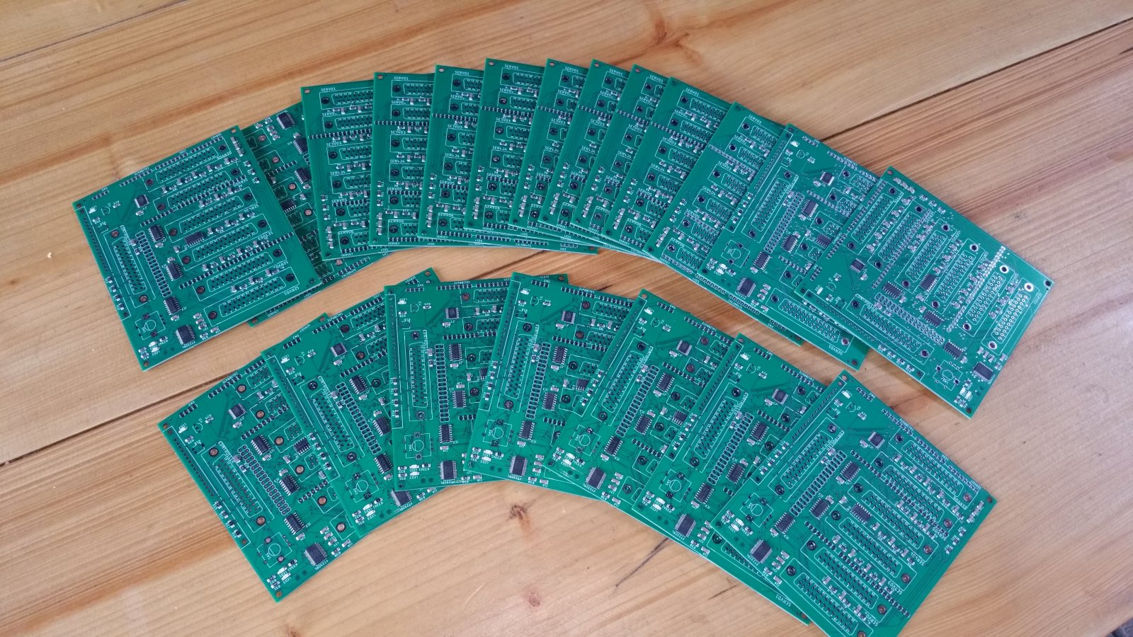

    hey, today i got the first pcb series from china. new provider and small changes to the board. I will finish it and test if everything works. I also installed an encrypted bootloader and hardware security against copying the firmware. so there can be regular updates for new functions and bug fixes. Now I would be ready to accept the first orders. But first after the vacation one week. I'll write here when the time comes and where to buy. 20201023_145401.jpg

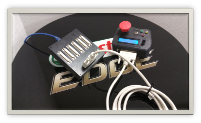

    Hello, sorry that it has been so long since my vacation, but at the moment time is running out like nothing.
    it's ahead i finally finished the controller, a year of development has now flowed into it.
    Like thanos, I started with a 2560. however, I did not have background knowledge of programming with assembler.therefore I quickly realized that the 2560 was much too slow for my project and tried something faster, the arduino due at least 32bit and 84 mhz. with this one could shoot at least 200kpps but for 550kbps and proper filters and the inverse kinematics that wasn't enough either.
    So I looked again and didn't want to leave the programming environment and now it became a SAME70 with 300mhz as well as cache and fpu. So there is definitely enough juice now. also for future connections such as a tft display or datalogging to sd without hardware adjustments. let's see. the whole firmware is written in c without framework.
    I have set up a github channel on which all documents are stored and future firmware is also saved
    https://github.com/motion4sim/AASD15A-Servo-Controller-for-Motion-Simrigs
    there you will also find instructions and other documents for operating the controller
    there will be 2 models, one for the external control unit and one with lcd and encoder on board
    these will be compatible, which means that the external control unit can also be connected to the 2nd model
    you can also print the external control unit with display yourself and assemble it from just a few parts. soldering skills are required for this.
    the instructions and files for 3d printing can be found on thingiverse
    https://www.thingiverse.com/thing:4641555
    there are also the stl files for the controller housings
    Video about firmware update process
    the next days i will upload some videos of how to connect the drives and operate them.
    i will show you how to make the settings for the actuators.
    the sale ad is on tindie for review as soon as it is approved i will publish this here.
    from the "pre-series" I still have 3 pcb that are all fully functional. they differ in layout and have a usb B connection instead of a micro usb in the final version.
    I would sell these boards cheaply please write to me via pm if you are interested
    thank you
