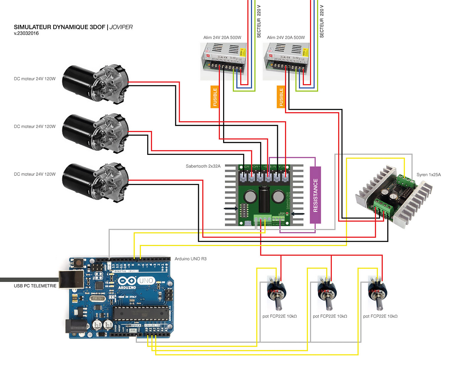

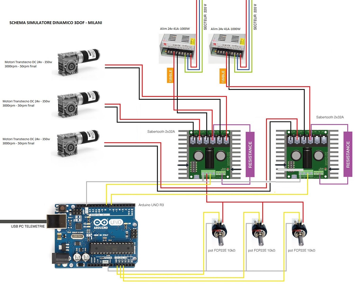

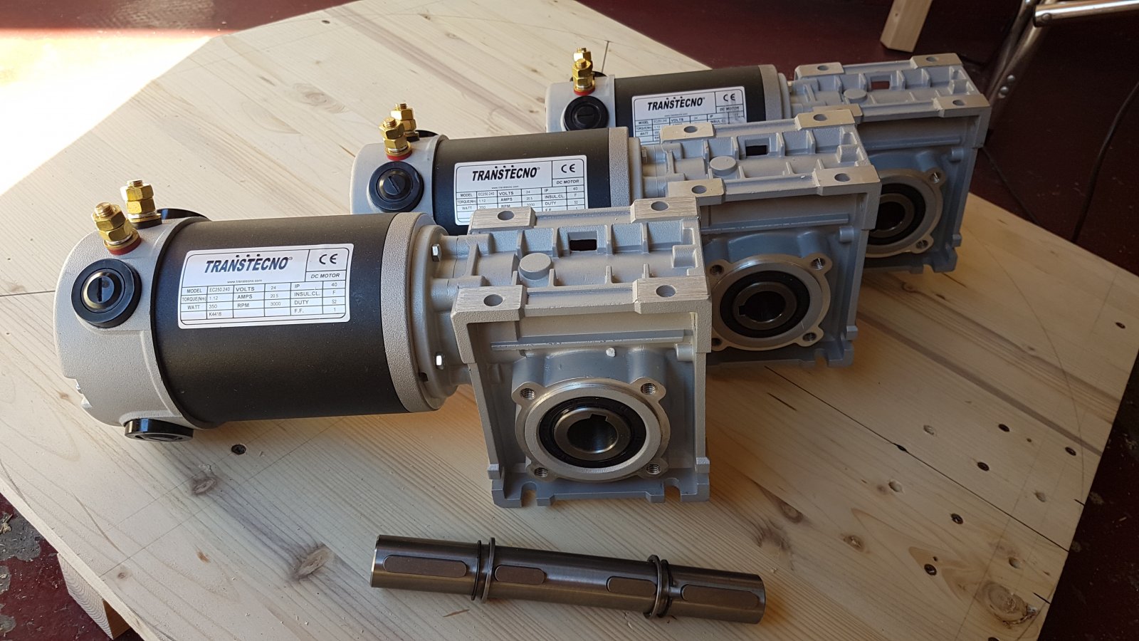

    Schema 3DOF Milani.jpg Schema 3DOF.jpg Ok, my project continues.
    I found the engines that I fully meet my needs, robust, powerful, fast, reliable and purchased in Italy ...... TRANSTECNO 24V 350W 3000RPM 50 RPM FINAL.
    They are not cheap but fall within my budget.
    I list all the components that I need for the 3DOF taken from the scheme that I found in my thousand searches.
    N. 3 Transtecno ECM 350w-24v-3000 / 50rpm engines
    N. 1 arduino ONE REV3
    N. 2 Sabertooth 2x32
    N. 2 power supply 24v - 1000W - 41A
    N. 3 potentiometer FCP22E 10K
    I NEED YOU for a confirmation if all the components are good and if the scheme to be followed is the right one, in the scheme will be replaced the Sabertooth syren 1x25A with a 2x32.
    I await your kind reply to buy and leave with assembly.
    Thank you.
    Hello
    Fabio
  7. Milani Fabio
    Milani Fabio Active Member
    Feb 21, 2019
    105
    Italia
    718Coins
    +74 / 2 / -0
    Can not find these FCP22E 10K potentiometers.
    I found these on amazon: Sourcingmap - Rv24Yn20S 10K Ohm Single Turn, Carbon Rotary Taper Potentiometer.
    Am I ok for my 3DOF?
    Thank you.
    Hello
    Fabio

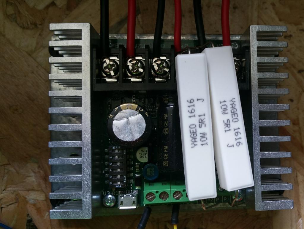

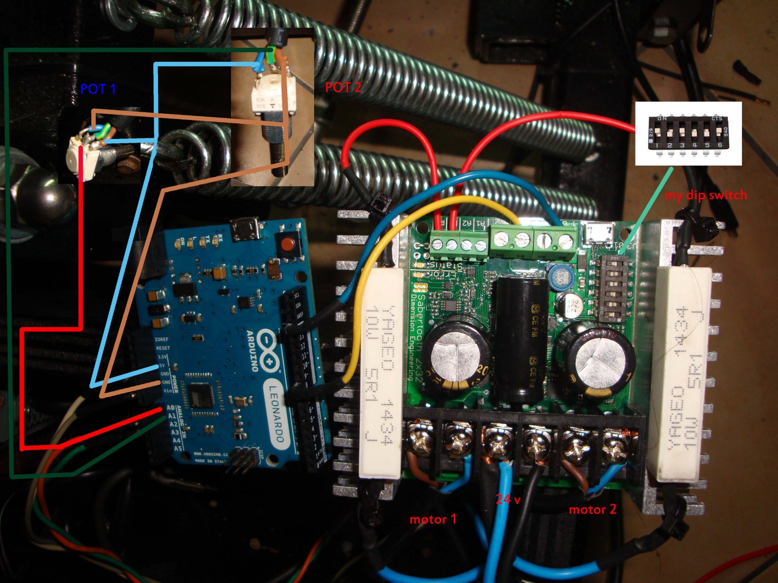

  10. Milani Fabio
    Feb 21, 2019
    105
    Italia
    718Coins
    +74 / 2 / -0

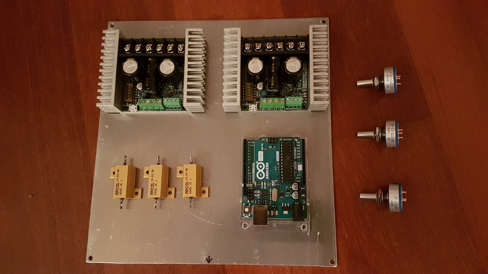

    I found these web photos of resistances applied to sabertooth.
    They are 2 different projects but they have the same resistances, so they should be fine ..... 10W - 5 ohm.
    Is there no one who can confirm us ???
    Thank you.
  11. MarkusB
    Jun 30, 2015
    552
    4,214Coins
    +597 / 2 / -0
    DimensionEngineering has a resistor calculator on their web site:
    https://www.dimensionengineering.com/calculators/power-resistor
  12. Milani Fabio
    Feb 21, 2019
    105
    Italia
    718Coins
    +74 / 2 / -0
    Thanks MarkusB.
    My engines are Transtecno 24V 350W 3000rpm 20A with 1000w 40 Amps power supplies, see post above.
    Dimensionengineeringcalculator:
    Volts 24
    Max Current: 20 Amps
    result
    1.2 Ohms dissipates 480 Watts at 20 Amps
    Alternatives
    2 Ohms dissipates 288 Watts at 12 Amps
    What resistance should I buy, Ohms and watts?
    Thank you.

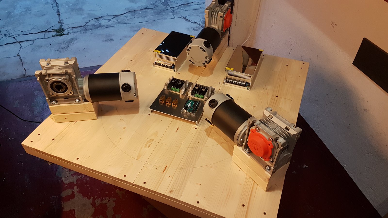

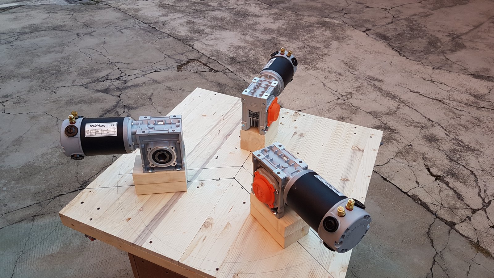

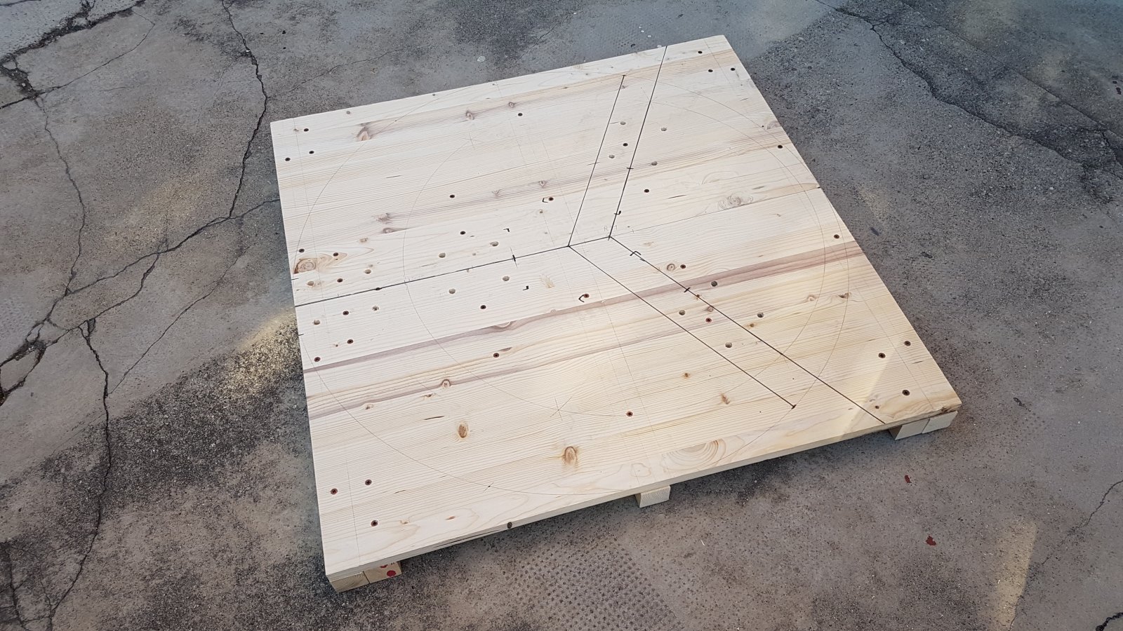

    Hi guys,
    my 3DOF begins to take shape.
    Almost everything has arrived, only the power supplies are missing .... in 15 days.
    The prototype will be on a wooden platform, then when it is all working, I will build iron.
    See you soon with new updates.
    Hello.

  14. Milani Fabio
    Feb 21, 2019
    105
    Italia
    718Coins
    +74 / 2 / -0

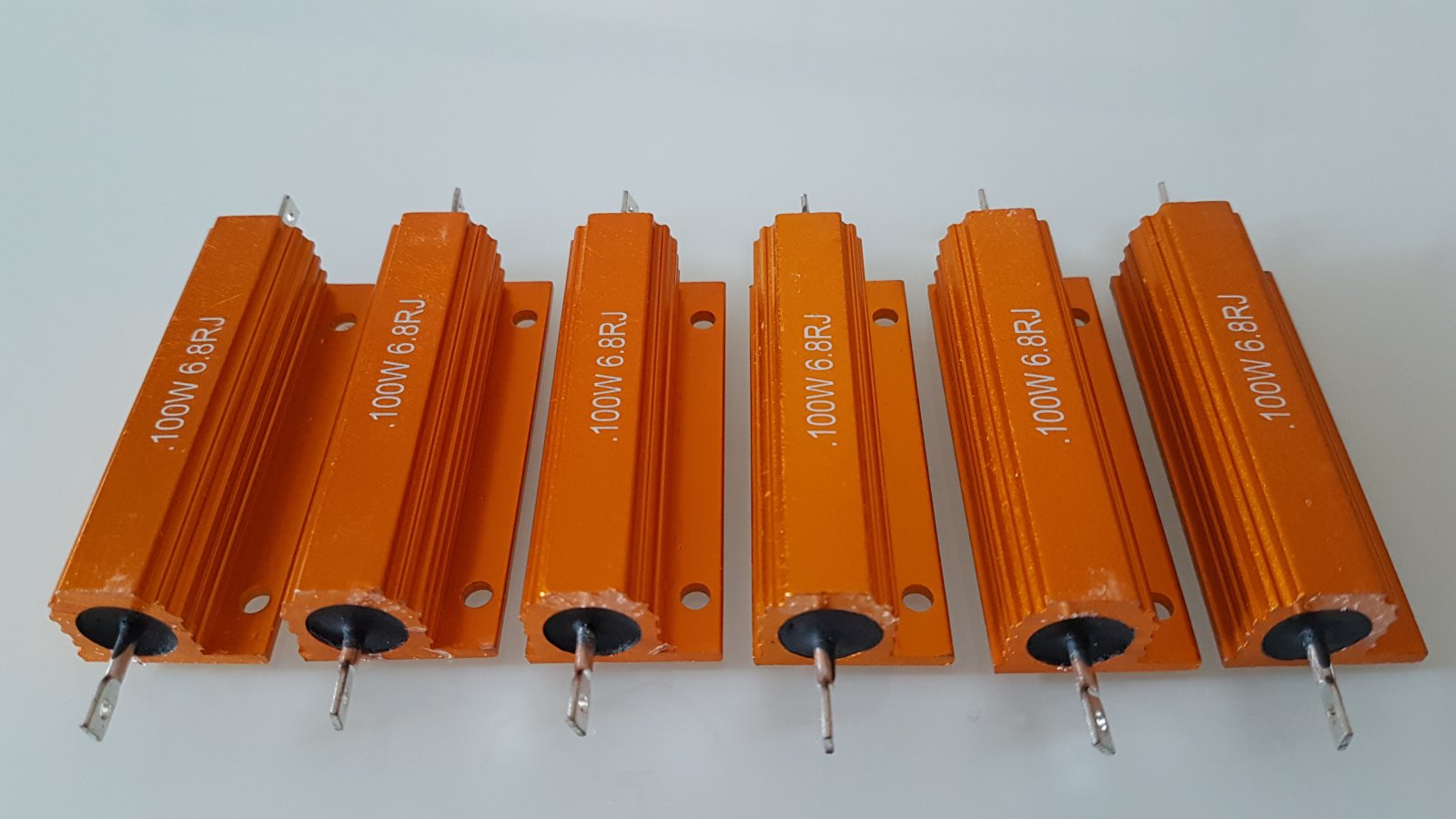

    Update.
    I changed the layout of the engines, so the measurements of the upper platform will be more correct.
    I will also change the resistances for the regenerated power, reading other posts I understood that they were under dimensioned. I took 3 ohm 100w, we hope they are the right ones for my 350w 24v motors.

  17. gigi
    gigi Active Member
    Nov 16, 2013
    467
    913Coins
    +141 / 1 / -0
    2DOF, JRK, 4DOF
    For this motor power dimension enginering suggest at leats 200w 3ohm resistor....I think for channel. so probably yuo need not only 3 but 6 resistor, 2 resistor in parallel for each channel . this mean 200w 3,4ohm resistor for channel.
    I hope I'm not wrong but it should be so. the required resistance is for each channel. therefore, if I connect 2 motors to one board and then use both the two channels available, the 100w 6.8 ohm resistors must be 4 per board, connected in pairs in parallel so that each channel has a resistor value of 200w 3, 4 ohm
  18. Milani Fabio
    Feb 21, 2019
    105
    Italia
    718Coins
    +74 / 2 / -0
    Quite right.
    After several confirmations I bought these resistors that I will put in parallel for each motor.
    They just arrived ….

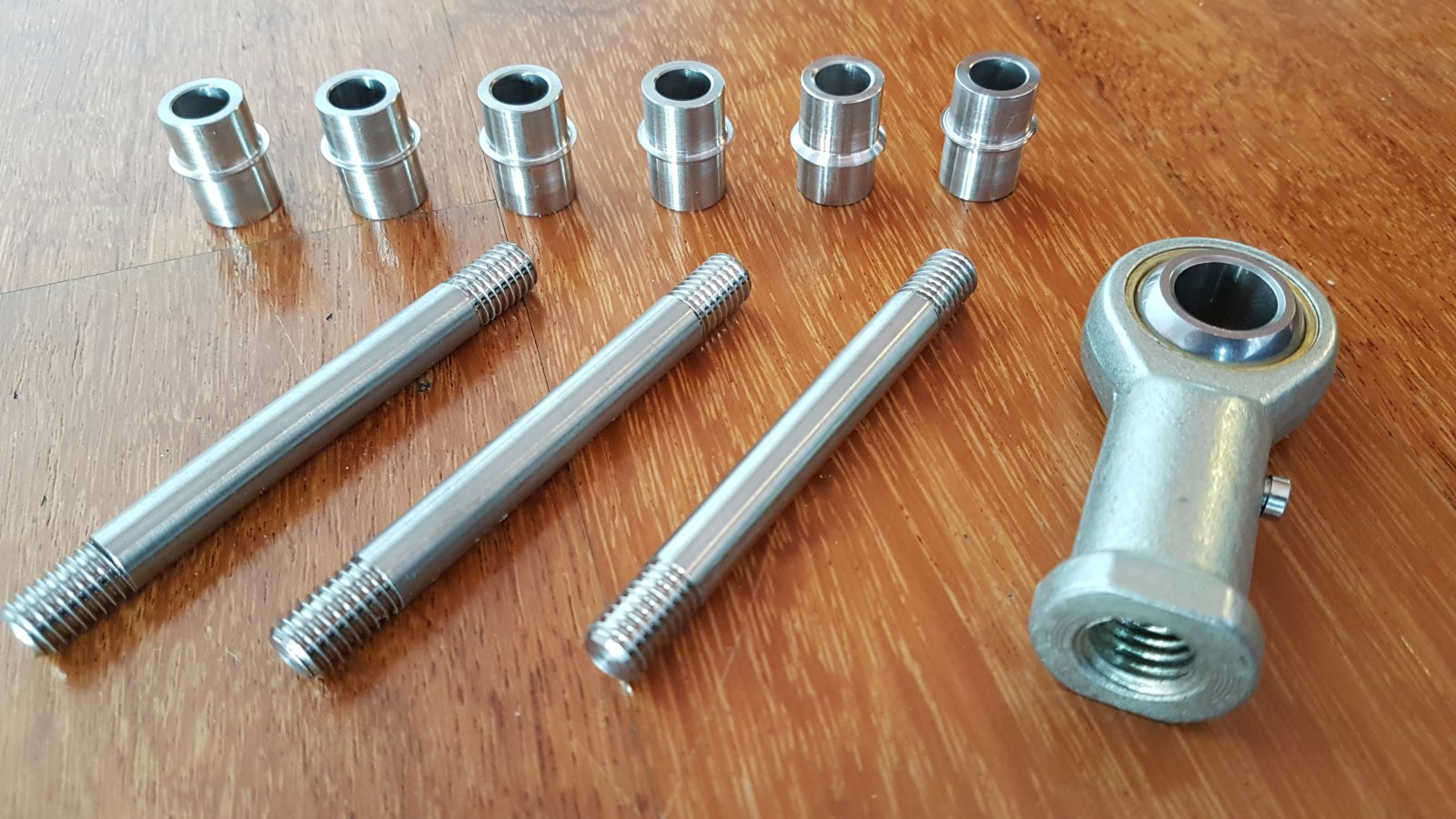

    718Coins
    +74 / 2 / -0

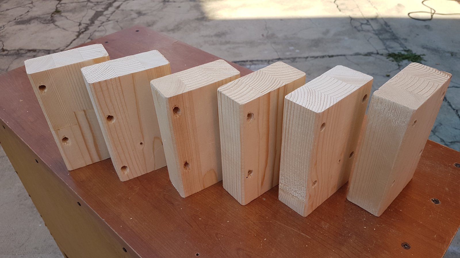

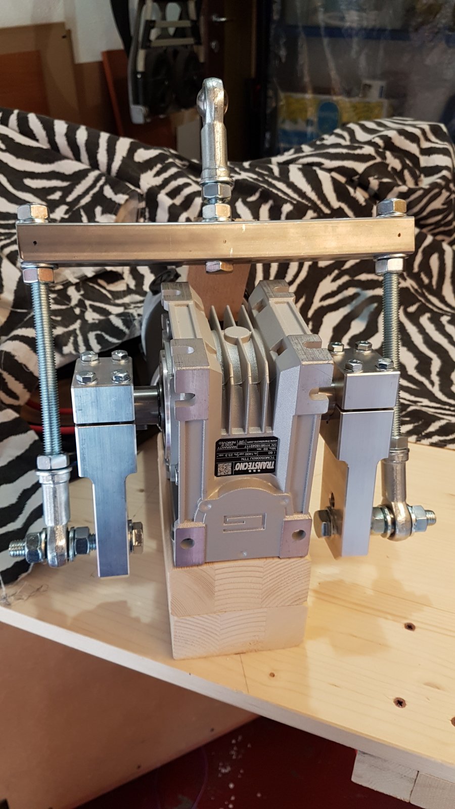

    New arrivals.
    The levers have arrived ... beautiful big .... oversized.
    The posts and the spacers, thus increases the possibility of angles of the upper base.
    Soon I will post photos of the assembled pieces.
    Hello
