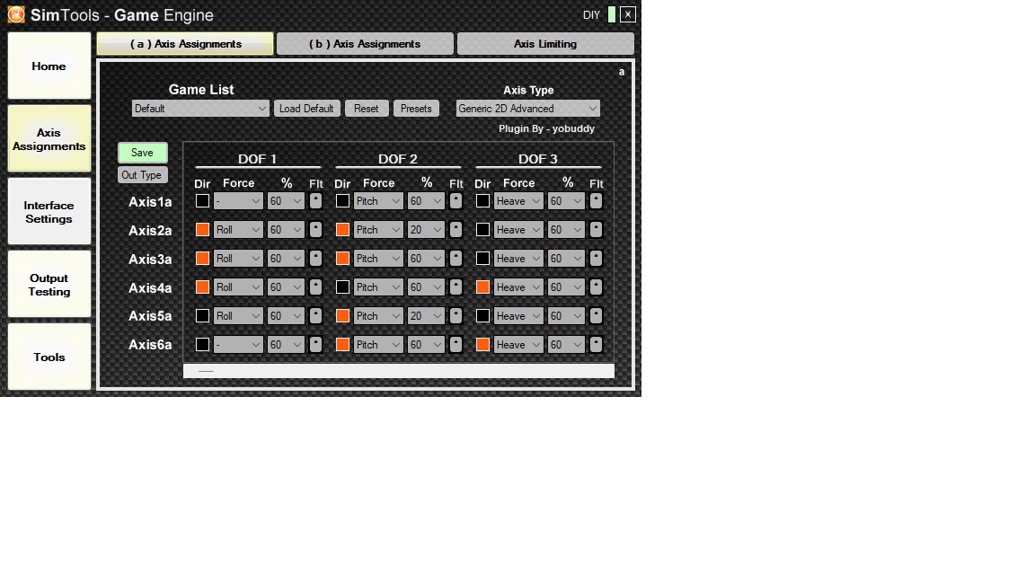

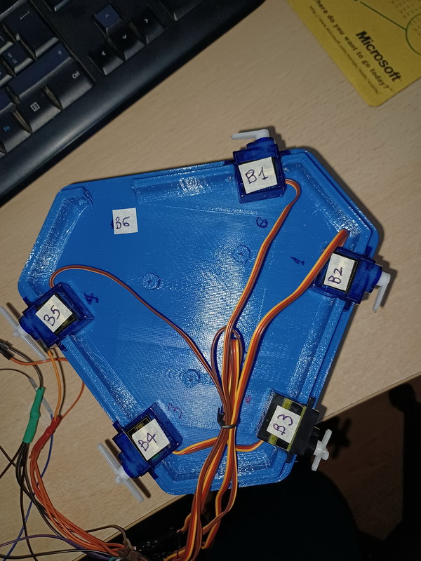

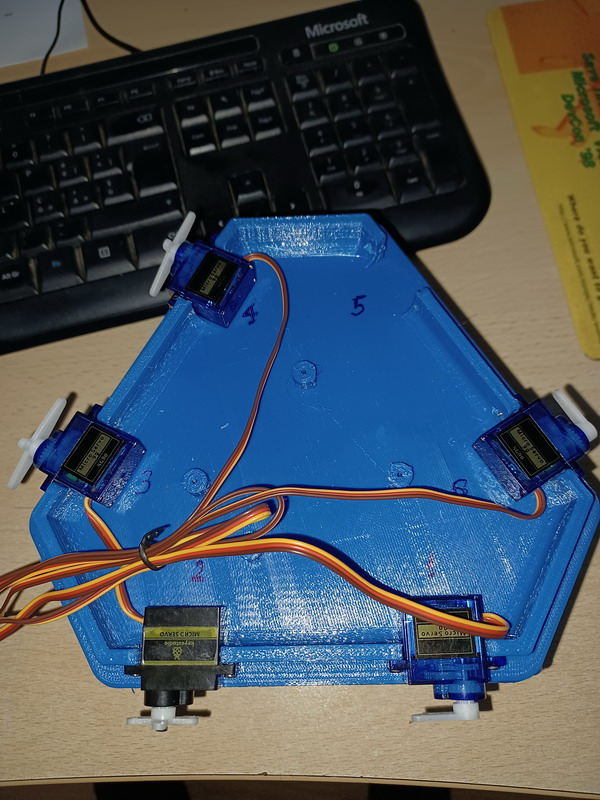

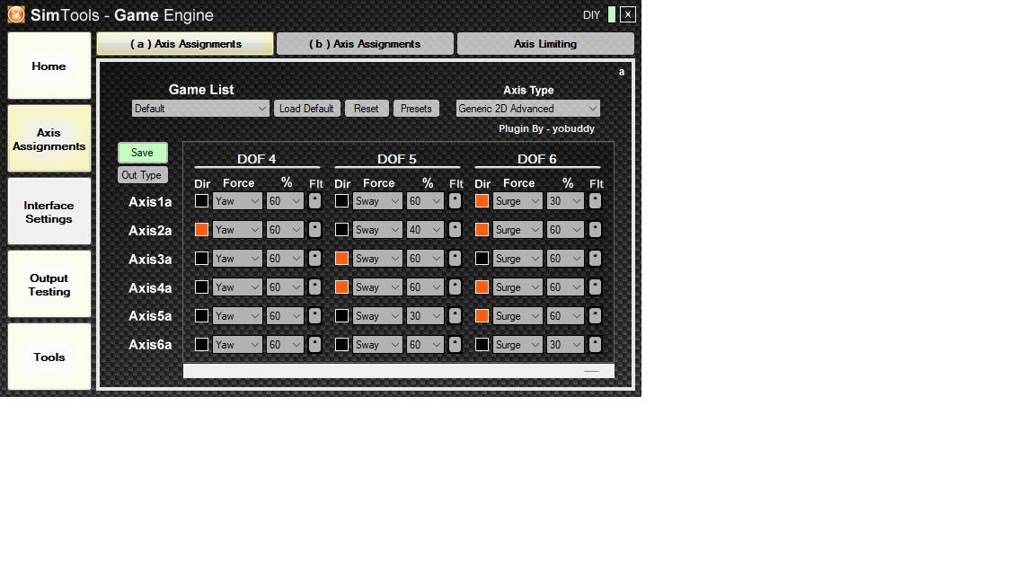

    Hi all, I would like to start understanding how to set axis assignments in simtools using a mini 6dof platform with RC servo.

    Having numbered the engines, I might have some help on how to get started ....?

    Hi noorbeast yes I have already modified the code for the six servos and in the video they move (5 because one has to arrive), I am reading all the various posts concerning the 6dof but I have not yet understood which way to use to organize the axes.

    Yes ok, with my 2dof I learned to play with the setup of the two axes, now with 6 things change, I would like to know if there is a way or procedure to do the setup, in the various posts I shot you can see the success of the operation but it is not explained how, I will try as I think the others have done, it was only to find out if there is a method.

    I followed the settings according to the logic of NjMotion https://www.xsimulator.net/community/threads/prototype-6dof.5045/
    and it seems to go quite well, at least I deduce from the movements of the servos as I still have to mount the upper platform
    soon the last missing servo should arrive and then it will be easier ... I think !!

    Heave: all actuactors should move in the same direction.
    Yaw: the actuators should work in a reserve way by pairs. 1 and 6 are reversed, 2 and 3, then 4 and 5.
    Roll: 1 and 2 are set the same. 5 and 6 are reversed with respect to 1 and 2. 3 and 4 are not used.
    Pitch: 1, 6, are set the same way. 3 and 4 reversed and 2 and 5 are not used.
    For Surge and Sway I find it more difficult also because I can't visualize the movement well without having the upper platform ...
    Now, I don't know if what I wrote corresponds to the real movement it would take some help ...

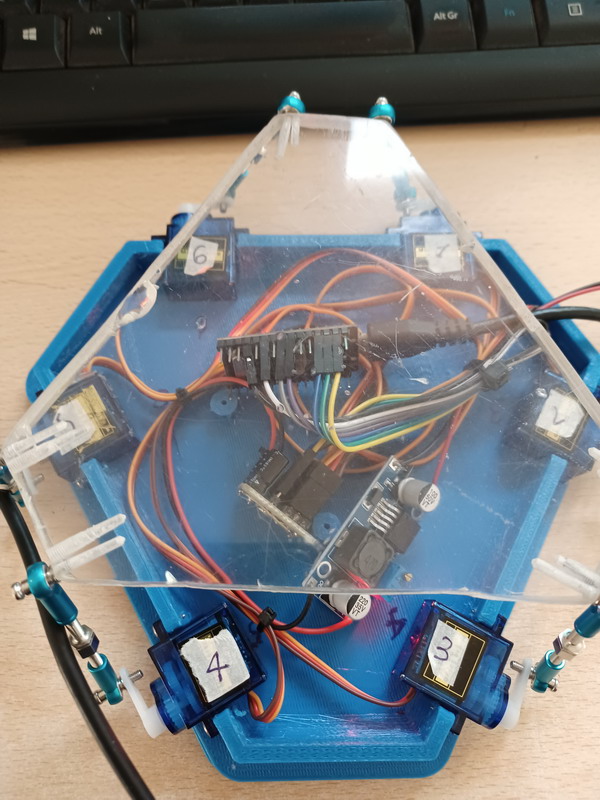

    I'm back...
    I managed to mount the upper platform and film the first test of the settings .... help !!!

    I would say a disaster !!!
    It is also true that I had done the setup without the upper platform so a bit randomly, now I have to refine the movements and here I would need someone to help me, perhaps showing me the way on how to start ....

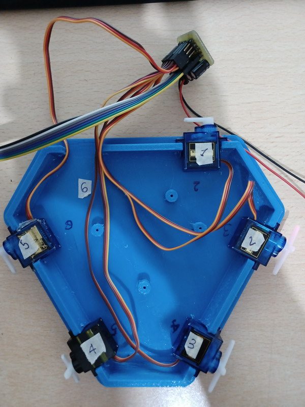

    For those who want to help me and to be able to help someone who might have the same difficulties as me, here is a picture of how I wired and numbered the axes that are shown on the "Axis Assignment" tab on Simtools.

    ... I think I'm on the right track .....

    But it is a base to work on at least, now reading the tutorials and having a working prototype I can try to refine the setup of the axes ....
    Slowly I hope to make it!

    I'll stop here for today, test on NoLimits2, I have to lower the percentages of the axes a little more ...
