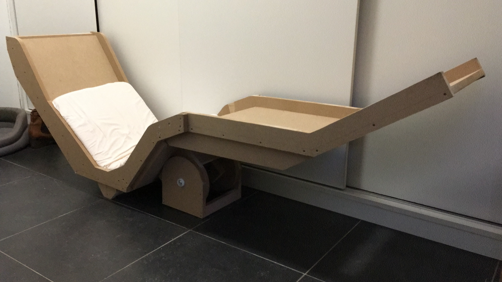

    I am making my own 2 DOF motion simulator as a school project. I don't have any experience in making a motion simulator, so any help or advice would be nice ;) I have already made my own seat and base to put all the components on.
    This is the seat I will be using. It can tilt in 2 different positions, so I can sit like in an F1 position or a GT position. ( thanks you Baj on the isrtv.com threat for the inspiration)
    The steering wheel adaptor still need to be added on the seat.
    The seat will be placed on a wooden board which will be connected with an other (floor)plate where the following parts are placed on to control the sim

    Cool trestle bed. :thumbs There are many wooden parts in the construction. How much weight does it have?
    Looks heavy.
    If the driver's seat changes the incline in 2 different positions (lying and sitting), then the center of gravity for one of the positions will definitely change. How are you going to implement this?

    The seat weighs about 20kg, so yeah it is quite heavy. For the moment I am only going to use the F1 position. When I sit in this position the center of gravity is exactly above the universal joint. Normally the center of gravity doesn't change that much when I put the seat in the Gt position. That's because the front of the seat is much lighter than the sitting area of the seat.
    But like you said I will probably have to adjust a few things, to make sure the center of gravity is on the exact same positions at all times.

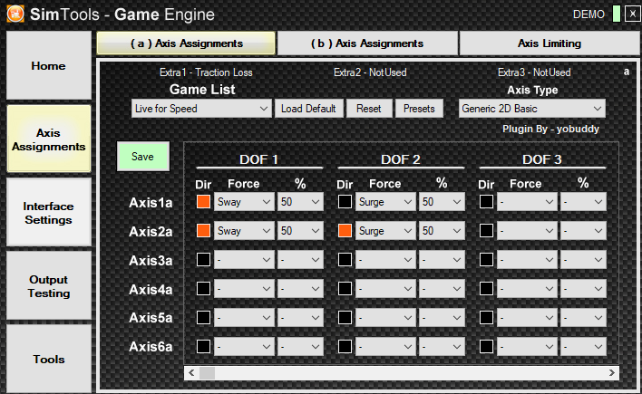

    The g-seat concept definitely looks really nice :thumbs. It will certainly be something I want do add to my sim in the future. But for moment I'll stay with my concept. My next step is to make the system work fluently, without any niggles. At the moment the motors aren't always responding in the correct way, when I am using Live for Speed. I'll give you an example to give you a better image. When I turn to left the motors don't react instantly. There is always a little delay before they respond. Aside this issue, they sometimes only respond when I drive over a curbstone. So it's very unclear to me what I should do now.

    These are the settings I am using. I've put the percentage on 60% for one of the motors, so they would rotate equally. (pwmmax in smc3 utils is 120)

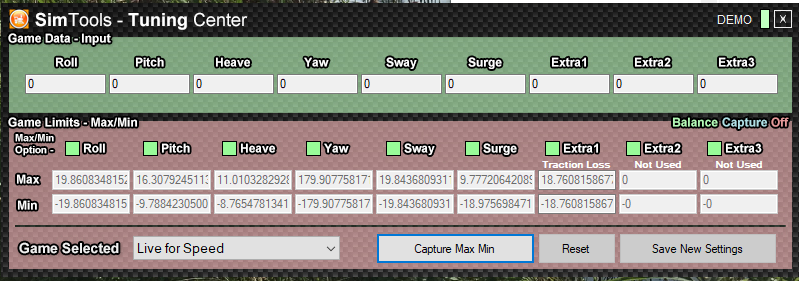

    Can you please add a picture of the Tuning Center while the game is running.
    Axis % totals should be around 100% combined, otherwise you risk clipping: https://www.xsimulator.net/community/faq/axis-assignment-percentage-totals.120/
    Grab a copy of the SimTools manual and keep in handy for reference: https://www.xsimulator.net/community/faq/rtfm-start-with-the-official-simtools-documentation.117/
    Then see the motion profile tuning tips here: https://www.xsimulator.net/community/faq/rtfm-start-with-the-official-simtools-documentation.117/
    Keep in mind the smaller the Tuning Center value the snappier the response, but over a more limited range.

    Hi noorbeast,
    This is a photo of the tuning center while the game is running.
    I made some changes in my axis assignment settings. I decided to switch this because the simulator did not respond when I was using pitch and roll. After you said I had posted a picture of the tuning center, I saw there was nothing happening in the tuning center. So after I made these changes everything was working very well. I only need to do some further testing.
    Thanks for replying:thumbs.

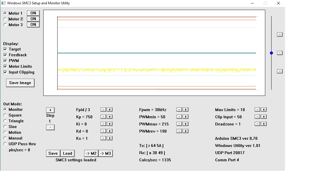

    have you use SMC3 to adjust motors and if so what kind settings you have put there?

    Yes I've used SMC3. I just followed the tutorial (https://www.xsimulator.net/communit...3dof-motor-driver-and-windows-utilities.4957/), so I haven't done anything special in my settings.
    These are the numbers that I've changed to setup the motors.
    Kp= 400
    Max inputs= 255
    Clip input = 255
    PWMmax = 120

    Here are my settings. Its good to test several versions and not settle the first one. I test many versions and forget to put same settings to second motor and after testing i afraid i was broke the motor. But it was only wrong setting. Have you get both motors work? Was the problem in pot?
