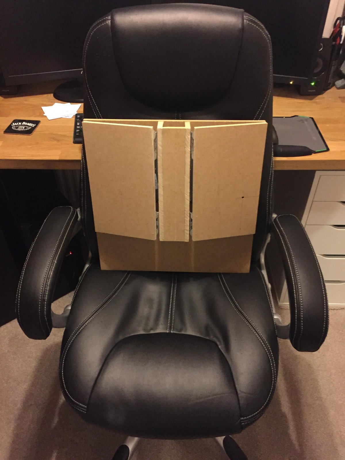

    Due to lack of space I could never afford the luxury of a full size simulator. But I still wanted to experiment and started producing a mini build using servos - just for fun https://www.xsimulator.net/community/threads/2dof-mini-arduino-motion-platform-protoype.9739/
    I've learnt so much from doing a mini version, one of which is that high torque servos can be used to make a 'g-seat'. The idea popped into my head that I could design a g-seat that fitted onto my existing office chair - I could at last experience some motion!
    So over the last week I have built a proof of concept. It's not perfect, and an improved slimline V2 is already in the works. But what it did do was prove to me that a g-seat can give a great sense of motion - especially in VR - and is a brilliant alternative to a motion sim.
    I'm no where near finished, but I am going to try and cover everything that I did and discovered as, while these forums are superb, I sometimes struggled to find the information I was looking for.
    More to come...

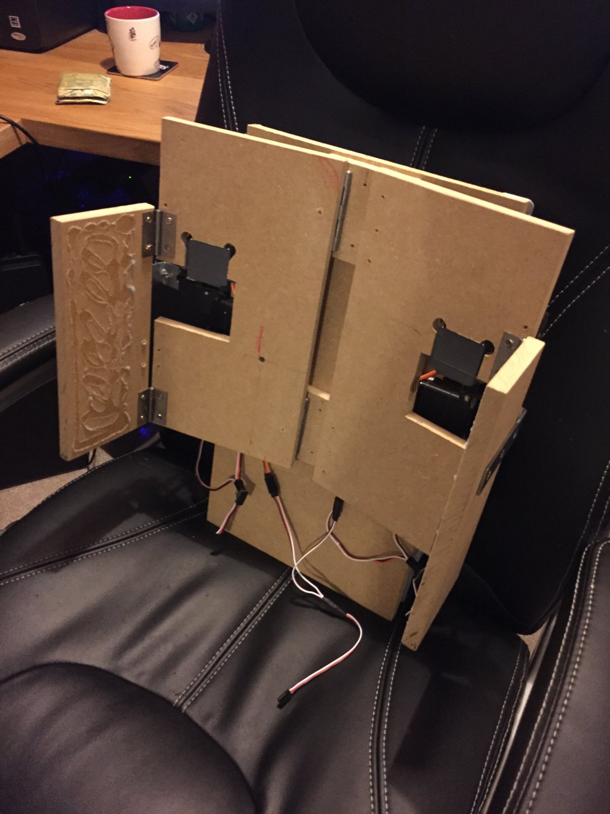

    The built frame

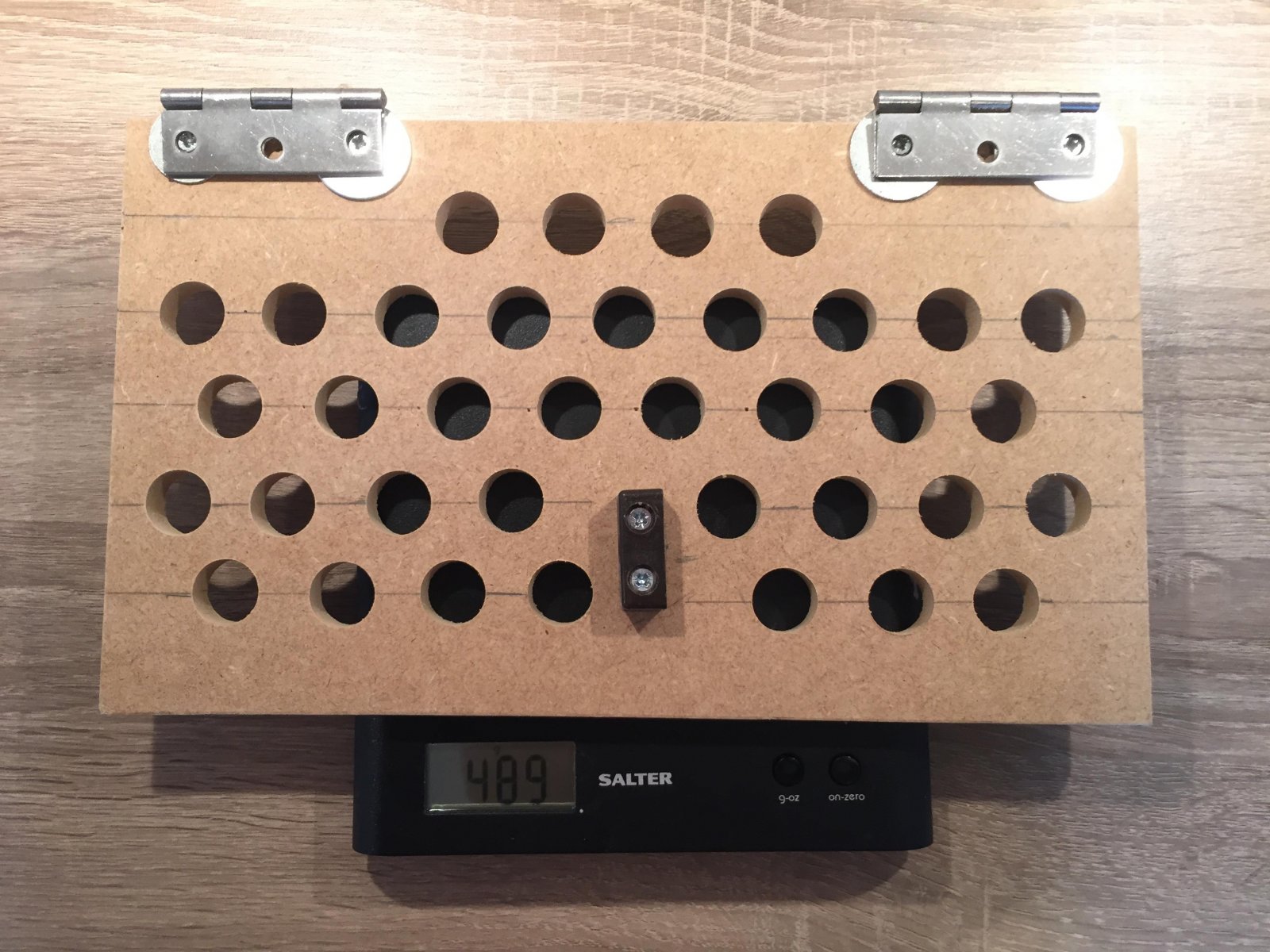

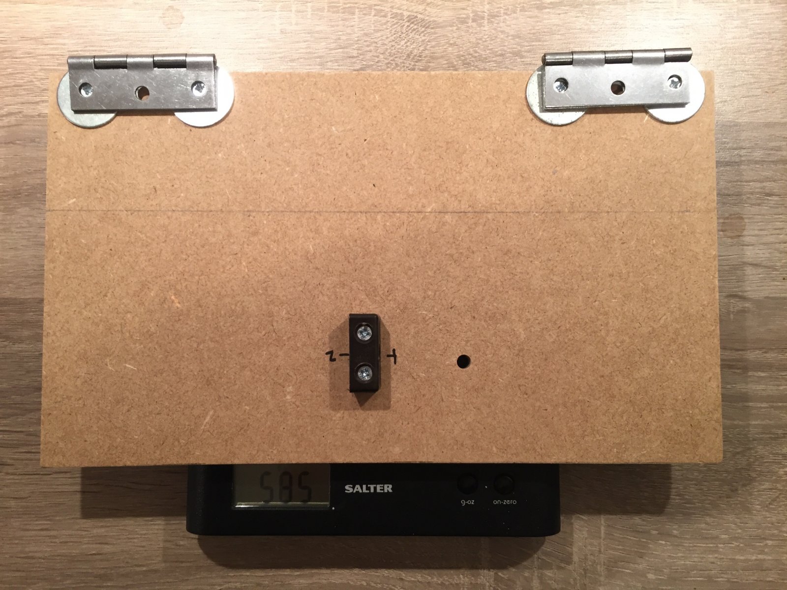

    Some weight saving
    I plan to do the same to the back plate (and cut off excess material)

  7. early_m
    early_m Active Member
    Jul 28, 2016
    318
    Chelmsford
    814Coins
    +344 / 4 / -0
    Absolutely fine, before I bought them I put some scales behind me and forced myself back as hard as I could and only mangaed to get it up to 10kgs - so plenty of room left. Im hoping 2 on each side for the base will be ok. Im 70kgs so should be fine. Running at 6V the speed is also good
    EDIT: I now understand I got this totally wrong. For anyone else who is unsure, 30kg doesnt mean it can lift 30kg. It is torque in kgcm. To work out what it can lift you need to use moments to calculate the force at the lever length you're using
    30kg.cm means the servo can lift 30kg with a 1 cm lever, 15kg with a 2 cm lever, etc.

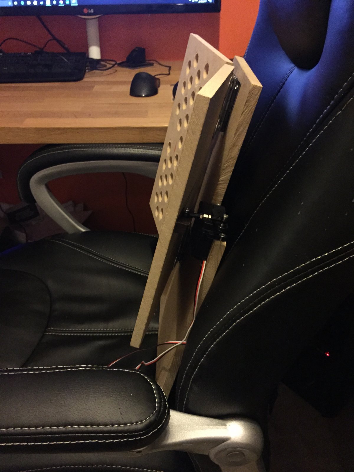

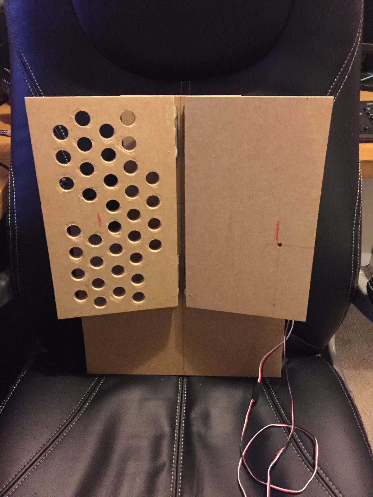

  10. early_m
    Jul 28, 2016
    318
    Chelmsford
    814Coins
    +344 / 4 / -0
    Made some progress over the weekend. Put version 2 together which is lower profile allowing me to sit further back in my seat
    Also narrower and much lighter

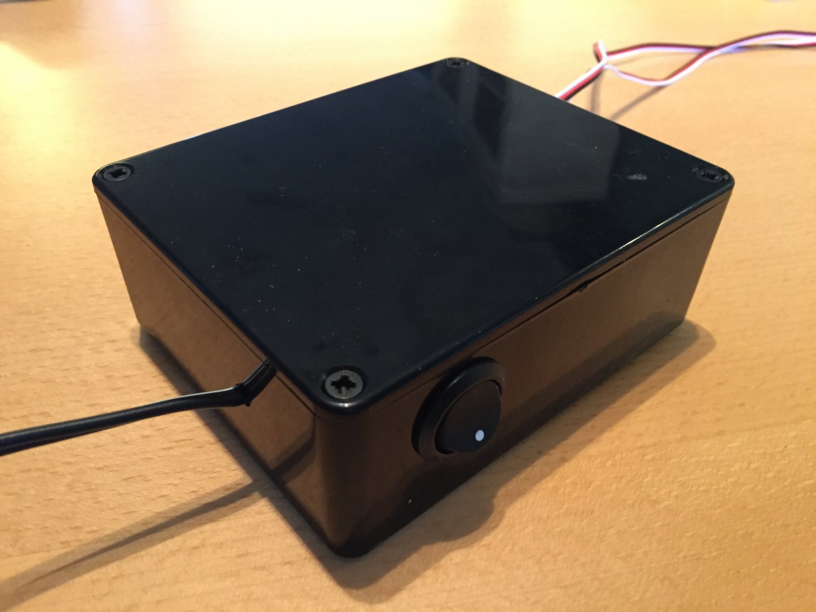

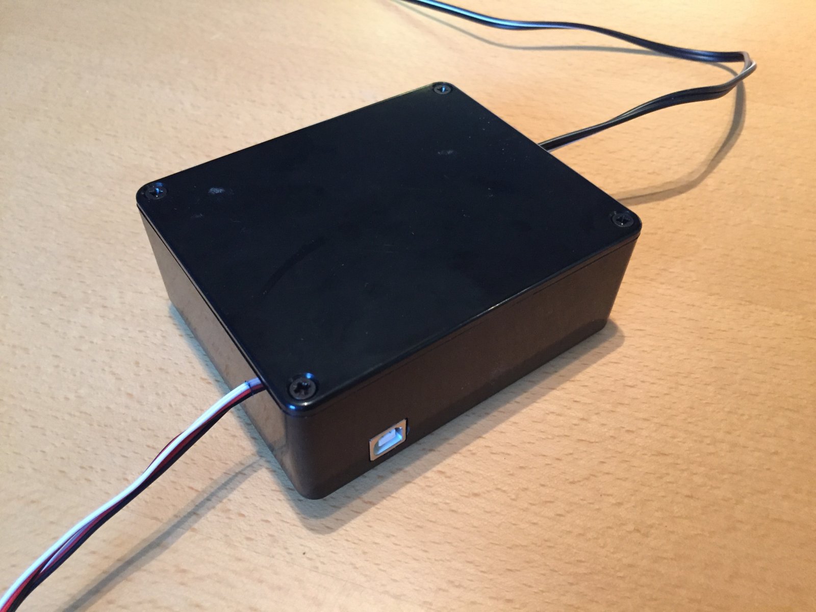

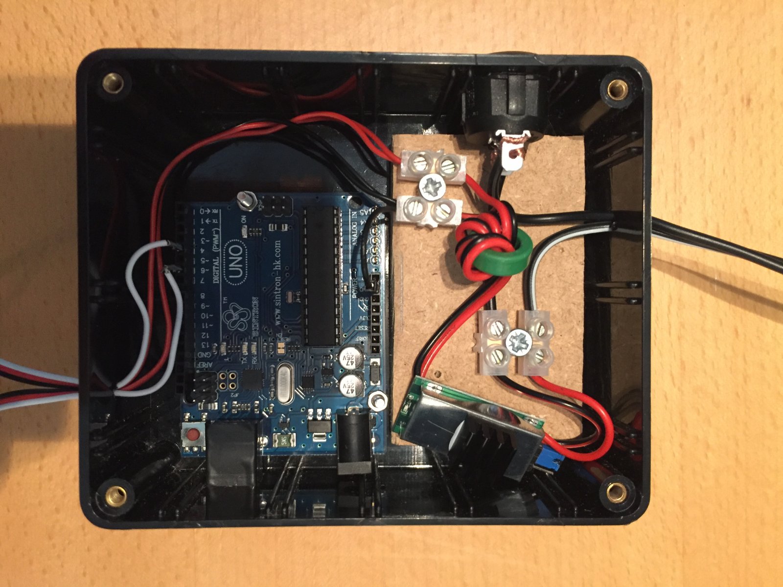

    Also made a 'control box' to keep everything nice and tidy
    Servo wires and ard usb port
    Power in and switch (for servo supply)
  12. early_m
    Jul 28, 2016
    318
    Chelmsford
    814Coins
    +344 / 4 / -0
    The servos are able to move me but they make a groaning noise and vibrate minutely under load. Is this 'jitter'? And does it mean I'd be best off adding a second servo to each side?

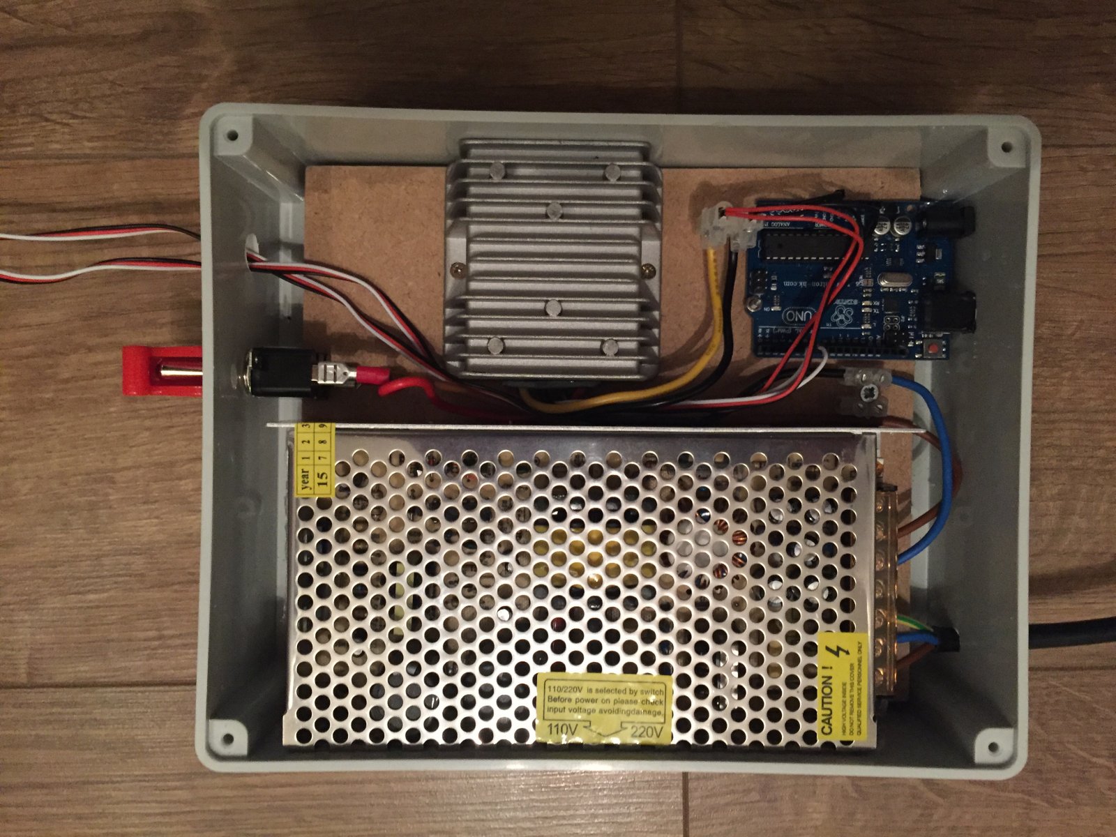

    Version 3.0
    The back paddles now have 2 servos each. One was enough to apply pressure but jitter sometimes occurred. Being so cheap adding a second was a no brainer. They deal with Surge, Sway and a little Pitch.
    I have also added side paddles to apply pressure down the side of the body. This simulates lateral G force (Sway) much more effectively than back paddles alone. It really feels like you're being pushed into the sides of the seat when cornering. I didnt think the servos would need much torque but for realistic pressure they need to be quite high torque. My current ones are about 13kgcm and struggle a little so will source another.
    In total there are 3 Axis. I'm using @eaorobbie 's RC code, modified to include an additional servo.
    Lastly I will add some padding to make a little more comfortable.
    Next step is to put together the base which will simulate surge(breaking), heave and sway. I plan on using 3 30kgcm servos under each leg (6 in total).
    Also needed more power so have put together a new power/control box giving 6VDC 20A output
