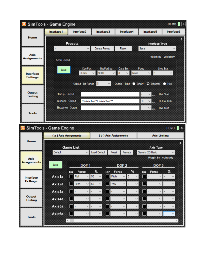

    Here are screenshots of my simtools settings. i also have game manager open running live for speed please assist sim settings.png

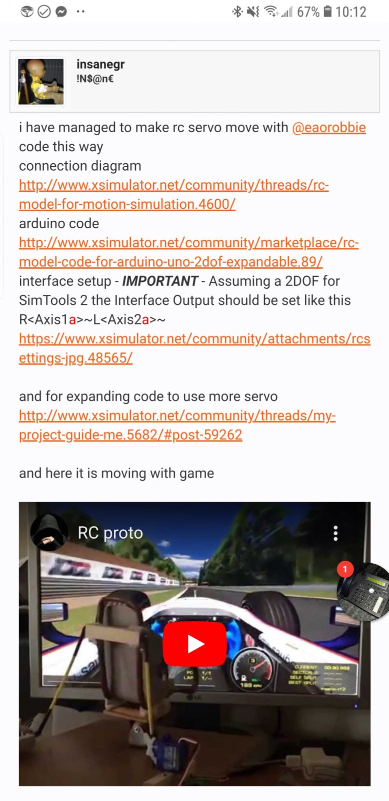

    Abram, it's not my code for sure.. AEROBBIE code. Take a look at this link if you have time. I used it to initially set up my simtools. I cant tell what the characters are in the interface output section you show but they should be like this:
    [A<Axis1a>][B<Axis2a>]
    also Output Type - Binary
    and BitsPerSec - 500000
    Read through this link. Set it up the same I would think.

    Check your Interface Output, as you seem to have an extra character * at the end: R<Axis1a>~L<Axis2a>~
    Like this:

    From reading the sketch in post 2 it looks like your simtools settings in post 3 should work. I suggest you try using axis setting for output testing from Simtools instead of dof.

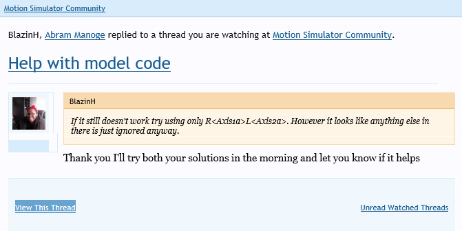

    If it still doesn't work try using only R<Axis1a>L<Axis2a>. However it looks like anything else in there is just ignored anyway.

    I got this from my inbox. You must have deleted it though? Are you a quitter?
  17. Abram Manoge
    Abram Manoge Member
    Apr 6, 2021
    46
    Web developer
    South Africa
    319Coins
    No i didn't lol. a moderator deleted is as spam i think. I'm still gonna continue looking for solutions
