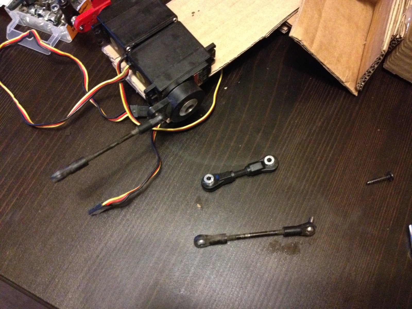

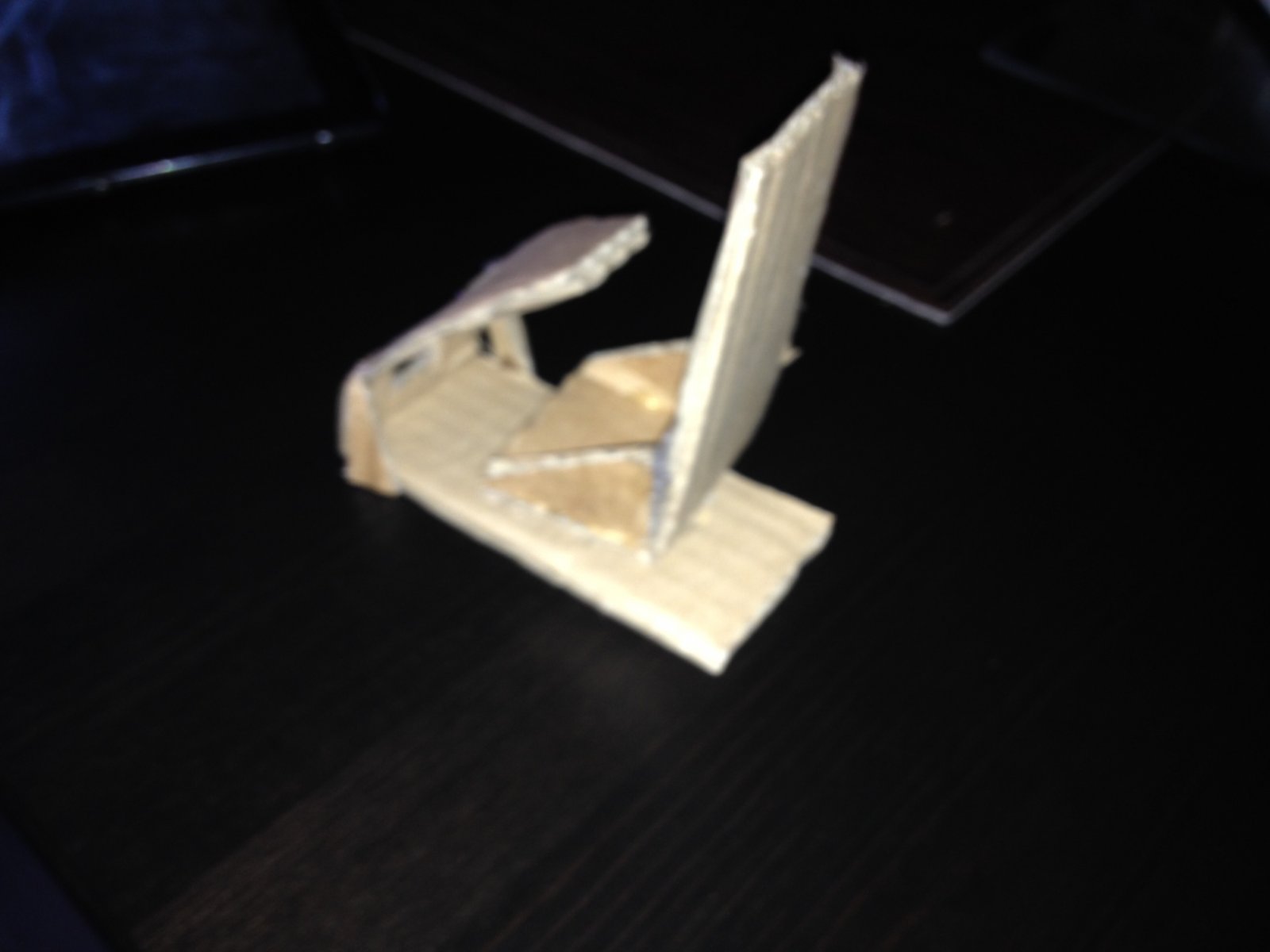

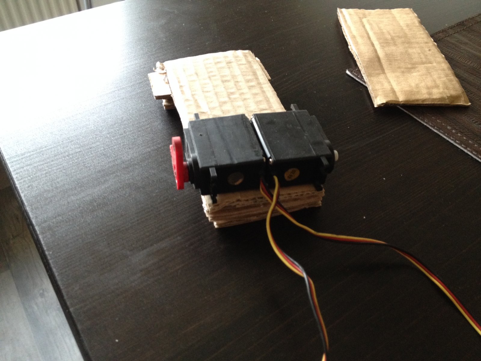

    Just wanted to try building a simulator with servos before getting in to the real deal.
    Had a rc car just laying around that i could salvage servos and some other stuff from.
    2x Hitec HS-311 servo
    1x Traxxas u-joint
    1x Arduino nano
    Some cardboard
    I've followed this guide when setting up simtools http://www.xsimulator.net/installing-simtools/
    I've used eaorobie's arduino code and have set up my servos like he's done. http://www.xsimulator.net/community/threads/rc-model-for-motion-simulation.4600/
    Now to the problem. When testing the output to the servos, the servo that is connected to pin 5 to the arduino, only moves between 0-90 degrees. When it at 90 degrees it moves back to 0 again. The other servo connected to pin 4 only moves to 90 and stays there. See video for more detail

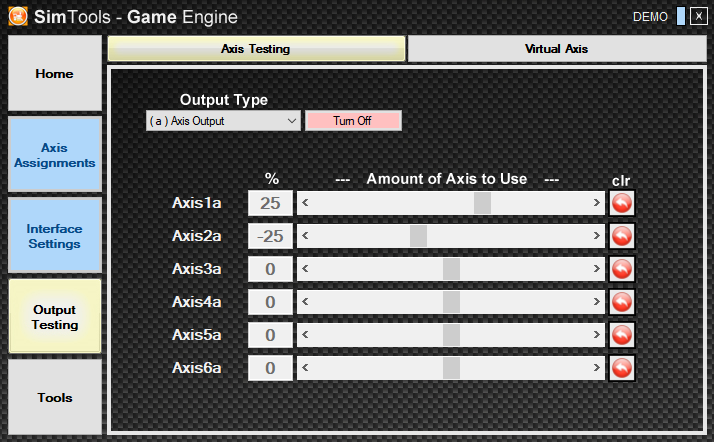

    i have managed to make rc servo move with @eaorobbie code this way
    connection diagram http://www.xsimulator.net/community/threads/rc-model-for-motion-simulation.4600/
    arduino code http://www.xsimulator.net/community/marketplace/rc-model-code-for-arduino-uno-2dof-expandable.89/
    interface setup - IMPORTANT - Assuming a 2DOF for SimTools 2 the Interface Output should be set like this R<Axis1a>~L<Axis2a>~ https://www.xsimulator.net/community/attachments/rcsettings-jpg.48565/
    and for expanding code to use more servo http://www.xsimulator.net/community/threads/my-project-guide-me.5682/#post-59262
    and here it is moving with game
    thnx to @eaorobbie i made my first project here and i am keep going

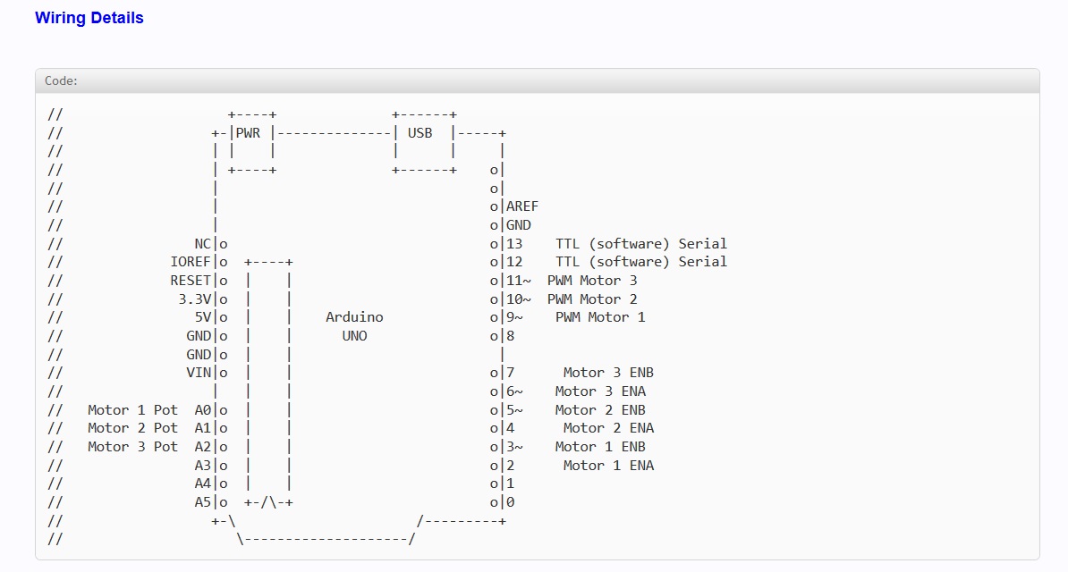

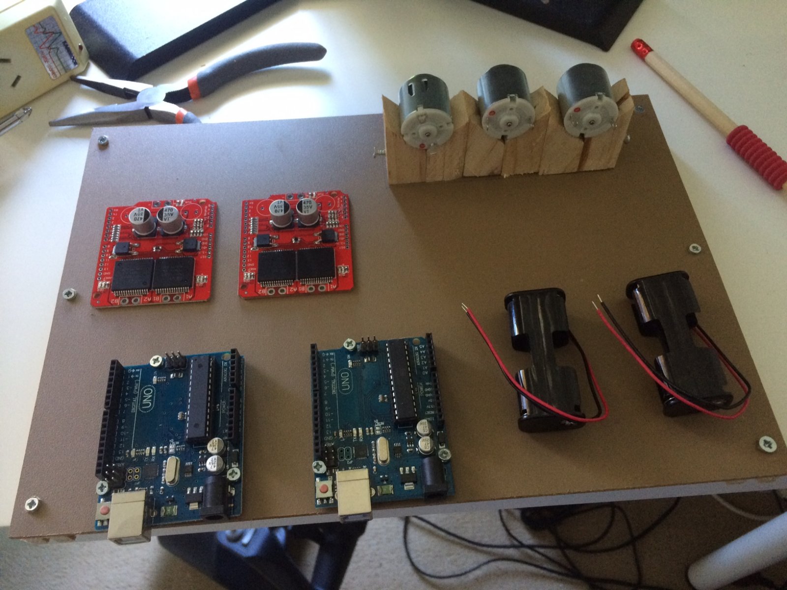

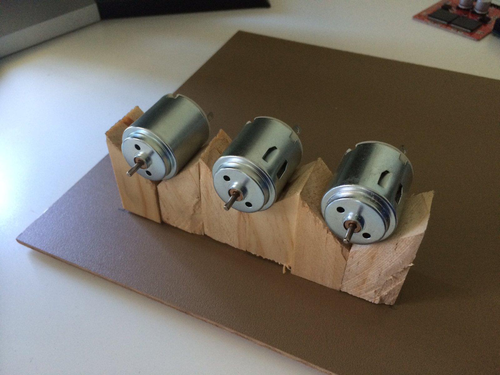

    Hey Guys,

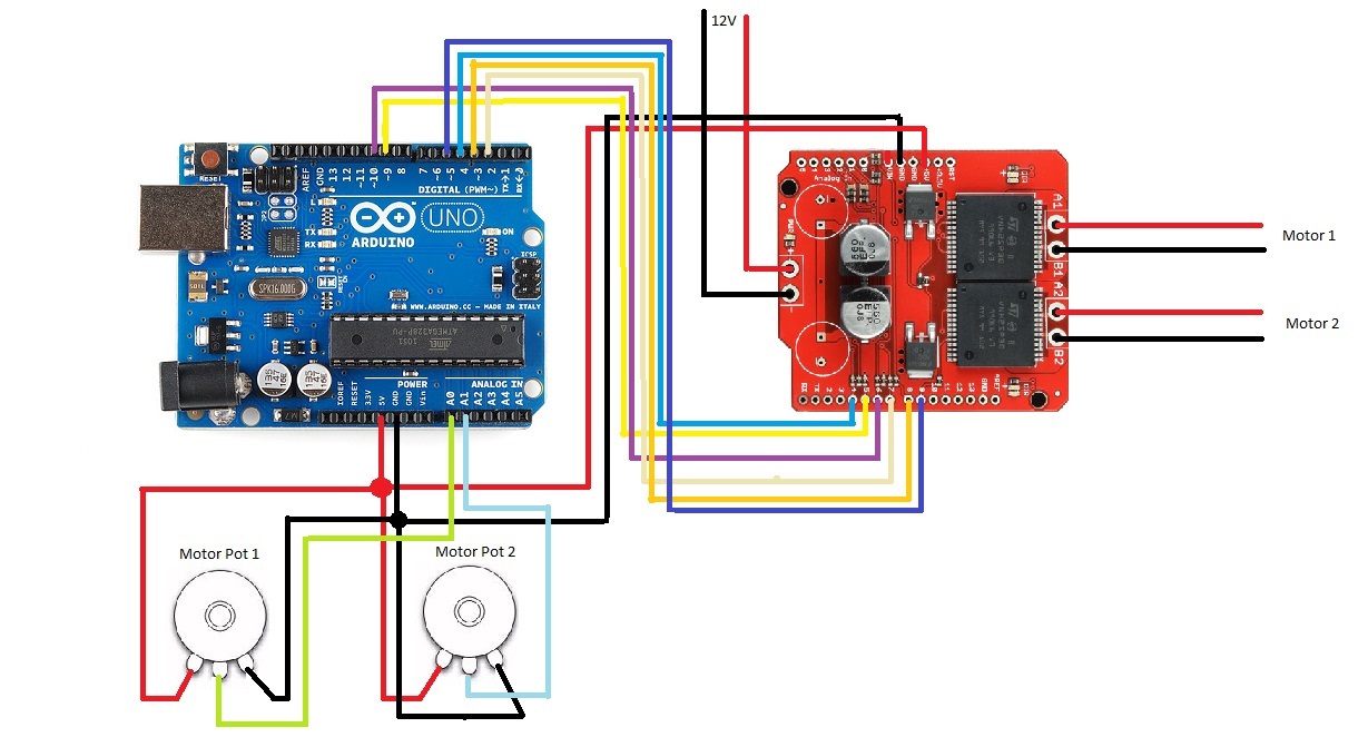

    Cant find a wiring diagram for 3dof using Arduino and monster moto, plenty of 2d0f... can someone help. I have found a few 2d0f and 1 3dof but that is not using arduinos and mottos (see attached) I can't find the links anymore...sorry
    I am creating a scale model myself using ardunio and monster moto boards before I go full scale. I want to make sure the model is working properly, i have created this board (just waiting on the pots)
    and making the 3 motors pitch roll and yaw.
    any help would be very much appreciated :)
    Cheers

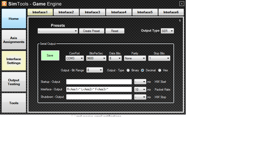

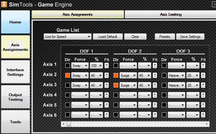

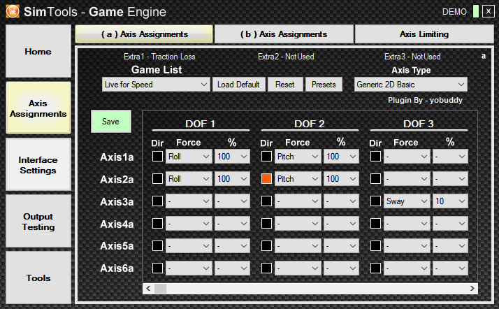

    hi, where can i refer to set the axis assignment for 2 DOF?
    currently i am using this setting.
  8. obobo
    obobo Active Member
    Nov 8, 2016
    248
    1,323Coins
    +77 / 1 / -0
    It's not pitch and roll that you should have ??
    21,581
    151,100Coins
    Those settings look to be from the SketchUp powered model tutorial. You should be using a configuration that suits your design and hardware, even if that happens to be a 2DOF model in something like SketchUp.
    This is another member's project page, you need to start your own and post information about your project so members can give advice. Please start your own project thread here: http://www.xsimulator.net/community/forums/diy-motion-simulator-projects.22/

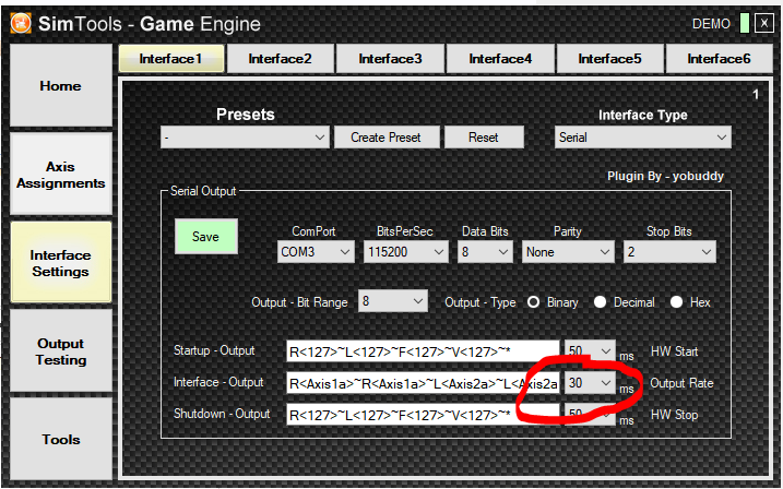

    Hi There, Hope you are well !
    Any idea how to optimize the code?
    I try to rework it, but still have some glich. The input seems to not be correctly manage and send thru other servo (I've extended to 3do, 4 dof but testing unde 2dof)
    The first symptoms where when I was on -1 that trow the servo way out of range...
    Then I see the servo totally out of mind... you change R and it move the number 2...
    I have reworked multiple time, but as I'm not an expert, it start to be quite difficult...
    - Added an LCD to get some message
    - try to add a Stop code '*' in Simultool. R<Axis1a>~L<Axis2a>~F<Axis3a>~V<Axis4a>~*
    - Try change the plug
    - Try to optimize the Scaling
    Noting really work...

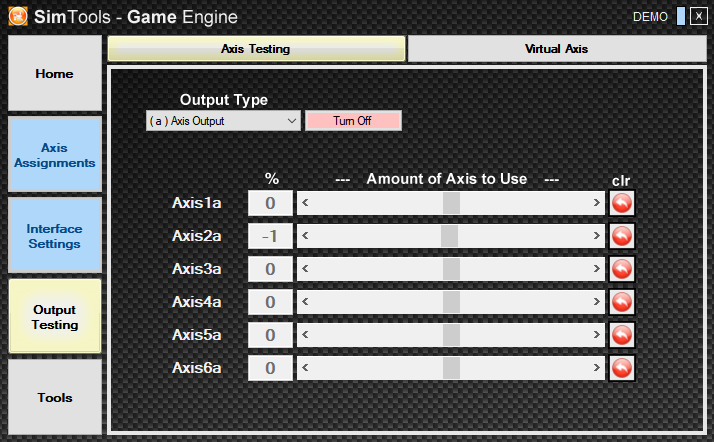

    Can you please post pictures of your SimTools settings, as looking at the model movement they do not seem to be refined.
  13. smallmadtv
    smallmadtv The Astrophotgrapher Gold Contributor
    Dec 23, 2020
    10
    Tech Manager
    Belgium - Sambreville
    100Coins
    2DOF, 3DOF, Arduino, 4DOF, 6DOF
    I try with these:
    and these one where I double the info seems to work better:
    R<Axis1a>~R<Axis1a>~L<Axis2a>~L<Axis2a>~F<Axis3a>~F<Axis3a>~V<Axis4a>~V<Axis4a>~*
    I also try different Output type, Parity, or the 50ms... even the BitsPerSec...
    My current code is here:

    I can't see from your video that there are more than 3 axis, if there are more than 3 axis please post model pictures so they are clear.
    For a 3DOF the Interface Settings should be like this, so edit the code accordingly as well: R<Axis1a>~L<Axis2a>~F<Axis3a>~
    Leave out the Startup and Shutdown for now.
    What are your Axis Assignment and Tuning Center settings, please post pictures.

    I have these settings fortesting now :
    and forLFS:
    Does it really matter ? As I'm testing within Simtool, with axes screen:
    Seems, I'm two finger to have it correctly setup.... But can find the solution
    for me the problem remain in the arduino to read the serial messages without skip, jump or incomplete message

  18. noorbeast
    21,581
    151,100Coins
    The Axis Assignment total (horizontal total) should be around 100, not 100 per axis: https://www.xsimulator.net/community/faq/axis-assignment-percentage-totals.120/
    A dedicated axis can be 100 percent allocation.
    If properly configured you should not need axis limiting, generally that is applicable to protect hardware like SCN actuators.
    Grab a copy of the SimTools manual and keep it handy for reference: https://www.xsimulator.net/community/faq/rtfm-start-with-the-official-simtools-documentation.117/
    Then see the motion profile refinement tips and do each axis initially one at a time: https://www.xsimulator.net/community/faq/steps-to-create-a-motion-profile.228/

    Yes, try multiple one without success. The only parameter that seems to have an impact is this one in red:
    When I put 50 the error seems to reduce. Note that if I put less than 30, the model jiggle around
    :D :D :D :D

    As per my earlier comment re what appears to be 3 axis: https://www.xsimulator.net/community/threads/2dof-simulator-servo-model.6851/#post-210879
    Can you please explain your Interface Output settings, as they look to be messed up to me for a 3DOF:
