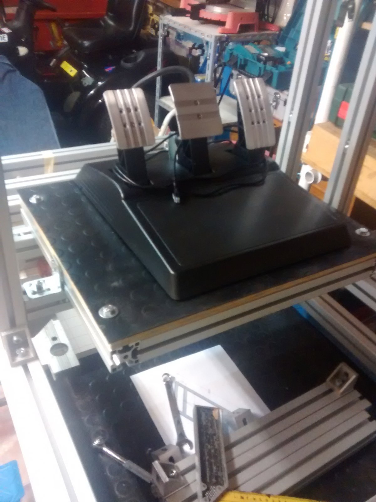

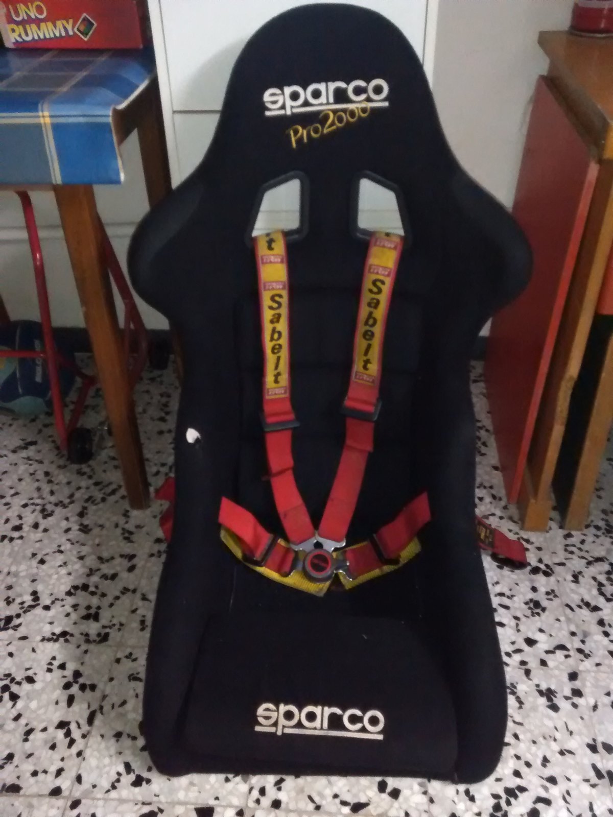

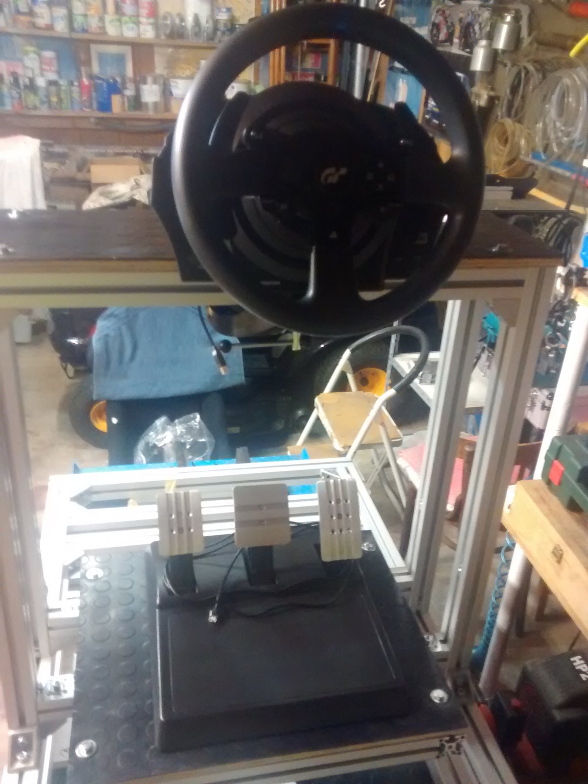

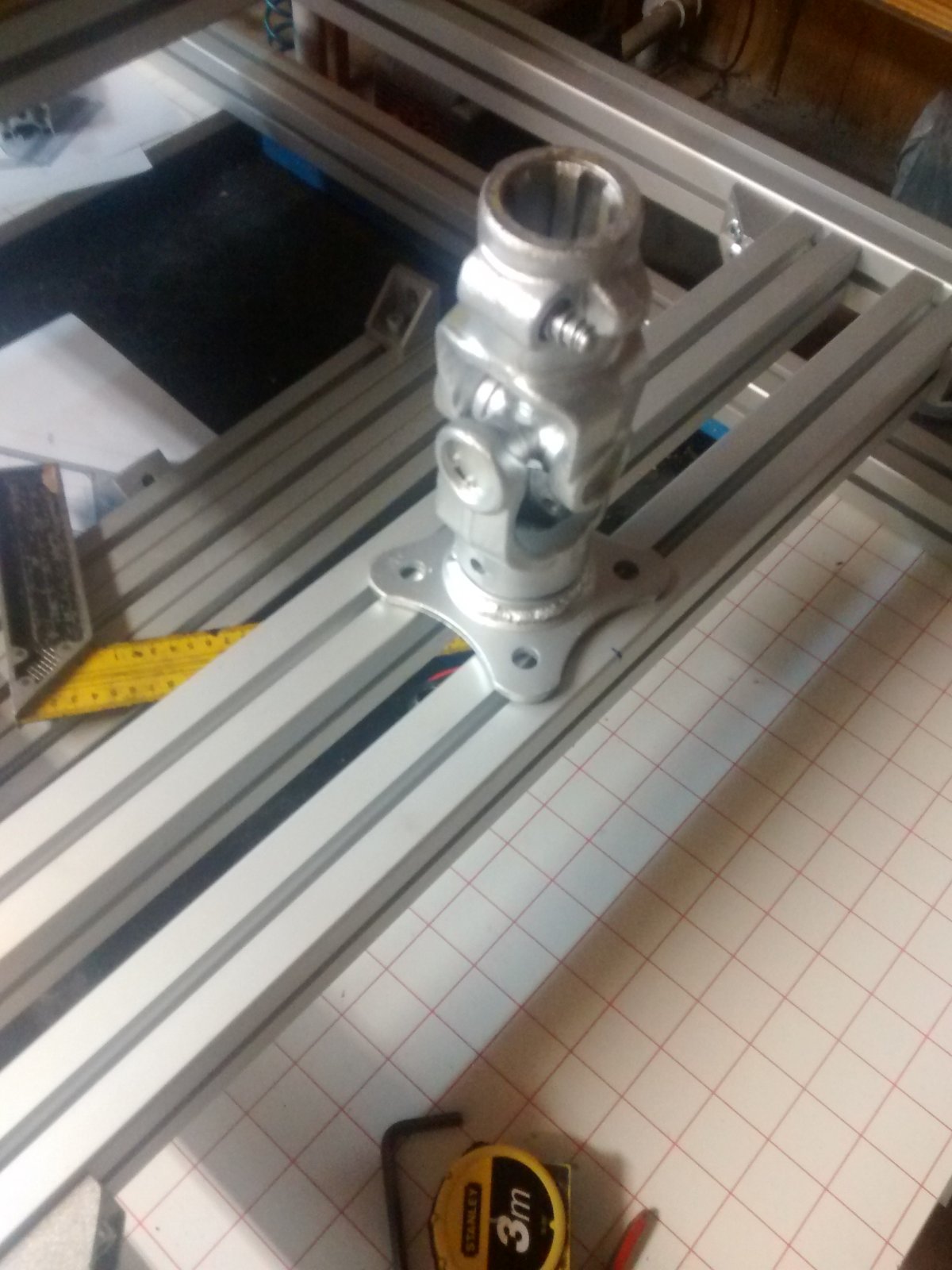

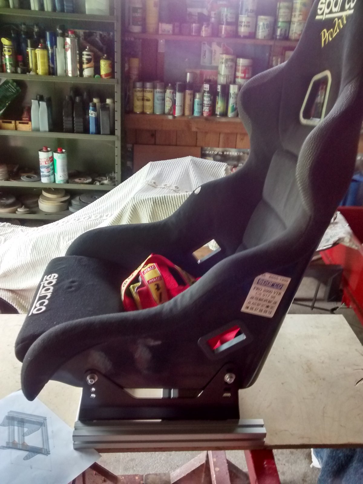

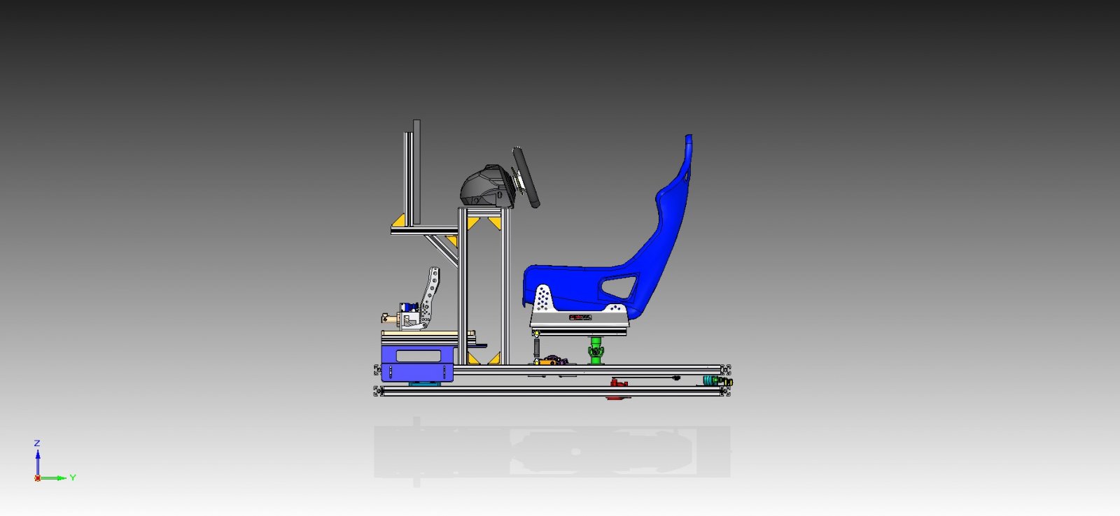

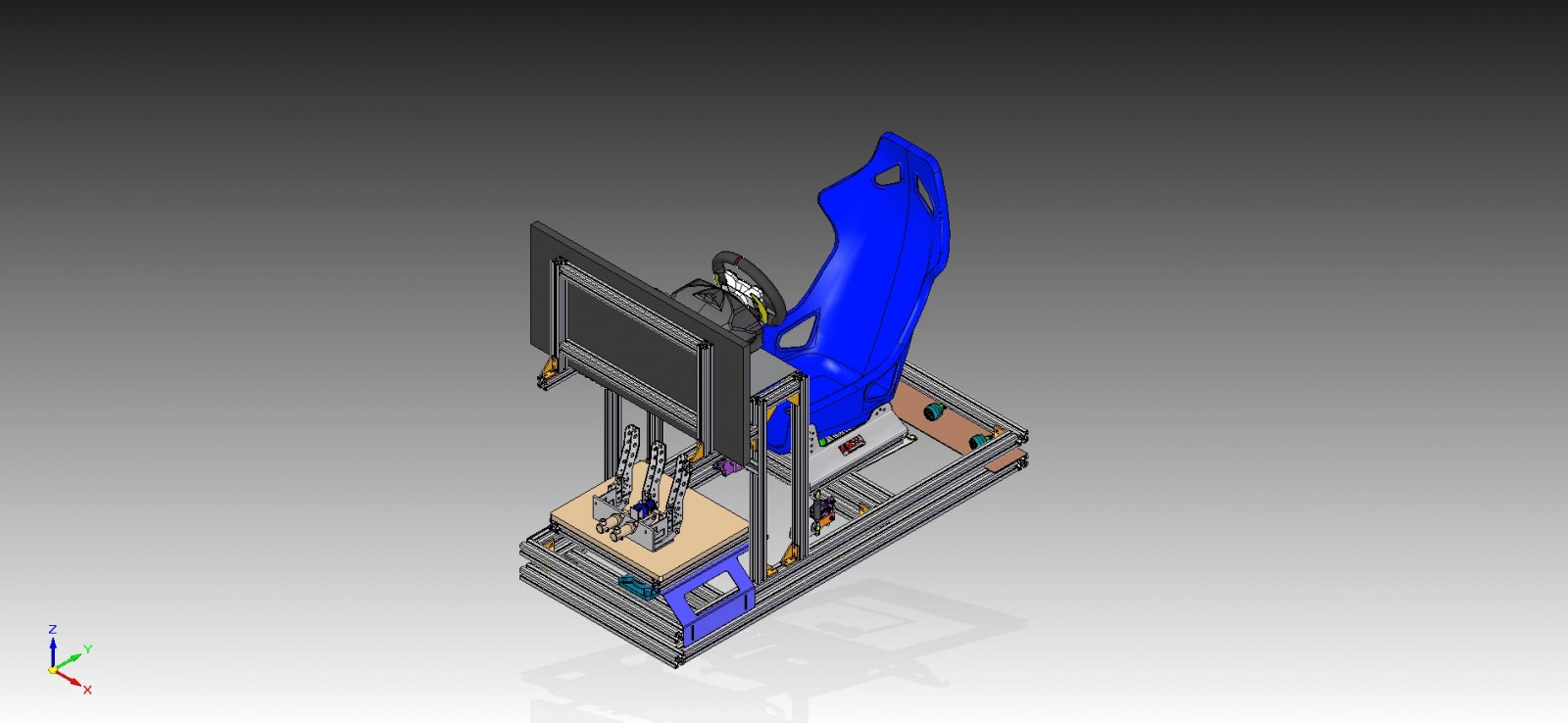

    I try to assembly my first simulator (3DOF)
    See the attachment about the project and the tests.
    I bought the racing seat and the wheel, while the aluminum profiles arrived in two weeks
    Best Regards
    Francesco Rosso

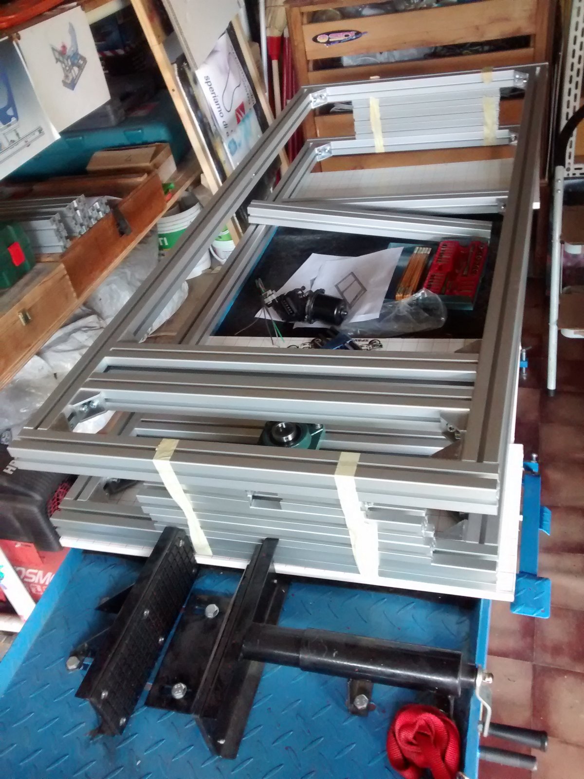

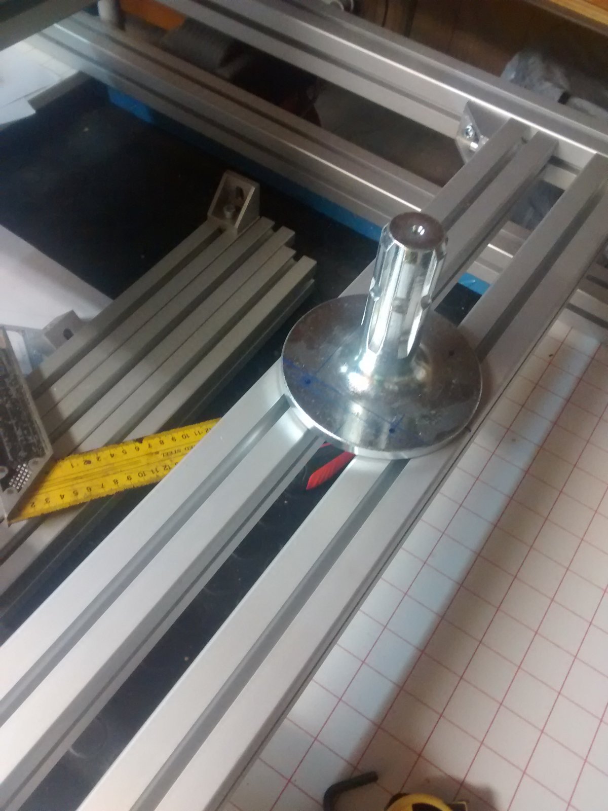

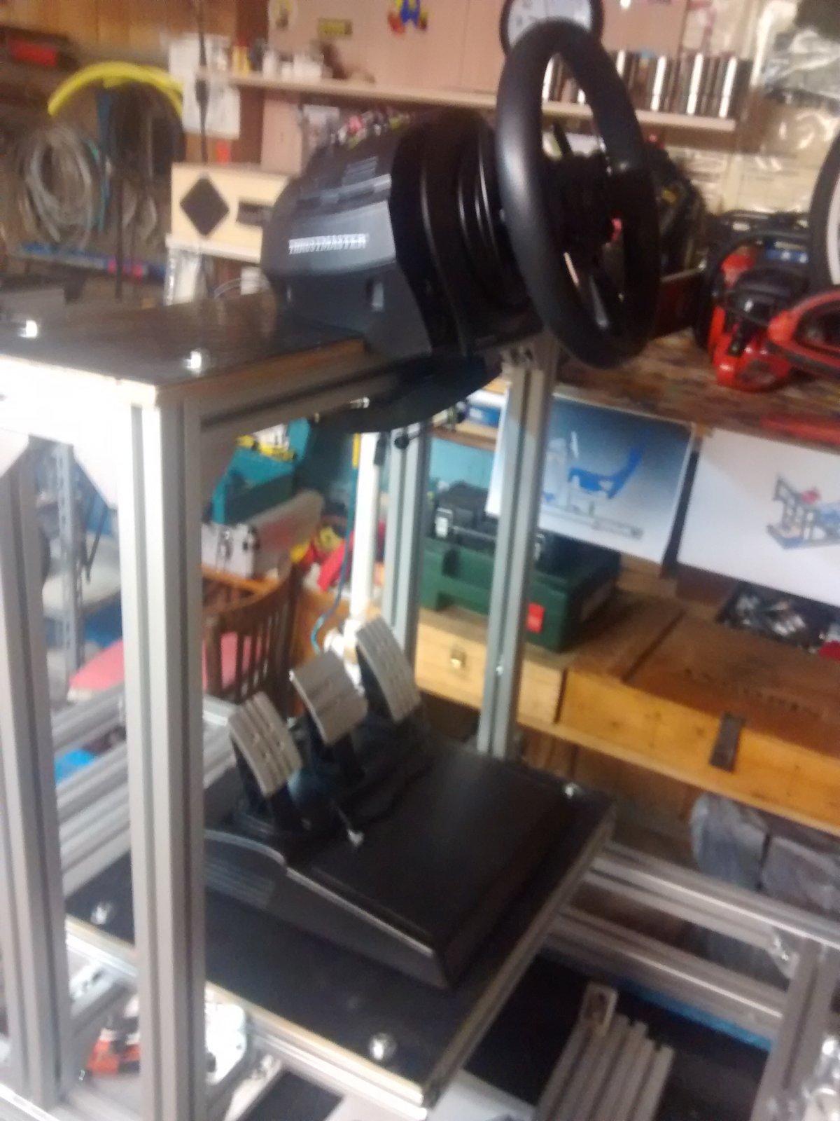

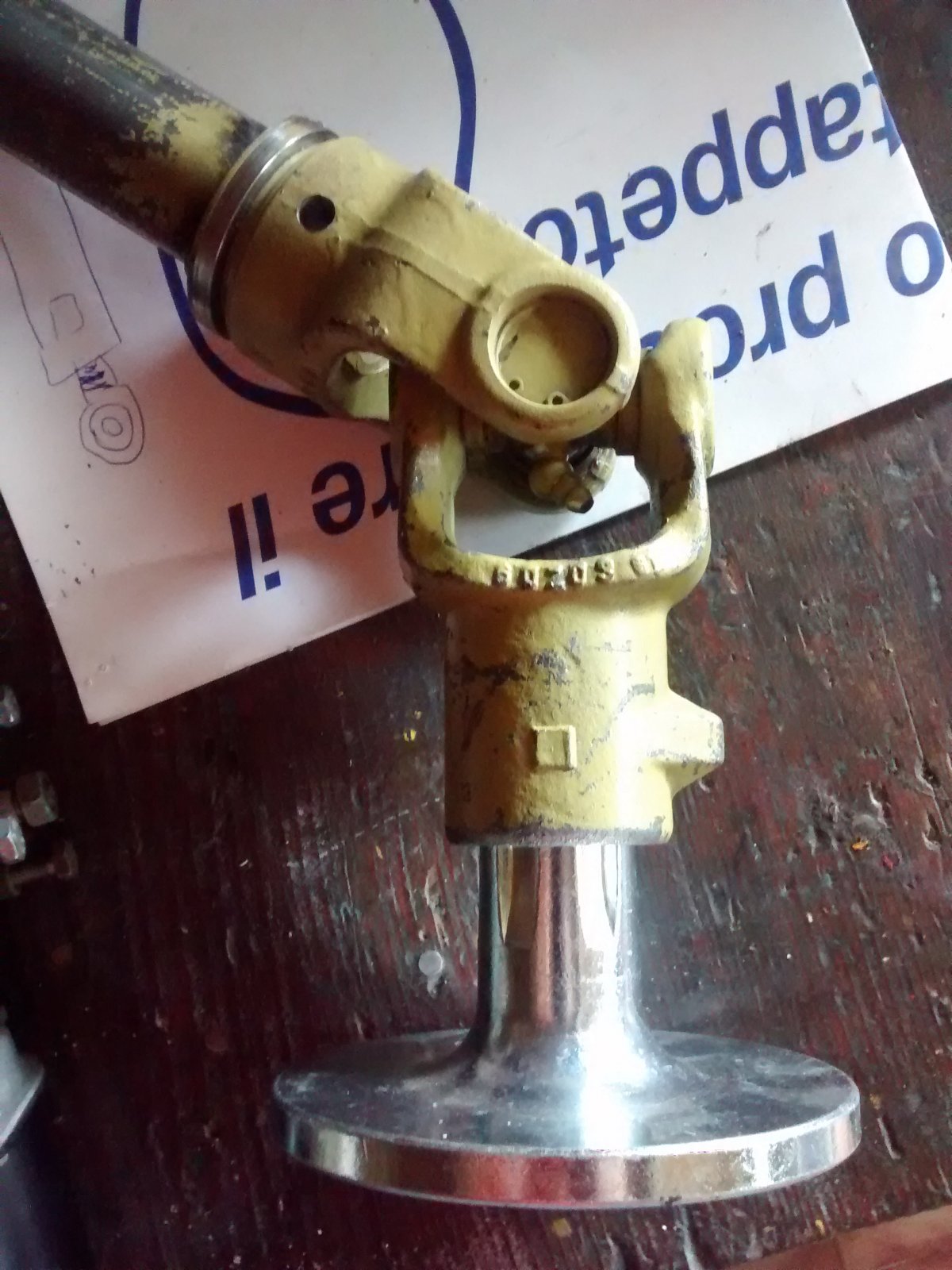

    My simulator assembly is going on.

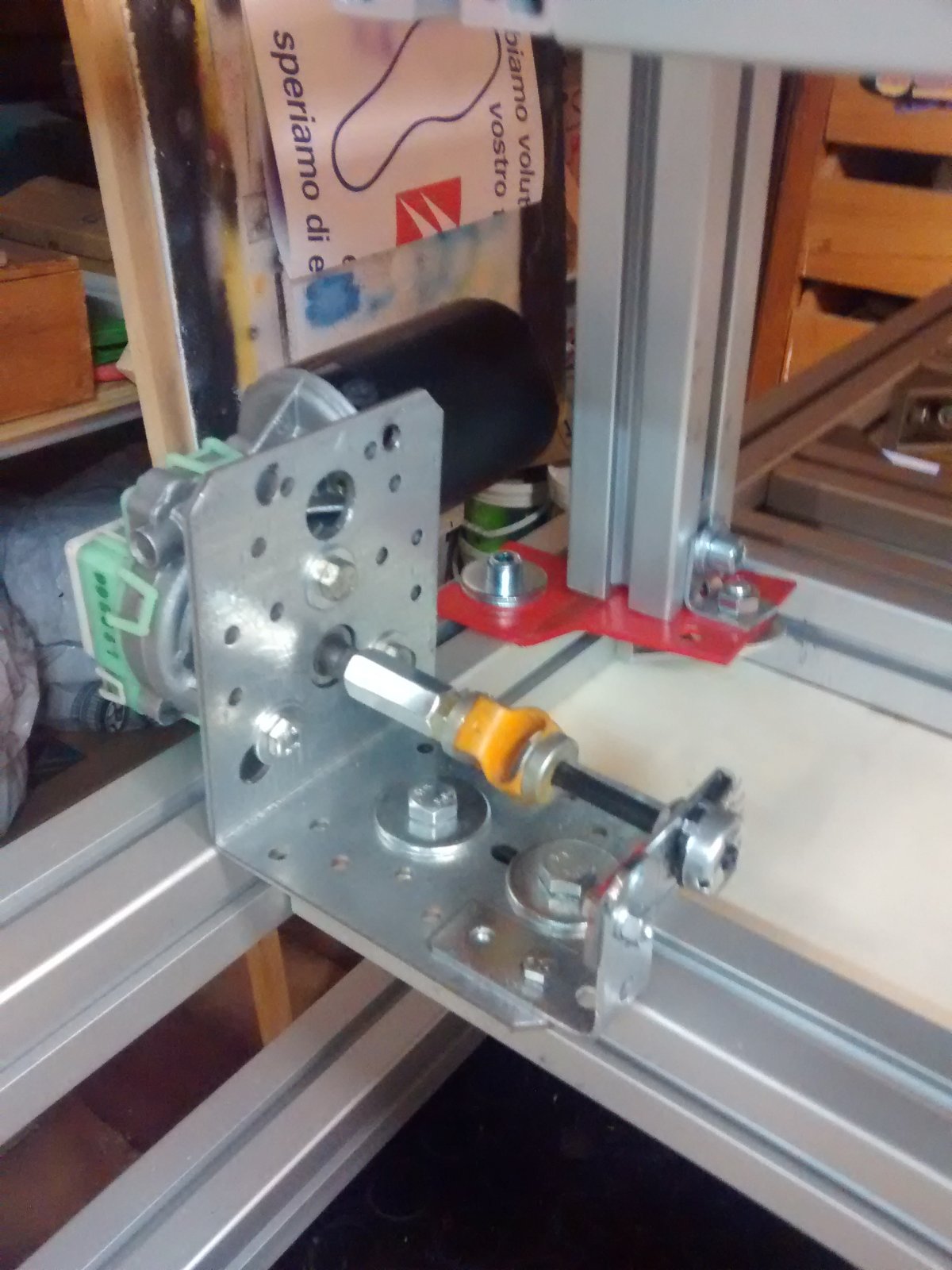

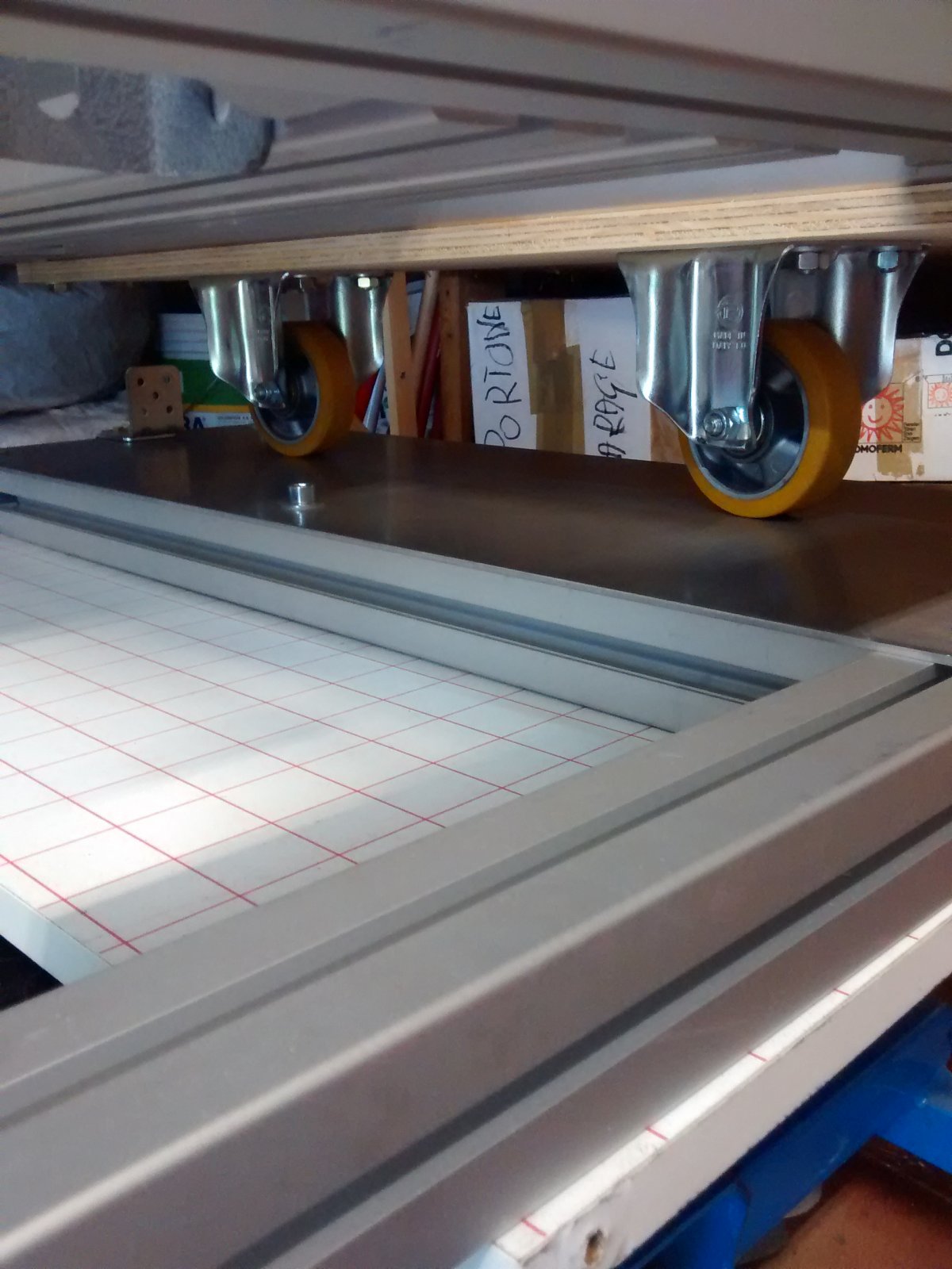

    I need make some modifications, about this I try to find some solutions.
    I the attachments I save some imagines.
    Best Regards

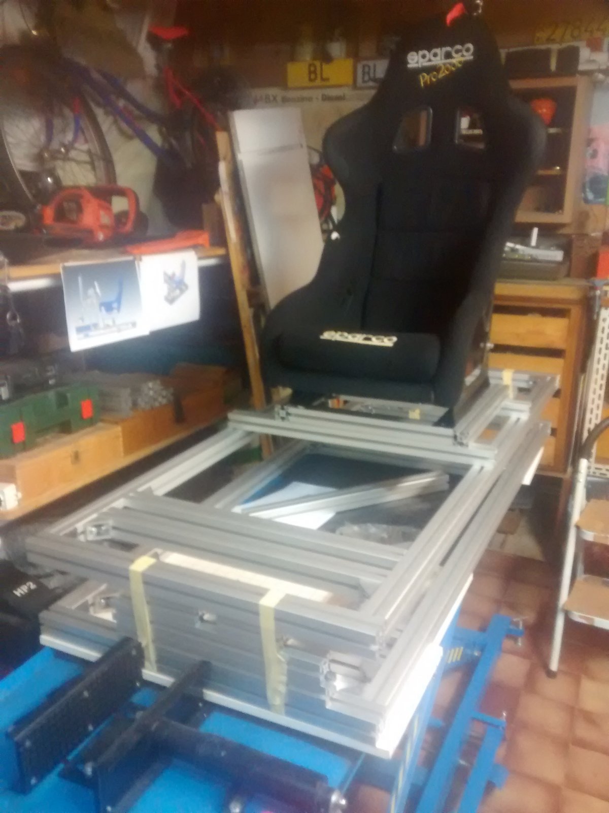

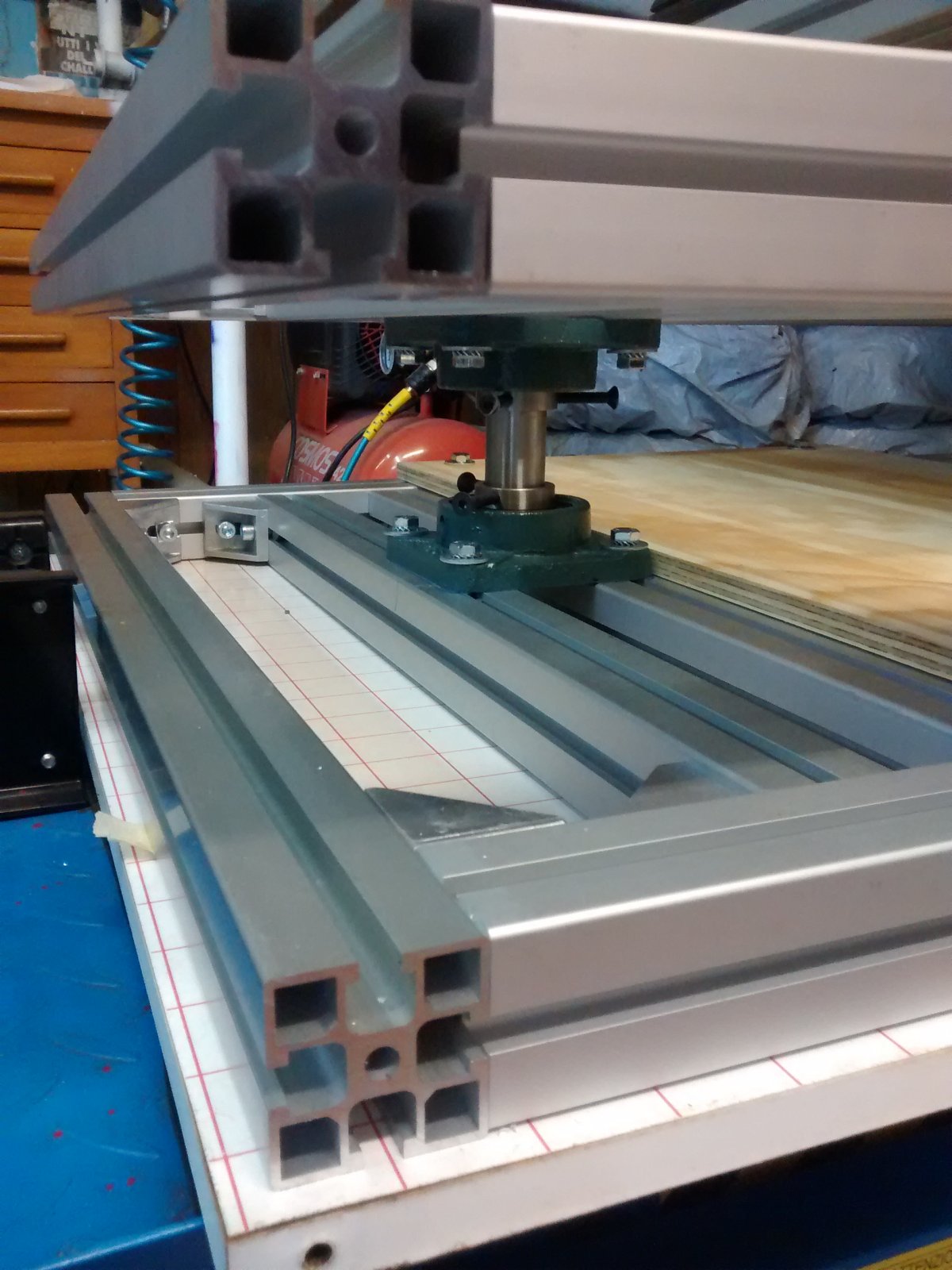

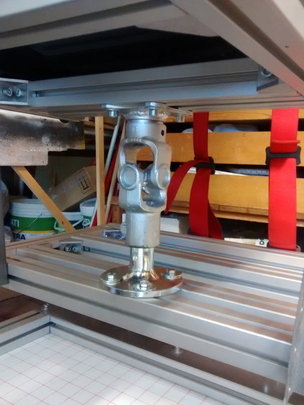

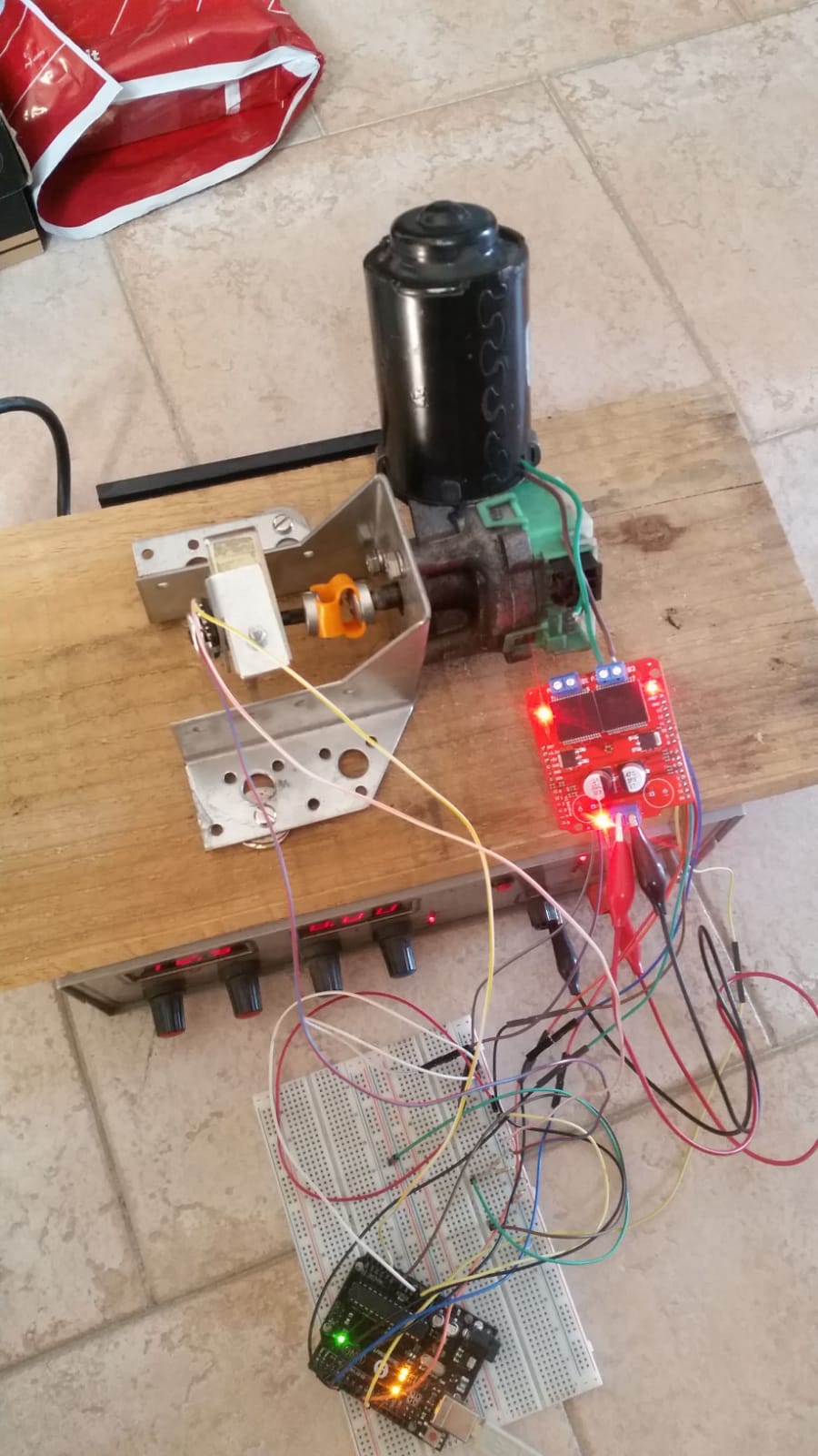

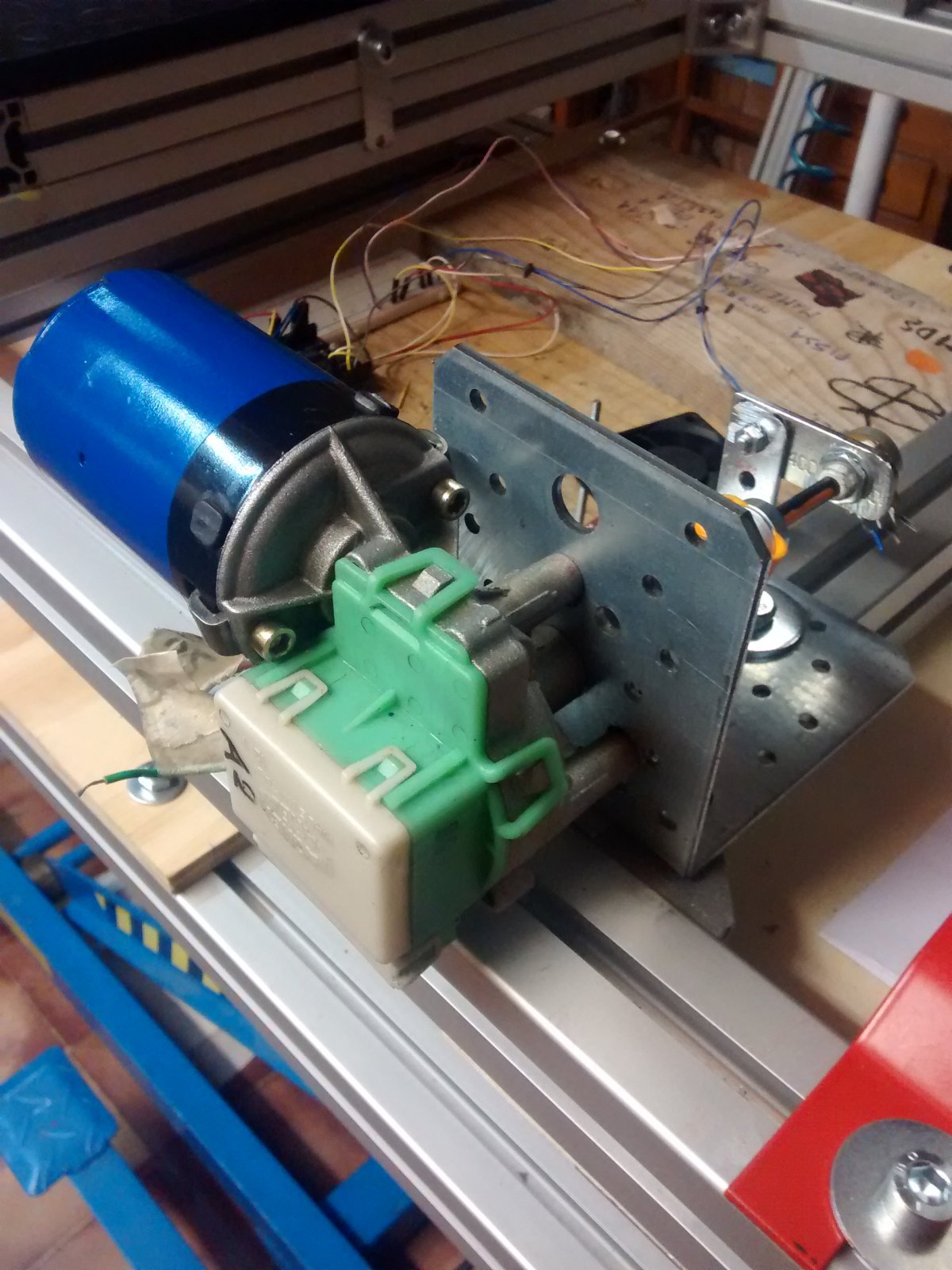

    Thanks for your suggests. I make a braket 35mm long, so the load on the motor shaft isn't too big.
    Furthermore I buy two wheel z=16 and z=30 to connect the motor and the potentiometer; I'm going to buy, certainly, a system cooling to a motormonster.
    I'll attach other imagines about the assembly.

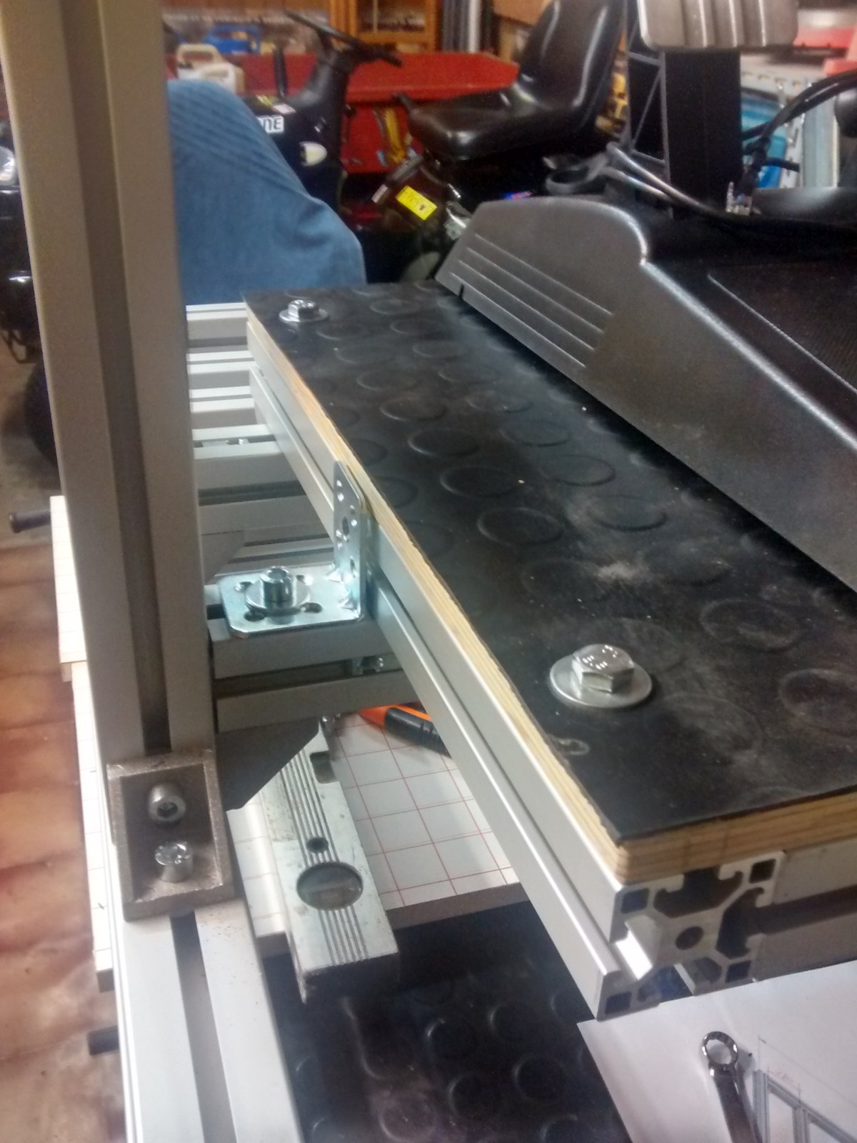

    Now I send some imagines about the assembly.
    Best Regards

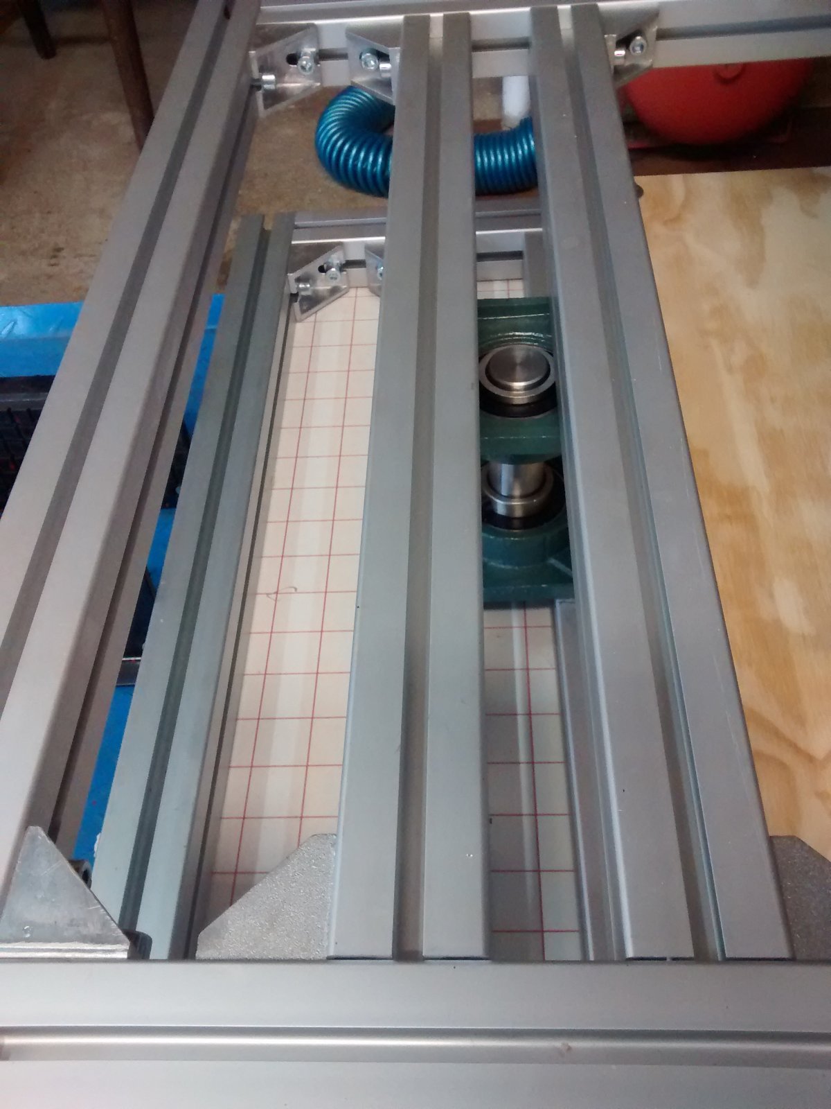

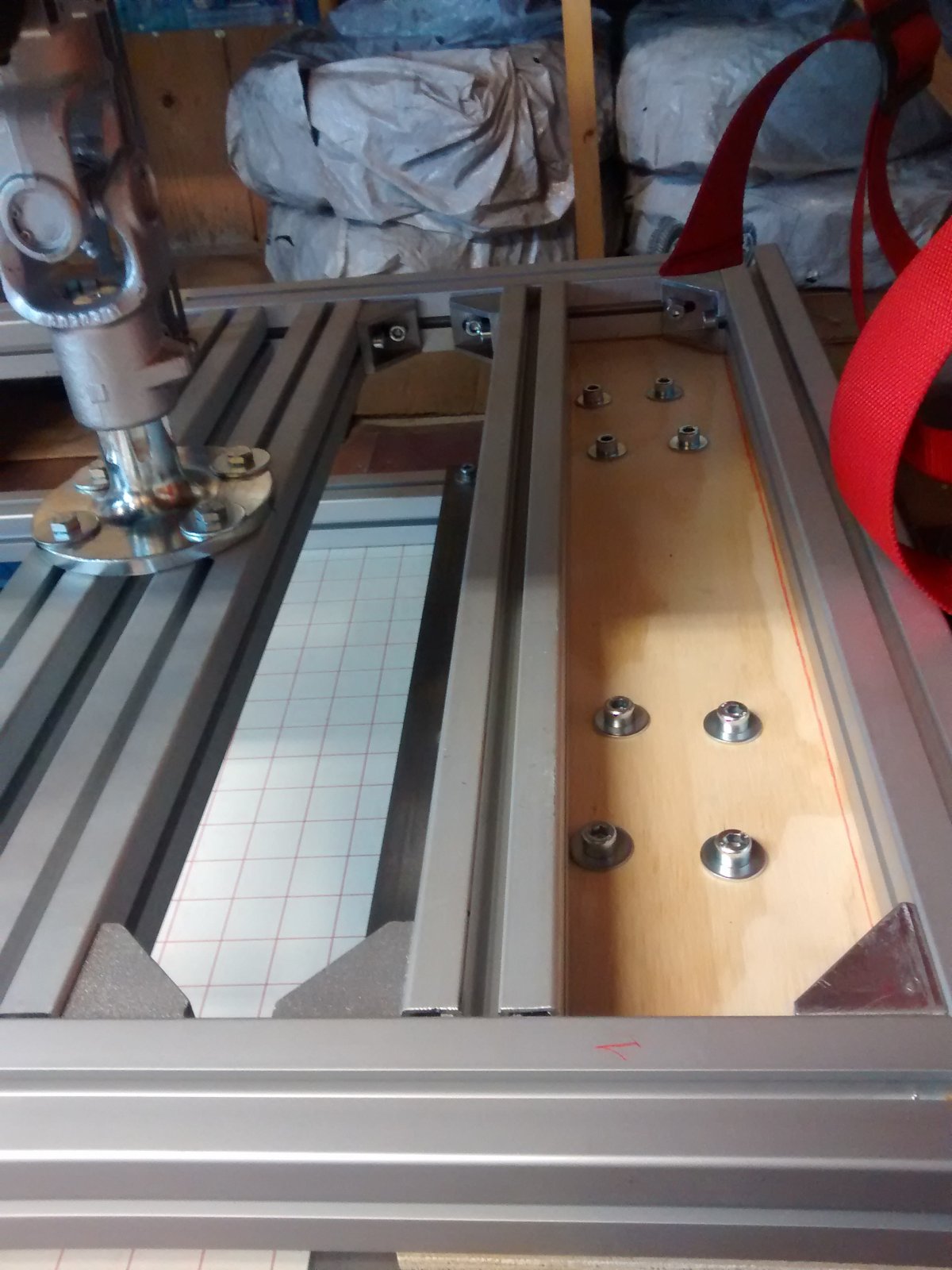

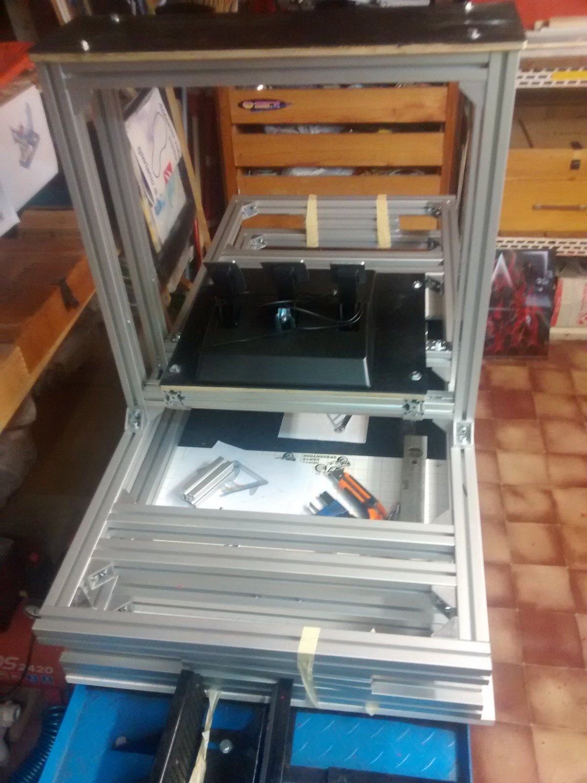

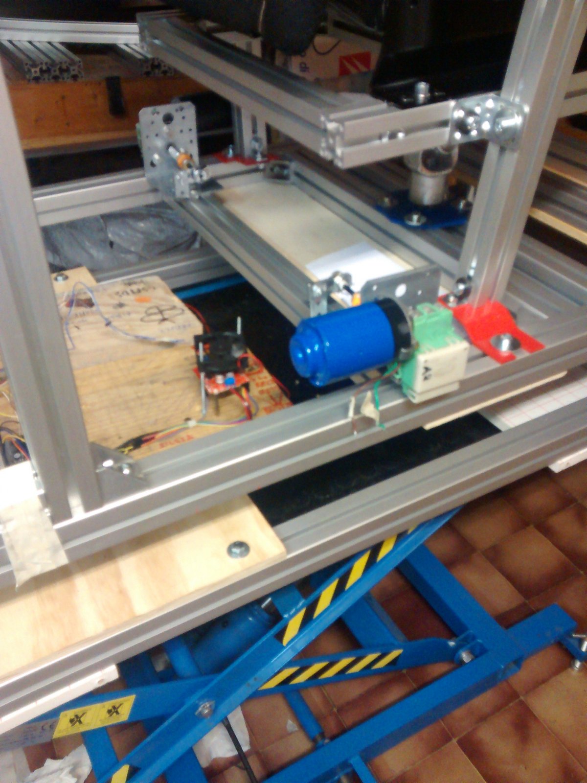

    Now, finally, I've finished the frame's assembly and I try to attach some imagines.
    I hope that the tests with n°2 motor will be ok, so I can install the one and I try to move the playseat.
    Best Regards

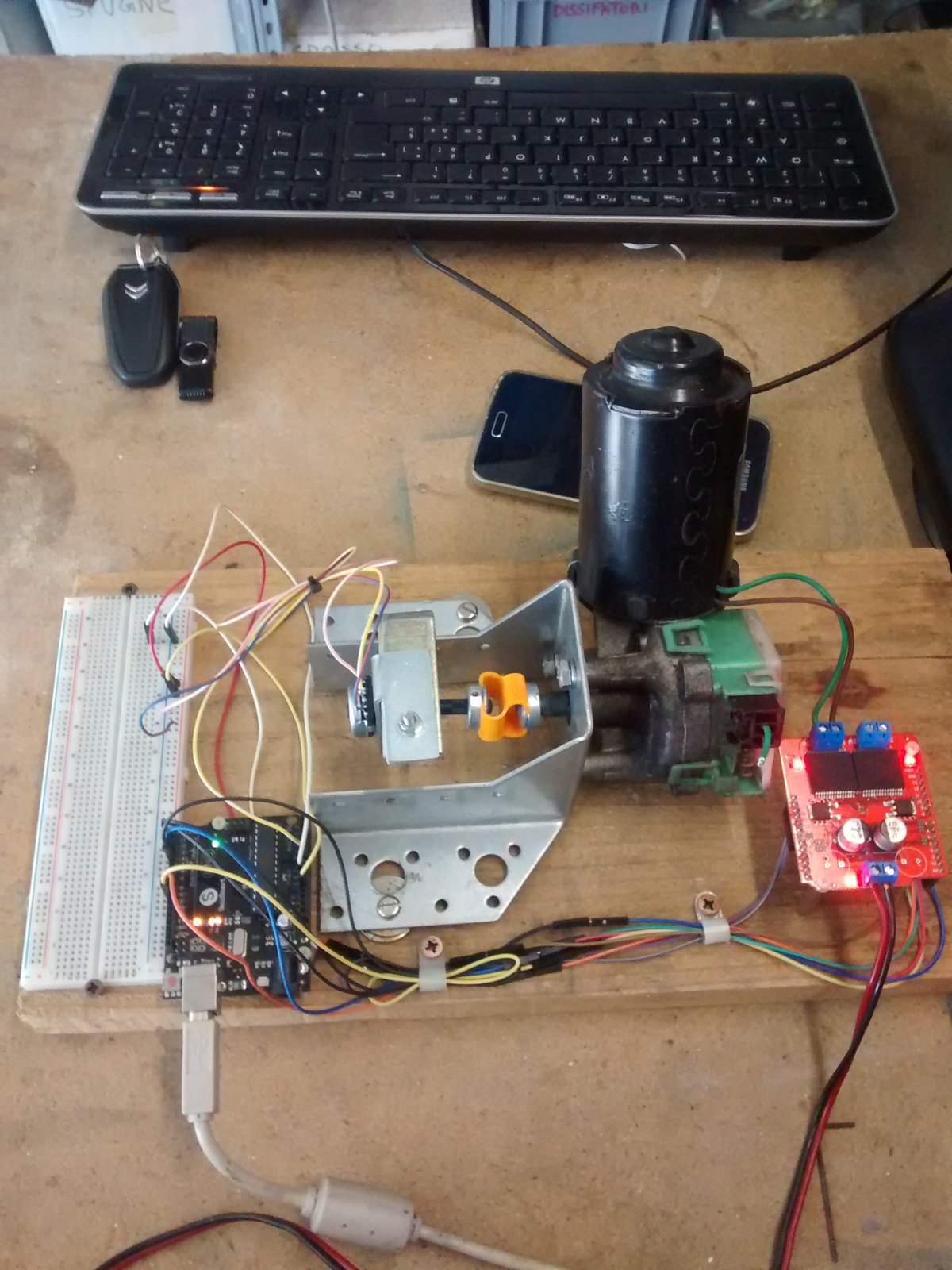

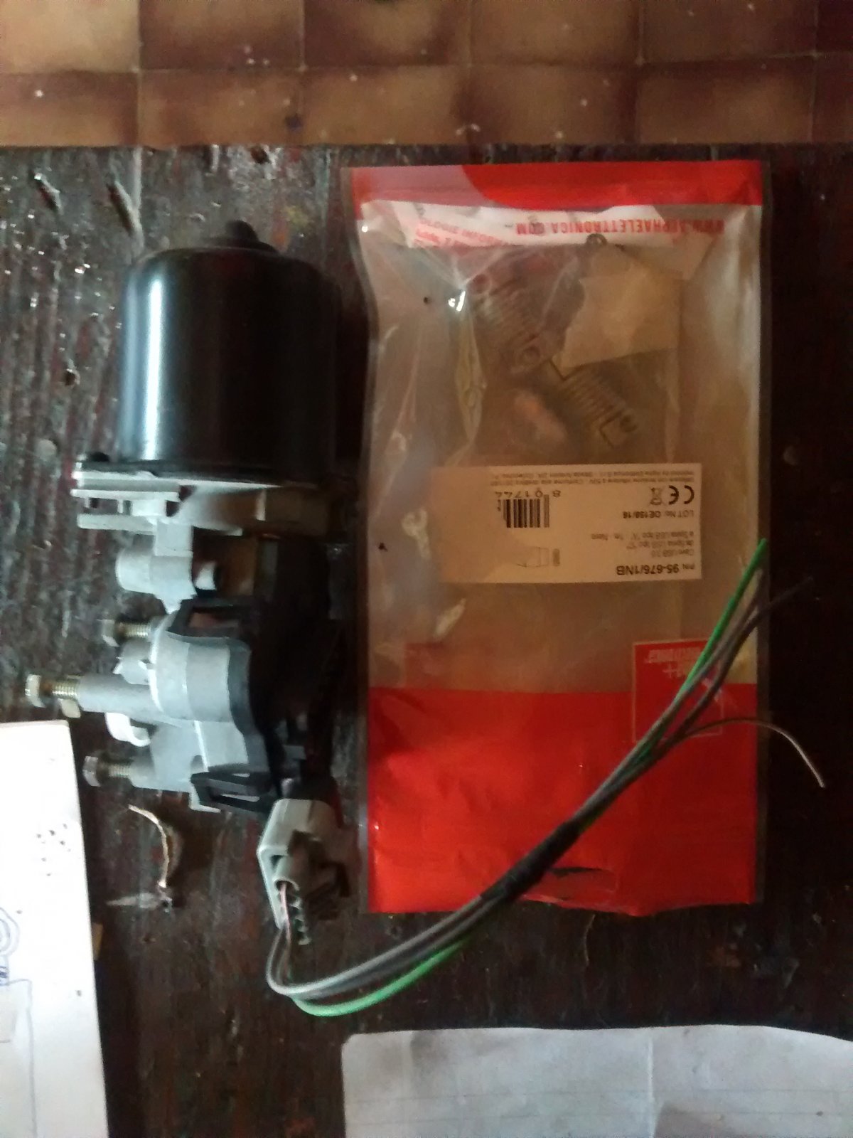

    Finally, by Spyderwash help and suggests, I can rotate the wiper motors and the tests have been positive.
    See the attachments.
    Now I try to install these on my playseat in the next days and then I hope it's ok to start the game; before with LFS and then with Projectcars2 by PS4.

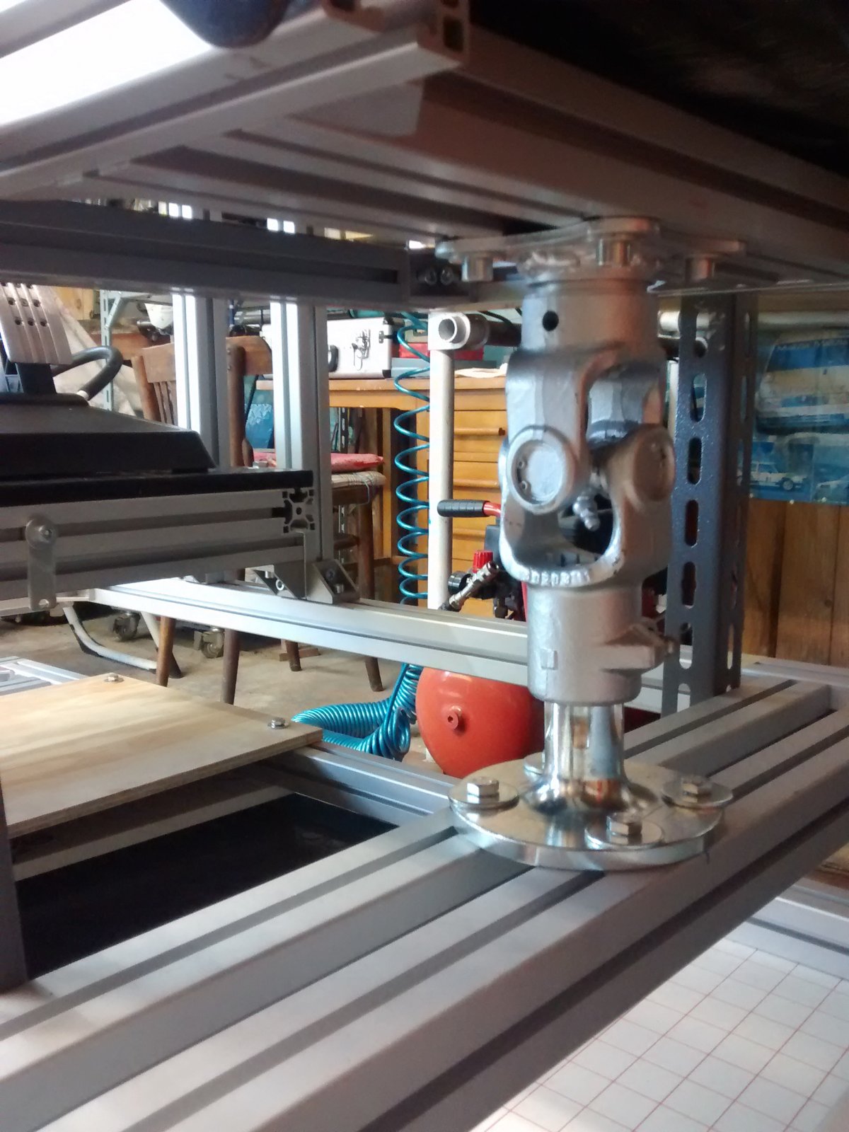

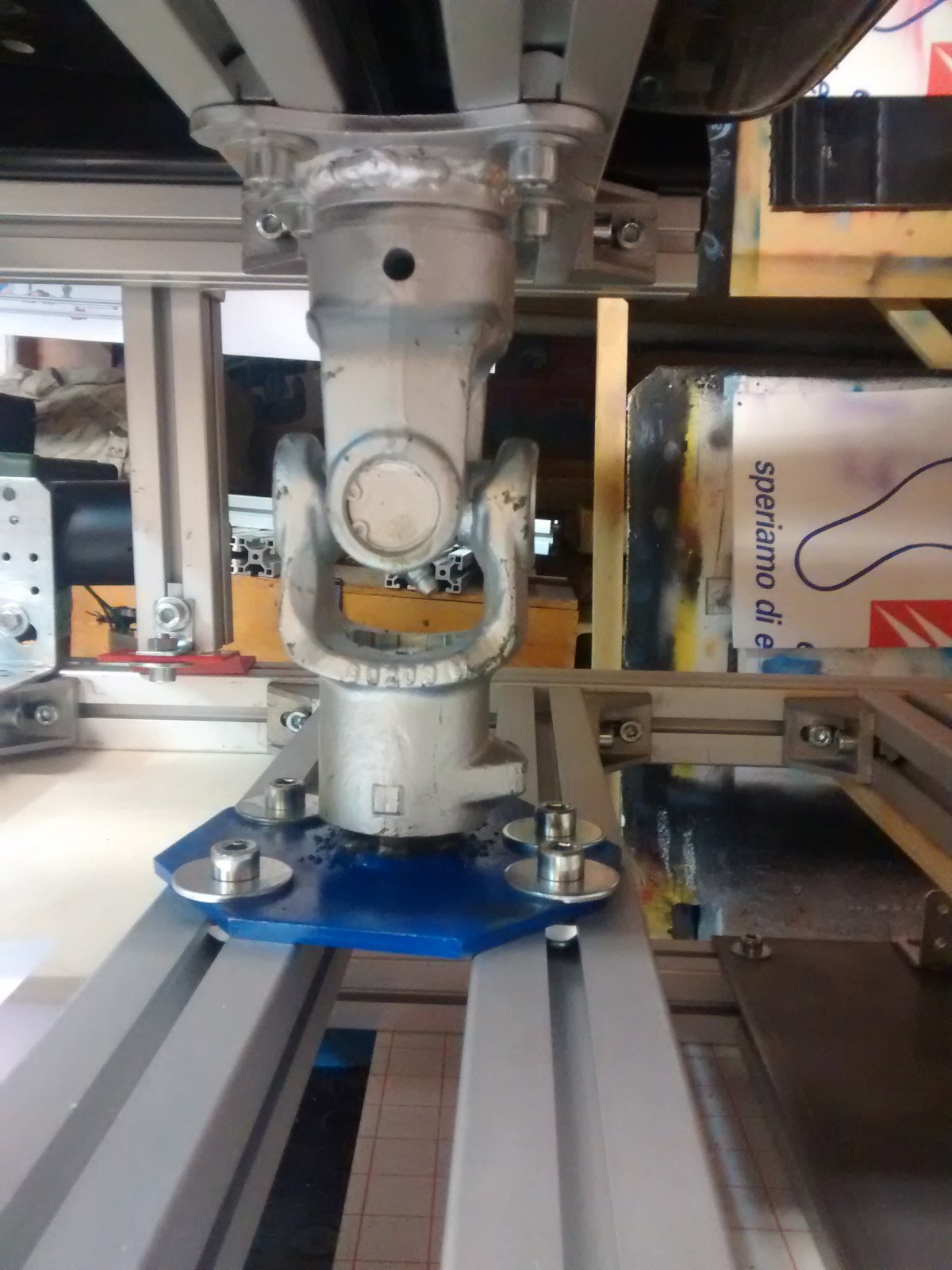

    In the time I learn to upload a video on youtube to be able to show the successes made inassembly of my playseat 3dof I've choosen its name: "REDXreme1" and one day I will explain the meaning. At this point I just have to attach some pictures showing progress made, Tuesday I lost the delivery of the power supply but today the courier makes a second delivery attempt. Now the levers to transmit the pitch and roll movement are about 100mm.

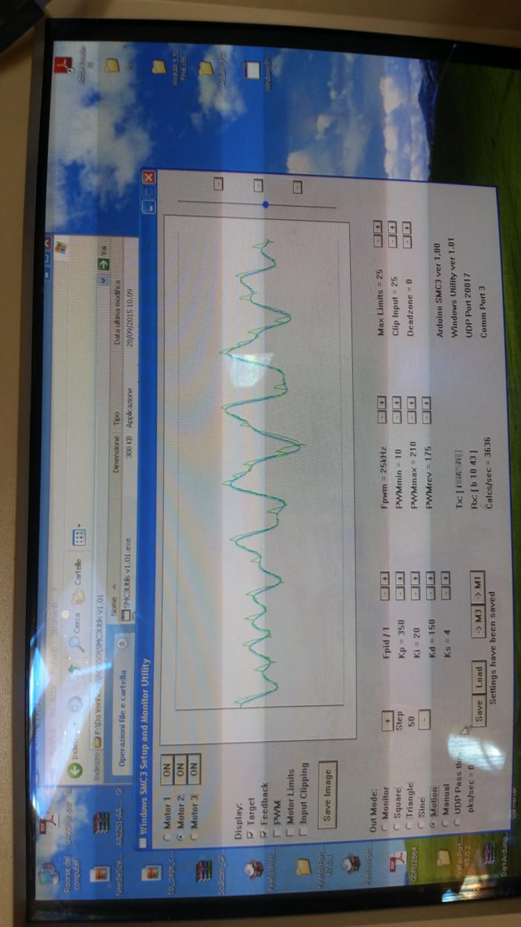

    By this post I try to link my video about the wiper motrors tests using SMC3 and then using LFS and SimTools.

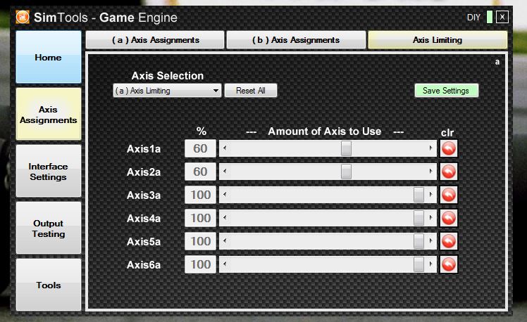

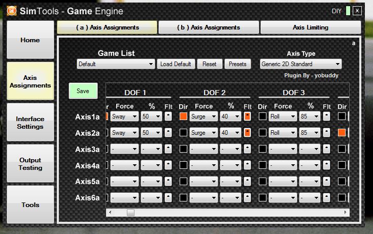

    Hello, Thanks for the directions described in the previous post. I hope to be able to show you in video at what point they are. Two days ago I moved the station, currently 2DOF as the first step, and it was a great satisfaction to see the mechanism move. But immediately afterwards I focused on the set up and already the first difficulties arose because, in my opinion, a detailed manual on how the SIMTOOLS program works is missing. See attachment image settings for LFS; the thing that surprised me is how little you look at the roll in the opposite movement of the levers; you will notice that I also acted on the filters, but only for what concerns the smoothing. Then, today I had the unhealthy idea of connecting the fixed PC, apart from the fact that Arduino uses the COM5 port instead of COM3, the motors do not operate. I thought it was the wrong string of the axes or the bits per second that in the control panel are at 9600, while in Simtools 500000; but nothing. I thought, then, to get around the problem by connecting two PCs: the fixed game and Game Manager, while the usual laptop with Game Engine and connected the COM3 port to control the engines; what do you think? Thank you

    Please have a look through the FAQ SimTools section: https://www.xsimulator.net/community/faq/simtools-settings-tips-and-tricks.18/category
    In particular the SimTool documentation: https://www.xsimulator.net/community/faq/rtfm-start-with-the-official-simtools-documentation.117/
    How SimTools expects axis to be be configured for movement direction: https://www.xsimulator.net/community/faq/which-way-to-set-simtool-axis-movements.230/
    How to refine a motion profile: https://www.xsimulator.net/community/faq/steps-to-create-a-motion-profile.228/
    And axis assignment percentage totals, so you don't risk clipping: https://www.xsimulator.net/community/faq/axis-assignment-percentage-totals.120/
    And dual PC setup, if that is the way you want to go: https://www.xsimulator.net/community/faq/dual-pc-simtools-setup.251/
    I would suggest you leave filters until after you have a well sorted base profile.
