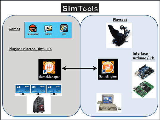

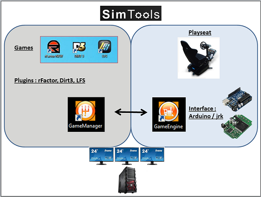

Rather than running the game on one PC and SimTools on the other,
we have split SimTools into GameManager on the GamePC and GameEngine on the other PC controlling the actuators.
Read more here:
http://www.xsimulator.net/community/threads/how-to-set-up-a-dual-pc-installation-of-simtools.4974/
Nota: you have to install plugins on both computers! ;)
Here a single computer setup:
Here a dual computer setup:

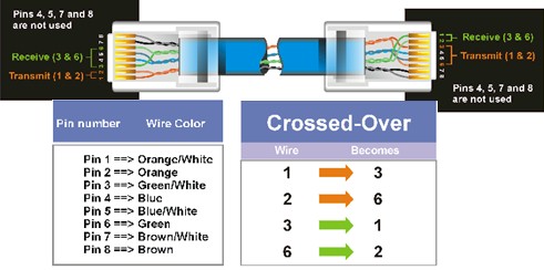

ONLY a cross-over cable
And remember the tcp/ip configuration, for best performance (and in old computer for best startup) to config 2 pc's in static IP non in DHCP!
