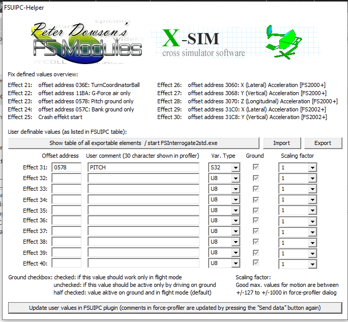

    Hi, could I ask you for help?
    I use X-Sim for my 3DOF and want to make it work with Flight Simulator X, but I have problems.
    Basically I use FSUIPC and FSUIPC-Helper (X-sim plugin). I have eliminated all the standard values and I have inserted only the pitch (see image). X-Sim receives the data but the motors rotate in "jerks" (like the hand of a clock).
    How can I solve the problem?

    I have already asked for help in the X-Sim forum, but no one has replied, in that forum they are all passionate about motoring and do not know how to give answers on flight simulators.
    Is there anyone here who could help me please?
    22,126
    154,382Coins
    +11,179 / 57 / -2
    Most here will either be using SimTools or FlyPT as their control software, but perhaps someone has X-Sim experience. If not you could try SimTools or FlyPT, as you will find plenty of help here for both.
