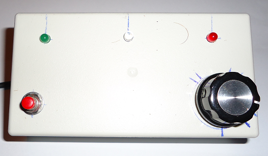

    Using a Ardunio and some leds and a pot, we can create a setable shift light.
    Thanks @bsft Sorry video no real good, need to do a new one for V2.

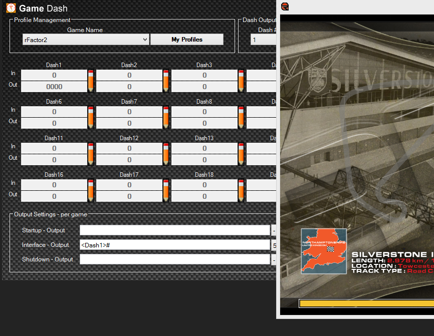

    I love this tool. Super nice and "simple". I got it to work the first time I tried it on my computer at work and in a matter of minutes I had Speed showing up on a tiny 7-segment display hooked to an Arduino.
    But now I can't get it to work at all here at home. Just to make sure I had a clean install I removed everything: rFactor, SimTools and GameDash. Then I installed everything again and went through the configuration as I had done at work - but there is still a problem. I actually don't think the problem is with Game Dash - but rather with the rFactor2 plugin.
    Here is a snapshot of my screen where Game Dash is running as well as rFactor. You can see that all the game dash fields are still just showing Dash1, Dash2, Dash3 and so on - instead of Speed, RPM .....
    I do notice that when I run the game there is no "icon" top left for the plugin. Isn't that the reason? It is as if the plugin is not working at all - and therefor not sending anything Game Dash.
    What could I try to get this to work again? I have disable UAC and double check every setting. I installed the rFactor2 plugin with the SimTools plugin updater.
  19. eaorobbie
    20,471Coins
    +1,686 / 23 / -2
    Not sure need to reload rfactor2 in order to check. May on plugin update the dashdata was not included.
