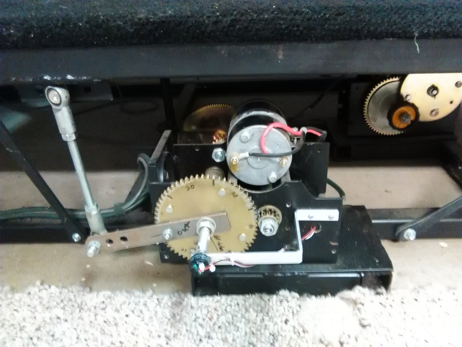

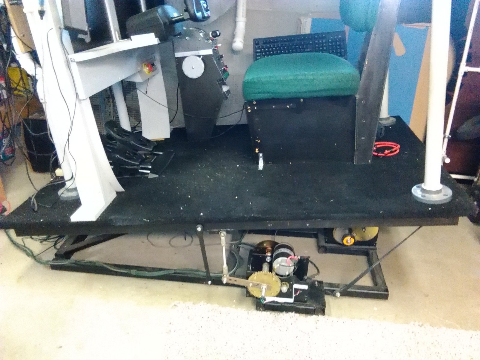

    Hello all, been a while since I have been on this forum but since the covid thing going on i am thinking about "up grading" my Flight Simulator Motion Platform from winch motors to worm gears and motors and going from "TWO" ( pitch and roll) to three. I am not sure what configuration I would need to do this. The platform I have now is 4 ft x 6 ft and it carries (5) monitors and (1) person I weigh about 225lbs. and the two winch system works well but is very noisy and somewhat jerk-able at cretin times. The downloads show what I have and what I would like to do is at this site.

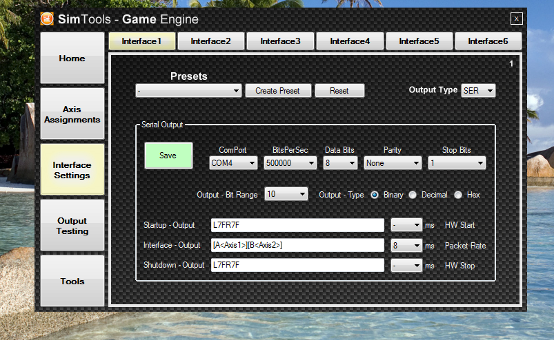

    Would the Interface-Output just need to have [C<Axis3>] added in to make 3 motor axis for this setup?
  20. noorbeast
    21,597
    151,245Coins
    Yes, but it should be like this: [A<Axis1a>][B<Axis2a>][C<Axis3a>]
