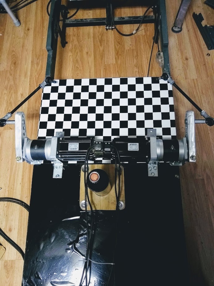

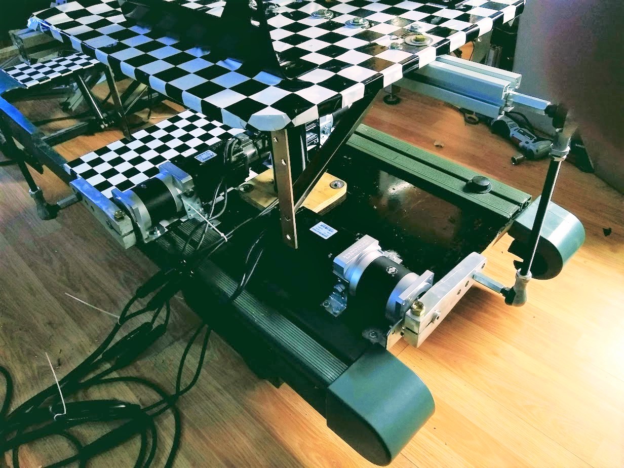

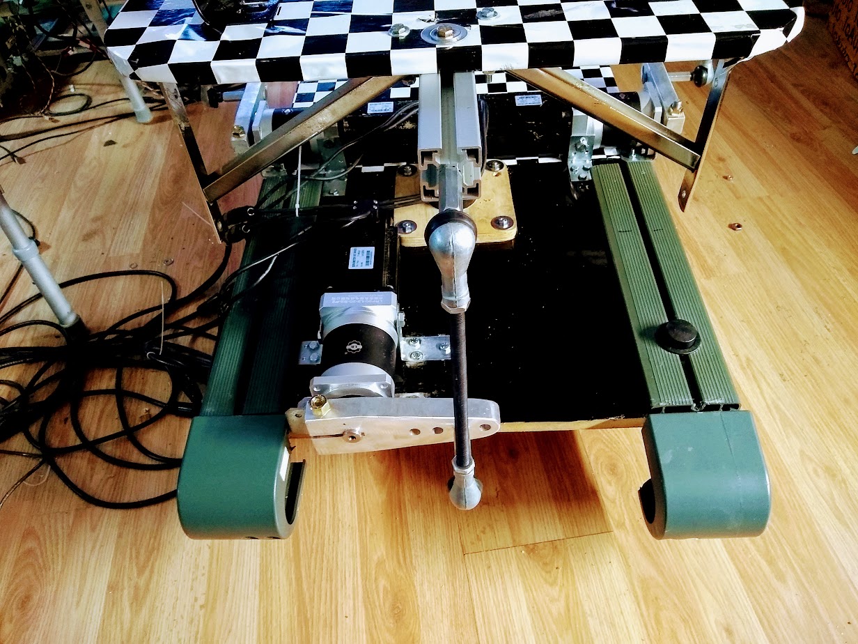

    Spent most of the day installing the 3rd motor.
    I still have the seat to install and the cockpit.
    Wiring is all done and I spent a few hours making sure nothing would crash.
    The video is not much to speak of.
    The camera is sitting in the last car on the train.
    The background TV has a known 200ms lag.

    The model number of the motor is 90st-m04025
    The control box is RS485, 4NM 1000W Servo Motor Drive
    And the planetary is a LRF90(16-80-m6-100)-20, Ratio 20:1 Speed Reducer

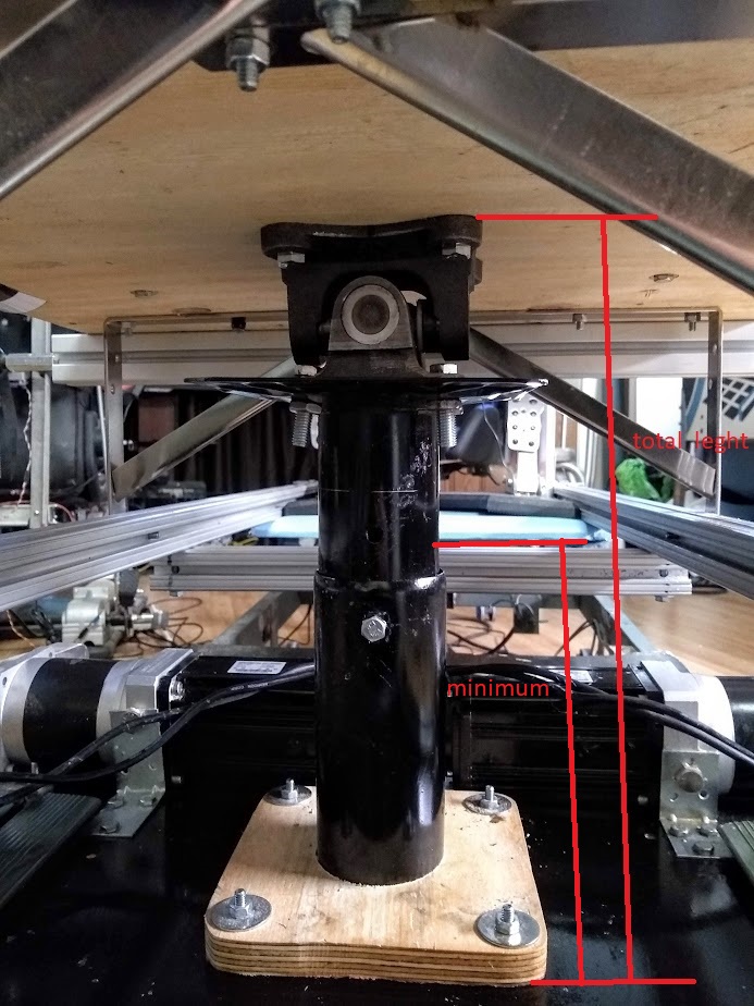

    hello how much it moves minimum and max traveling ? total length is .thanks

    The total heave (vertical movement) is set to 100mm. That leaves about 40mm of splined shaft left for a safety factor.

    and total length is? thanks

    Ok I understand now...
    the maximum vertical distance is 520 mm (fully extended )
    minimum distance is 365mm (fully collapsed)
