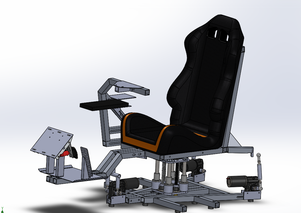

    Hello again everyone,

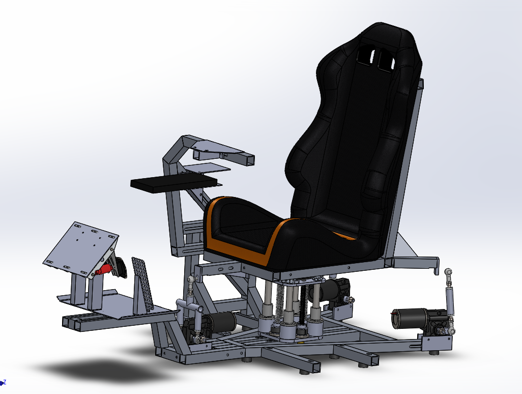

    Those of you who may have been following my old thread probably noticed some early sketches of a 3DOF simulator I'd been toying with. Well, here it is. Rather than posting updates slowly, this time I decided to wait until I had a working rig before posting my thread. I'll be posting the build process after this for those who are interested. I've been working on this for about 6 months or so, but I've still got a long way to go before I'm happy with it.
    My old rig was a learning experience, but I really wasn't happy with how it turned out. It was too heavy, too big, and it would tip over if I didn't put weights on the back. The build quality was also about what you'd expect from someone's first real fabrication project.
    With that in mind, I started drawing up plans for a new simulator. I wanted an extra DOF, but I wanted to keep the overall footprint of the sim a bit more compact, so I opted to add heave instead of traction loss (for now). Since I already had two PGSAW 25:1 gearmotors, I wanted to see if I could make a heave design work with the faster gearboxes (I don't think I've seen another build of this style that doesn't use the high ratio gearmotors). I also wanted the option of being able to switch between seat-mover and full-frame configurations for different simulations.
    The final design ended up coming to this:
    The wheel and pedal frames are detachable, making switching between the configurations as simple as undoing a couple of bolts.
    Since I was using the smaller motors, I came up with an adjustable spring assist module that would help take some of the static load off of the motors when they're at rest:
    I think I ended up underestimating how much torque the 25:1 boxes output. I'm using 1.2in levers for now, and it'll throw me up and down without breaking a sweat. Overall I'm pretty pleased! But there's still a long way to go.

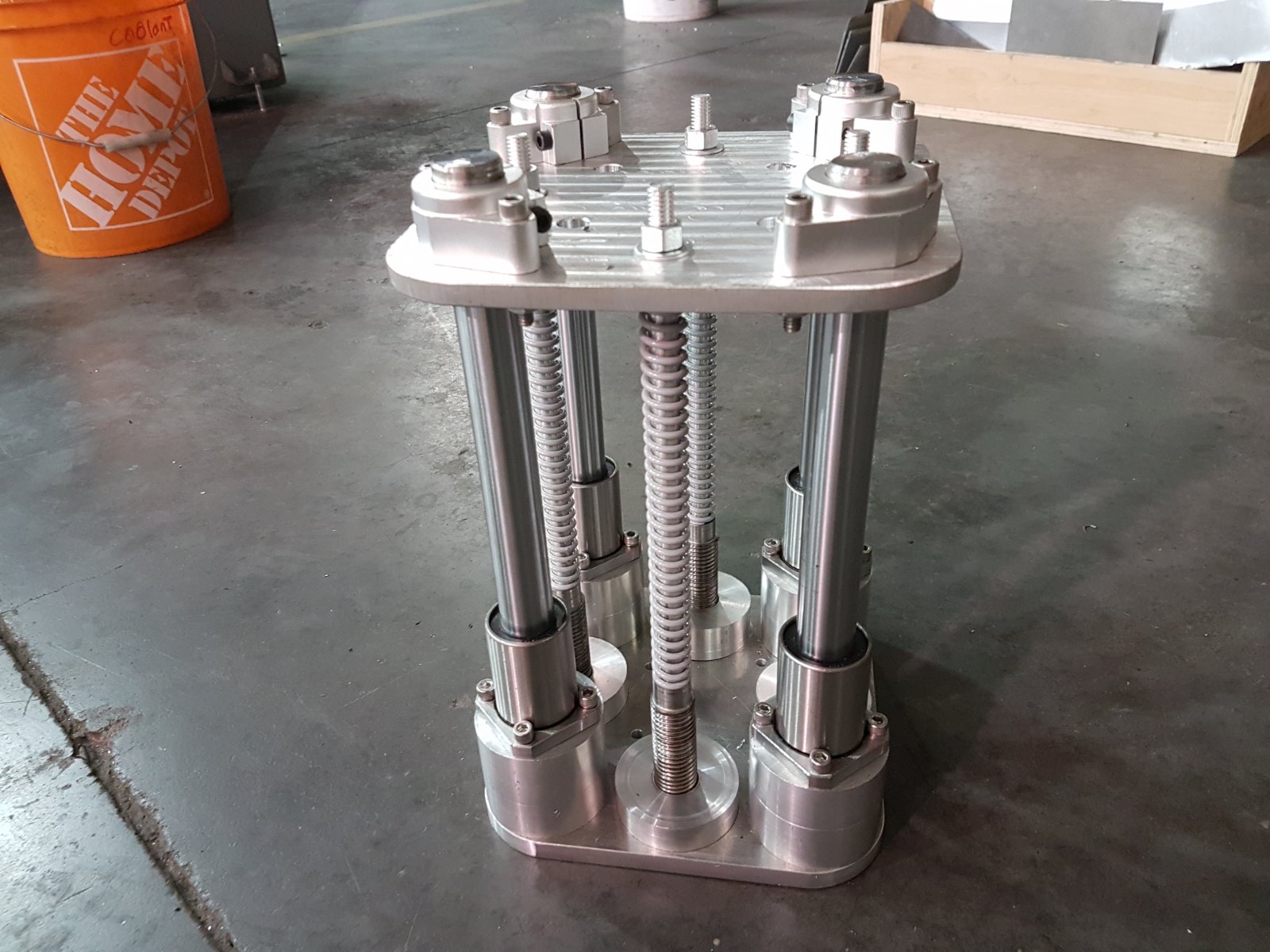

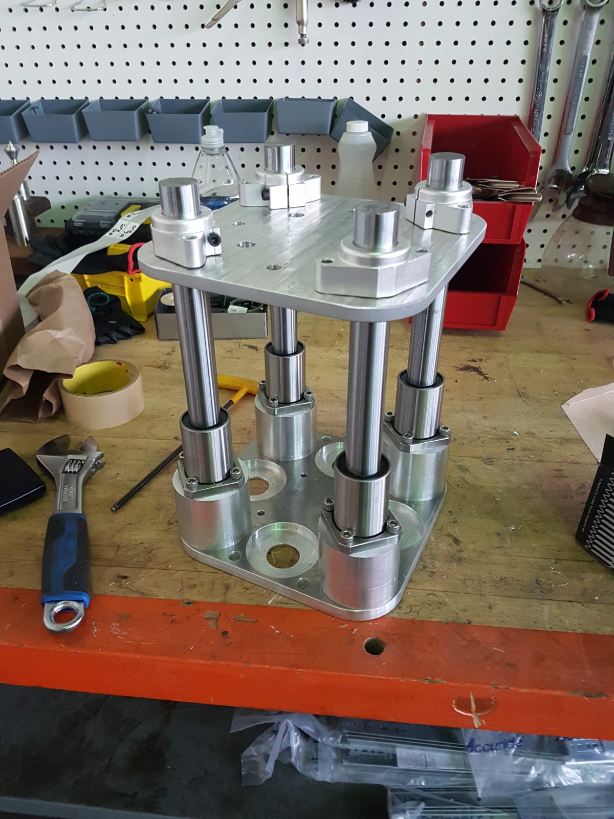

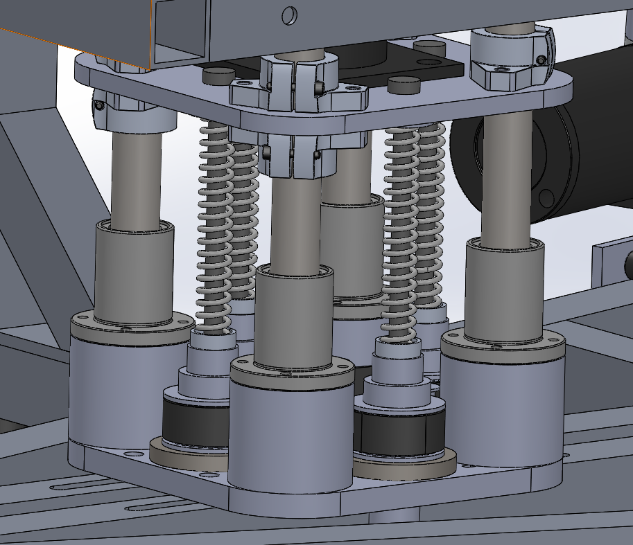

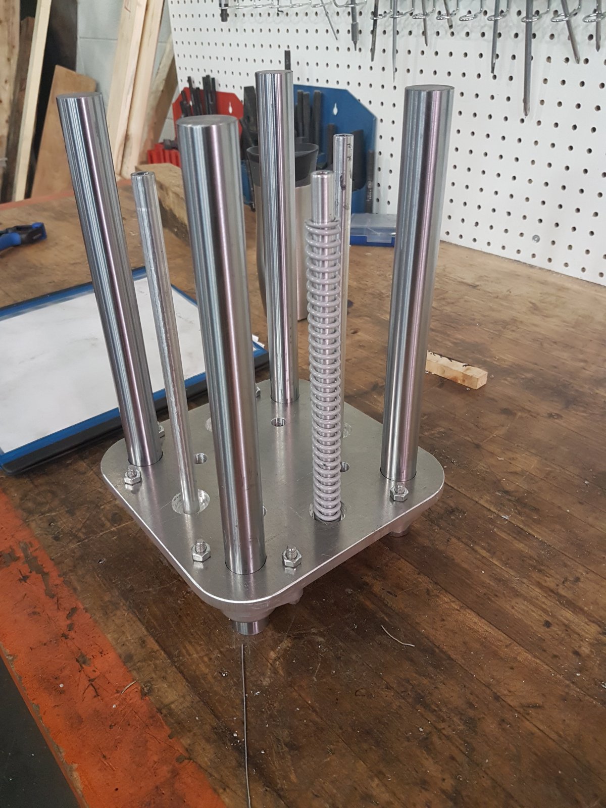

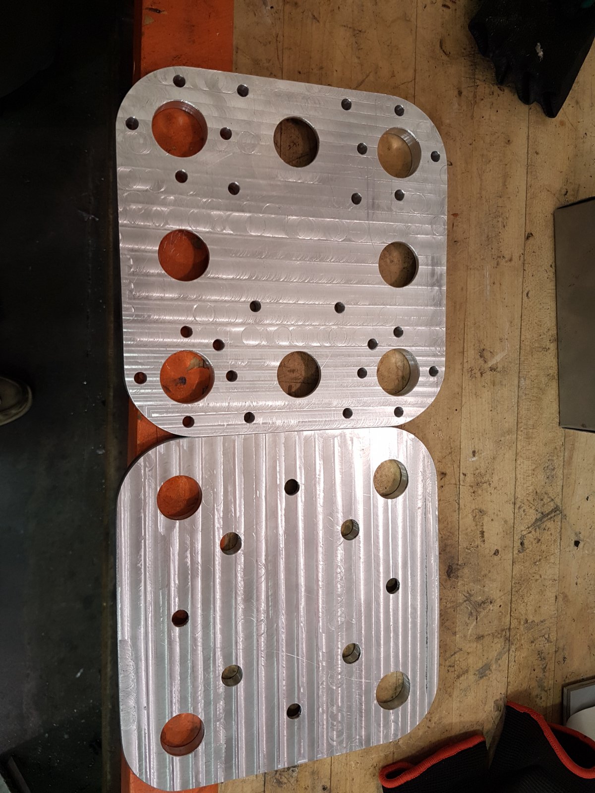

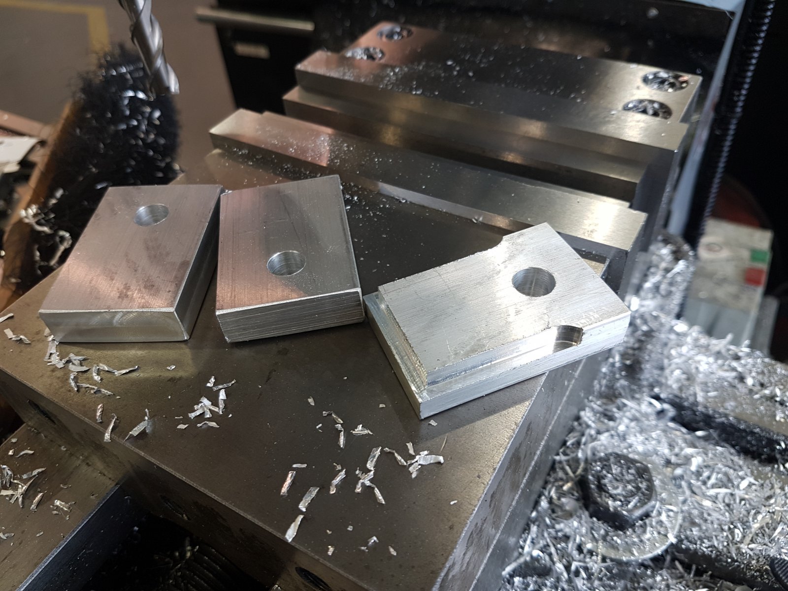

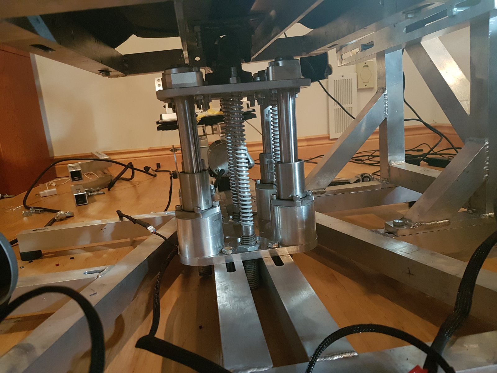

    I guess that's as good a place to start as any! Here's a pic of the finished product under the rig:

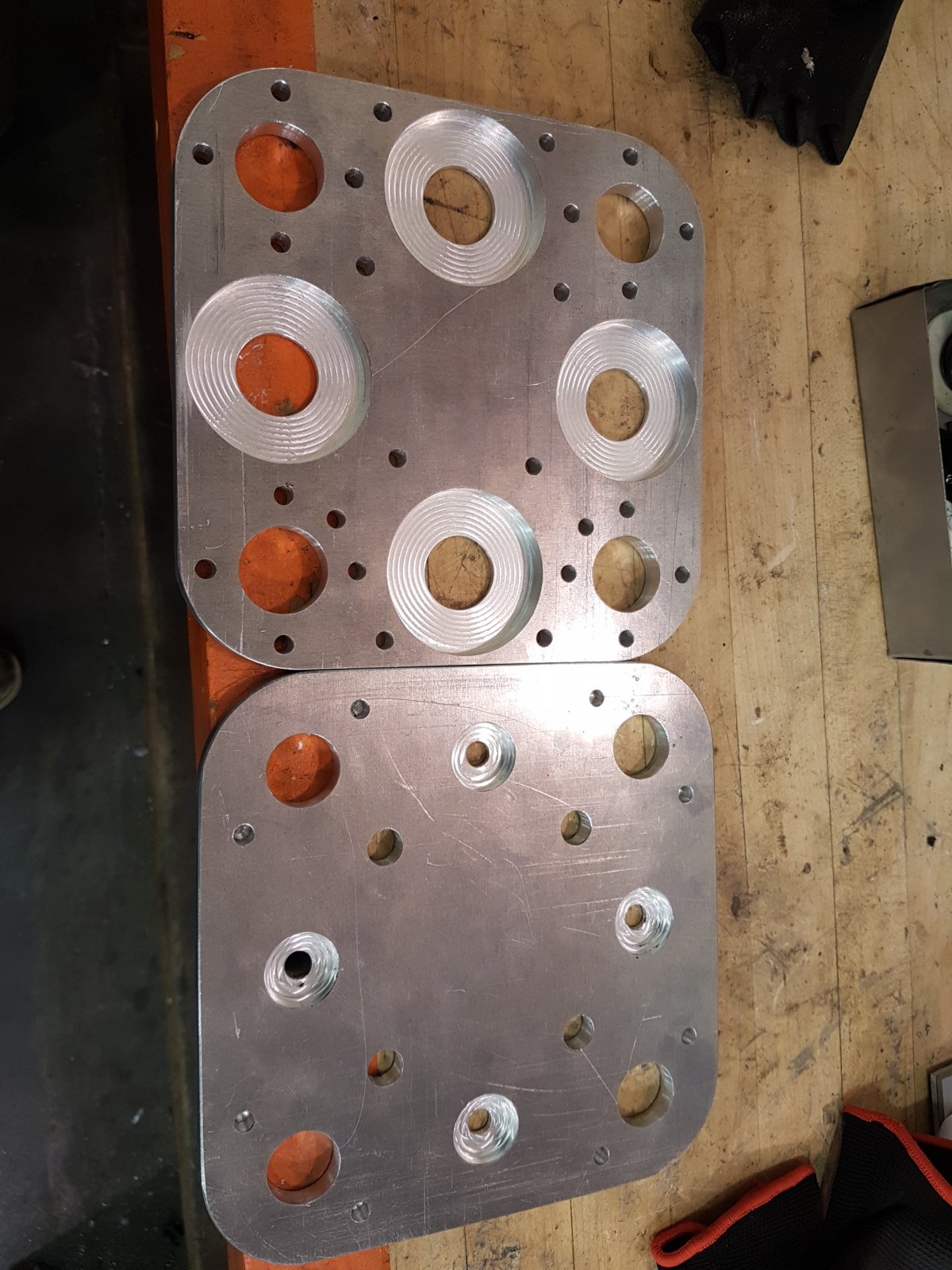

    The pretension on the springs can be adjusted by turning the large nuts on the baseplate. The whole platform slides up and down on the 4 linear rails on the corners.

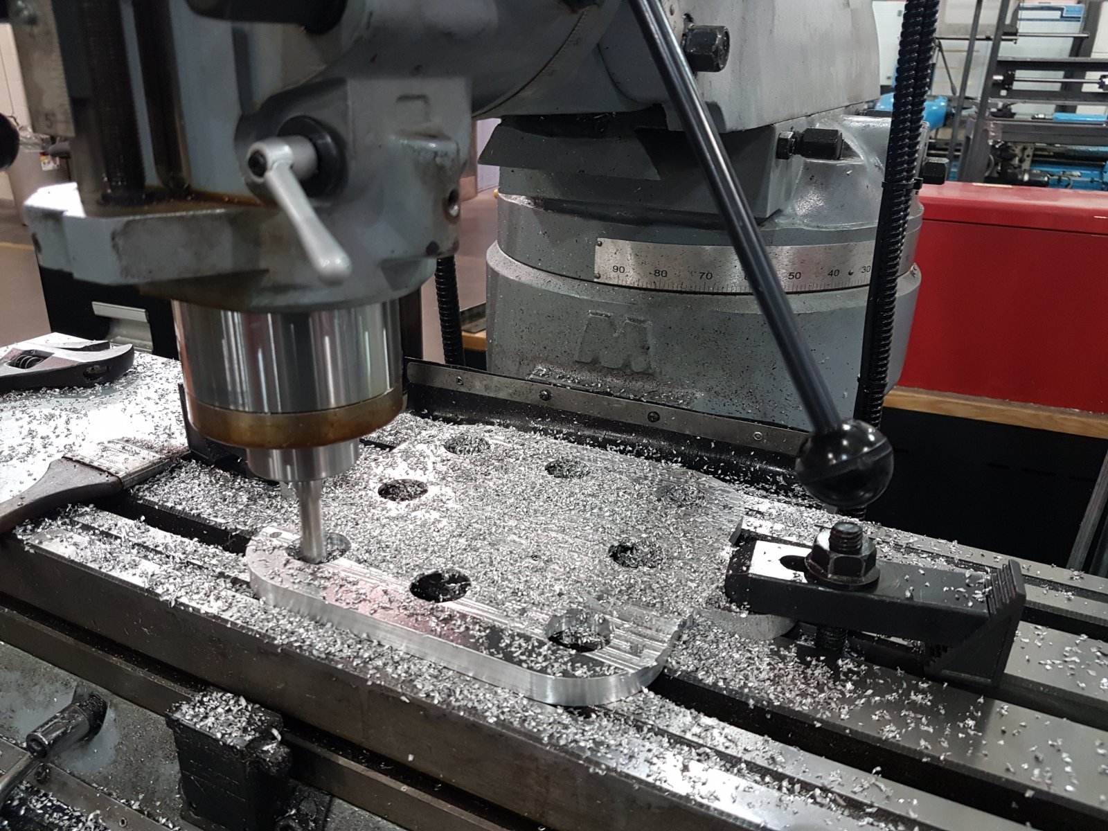

    The two plates were made out of half-inch aluminium plate:
    (not the best surface finish in the world, the endmill I was using was kind of dull and I think I didn't tighten the collet enough).
    I also needed to make some stands to hold the linear bearings high enough to give the clearance I needed for movement, those are just some bored out pieces of round stock with holes tapped in either end to fit the screws that fasten them to the plate. The linear bearing slides attach to the top plate with the standard chinese bearing mounts (I plan on replacing the heavy steel bearing slides with carbon fiber ones and matching bushings later on).
    Next I needed to make the guide rods for the springs, those are just some aluminium bar stock turned down to 0.5" diameter, with 3/8 threads on one end to mount to the top plate. The springs slide up and down over the guides, which keeps them from losing their form:
    Next I made the adjustable platform where the springs will sit:
    This just consists of a nut and a hollow threaded piece.
    The hollow threaded piece allows the spring guide to pass through it, and the threads allow it to be moved up and down relative to the base platform. Doing this effectively allows me more or less spring assist, based on how compressed the springs are at the neutral position.

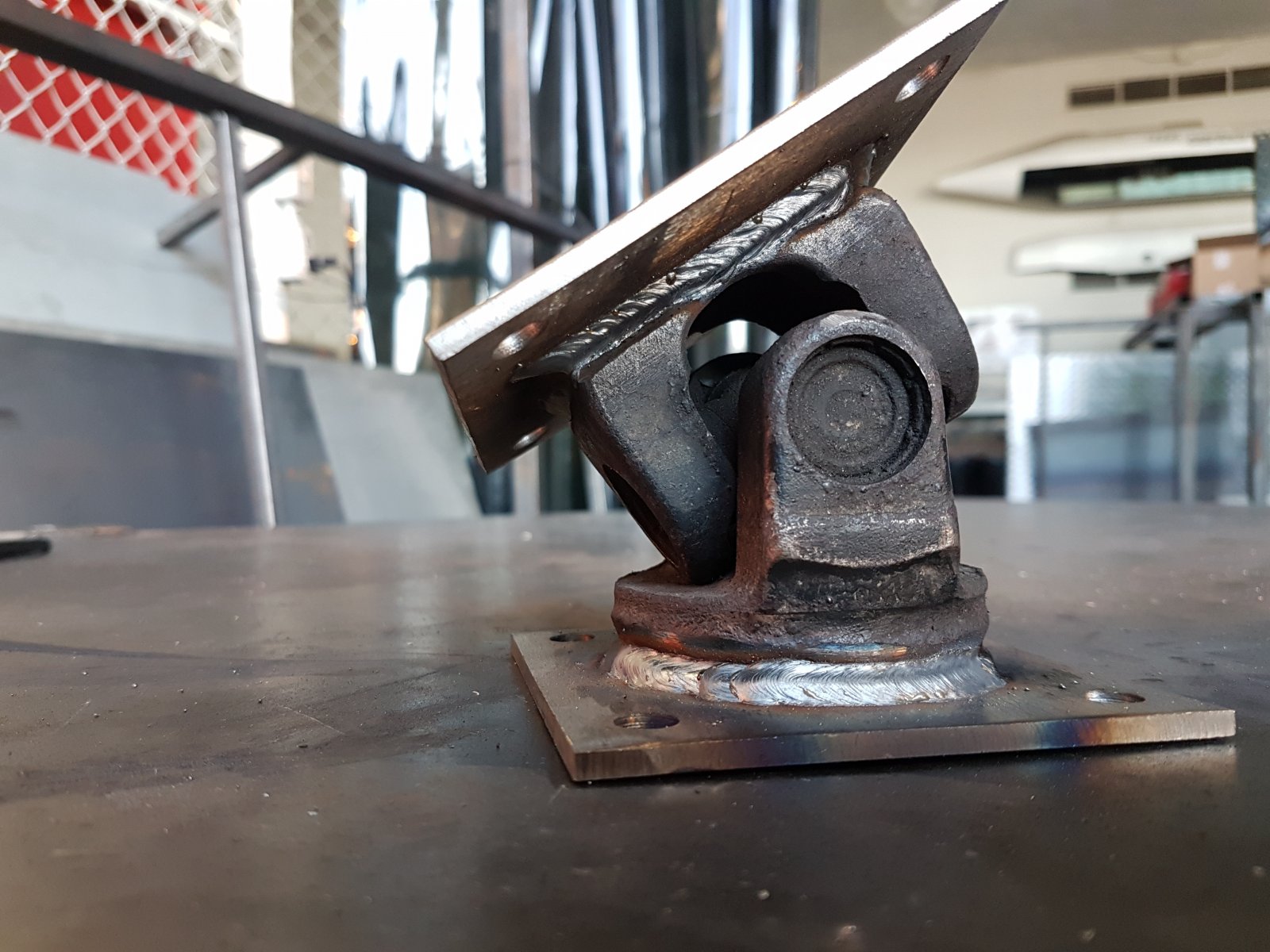

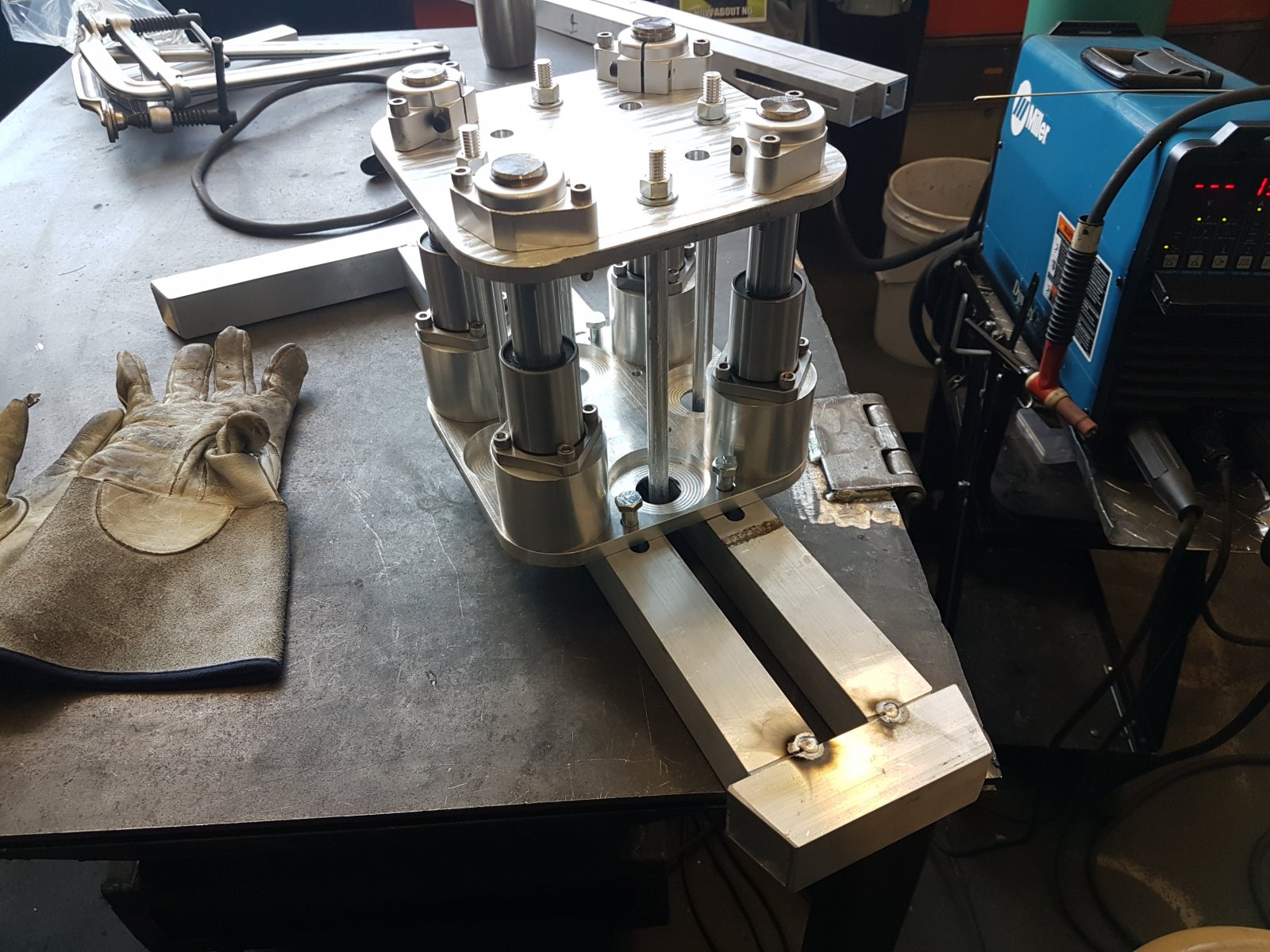

    Finally, I re-welded my U-joint, then mounted it on top of the platform:

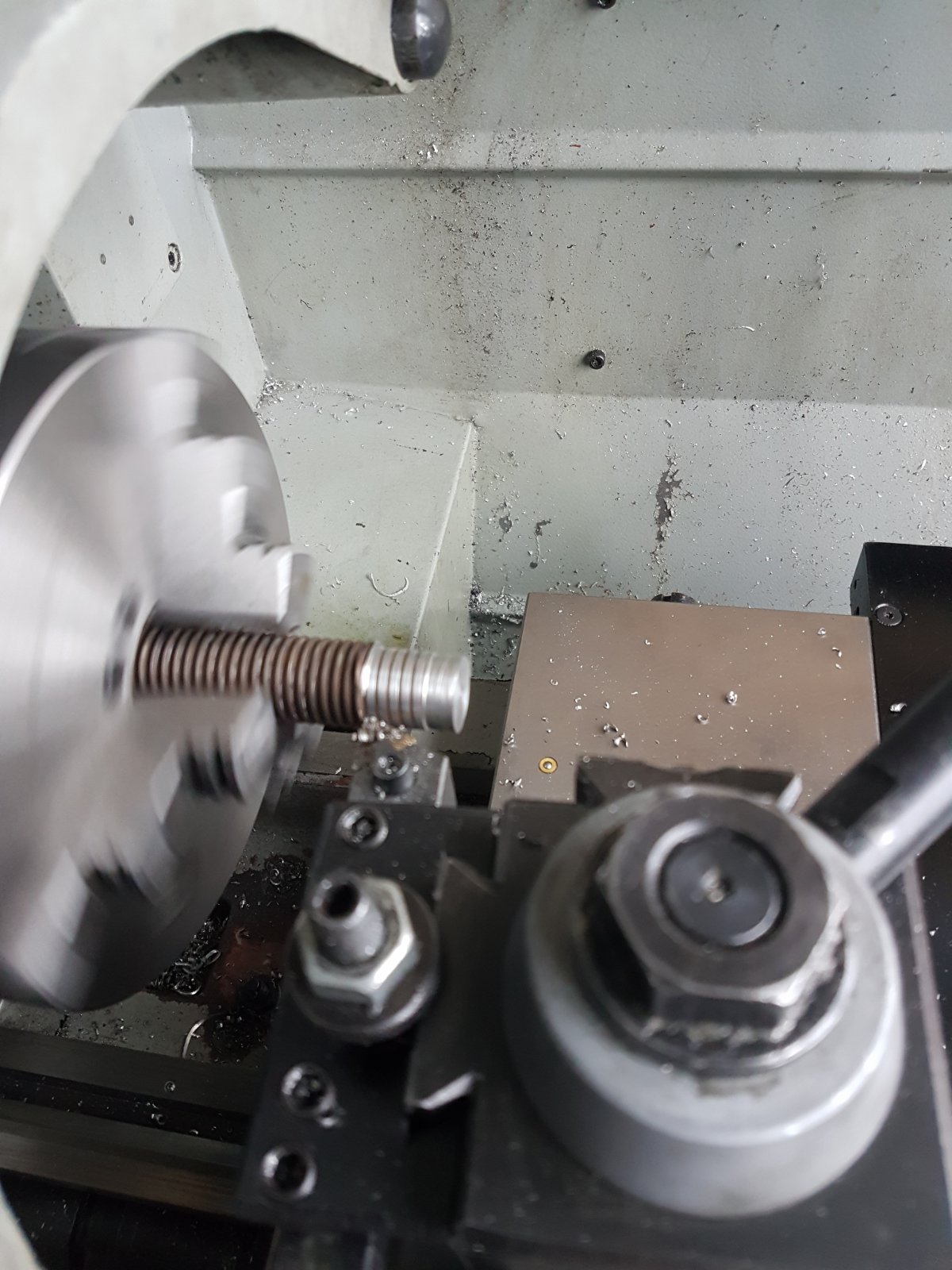

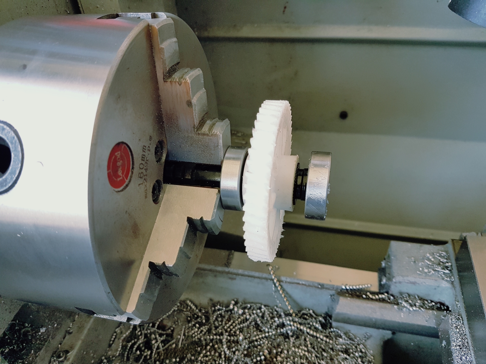

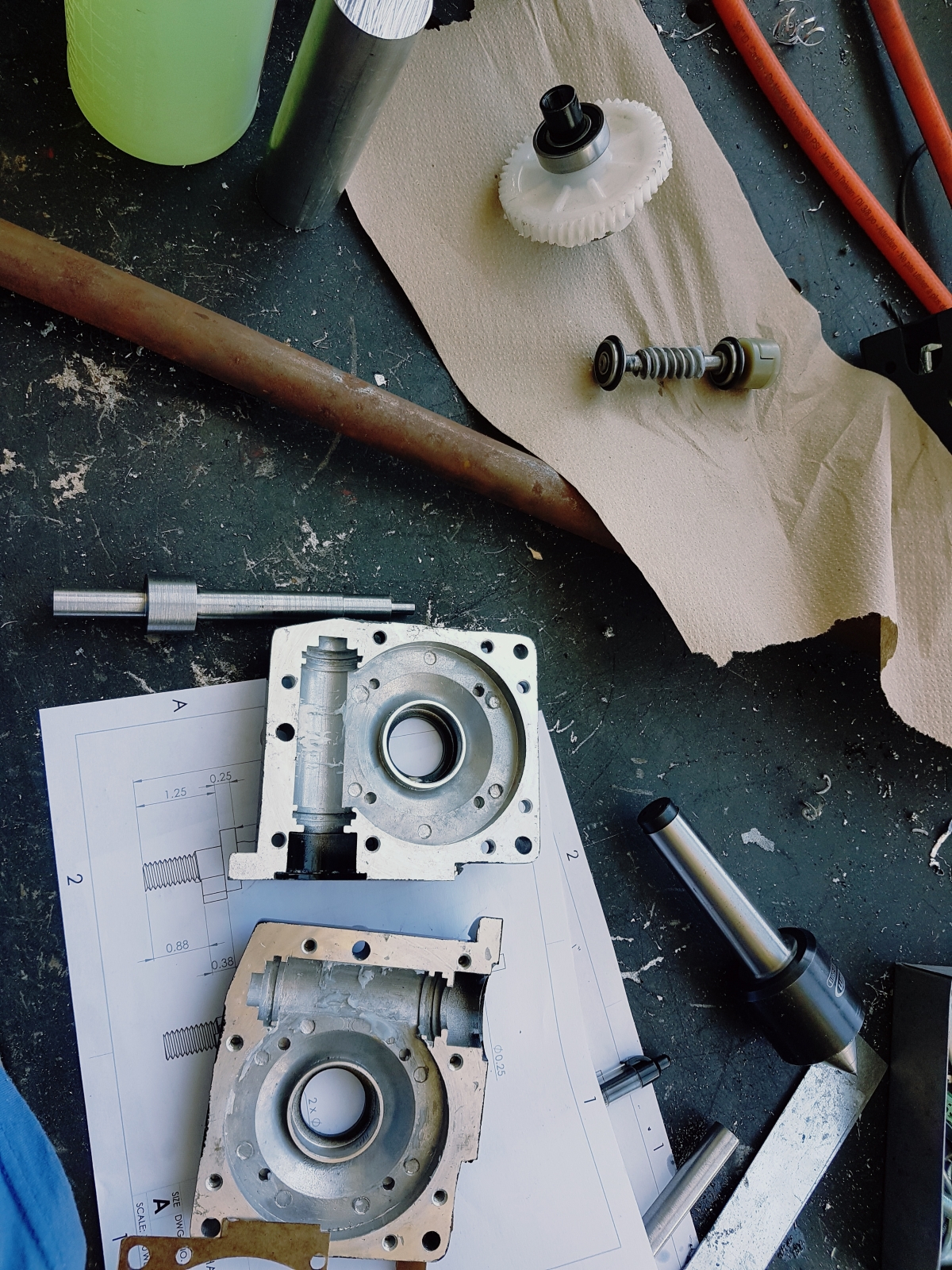

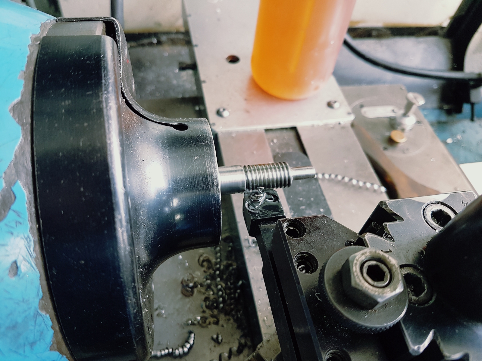

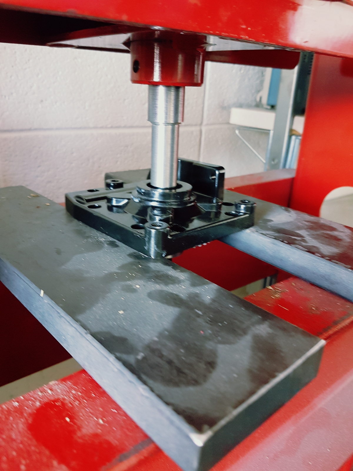

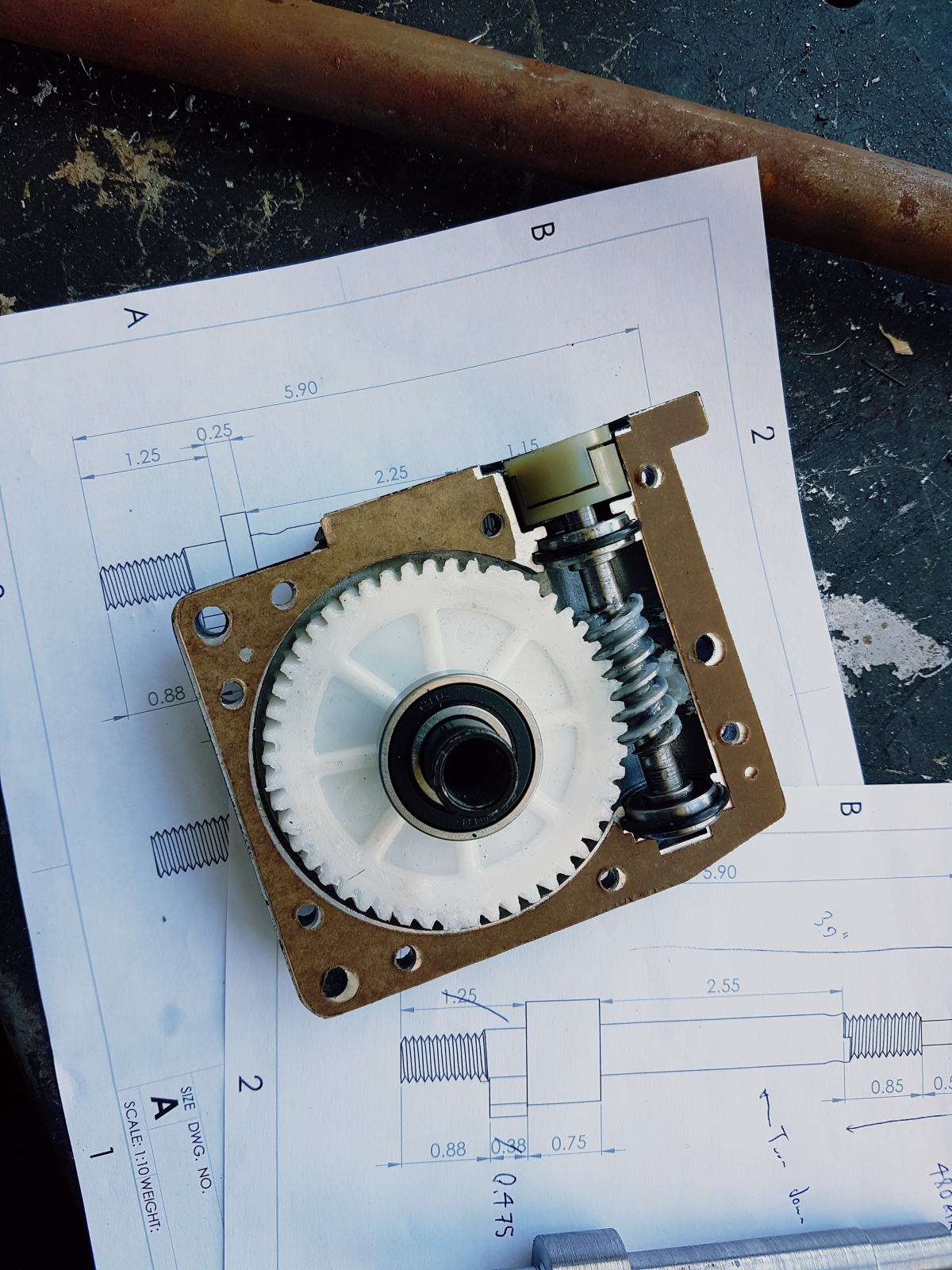

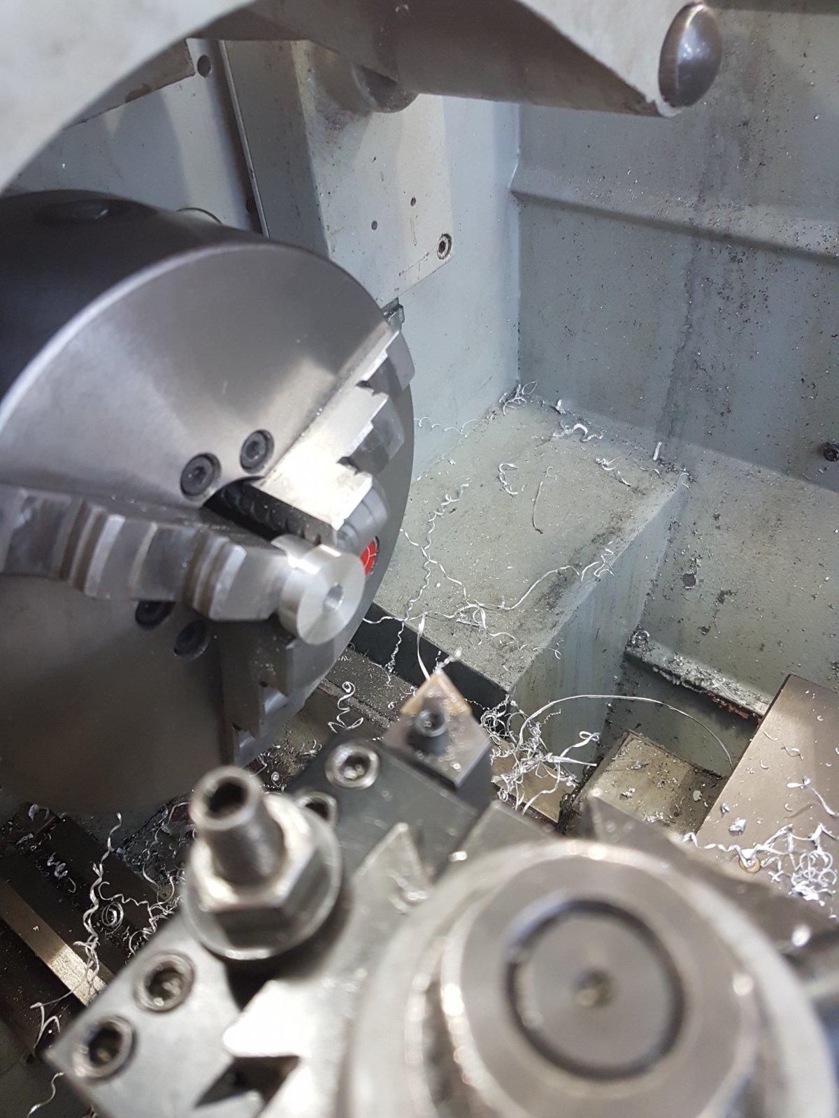

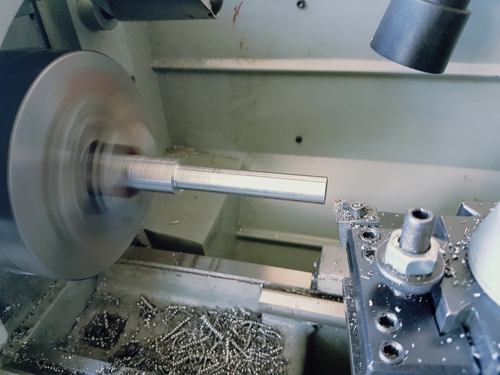

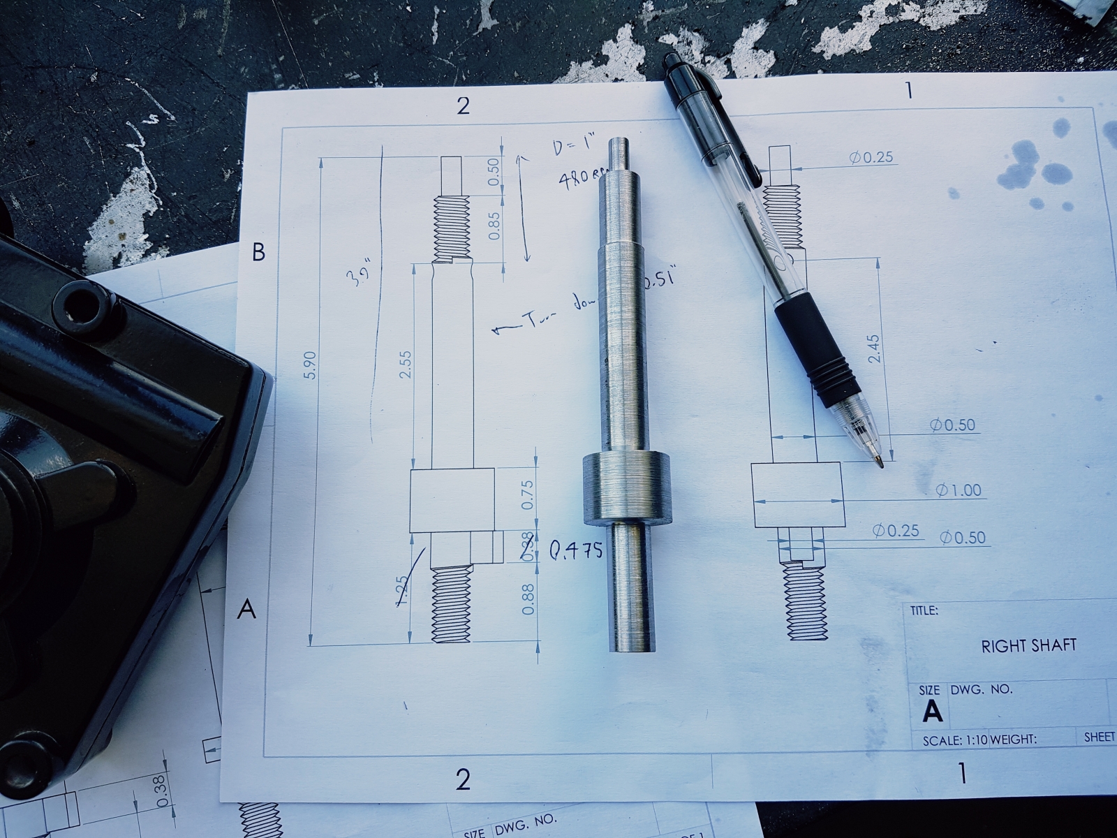

    I also wasn't really happy with the CTC lever arrangement on my old sim. I wanted to play around with different lever lengths, but because the arm was just welded to a central shaft, that wasn't really an option. I also wasn't really happy with the fact that the motor shaft was hollow, since it limited the force I could clamp onto it with. To get around all of this, I designed a threaded insert that would be pressed into the central shaft of the motor, and that would allow different levers to be easily attached to it. The levers would bolt to the insert, and be held in place with a key.
    I started with some steel round stock and turned the profile of the shaft down to size:
    Threads were then turned onto either end of the shaft, and keyways were milled into the the side that would hold the lever:

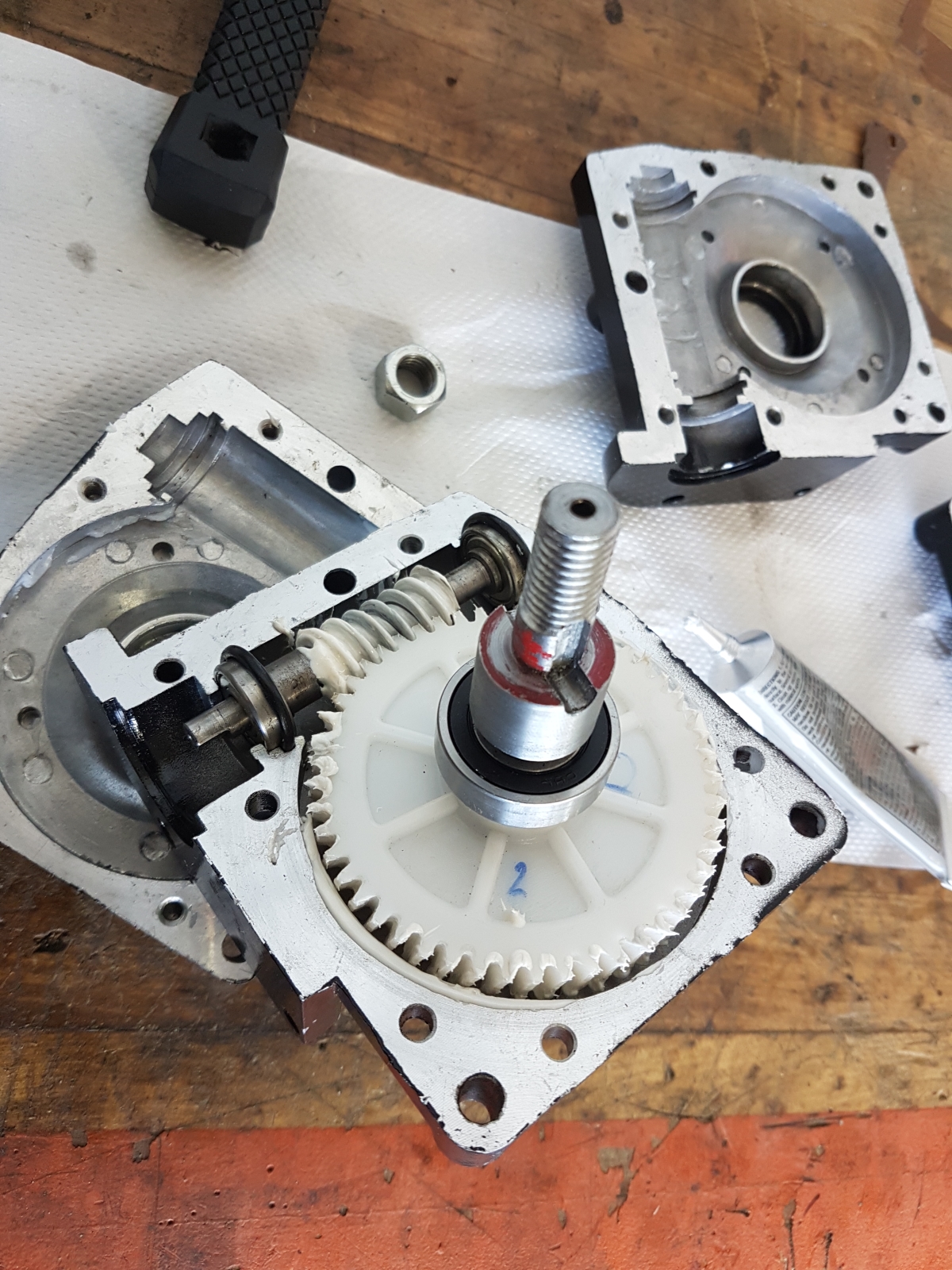

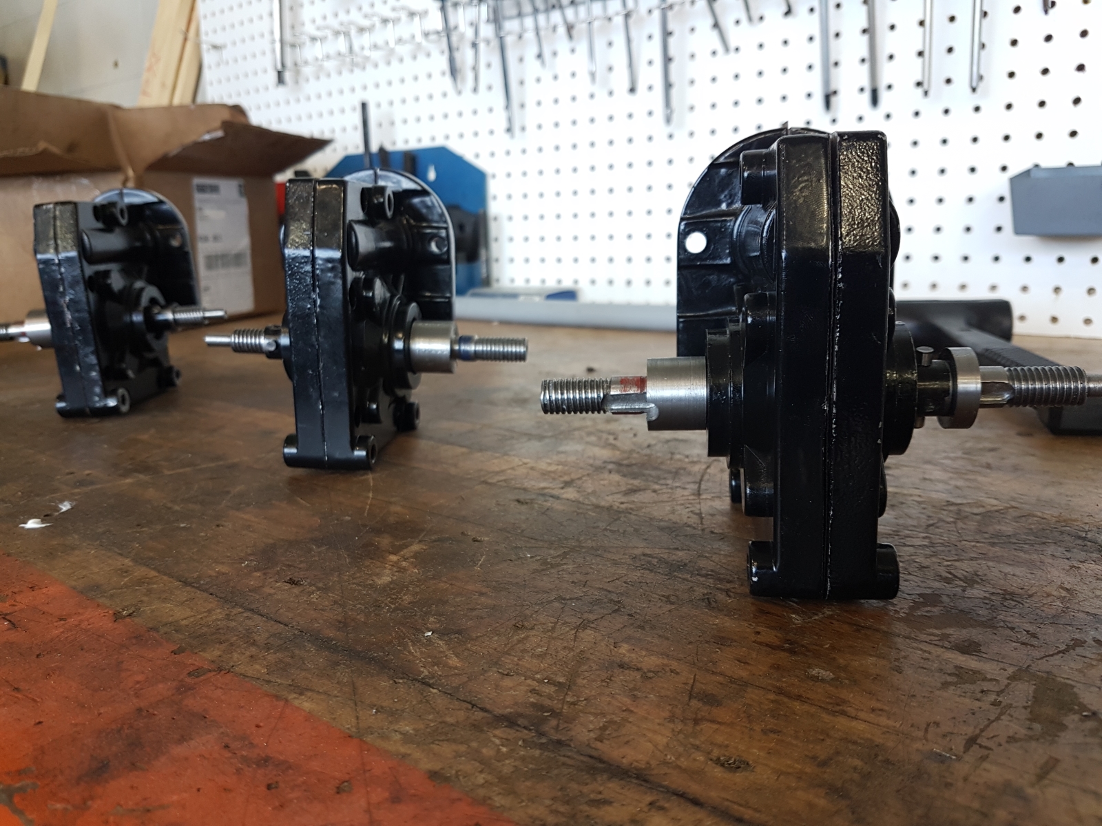

    Next the motors were taken apart, and the central shafts were removed:
    The shafts needed to be bored out slightly to ensure a good fit:
    Once that was done, the inserts were pressed into the motor shafts, and the shafts were put back into the gearboxes (the gears were cleaned and a fresh coat of lithium grease was applied before they were sealed up):

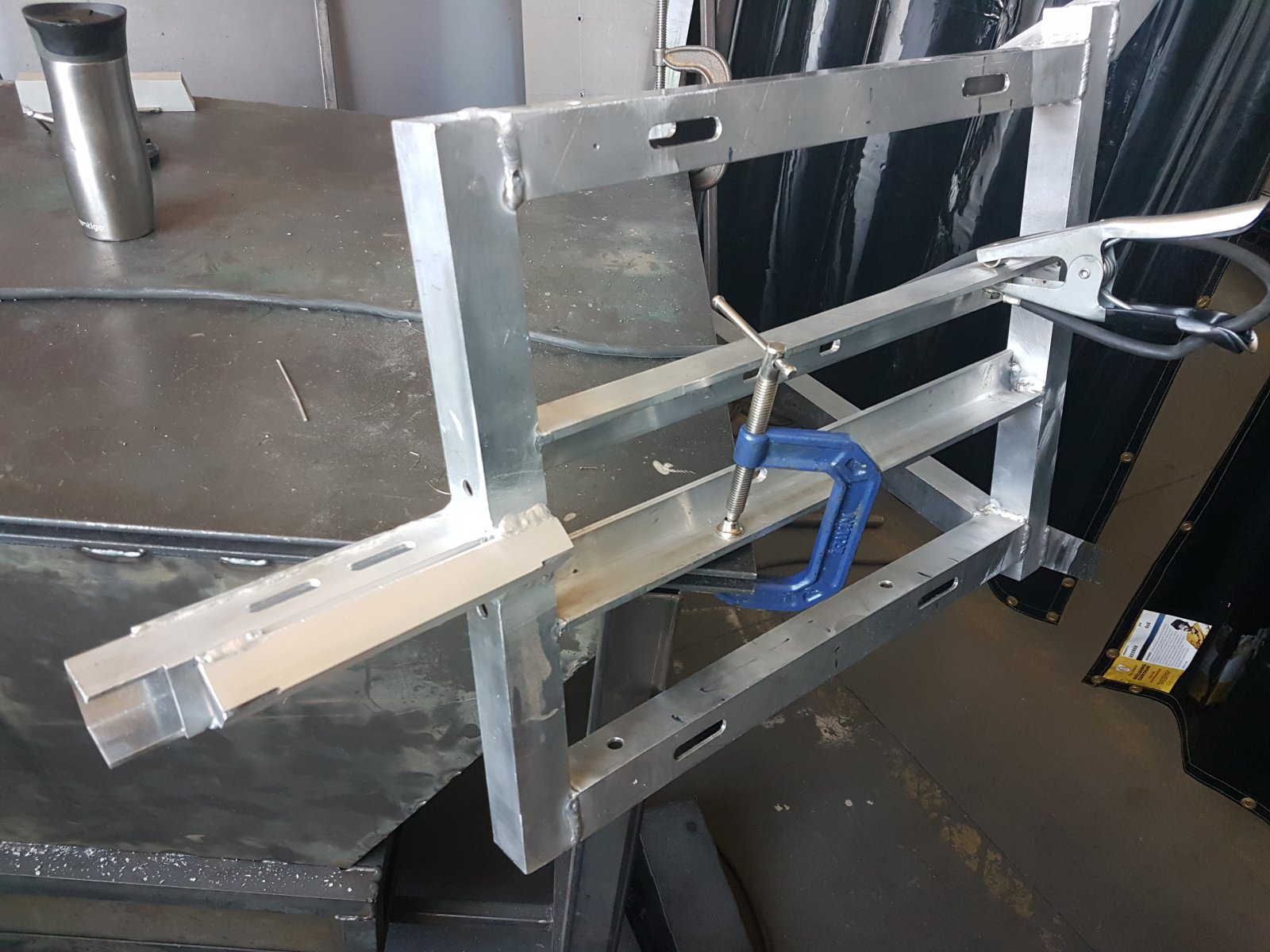

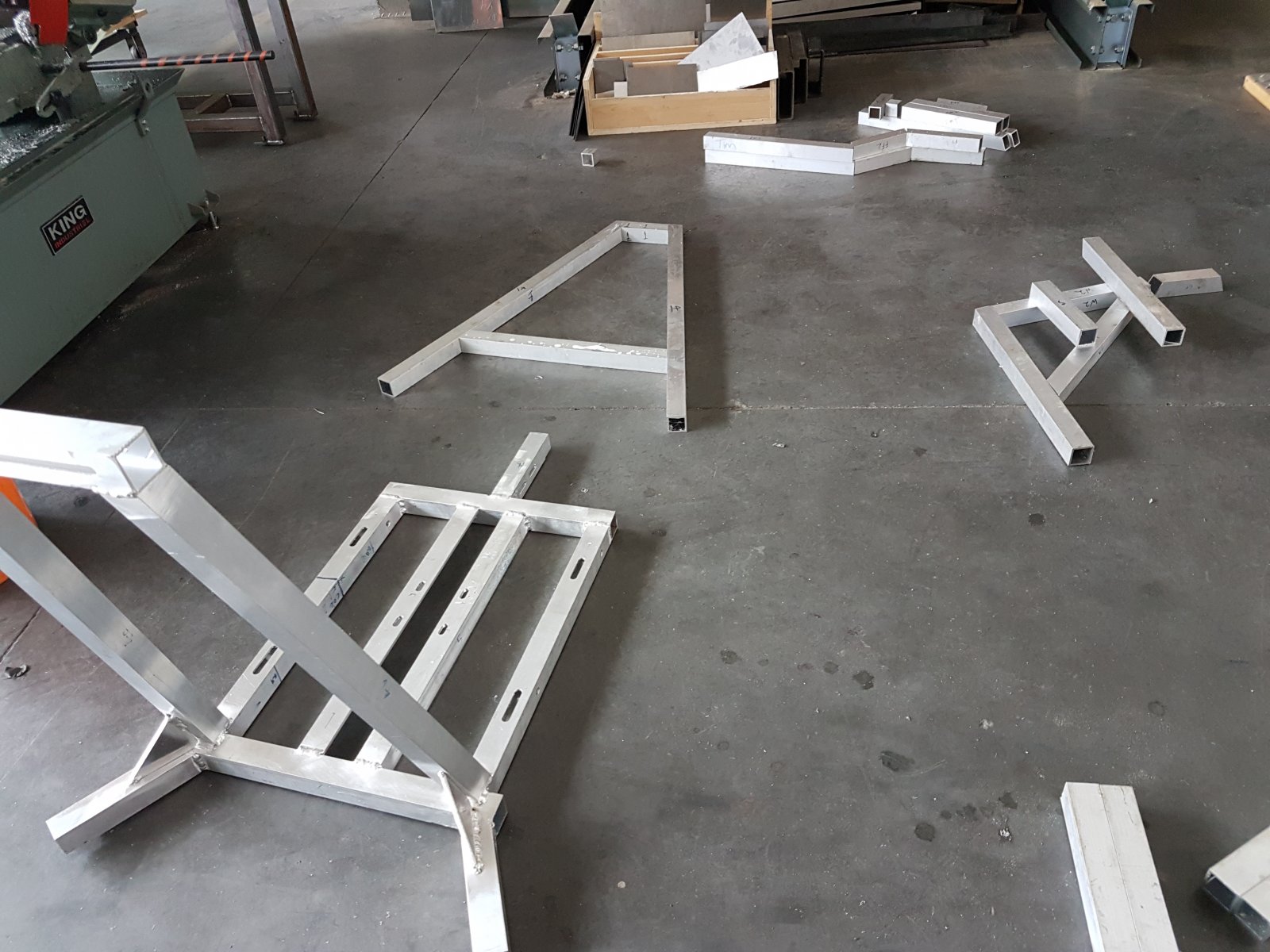

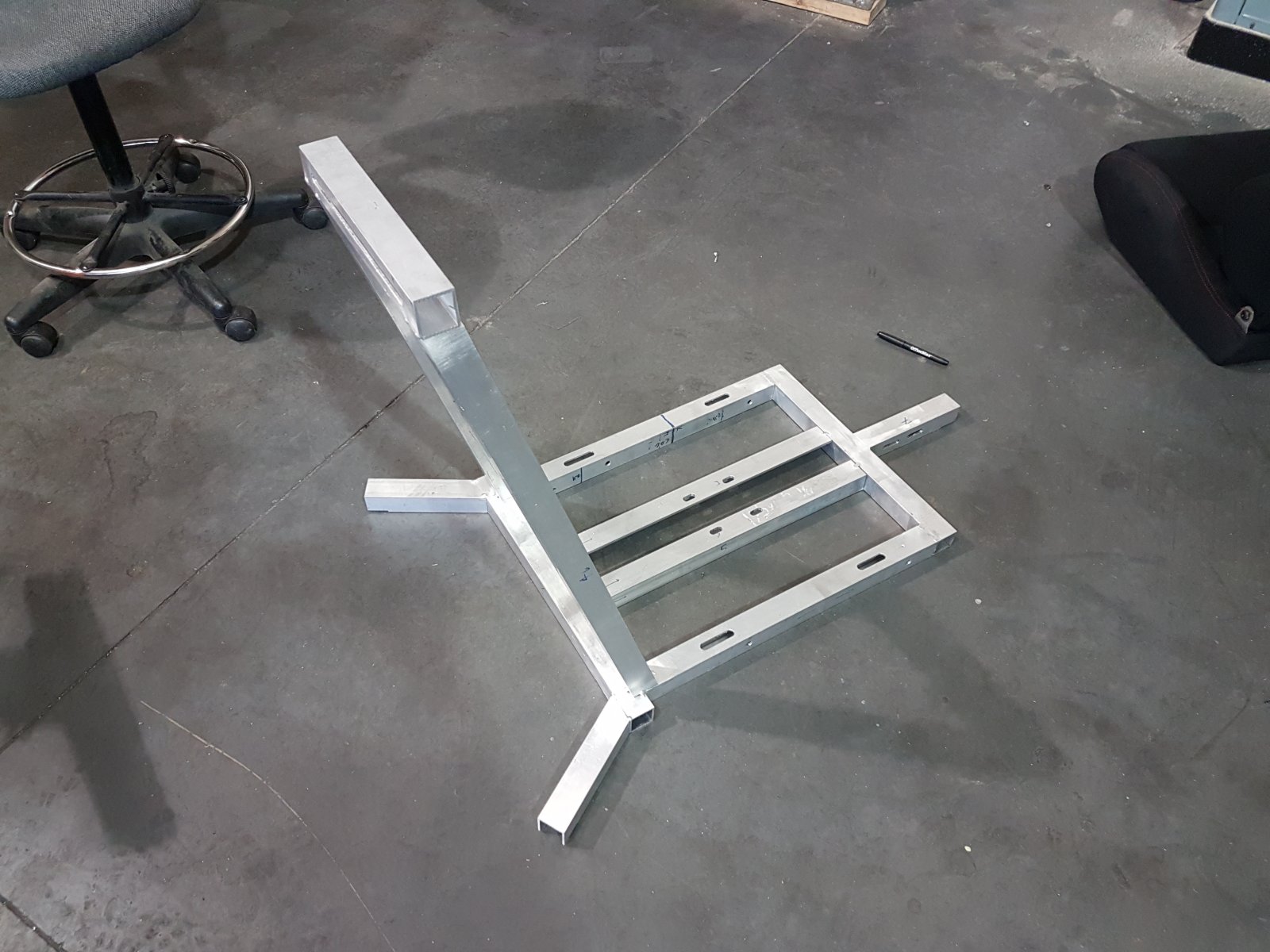

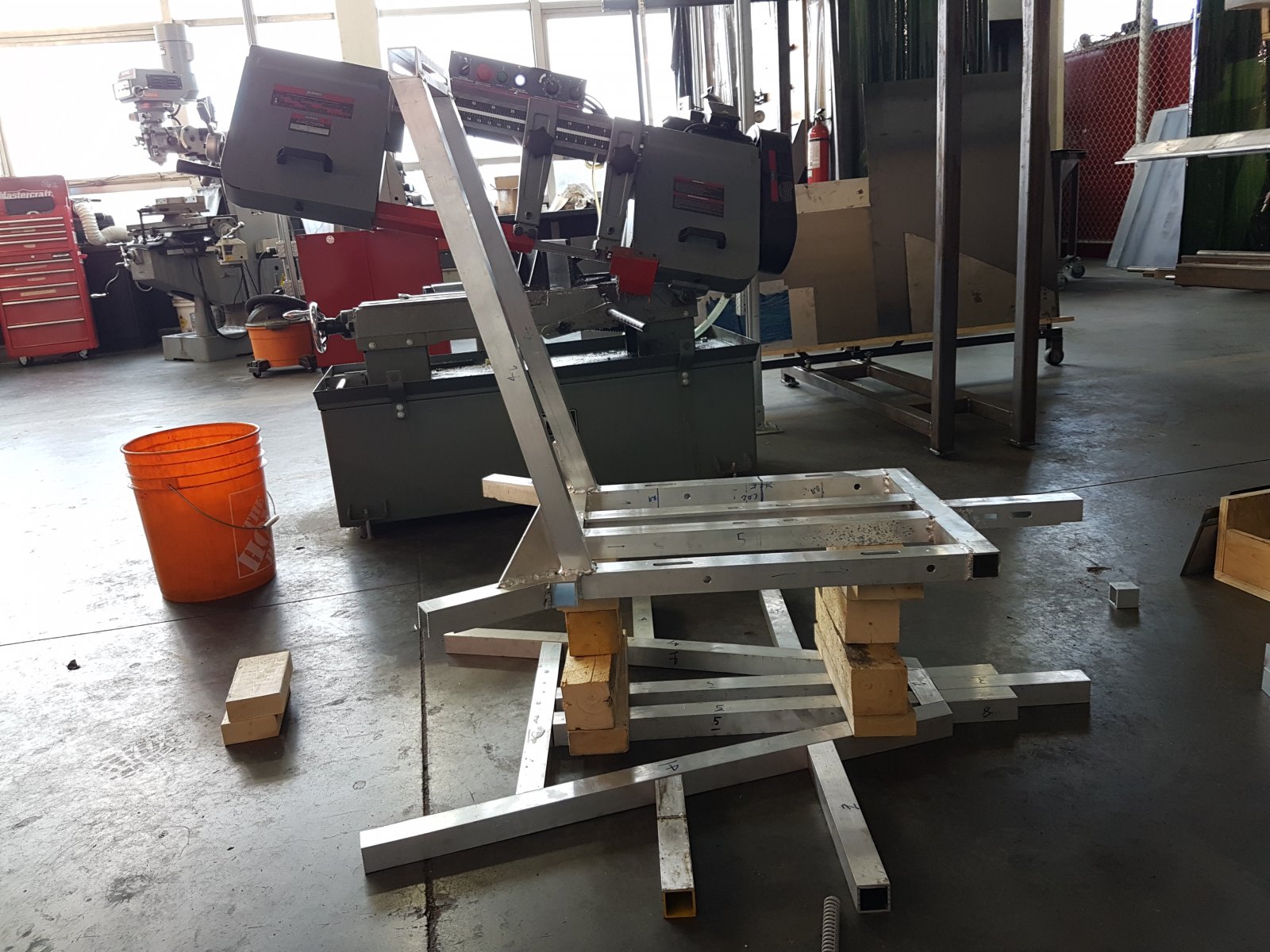

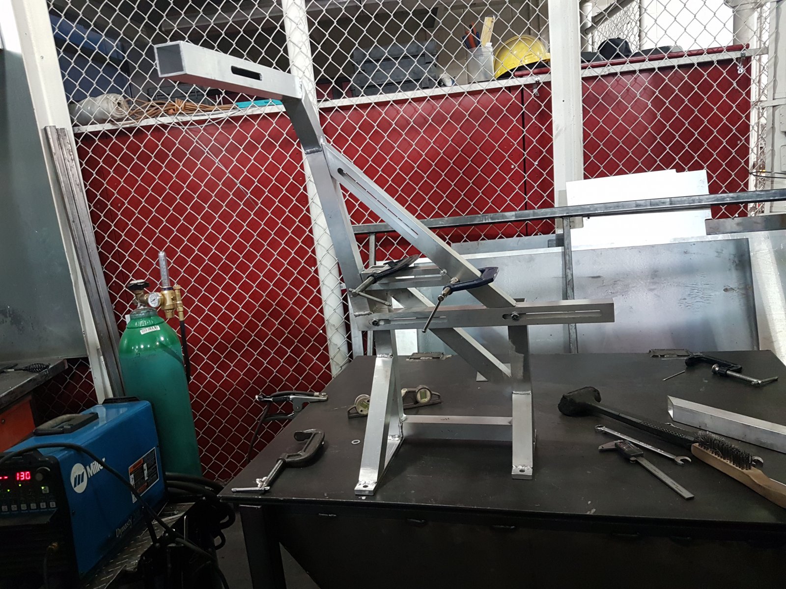

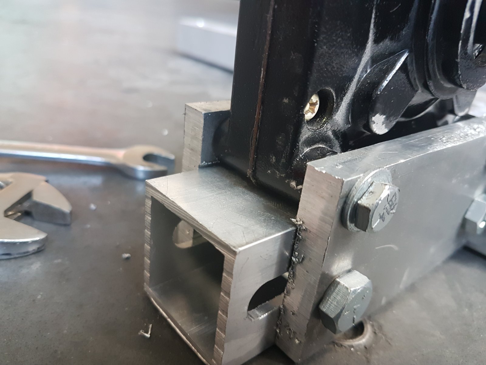

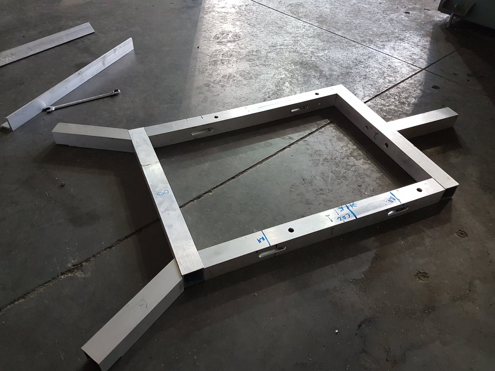

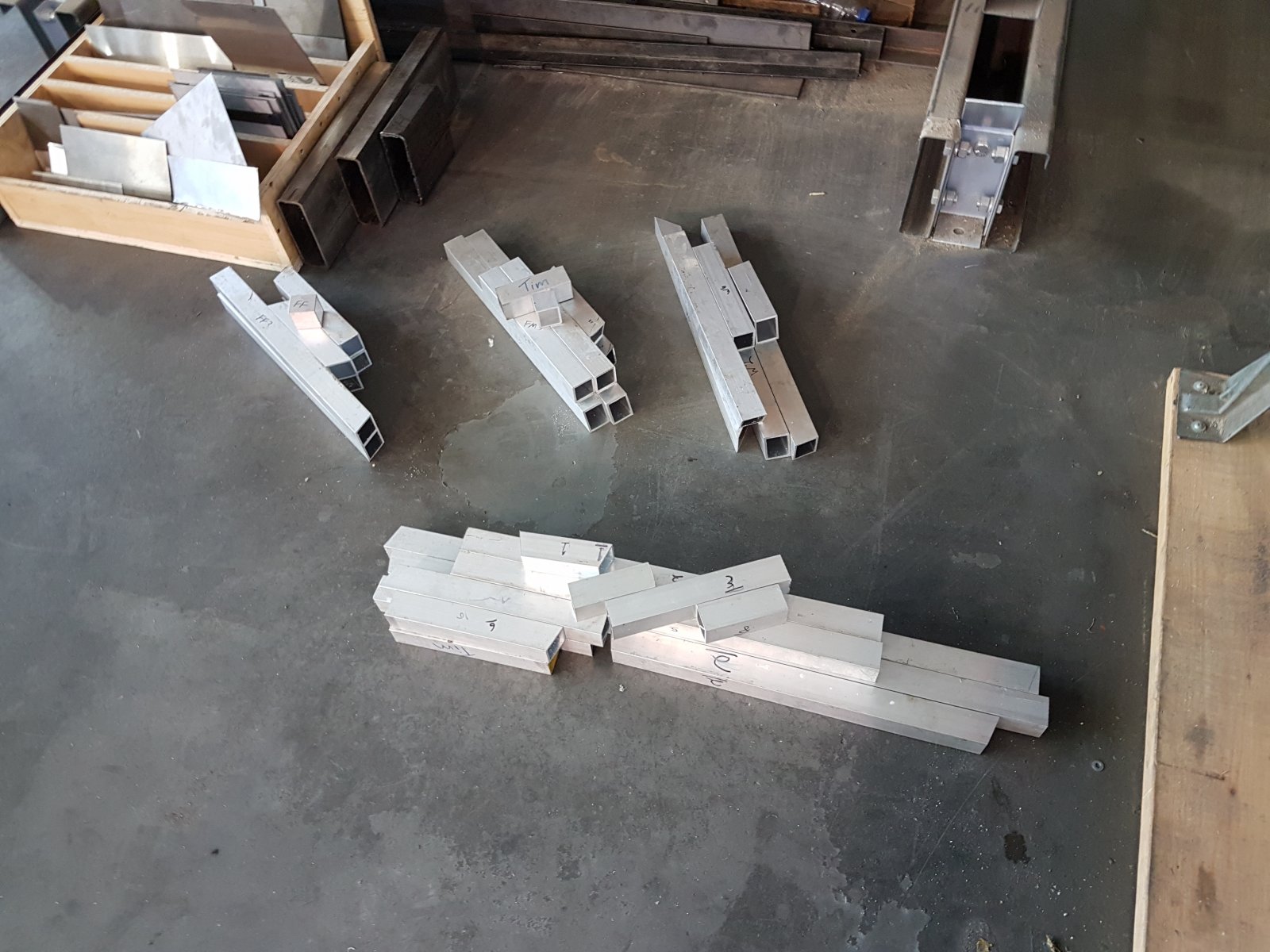

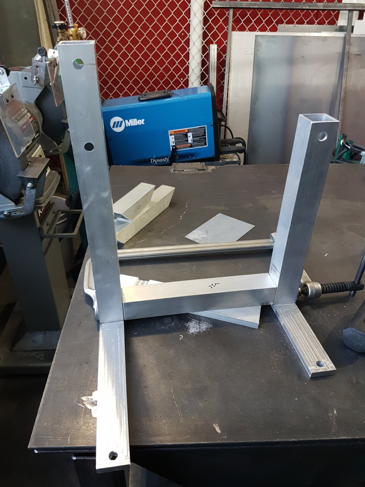

    By far the most time consuming part was the actual frame itself. The whole frame is made up of about 60 pieces of 1.5"x1.5"x0.120" 6061 Al square tubing. Since I can never leave well enough alone, many of the cuts have odd or compound angles as well, and to add more adjustability, slots were added instead of bolt holes where applicable:
    20170812_182820.jpg 20170826_194837.jpg 20170908_170511.jpg 20170908_171756.jpg
    20170930_150957.jpg 20170930_155943.jpg 20170930_183134.jpg 20171006_185552.jpg

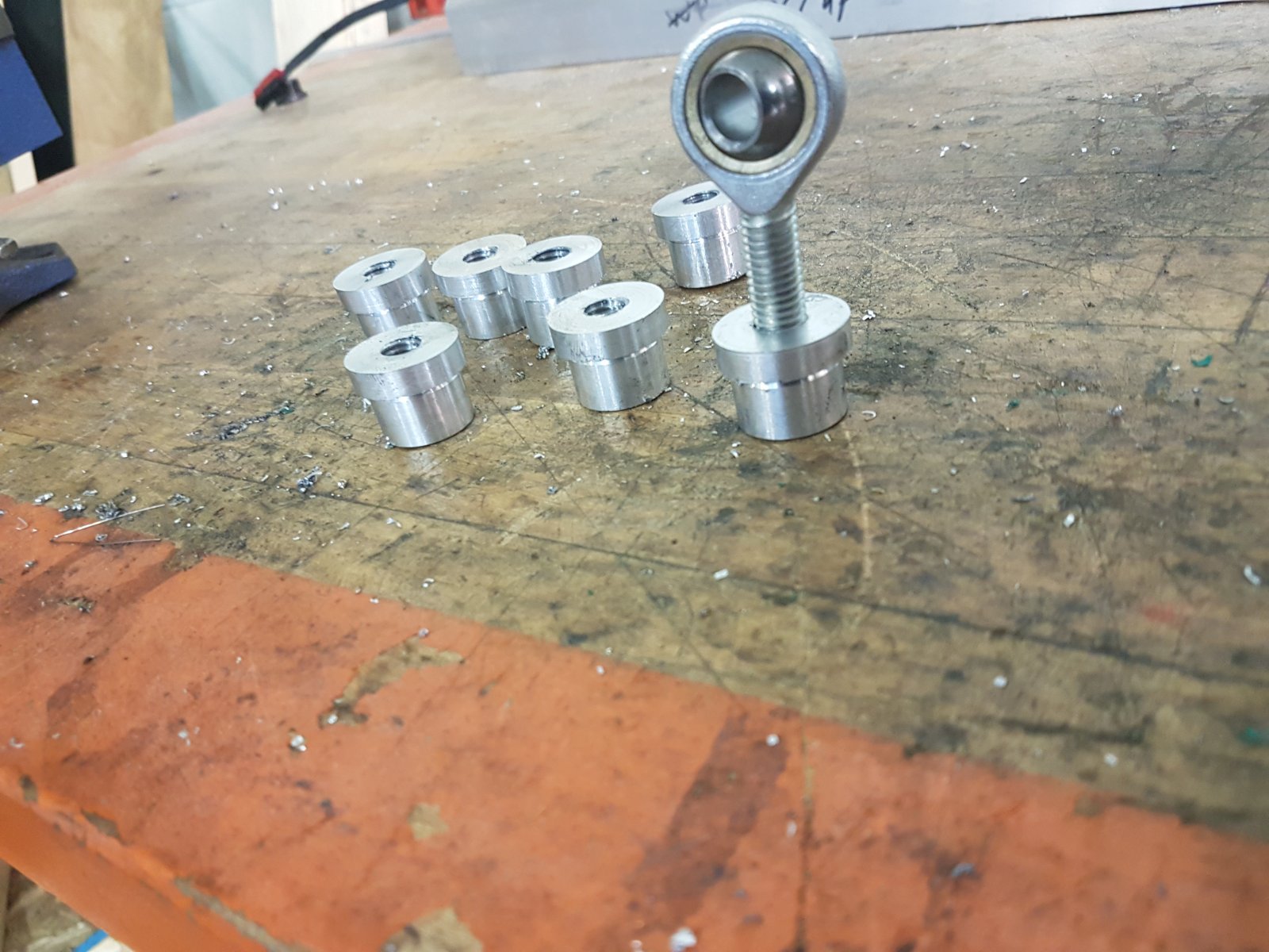

    I decided to make threaded inserts (kinda like weld nuts I guess?) for the ends of the connecting rods. That way my balljoints could simply be threaded in or out, and I could fine-tune the length without having to worry about precisely cutting my tubing:
    The rods mount to the top frame through similar inserts (but this one's just a through hole, no threads). The relief cut into the face is just to help make positioning for welding to my tubing easier:

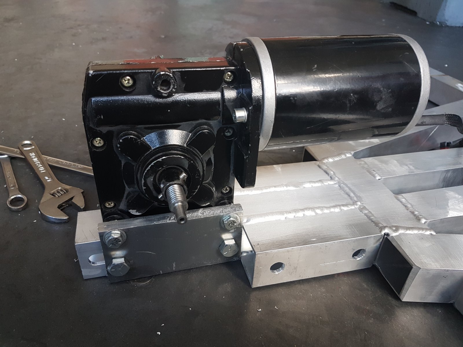

    Next, the motor mounts. These are pieces of 0.5" aluminium plate that were plasma cut and then sanded to size. They've got a slight relief milled into the face to ensure that the motor is actually being clamped, and that the tube isn't just being crushed by the bolt pressure:

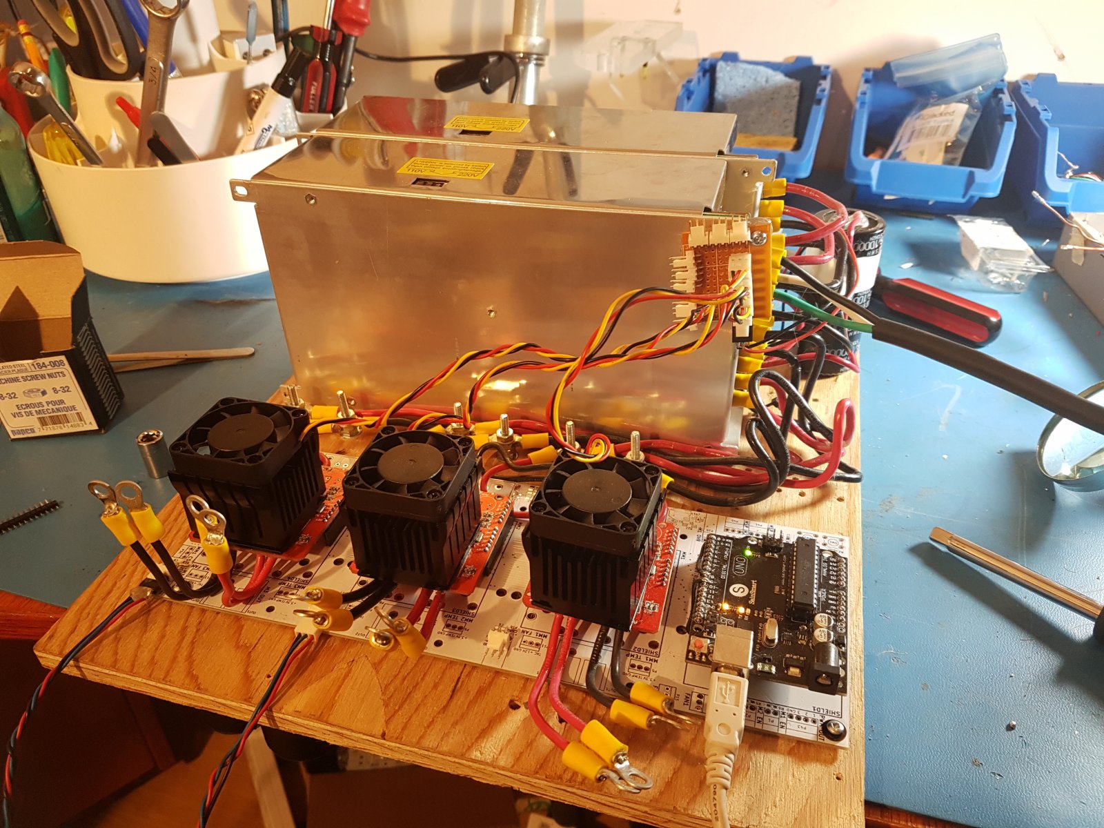

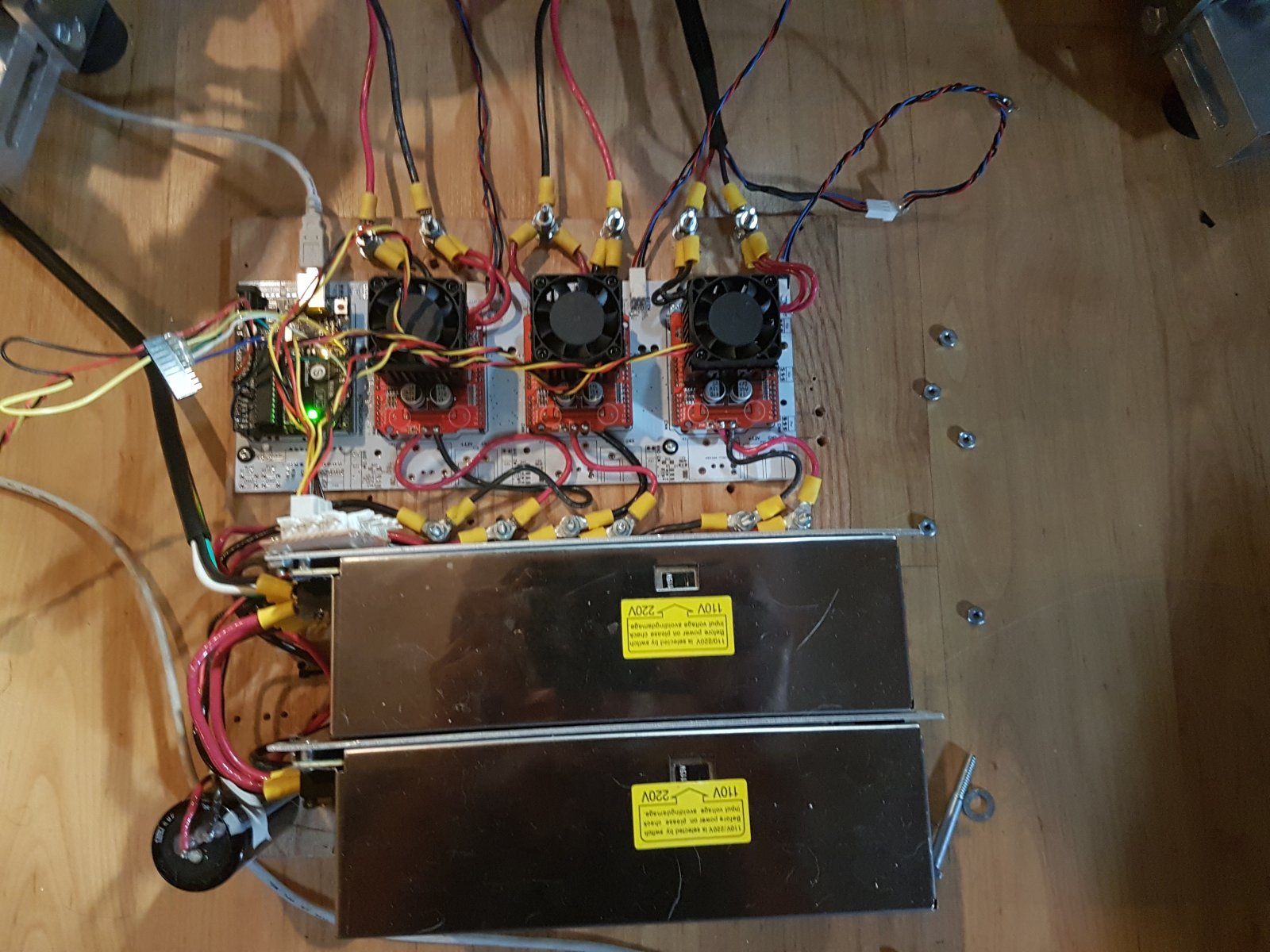

    As for the electrical side, I'm using the same setup as my previous rig, along with the custom interface PCB that hooks up my MMs to my arduino. I'm using 2 650W LED power supplies from ebay. One is driving the rear motors, and the other is driving the front motor. I plan on adding traction loss to this rig at some point, so the fourth motor would also be powered from that second supply.
    I've gotta put all of that into an electrical enclosure still.
