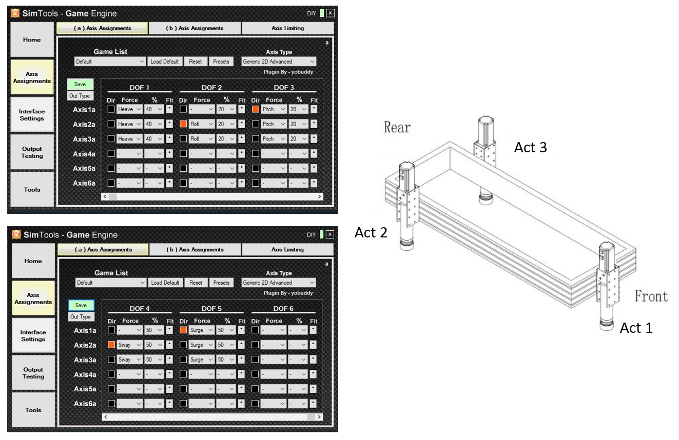

    Here is example axis assignment for simtools for 3DOF like that...

    If you want you can mount two actuators on the front sides, and one actuator in the back. It will work the same. Simtools can be configured for any arrangement of the actuators.
    I recommend the other way around for better load sharing as the back side with the driver usually has the most weight.

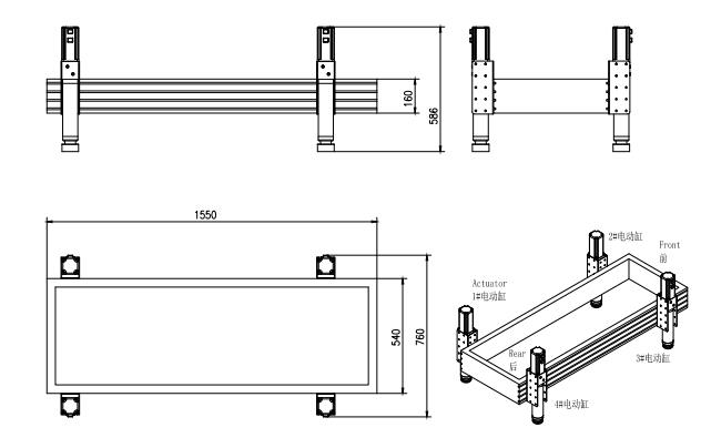

    Yeah the more I read about this and examine the cockpit I want to get, the more I am leaning towards a 4DOF setup. The two rigs I want to get, looks like both might present a challenge in mounting an actuator at the front due to clearance with the pedals, 4dof shouldn't be an issue since it's side mount to the rig. Will the 4Dof be ok mounting to a rig like below with smaller 8020 than 160mm?

    This cockpit is very small, what you can do is to add external frame beams to make it a little longer and have some extra spacing to add the actuators:
    Essentially, the rig on the link you provided, will be mounted inside the one on the drawing above.

    Thanks. Think I am probably better off with this and 4Dof instead. I think there should be enough room for all four actuators on the side without any additional modification to the cockpit.
