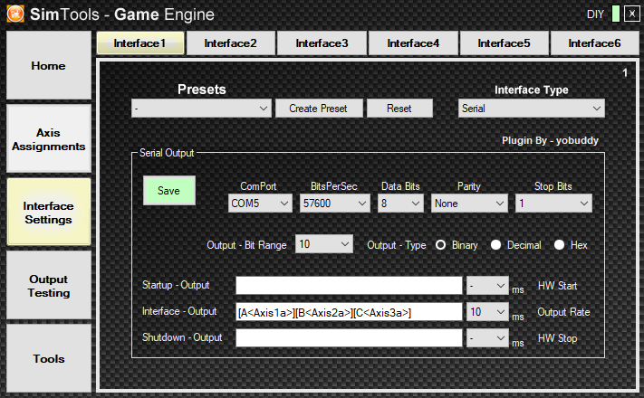

    Hey its me again. I have finally gotten to the point where I need to connect Simtools and smc3 and I did it through the serial interface and nothing happened when I went to output testing. I'm not a simtools expert an this is my first time using it so if anyone could offer some guidance it would be greatly appreciated

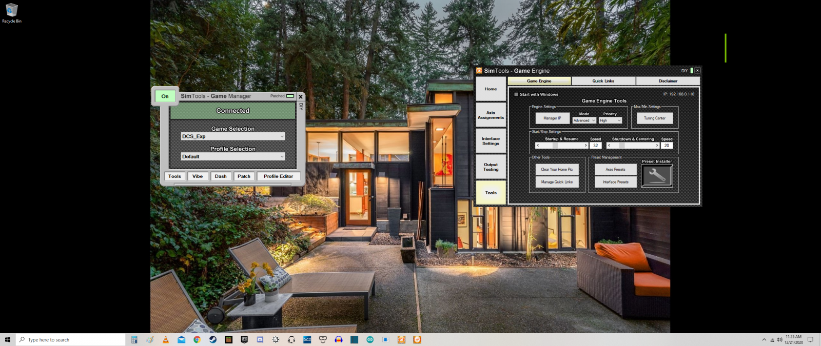

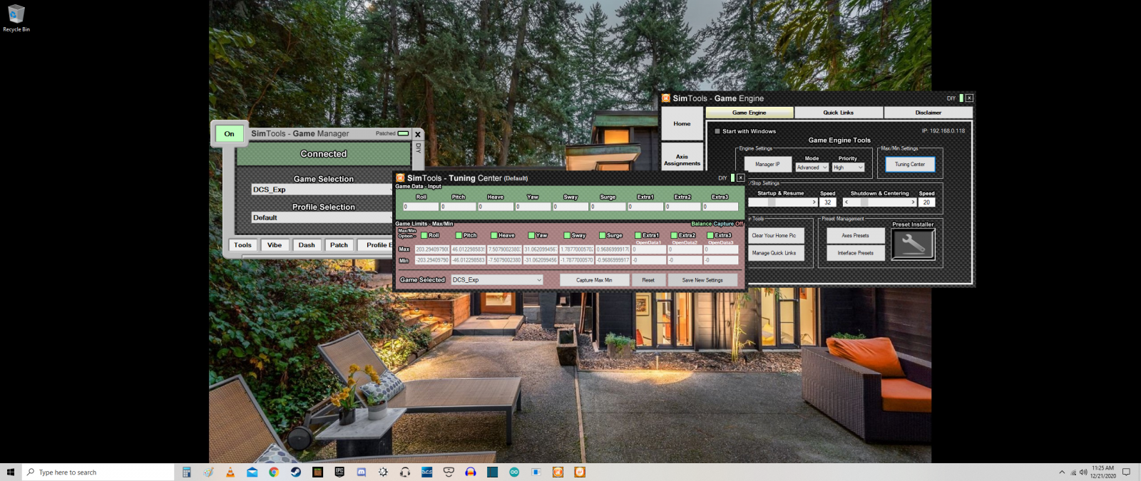

    A big issue I had that is not explicitly written but is talked about. Tuning center must capture your maximum in game travels. I did not do this and read about it. Once I did this my sim Desktop Screenshot 2020.12.21 - 11.25.34.47.png started working. May or may not be your issue.

    See above post. Click tools tab. Click tuning center. Then capture in game movement. Ensure the plug-in is active and on.

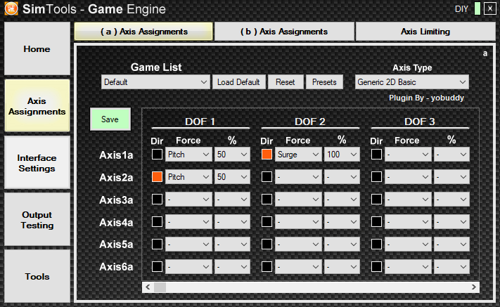

    These are all my settings. I did end up getting all my in game settings too Capture.PNG Capture2.PNG

    Try setting your BitPerSec to 500000.
    Your axis allocations are way too high: https://www.xsimulator.net/community/faq/axis-assignment-percentage-totals.120/
    Make sure you have a sensible Default Axis Allocations, 25 is a good starting point, but should be refined later.
    This is what SimTools expects in terms of axis settings: https://www.xsimulator.net/community/faq/which-way-to-set-simtool-axis-movements.230/
    Test in Output Settings.
    If Output Testing is working then see the tips here on how to refine motion profiles: https://www.xsimulator.net/community/faq/steps-to-create-a-motion-profile.228/
