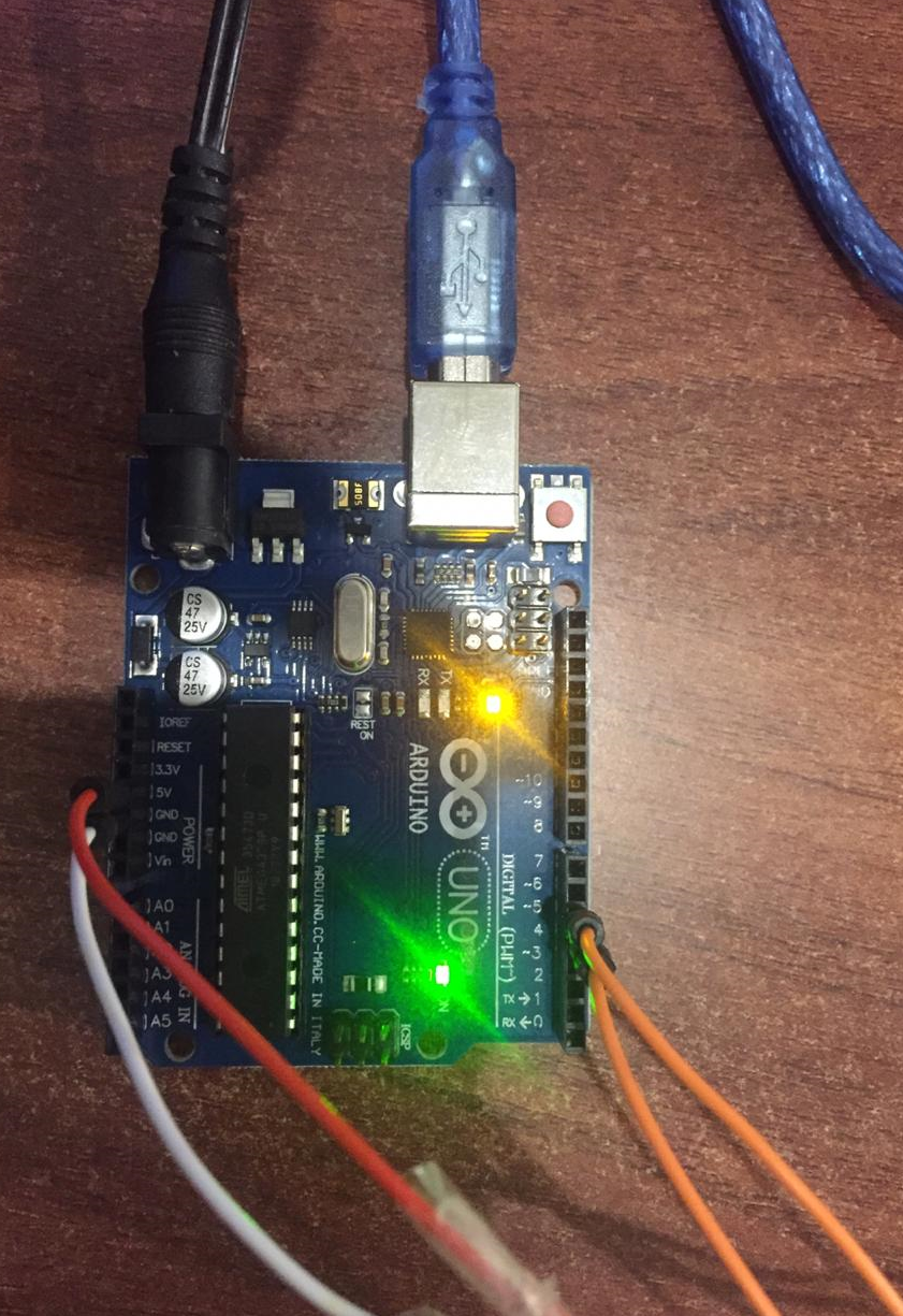

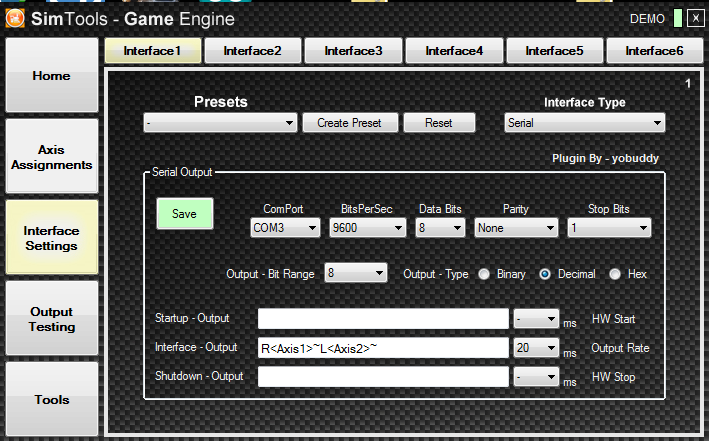

    I have same same configuration with same setup, but still im not able to move my motors from sim tools, when i testing RX and TX LED are blinking but not movement on the motors. when out put testing satrting time both motors are start moving and stop
    Please help.....
    i attached UNO code and sim tool settings, Please Help.....
    tell me where is the wrong...

    For SimTools 2 the Interface - Output should be like this: R<Axis1a>~L<Axis2a>~

    Thank you for quick respond,
    i just changed and out put R<Axis1a>~L<Axis2a>~ but still no movement when i test with out put testing..
    when i hit on out put testing RX and TX blinking,
    is there any other area need to be check.
    Please help......

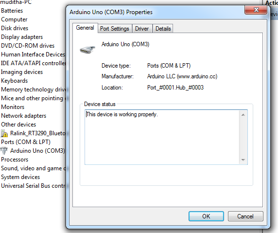

    Is Com3 the correct port?
    It is a bit hard to give advice until you provide a bit more detail about what you have and have not done, including hardware and wiring used.

    Stop Bits should be 1 in the Interface Settings.

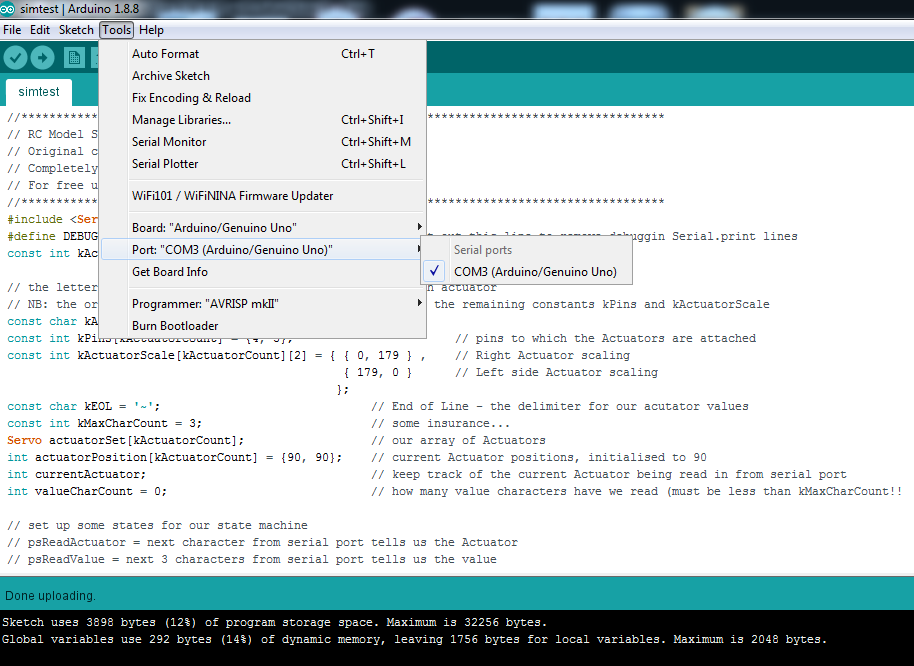

    Can you please post a picture of Device Manager ports so we can confirm om3 is correct.
    Can you also confirm if the board and com port are correctly set in the Arduino IDE.

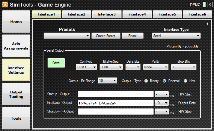

    Ok, obviously I was wrong with binary, but just one remark about the interface output, maybe it should be
    ~R<Axis1a>~L<Axis2a>~
    instead of
  9. Pit
    3,012
    30,480Coins
    +3,097 / 31 / -0
    ...and output rate should be 10ms.

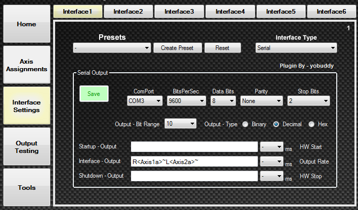

    I tried with stop bits as 1, Still no any changes.
    i used this both Arduino codes https://www.xsimulator.net/community/threads/rc-model-for-motion-simulation.4600/
    still no changes

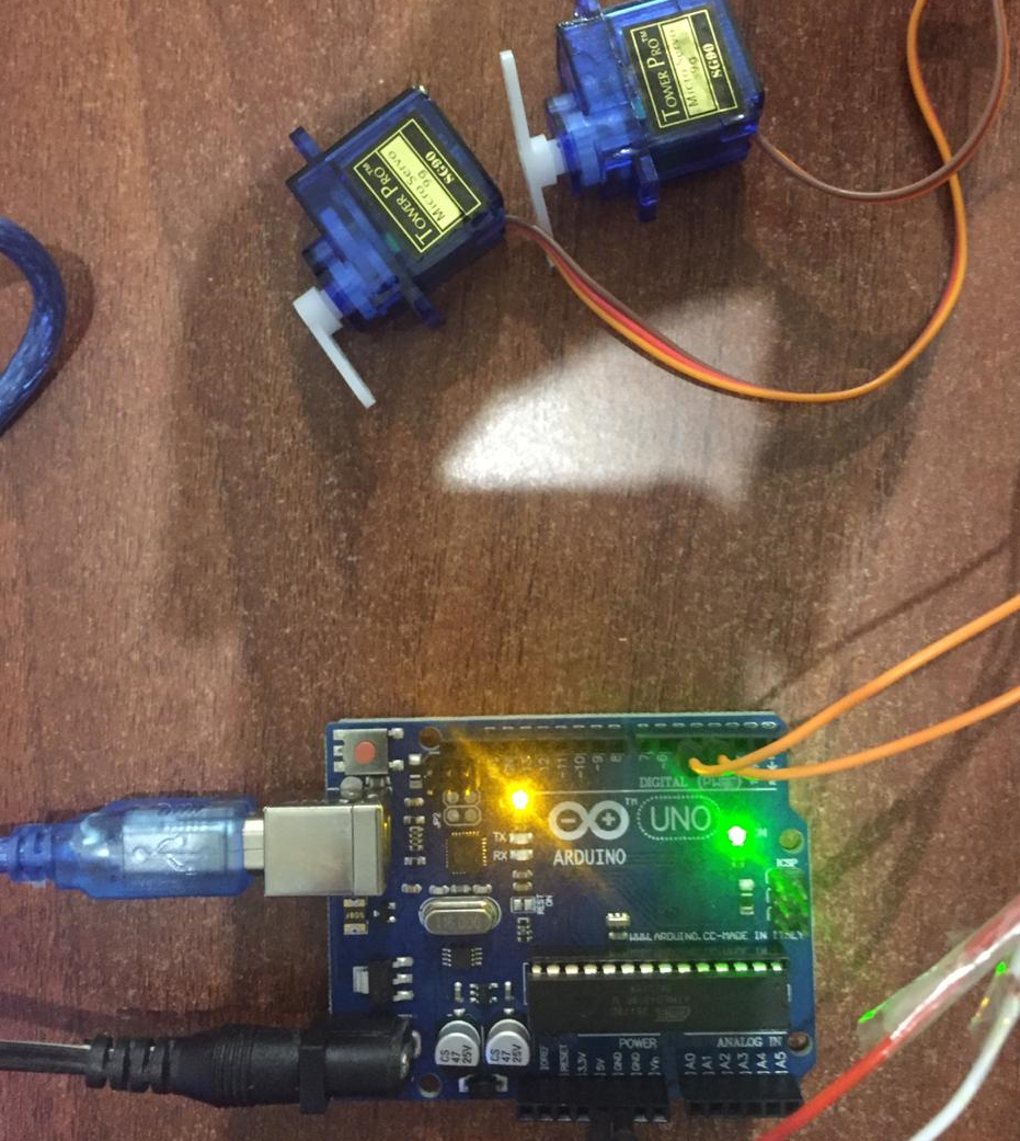

    this is the my hardware configuration

    I changed out put interface like this ~R<Axis1a>~L<Axis2a>~ and out put rate 10 and stop bits 1
    now when i hit out put testing RX and TX LED getting ON and both motors are stat moving in left and right for few second then stop, but still im not able to control with out out testing. no any respond for out put testing
    and when i start Life for speed game motors start moving for few second and stop moving,
    no respond for during playing
    Please help...

    Interface should be:

    i have changed it out put setting like this R<Axis1a>~L<Axis2a>~
    still i have no any changes on output testing
    but when i start out put testing both motors are start moving with out control and no action when i move sliders
    is there any other things to check
    Please help.....

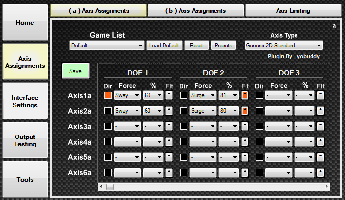

    Please do not cross post with the same questions, it gets very confusing for others to follow, keep your questions on your own thread rather than clutter others: https://www.xsimulator.net/community/threads/rc-model-for-motion-simulation.4600/page-8#post-169899
    You need to configure a default profile in Axis Assignments. Start with 20% allocations in Axis 1 and Axis 2 rows for sway, surge, pitch, roll and heave, this is how SimTools expects axis to be configured, using the Dir box being checked orange or not to define which way each axis moves: https://www.xsimulator.net/community/faq/which-way-to-set-simtool-axis-movements.230/

    i'm really sorry about confusion,
    i was tried that almost all the comments and i did not get any changes on my out put settings.
    but i noticed most of the post are for sim tools 1.3, i just downgrade sim tools to 1.3 and start like this
    way. https://www.xsimulator.net/community/threads/rc-model-for-motion-simulation.4600/
    and
    https://www.xsimulator.net/community/marketplace/rc-model-code-for-arduino-uno-2dof-expandable.89/
    finally i go my correct movement from motors with sim tools 1.3
    also i tested with LFS game as well, its working fine.
    but i have still doubt with why it did not work with sim tools 2. if i use same setup with sim tools 2, will it work ?
    Please advice me if need to any other this before starting this project and im planing to buy licence for sim tools 2 as well for my project.
