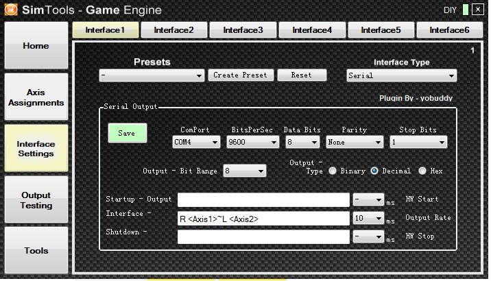

    Google Translate -
    I am a newbie, I have purchased the simtools and race07 game plugins, I use RC_Sim_Model ino, and wired correctly, running the game, but I have no reaction to the motor, I don't know where the problem is, ask for help, thank you
    As per the forum rules you need to include English, particularly when seeking assistance, you can use Google Translate, as I have done for you: https://www.xsimulator.net/community/threads/forum-rules.9527/
    Regarding your question The difference from SimTools 1.3 to SimTools 2 in setup is that in the Interface Settings instead of axis defined like this <Axis1> it now has designate grouping for a or b in SimTools 2 for each axis assignment, like this <Axis1a>
    So in your case it should be R<Axis1a>~L<Axis2a>

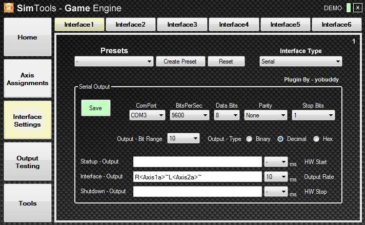

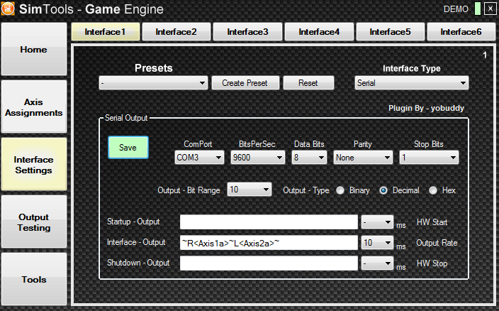

  9. Pramuuditha Kumara
    Pramuuditha Kumara Member
    Jan 6, 2019
    51
    61Coins
    +4 / 1 / -0
    i have done same setup, but still no movement on the motors when out out put testing
    can you please send me the image of the sim tools setting
    please help me to get ready this setup....
    i attached my current setup for reference....
    Please help me.....
    Thanks ....
  10. yobuddy
    51,751Coins
    +5,206 / 19 / -0
    @Pramuuditha Kumara,
    Your interface output line is wrong.
    You have "~R<Axis1a>~L<Axis2a>~" and it suppost to be "R<Axis1a>~L<Axis2a>~"
    You have a extra leading "~"
    Take care,
    22,210
    154,723Coins
    +11,213 / 57 / -2
    That advice was also provided in an earlier post:
  12. Pramuuditha Kumara
    Jan 6, 2019
    51
    61Coins
    +4 / 1 / -0
    hi @yobuddy
    i have changed it out put setting like this R<Axis1a>~L<Axis2a>~
    still i have no any changes on output testing
    but when i start out put testing both motors are start moving with out control and no action when i move sliders
    is there any other things to check
    Please help.....
