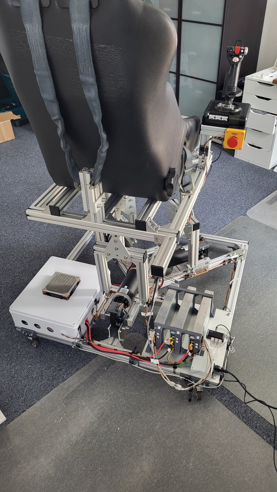

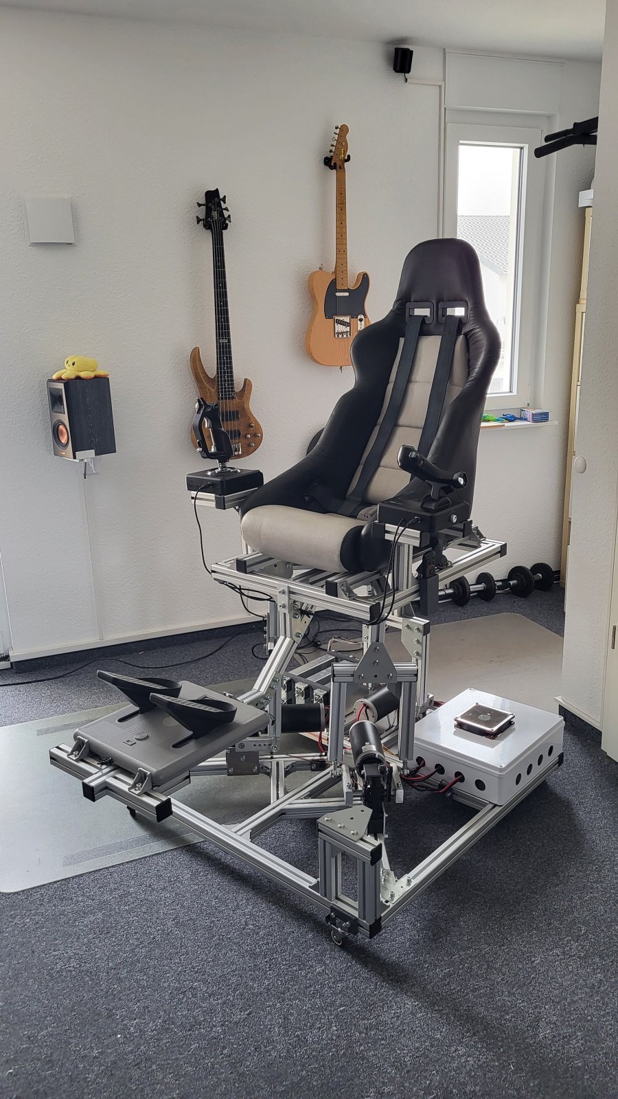

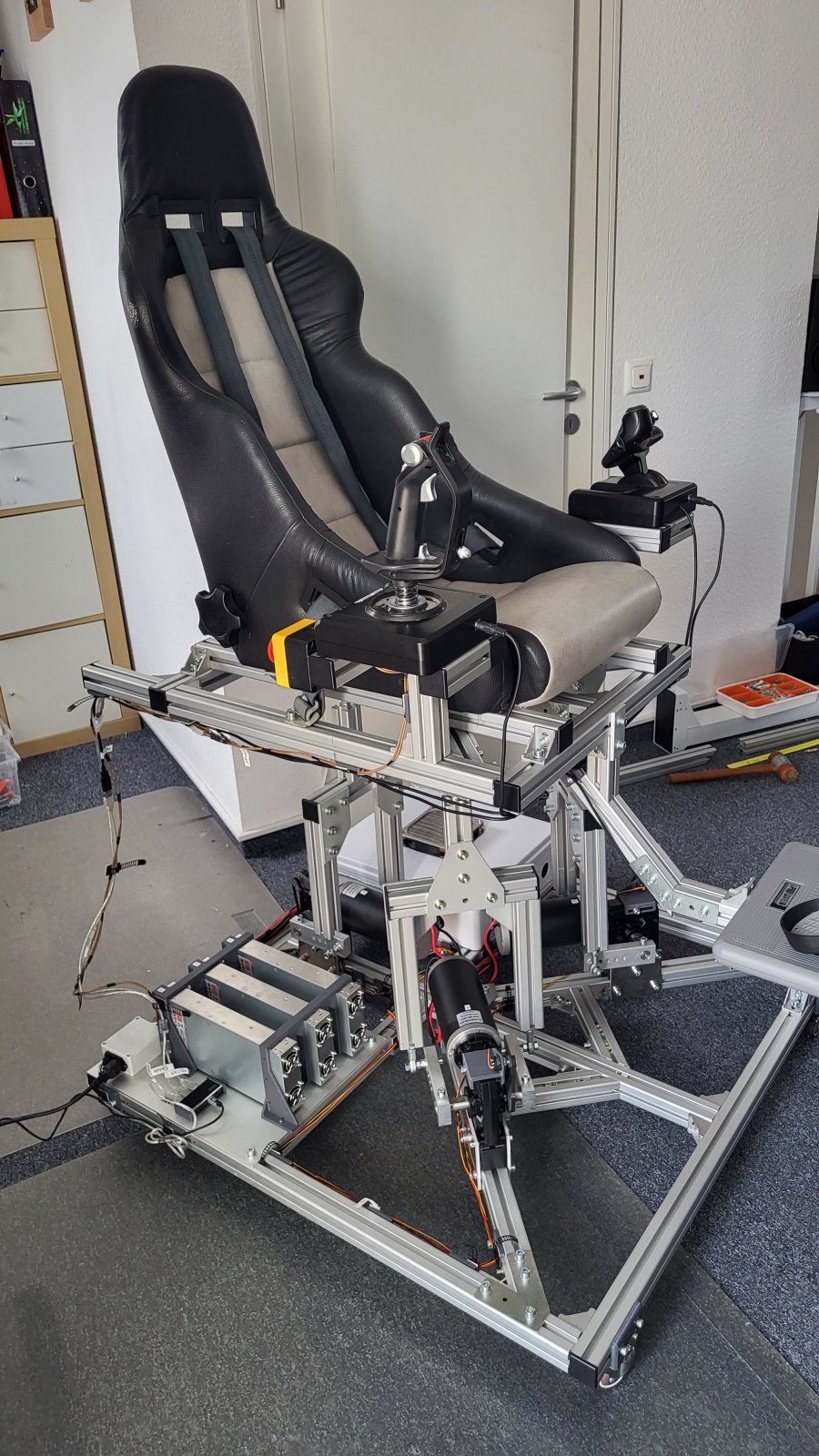

    I did my first ride on the rig in LFS! It was very exciting and felt like a huge mile stone in this project.
    Attached you find pictures of my rig and screenshots of the rudimentary motion profile that i used.
    As you can see from the motion profile pictures, I made sure that the DOFs for each axis add up to 100. This results in the individual DOF being relatively small, which is probably not optimal. Also, there is no filtering or profile tuning whatsoever, yet.
    I'll read more about motion profiles and experiment some.
    There is an issue i can't get my head around, I hope you all can help me with that: How does SimTools know how far it can move the motor levers?
    In SMC3utils I set the clipping values so that in the phyiscal world clipping will happen at +/-40 degree. I did so by variying the clipping value and physically measuring motor lever angle using the IMU in my phone.
    But the pot sensor data as well as the clipping value is not sent from the Arduino to SimTools, right? So where does the "translation" happen of SimTools saying "move axis 1 to +80% of its maximum" to "new set point for pot sensor 1 value is 122" in arduino? Or in other words: how do I make sure 100% Axis value in SimTools actually uses the full available angular range on the motor?
    I haven't really solved the issue with my shunts burning up. Still working on that. For my first ride I used 90 PWMmax (so about 35% of the power of my 500w motors) and before I crash into a wall, I hit the emergency shut off switch. This worked and the motors didn't feel weak at all when I went over the grass with the car.
    After the ride I noticed that a lot of components on my rig, that used to be 90 degree to each other, were tilted now.
    The screws that mount the motor levers to the D-cut motor shafts were not tight enough. As a result the pair of levers connected to one motor wasn't parallel anymore. But I'm afraid to tighten them significantly more, because the lenght of the threads in the aluminium levers is relatively short and might get damaged. I've read that M8 screws (class 8.8) can be tightened up to 23 Nm, but in aluminium the thread lenght should be at least twice the screw's nominal diameter, so 16 mm. I didn't think about that when I designed the levers so I only have 10 mm thread lenght (I literally screwed that up :D). That's why I only used 10 Nm on the screws, which evidently is not enough. I'm going to make new levers with 20 mm thread lenght so that I can use the full 23 Nm. That's a lot of work but it seems necessary.
    Before I sat down in the rig, I noticed that the top platform had some lateral flex. The least stiff element in the flow of force seems to be the aluminium sheets holding the motors to the lower frame. They are currently 6 mm thick. I will replace them by 12 mm thick sheets and see how that goes.

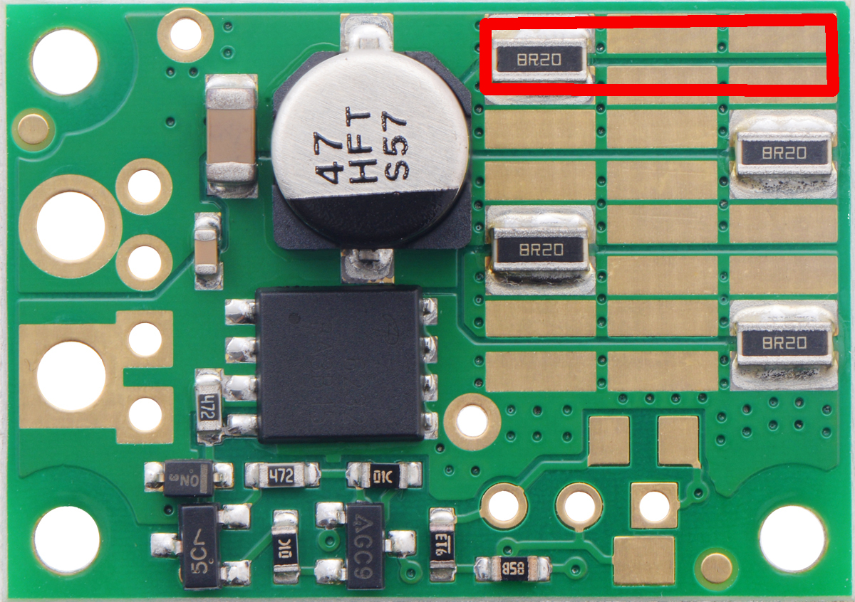

    I think i found the "optimal" parameters for my hardware. I am using modded Pololu shunt regulators type #3780.
    In order to decrease the thermal load on the board, I removed one of the SMD resistors mounted on the board (see attached picture). This also disables the remaining 3 SMD resistors (no current will go through them). I'm not sure if this is absolutely nessccary, but after seeing a couple of regulators burn up, I wanted to make sure.
    Then I added a 4 Ohm 100 W resistor to the regulator (there are special points on the board to connect the external resistor to).
    I also needed to add a 200k trim potentiometer to manually set the voltage where the shunt regulator starts sinking current to 26,4 V. The Pololu support suggested temporarily using a 500 Ohm current limiting resistor for this procedure, which I did.
    All this enables me to use PWMmax 190 without adverse side effects. The FET on the regulator stays cool to the touch while the resistor gets a little to hot to be comfortable to touch for extended periods of time. I'll put a fan over the load resistors of the shunt regulators and I guess it will work out.
    At PWMmax 200 the over voltage protection kicks in when using the square motion profile in SMC3utils.
    If I use 5 Ohm I can only go up to PWMmax 160. At 170 the OVP kicks in if I use square motion profile.
    And if I use 3 Ohm the FET on the regulator gets way too hot to touch very fast. I don't remember the PWMmax i used but it was way below 190.
    So 4 Ohm seems to be the optimum for my setup.

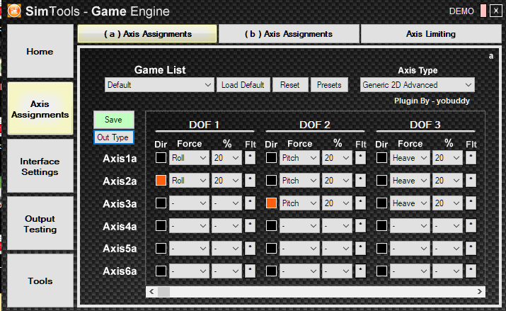

    Hm, collision detection could work. It seems to be a feature of Simtools v3 beta. Being new to this whole motion simulator thing, I hesitated to use a beta version and went with SimTools v2.

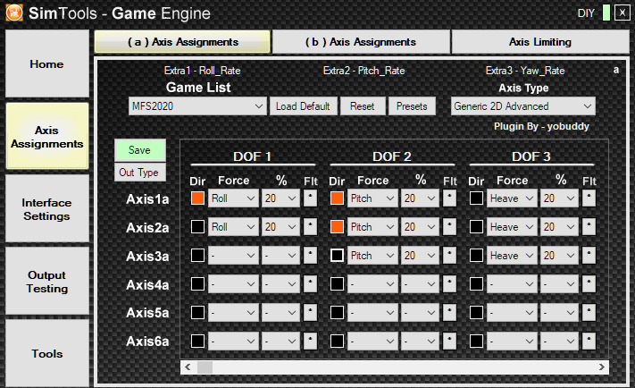

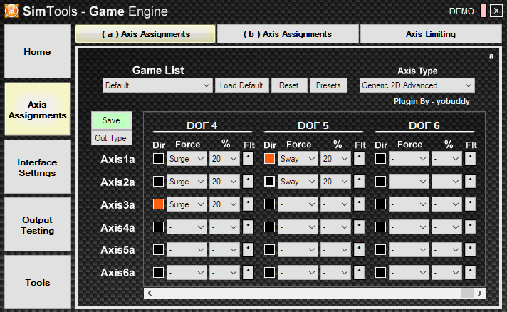

    I finished strenghtening the parts of the rig that were not stiff enough before and did another test today. It was the first time I tried Microsoft Flight Simulator 2020. I used the axis assignment posted in the attached picture "axis_assignment_1". It worked in principle, but roll and pitch were inverted.

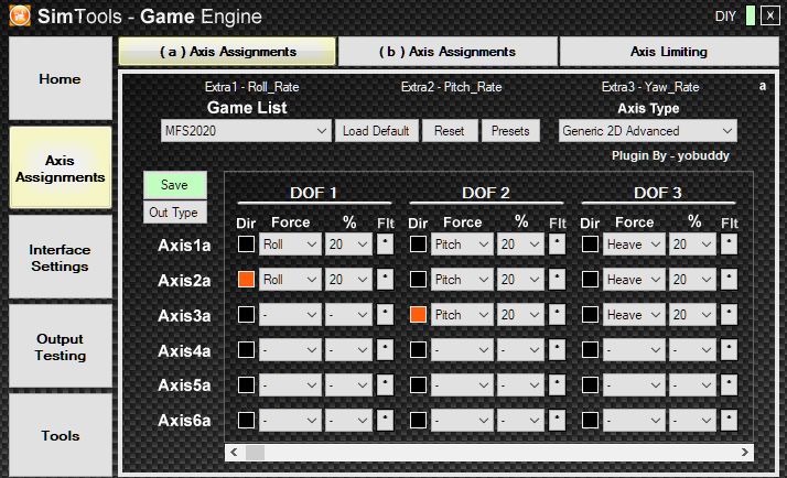

    I closed MSFS and inverted the axis assignments, so that it looked like in the attached picture "axis_assignment_2". I hit the save button and started MSFS again. But roll and pitch were still inverted. I dont get it.

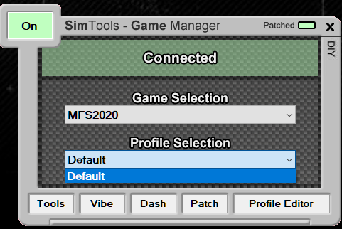

    As MSFS takes quite a long time to load, I wanted to experiment with output testing. But I don't get which game's axis assignment is used for that. The "default" one? Is it possible to change that?
    Could it be that my MSFS is using my "default" axis assingments? That would explain why it doesn't react to me inverting roll and pitch axis assignments. I also attached a Game Manager screenshot, which shows the "default" profile is selected. But there are no other profiles I could choose.
    I have a feeling that this "default" profile in Game Manager is something different from the "default" game axis assignment in Game Engine. This is a confusing naming pattern i must say.
    Could somebody help me invert roll and pitch for MSFS? I'd also like to understand why it didn't work the way i tried. It seems like i have some fundamental misunderstanding.

    Just so you know SimTools v3 Beta is edging towards release and you can install v2 and v3 on the same PC, with the same license, so don't be afraid to try v3.
    In either case first grab a copy of the SimTools manual and keep it handy for reference -
    v2: https://www.xsimulator.net/community/faq/rtfm-start-with-the-official-simtools-documentation.117/
    v3: https://simtools.us/wp-content/uploads/2024/02/SimTools-v3.pdf
    Then see the motion profile tuning tips in the FAQs: https://www.xsimulator.net/community/faq/steps-to-create-a-motion-profile.228/
    Make sure the axis move as expected, doing one axis at a time: https://www.xsimulator.net/community/faq/which-way-to-set-simtool-axis-movements.230/
    The Dir being checked orange or not determines which way each axis moves.
    The Profiles in Game Manager are different from Axis Assignments. The Axis Assignments provide global axis allocations for a particular game, the TC provides a base tuning as to how the rig responds in that game, while the Game Manage Profile lets you tune variations of the for a particular car or track.

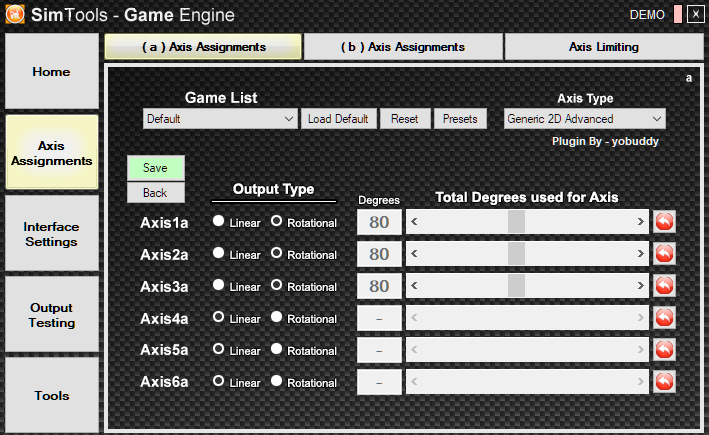

    As I mentioned the 'Default' profile in Game Manager is different from the Default profile in Axis Assignments.
    The Axis Assignments 'Default' is what is used by Ouput Testing, while the Default in Game Manager provides the global axis allocations for a particular game, the TC provides a base tuning as to how the rig responds in that game, while the Game Manage Profile lets you tune variations of the for a particular car or track.
