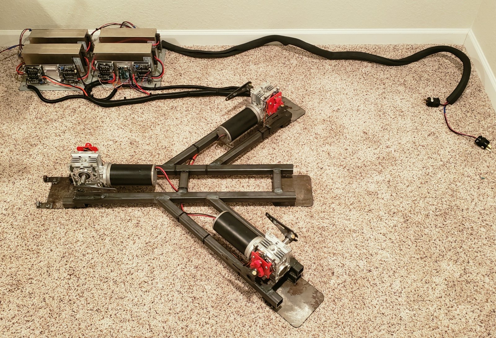

    Hey all! I purchased a motion simulator off another forum user here. (See previous build thread https://www.xsimulator.net/community/threads/my-3dof-motion-simulator.14908/ ) I got it all wired up and working in SMC3 utility. Clip and limit set to 225 and Kp 400. Moved PWMmax so green,blue and gray lines all match up. Using manual settings on the left and moving the blue line all motors move as intended. Am I ready to move to simtools and start testing? Do I keep those settings the same in SMC3 while testing in simtools? Currently waiting on new crank arms to arrive because the ones that were originally fabricated for this project were too long and blew out a motor. Can I do some test without the top platform attached while I wait? Thanks!
    Pic of bottom platform with motors attached and wired.
    Top platform
    21,581
    151,100Coins
    Yes you can start testing in SimTools once SMC3 is properly configured and working as expected and yes you can do initial testing without the top frame attached.
    SMC3 sets the Arduino configuration, once that is done shut it down and don't run SMC3 at the same time as SimTools, as that will cause a port conflict.

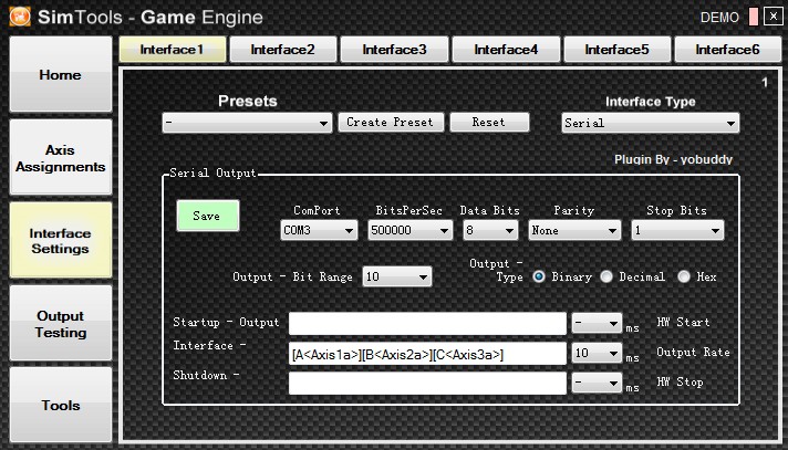

    This is how to configure the interface settings in SimTools for your 3DOF:

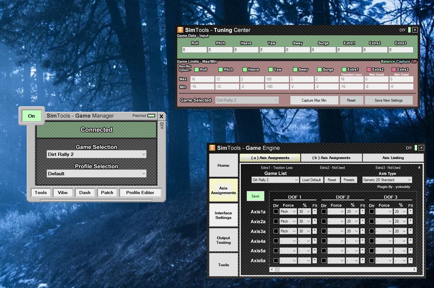

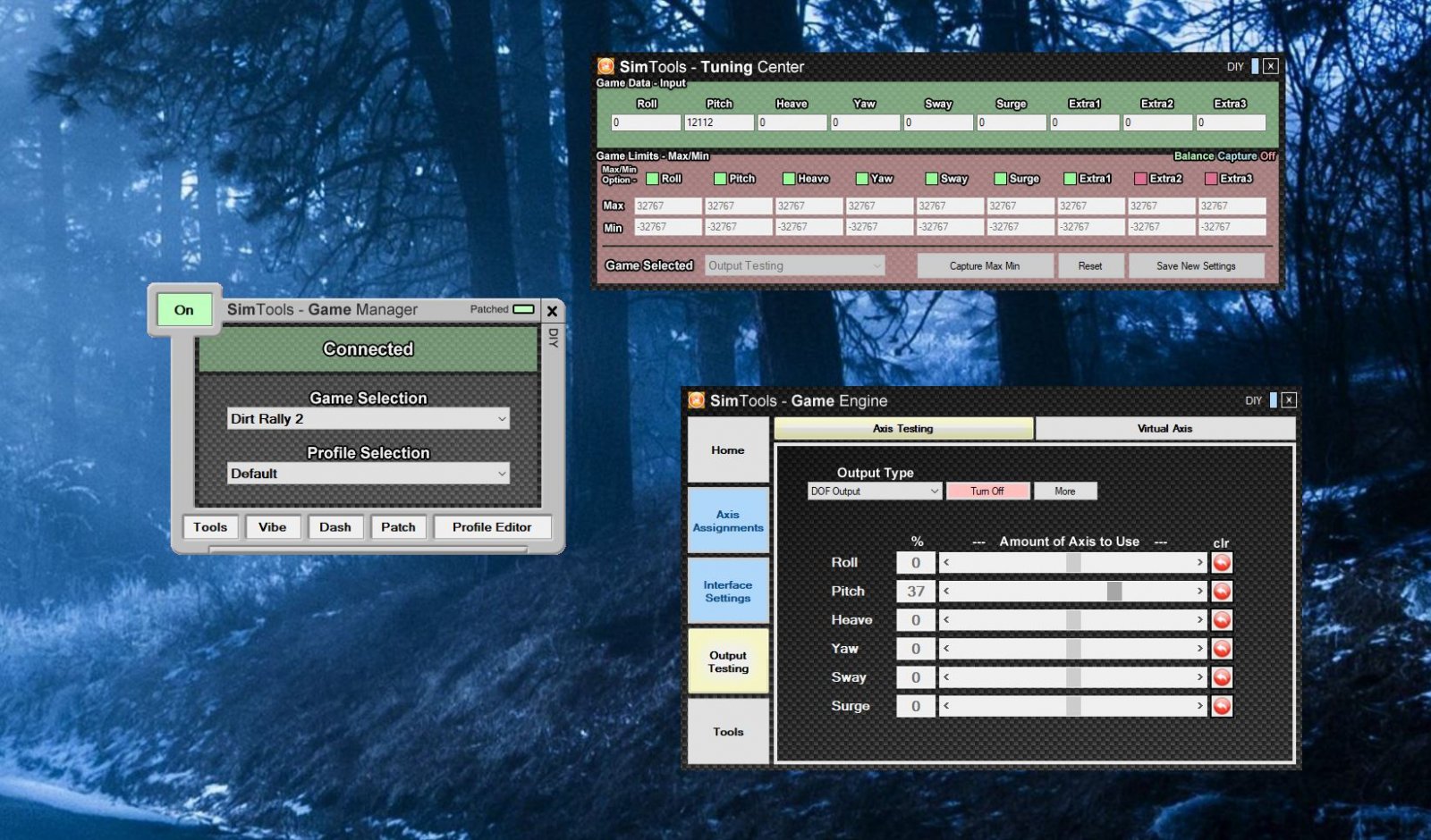

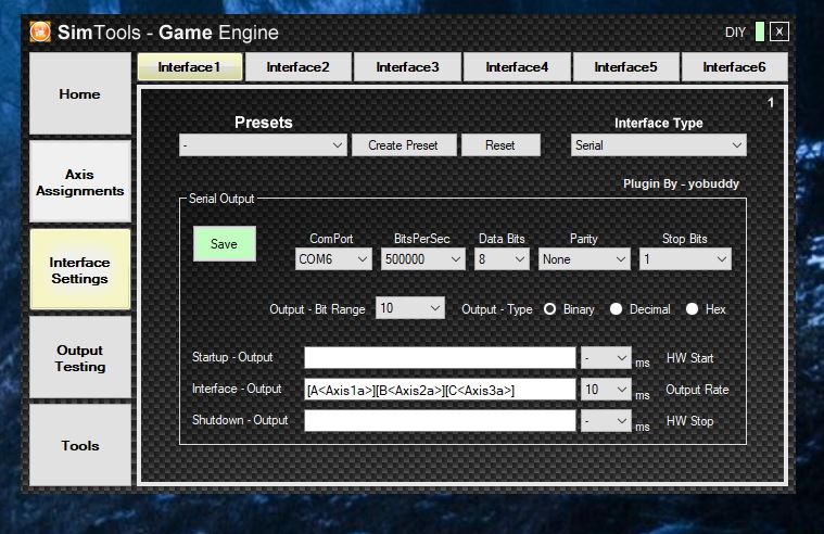

    I'm having a lot of trouble with simtools output testing. No matter what I do my motors won't move. I must be missing some small detail. I followed the guide/documentation above and nothing.
    Interface settings are good.
    Did a run on Dirt Rally 2 and recorded then modded the min/maxs
    Testing 1 axis at a time but when I turn on DOF output the game selected in the tuning center automatically switches to default and very high values appear
    What the hell am I doing wrong. About to pull my hair out. Just spent 6 out trying everything. Reading documentation, forum posts, searching YouTube for setup videos and still no progress. Xsimulator you're my only hope...:sos

    WOW this is what I get for pulling an all nighter working on my sim rig... I forgot to plug in the motors... my brain is fried but making progress lol. Think ill take a break from the computer and start sketching out yaw and monitor mount fabrication design ideas. Thanks for the quick replies though. You guys rock!

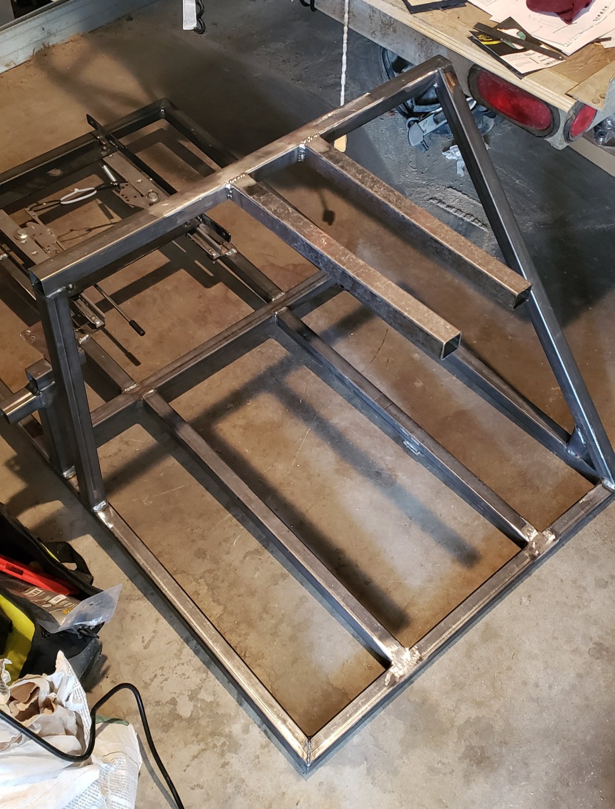

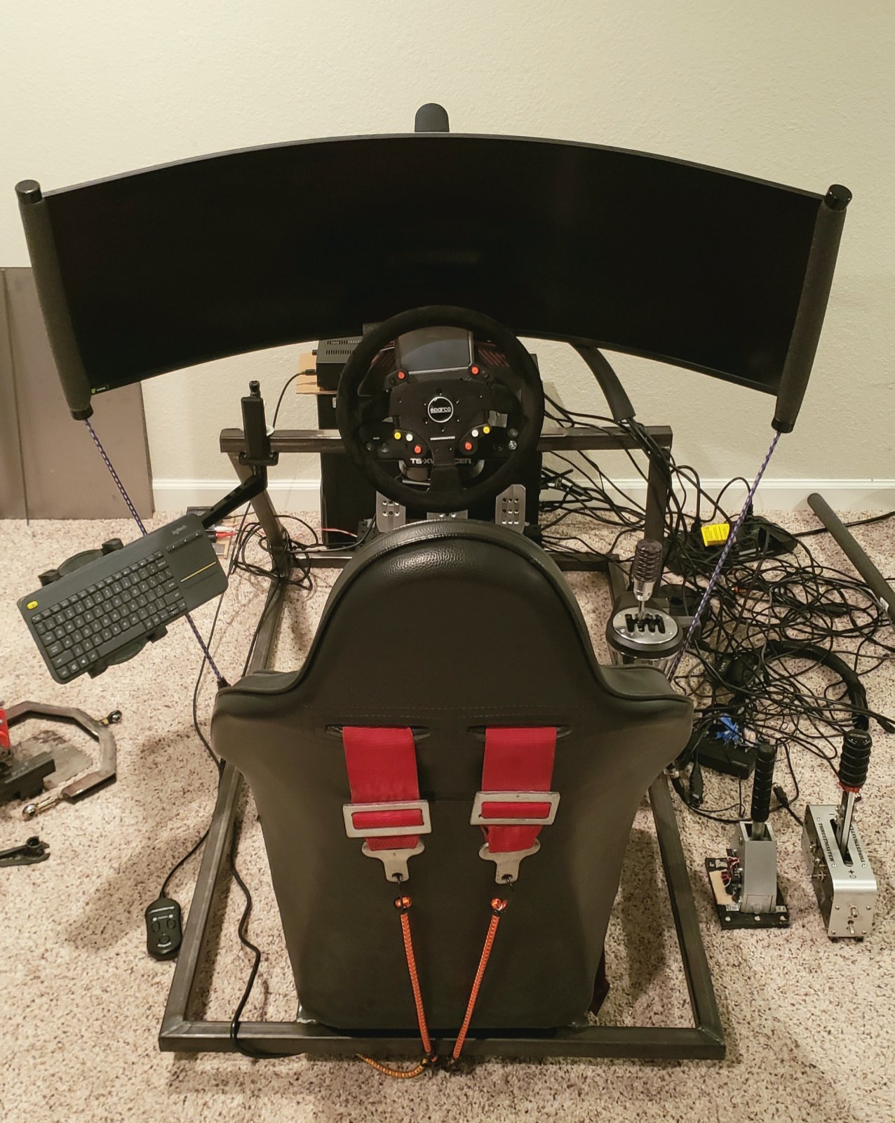

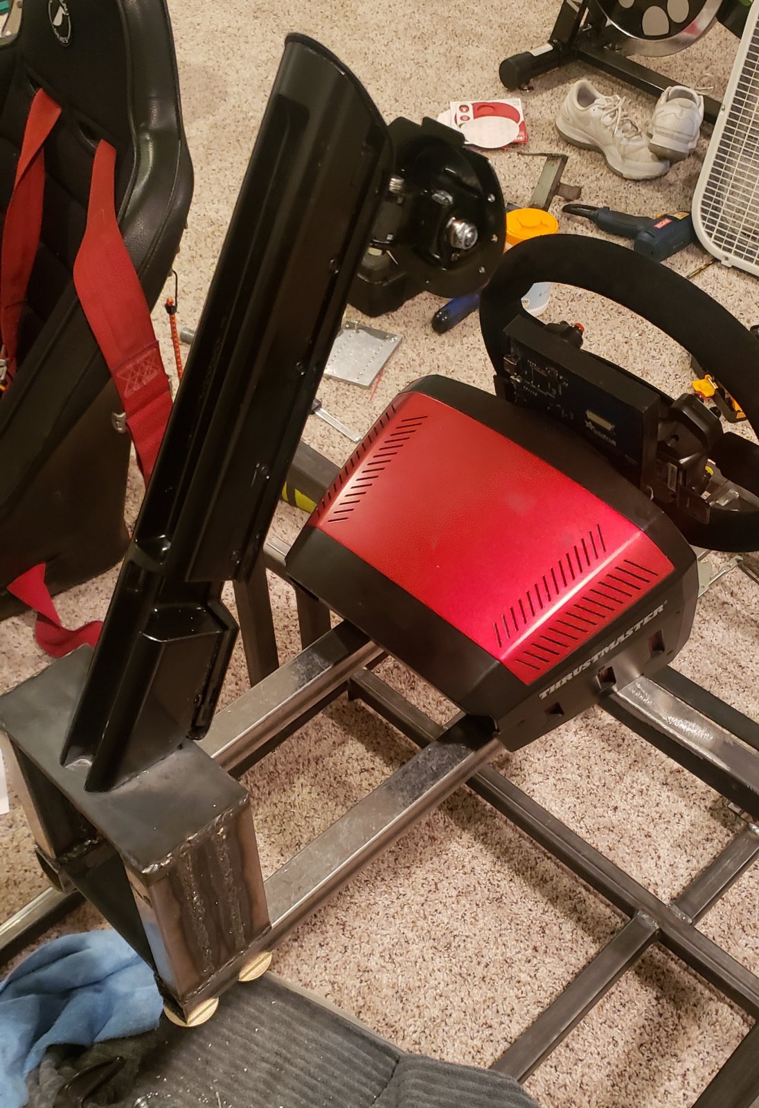

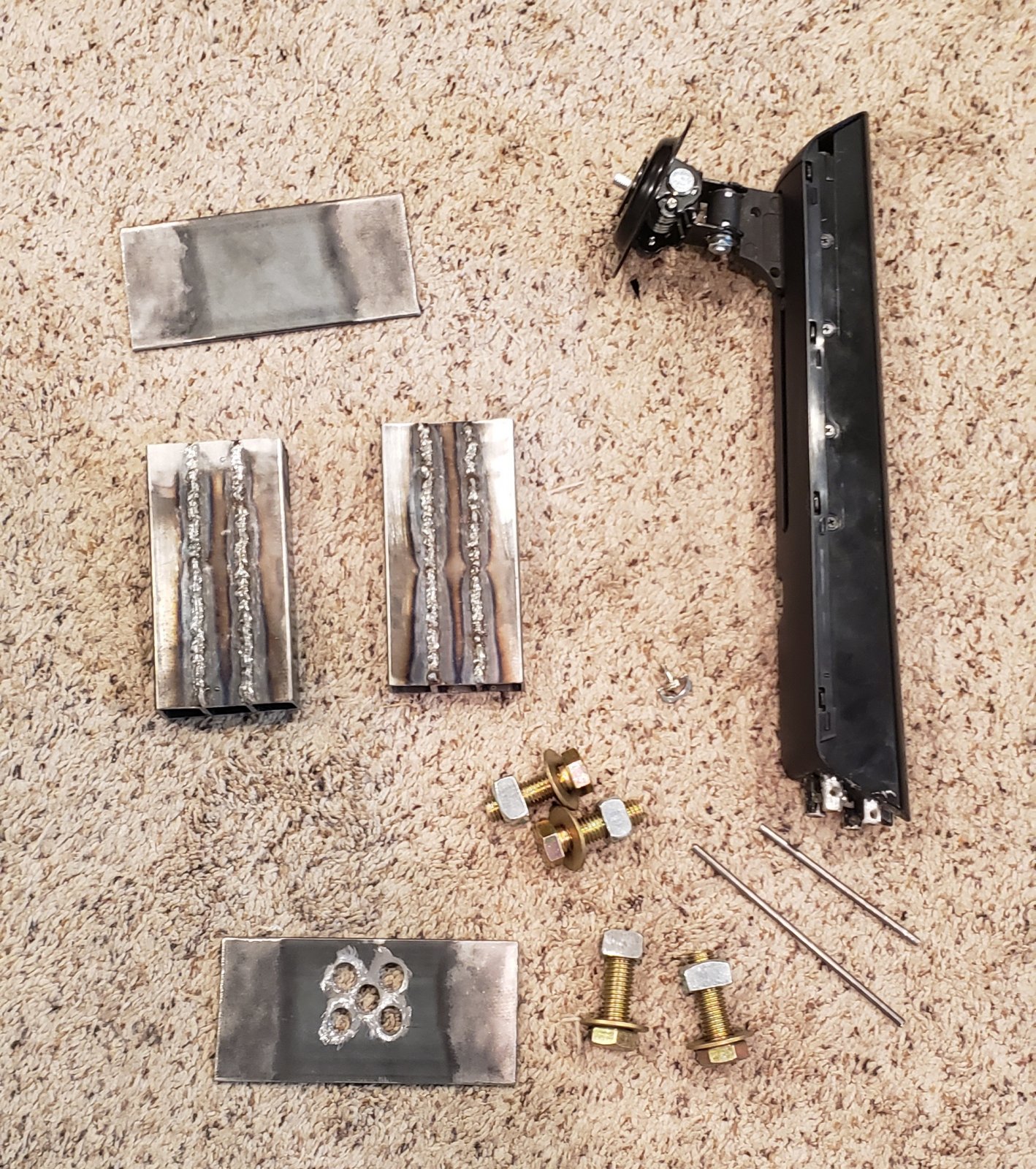

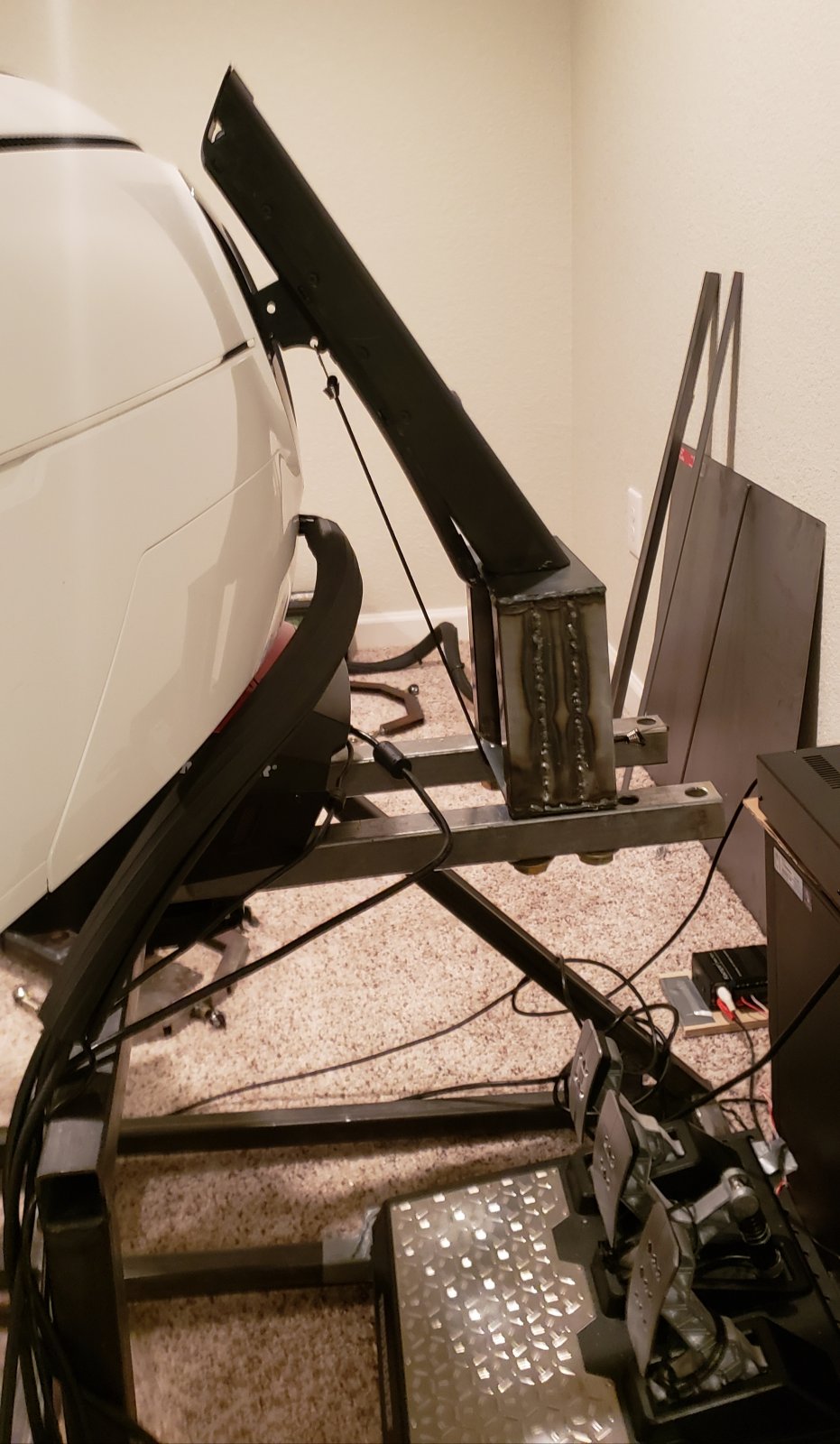

    Still waiting on the new motor cranks so I've been working on the upper part of the platform. Got the pedal mount and monitor mount welded on. Still need to add a support beam that attaches to the frame from the back of the monitor mount and mounts for my sequential shifter and ebreak but getting pretty close.
