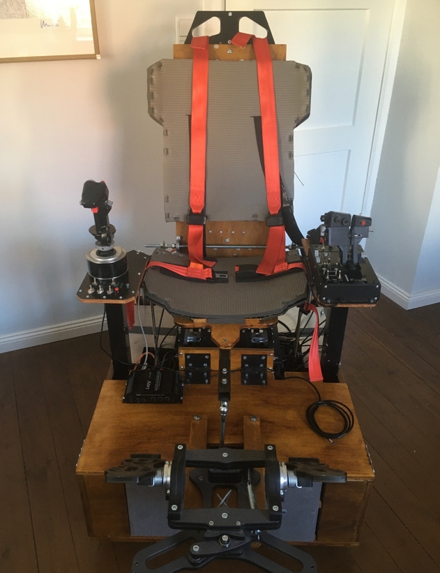

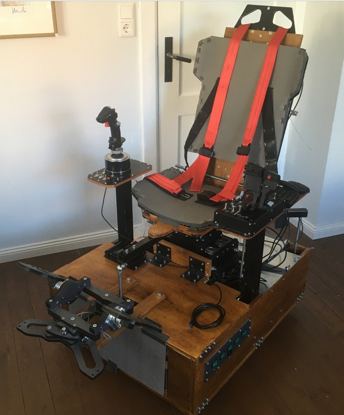

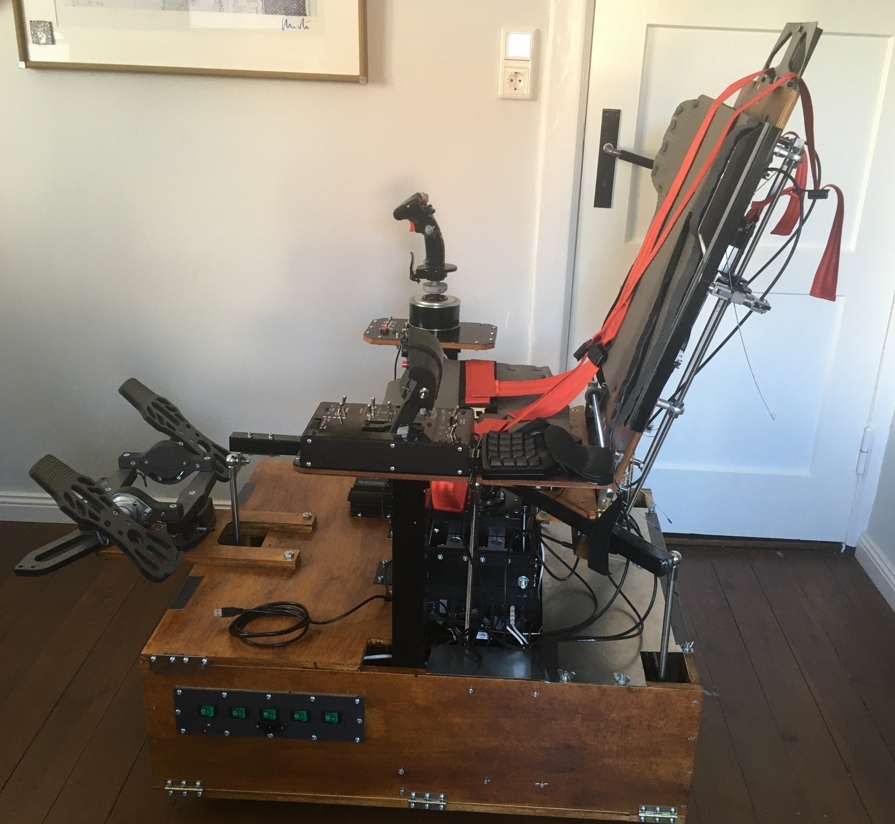

    At last: Almost 8 months after disassembling my second rig, I have finally finished my third one:
    My first two rigs were 2 DOF motion platforms that I documented in my first and second build thread.
    Now I wanted to add ‚heave‘ as third DOF and also change the overall concept compared to my previous builds: While rig #1 and #2 were mainly motion platforms with some G-Seat add-ons, my current build is more a G-Seat with integrated motion.
    The seat motion (roll, pitch, heave) is meant for letting the body move into the same direction into which it would also move in a real vehicle. The G-Seat components are meant for applying additional pressure to certain body parts in order to increase the sensation of the force(s).
    In this way I am following the approach of Bergison with his Motion Integrated G-Seat:
    https://bergisons.simpit.info/motion-integrated-g-seat
    My rig is driven by six second-hand wheelchair motors that are controlled with Arduino/Sabertooth 2x32 combinations and the famous SPS motor driver sketch, formally known as SMC3-SPS.

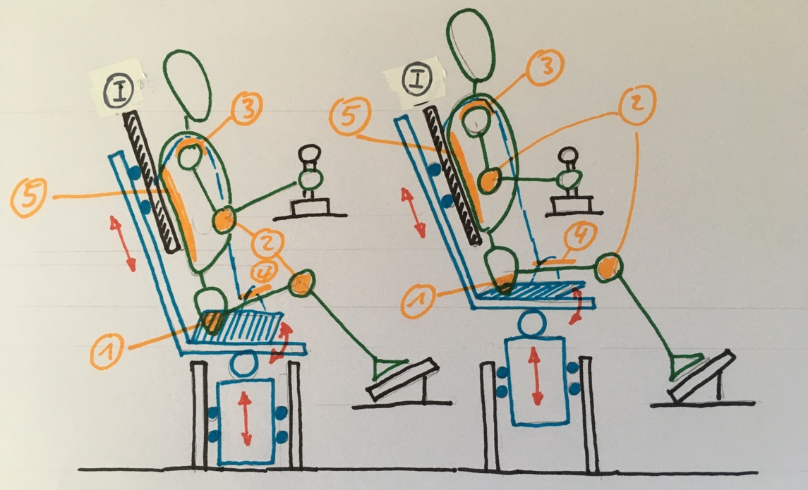

    My heave system creates five different sensations of the heave force, which are illustrated in the sketch below. (Since I never learnt to use any CAD software, I drew the sketch on this ancient stuff that the older ones among us may know as ‚paper‘.)
    Here is an explanation of the heave sensations:
    Positive heave force (in real vehicles increasing the sensed weight of the body):
    (1) The G-Seat paddles on the seat base increase pressure to the thighs from below.
    (2) The entire seat moves down, so that the knee and ellbow joints bend a little bit, because the foot rest as well as the HOTAS are fixed and don’t move together with the seat. This shall increase the sensation of the body sinking into the seat.
    (5) The backrest moves into the opposite direction as the seat (i.e. upwards), causing friction against the back of the body and in this way again simulating the sinking into the seat.​
    Negative heave force (in real vehicles reducing the sensed weight of the body):
    (1) The G-Seat paddles on the seat base reduce their pressure on the thighs.
    (2) The knee and ellbow joints bend into the other direction as with positive heave force.
    (3) An additional inner shoulder harness applies pressure on the shoulders from above, as if the body would be lifted upwards due to its reduced weight.
    (4) The harness belt around the thighs applies pressure from above, causing the same effect as (3).
    (5) The backrest again moves opposite to the seat, causing friction at the back of the body. This time into the downwards direction, as if the body is lifted upwards out of the seat.​

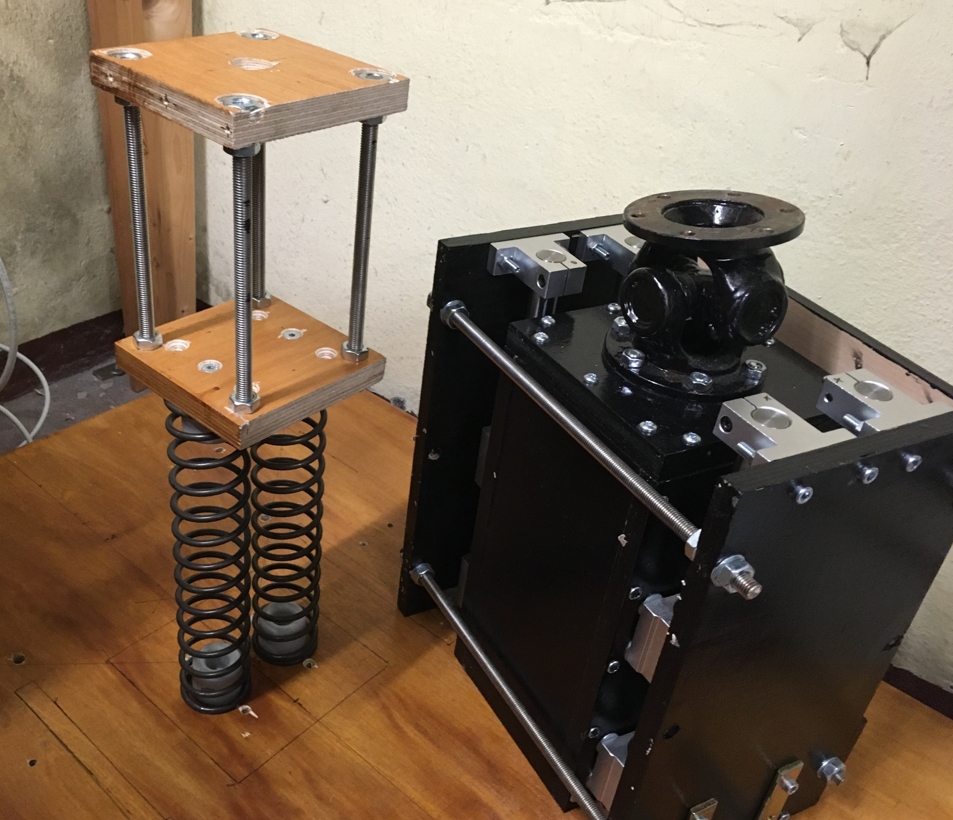

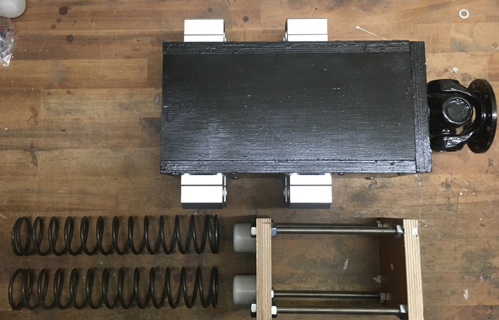

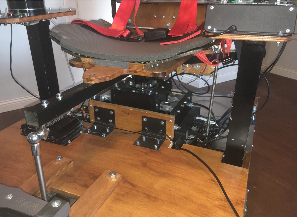

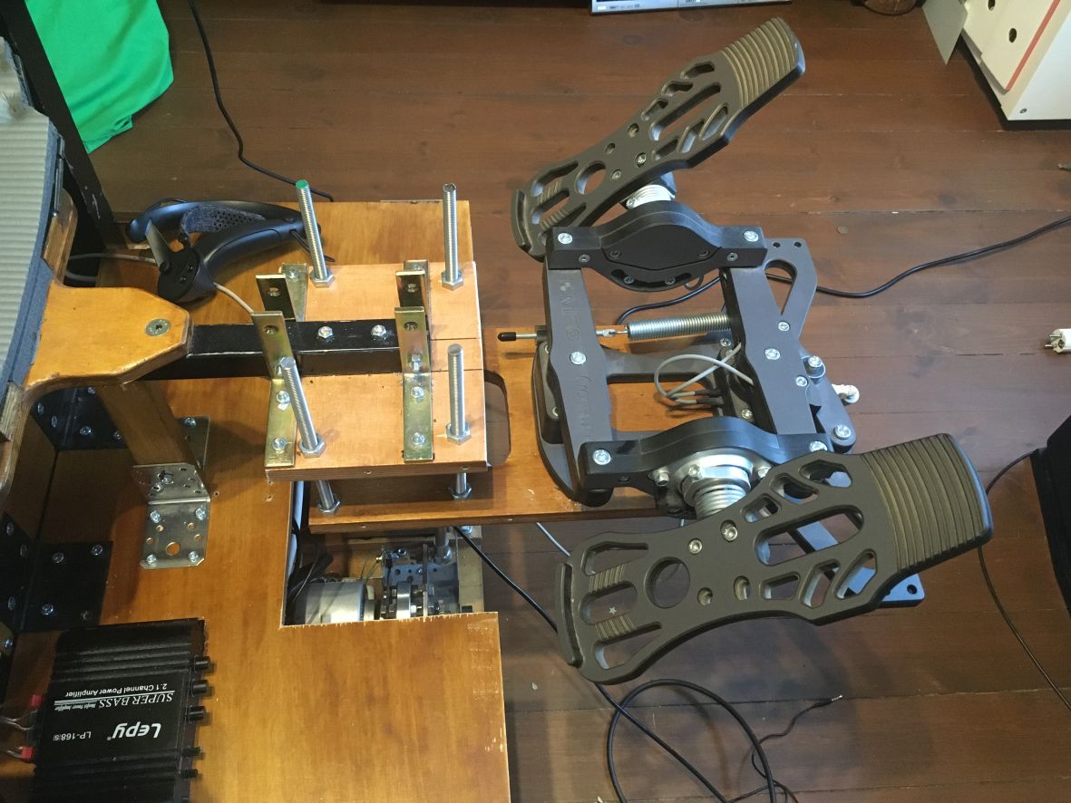

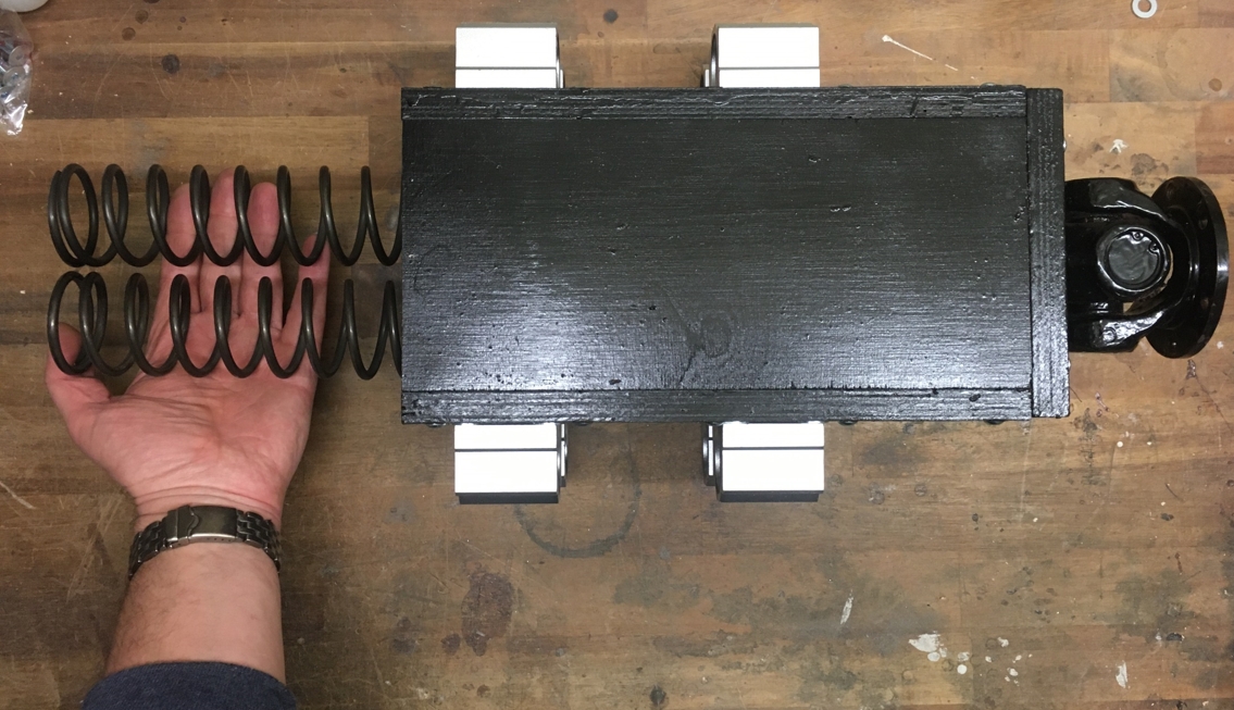

    The seat is mounted on a u-joint, which sits on top of a heave assist block shown in the pictures below.
    This purpose of this block is to stabilize the heave movement and to unburden the motors via a spring. (The pictures still show 2 springs, but at the end I only put one inside.) Thanks to @Tim McGuire from whom I took the idea of this heave assist block. Tim's construction is much more sophisticated than mine, because it allows to configure the spring pressure on the fly, while I would have to disassemble most of my rig. Besides it is much more elegant in design.

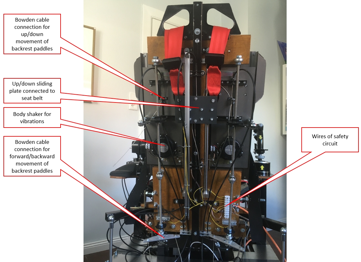

    As shown in the picture below, the heave assist block also has connection points for two bowden cables (1). Their counter parts are on the backrest paddles (2) and cause them to slide up and down in the opposite direction as the seat. That means, when the seat moves upwards, the backrest paddles move downwards, and vice versa.
    So in fact, the backrest paddles only move relative to the seat, while their ‚absolute‘ position remains fix. (See the video at the end of this post, starting at timepoint 01:00 minutes).
    I have already explained the purpose of this movement with the sketch above.

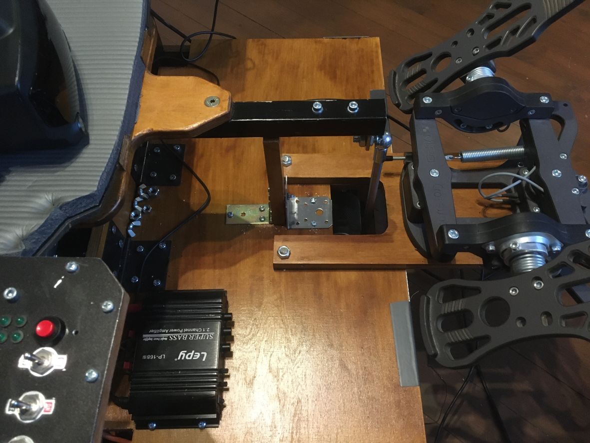

    The next picture shows the heave assist block integrated into the rig:

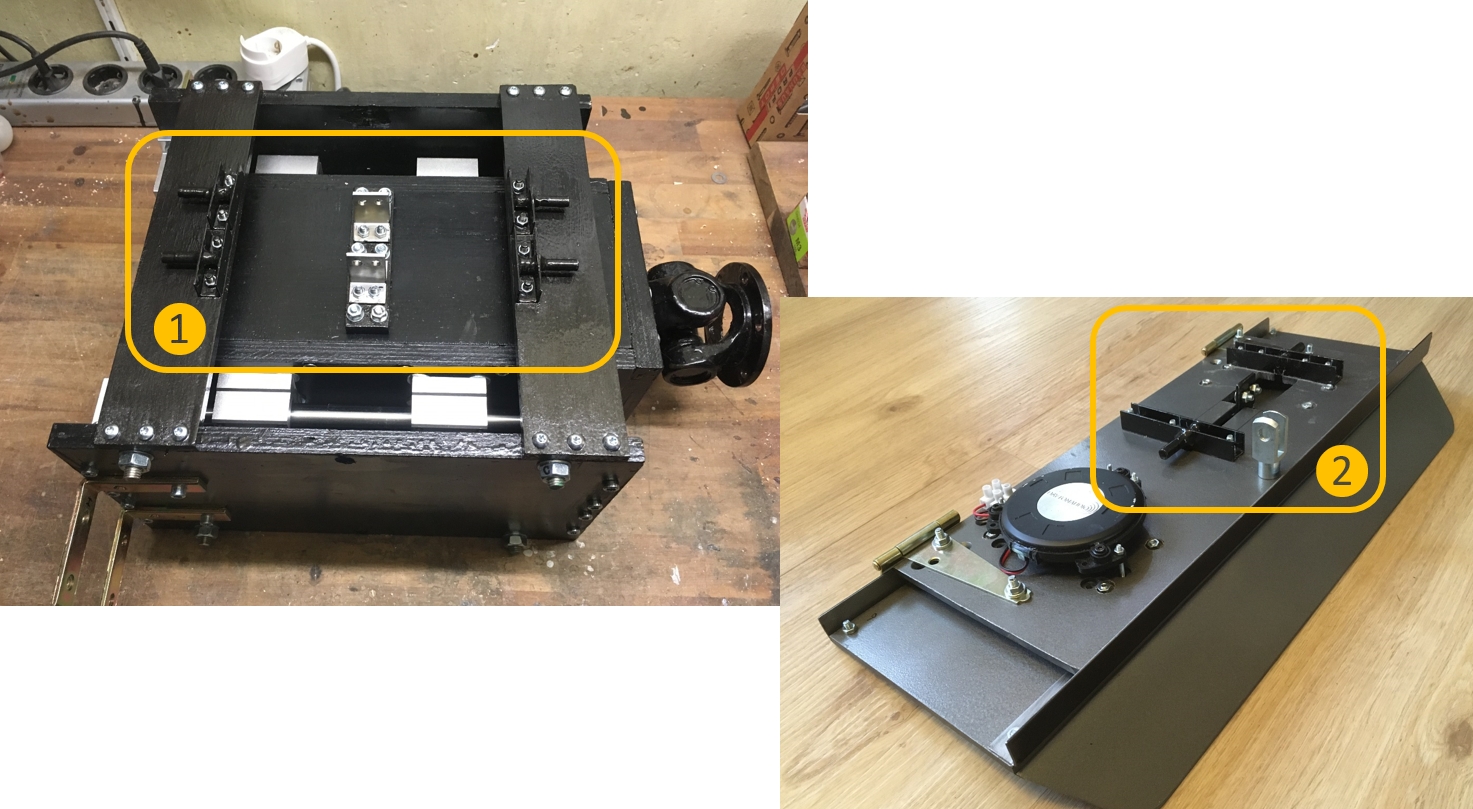

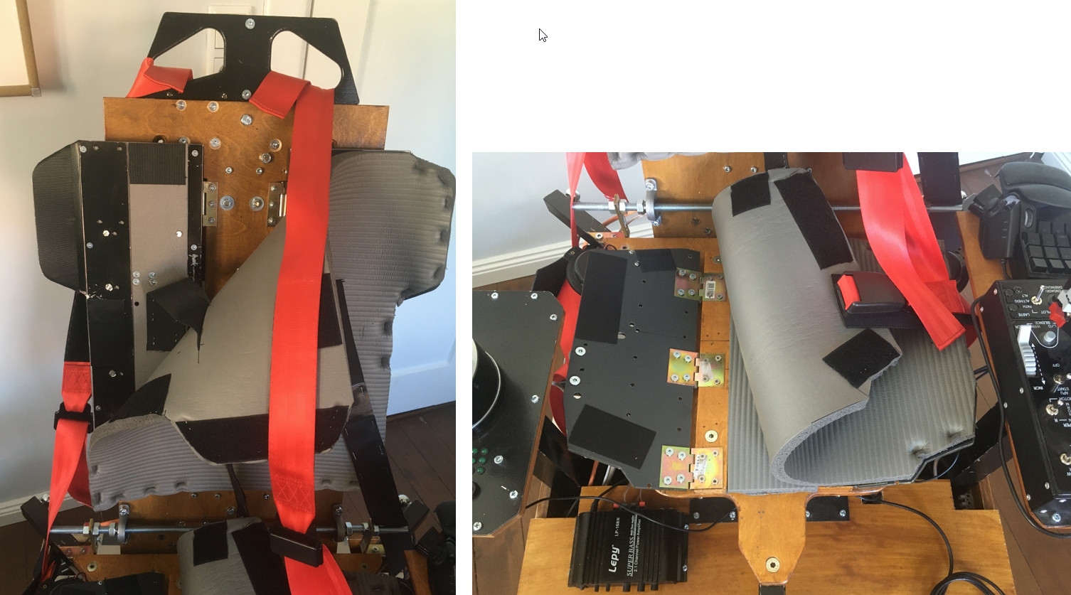

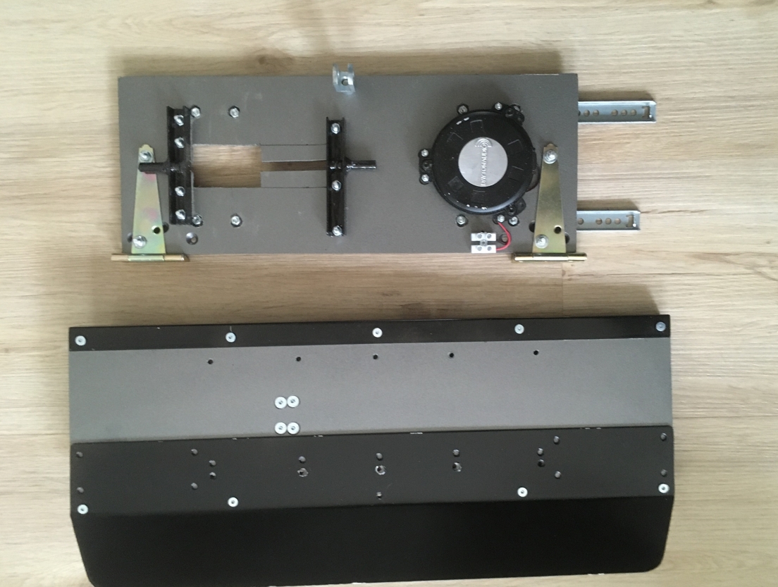

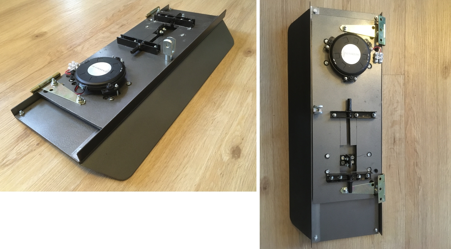

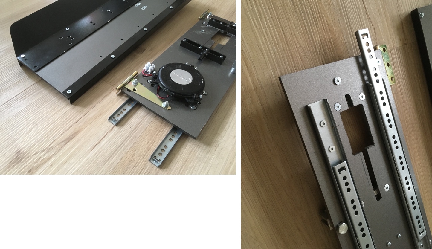

    Here are some pictures of the backrest paddle construction. The slider rails are actually meant for drawers. I got them from the local DIY market.
    008 Backrest paddles in parts.jpg 009 Backrest paddles in two halfs.jpg 010 Backrest paddles in two halfs.jpg 011 Backrest paddles assembled.jpg

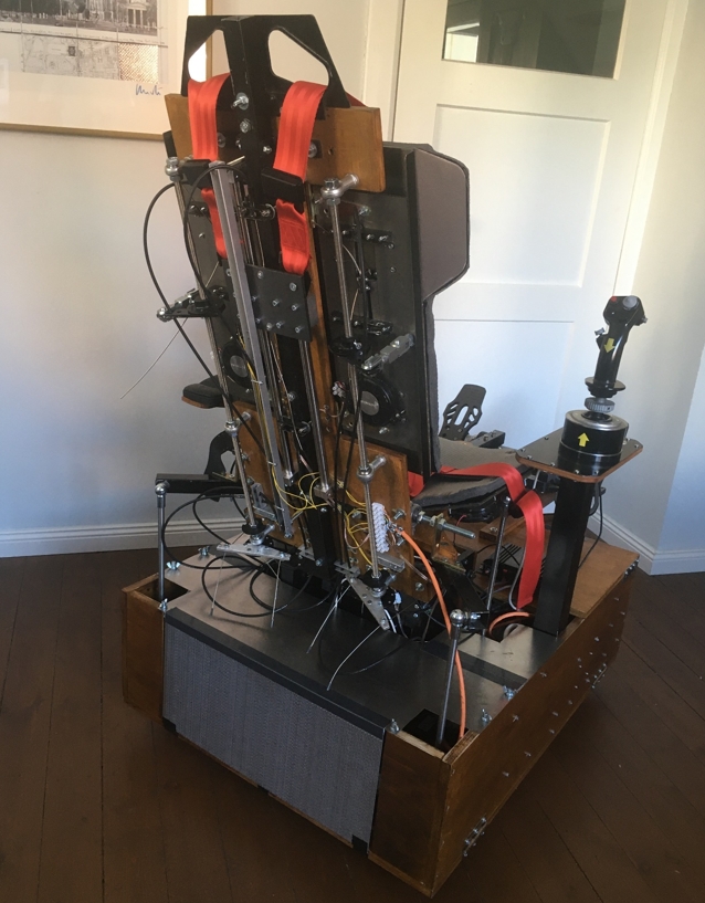

    The backrest itself is the most complicated part of the rig, and with around 16 kg also a quite heavy one. Here is an overview picture:

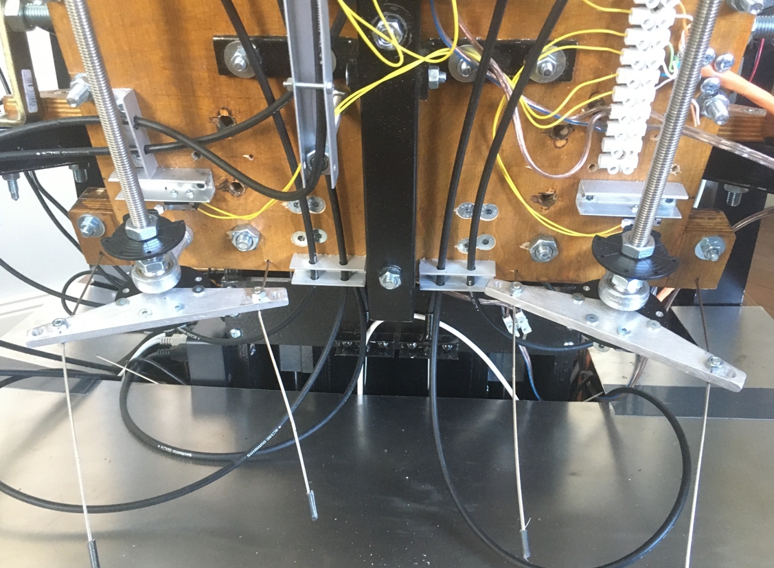

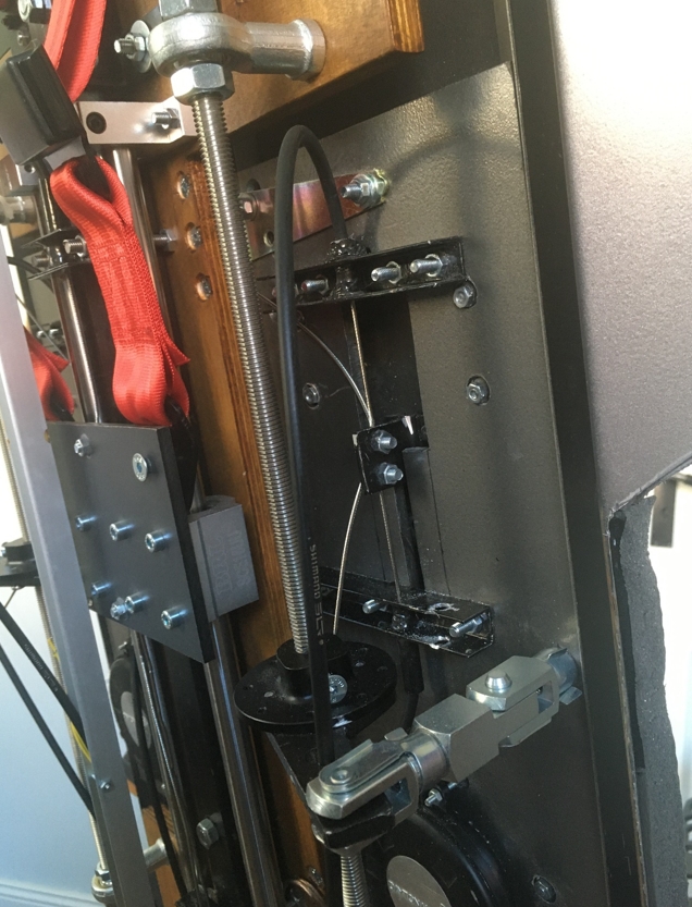

    The forward/backward movement of the backrest paddles is done via bowden cables. Credit to @SeatTime for introducing them in this forum years ago.
    The same bowden cable approach is used for the up/down movement of the paddes (already explained above) and the harness tensioner.

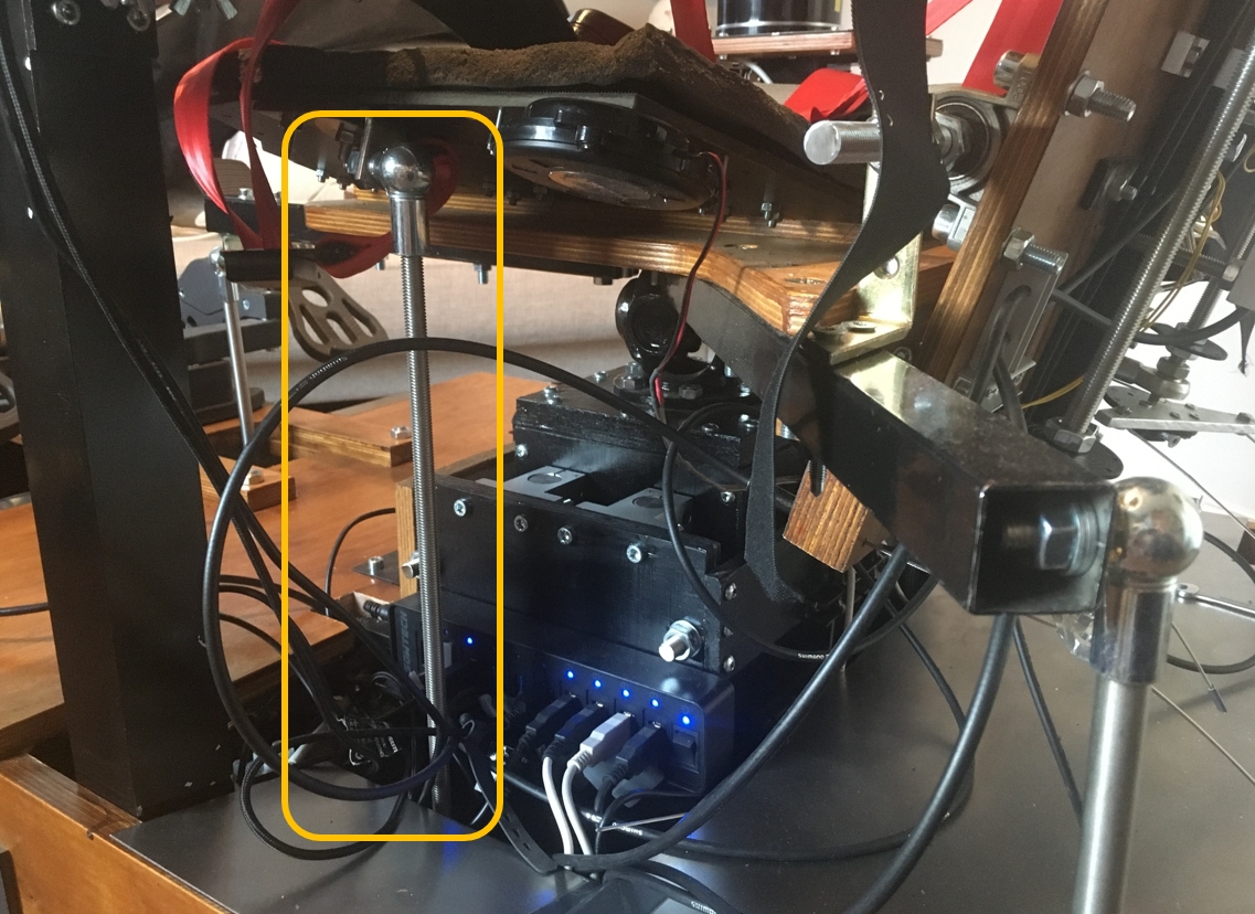

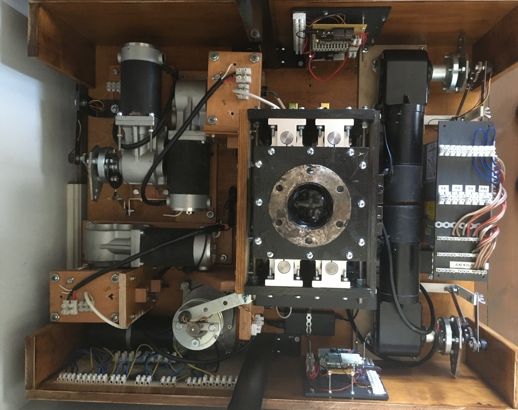

    The paddles on the seat base don’t have their own motors. Instead they are connected with steel rods to the base of the rig. In this way, they ‚automatically‘ move up/down when the 3DOF motors perform heave or roll movements. This movement also tensions/losens the seat belt around the thighs.

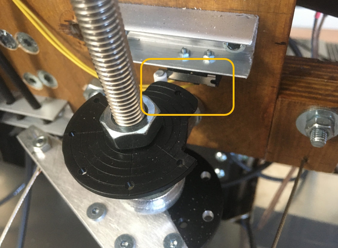

    I have added a safety circuit, consisting of one little safety switch per motor. If a motor moves out of its intended range, the switch is triggered and immediately shuts down the power. I will go into more detail in a next post.

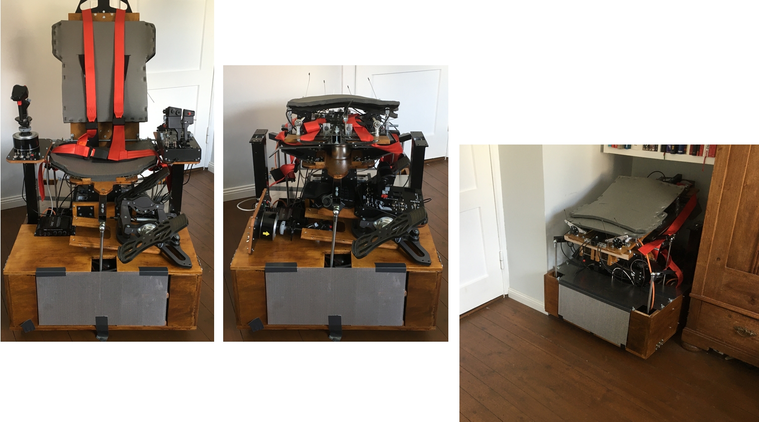

    And to fulfill at least the minimal set of WAF requirements, the backrest can be folded down, so that the rig can be easily stored in a corner of the room.
    As mentioned above, I will add more details in upcoming posts. Then I will also open up the covers and show the intestines of my build.
    Now I would like to conclude with a little demonstration video. Have fun.

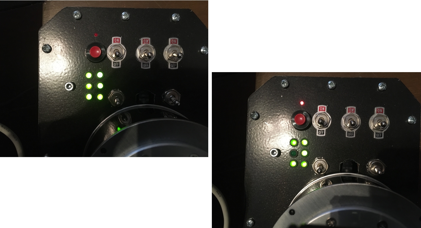

    My Safety Circuit
    With my last rig it happened two or three times that one of the motors moved outside of its intended range. Once this caused some damage, and another time I strapped my fingers in a bowden cable loop during an early test run in which I had to tighten the cable with my hand.
    For this reason I have now added a safety circuit that shuts down the main power as soon as one of the six wheelchair motors moves farther than intended.
    Here is how this circuit works:

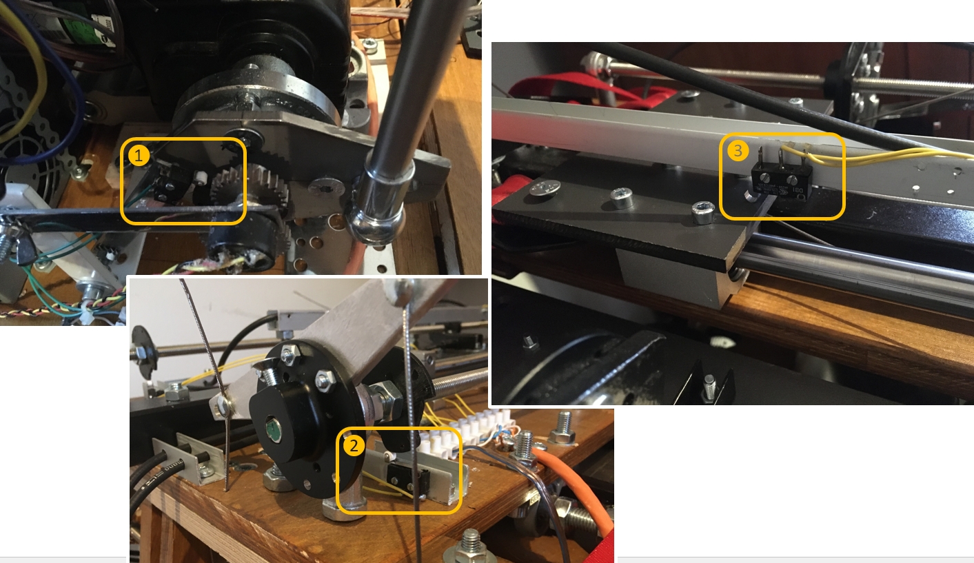

    I added a micro switch to each of the motors as shown in the picture below.
    The three main motors lifting/tilting the seat have the switches directly at their gear box axis (see #1 in the picture).
    The other motors, which are responsible for moving the backrest paddles and the harness tensioner, have their switches at the backrest (see #2 and #3 in the picture).
    The state (closed/open) of the six switches is permanently read by an Arduino Mega. (An Uno would also have done the job, but I only had a Mega lying around.)
    The 'closed' state means that everything is fine, while the 'open' state tells the Arduino that a motor has rotated too far.
    As soon as one switch is in 'open' state, the Arduino shuts down the main power, which is provided by two 12V PSUs connected in series. This shutdown is done via two relais.
    Besides, the Arduino permanently shows me the states of all switches via six green and one red LED:
    If a green LED is on, the corresponding switch is in closed state. As soon as the switch changes to 'open', the corresponding LED turns off. In this way, I immediately know which motor causes the problem.
    At the same time as one switch changes to 'open', the red warning LED turn on.
    The main power remains 'off' until all switches are closed again AND I have pressed the 'restart' button. (Pressing the 'restart' button while a switch is still open won't turn on the power.)

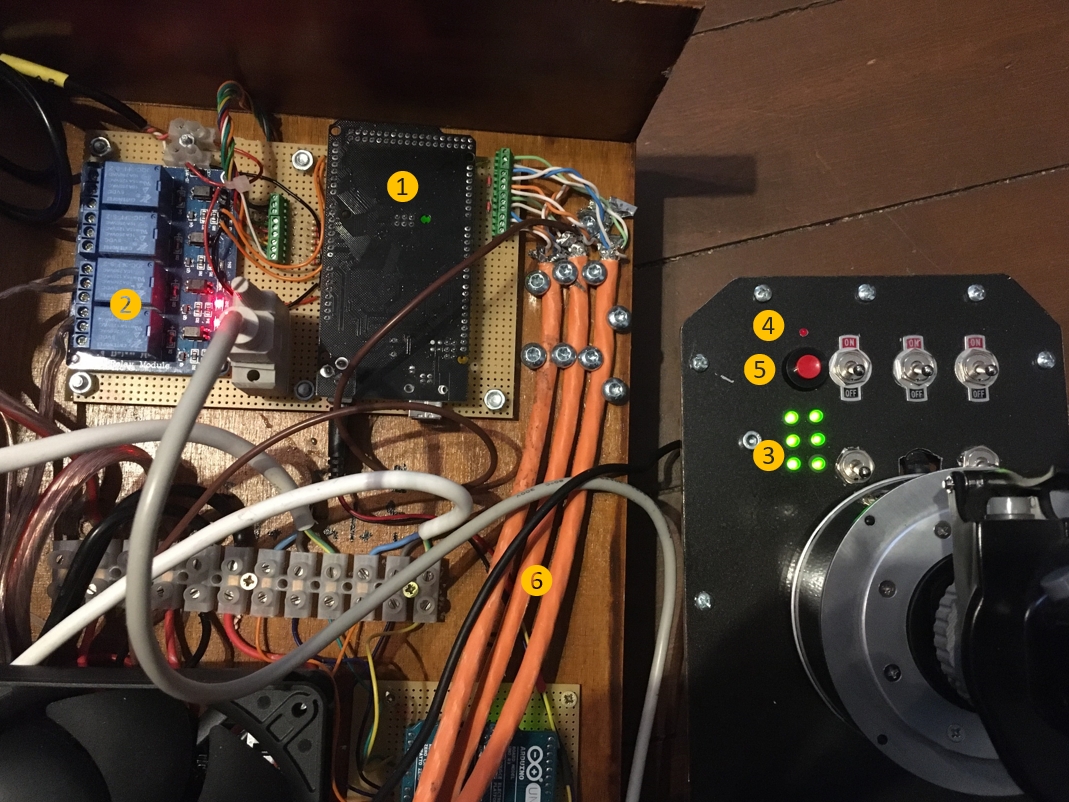

    The picture below shows the components of the safety circuit:
    • (1) Arduino Mega
    • (2) relais card (only two of the four relais are used)
    • (3) six status LEDs, one for each motor
    • (4) red warning LED
    • (5) restart button for re-powering the rig
    • (6) shielded cable going to the switches
    Here is what the status monitor looks like in normal condition and in case that Motor II is out of its movement range:

    A couple of questions.
    The paddles. Did you have these CNC cut? What is the thickness?
    The padding, is that a Yoga mat?
  7. MarkusB
    Jun 30, 2015
    552
    4,215Coins
    +597 / 2 / -0

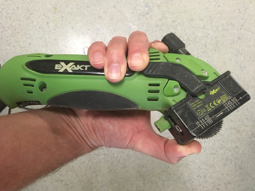

    The main parts of the paddles have a thickness of 6 mm. It is a very rigid, water-resistent, synthetic material. In the DIY market it was labeled "Baumehrzweckplatte". The English term would be something like "Multi-purpose construction plate".
    The black side parts of the paddles are made of Aluminium with a thickness of 1.5 mm.
    My set of tools is very limited, so that I don't have access to a CNC machine. Even my print-outs are limited to 2D on good old paper.
    I cut the parts with this saw:
    Yes, correct.
    The reason for this was that I don't like to feel my knee joints bend when the seat moves.
    Now especially positive heave forces feel good in a sense that I get the impression to be pressed into the seat.
    Negative heave forces are not so convincing. The seat paddles are reducing their pressure, the backrest moves down (relative to the seat), and the thigh belt tightens. However, it still does not feel like my body is lifted upwards. In the meantime I think that this can only be achieved by a rapid downward acceleration of the seat, which is what happens in real life. But in a simulator this cannot be a sustained force, because the downward movement is limited by the length of your actuators.
