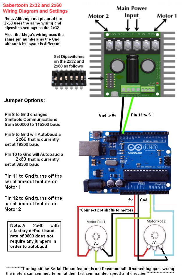

    SPS (previously SMC3-SPS) is a modified version of RufusDufus’s fantastic SMC3 sketch.
    SPS = Sabertooth Packet Serial version.
    Features:
    *Support for one Sabertooth 2x32 or one Sabertooth 2x60. (controls 2 motors only but you can use additional Arduinos to add more motors if needed).
    *Support for Mega and Uno Arduinos (uses the same sketch for both)
    *Plug and Play Sabertooth 2x60 – on a new 2x60 just set dipswitches and wire up as shown in the wiring diagram. (note: A new 2x32 also requires use of DEscribe software to set the baud rate and serial timeout feature)
    *Packet Serial Mode – uses a checksum so a Sabertooth won’t act if there are transmission errors.
    *Serial Timeout feature – a Sabertooth will shut down motors if a new position command is not received within 100ms of the last one.
    *Double Motor Resolution - twice the resolution of Simple Serial mode.
    *Soft Start Motor startup (at top of sketch look for //SET SOFTSTART SPEED const int SSloop = 8;. Increase SSloop for a slower start and decrease for a faster start)
    *Self-configuring baud rate on 2x60’s – will automatically change the baud rate of a new 2x60 from its 9600 default setting to 115200 baud. This makes the use of Describe software from Dimension Engineering as well as the need to purchase a TTL line level converter for the 2x60 Sabertooth unnecessary.
    A baud rate change to 115200 on a Sabertooth 2x60 that has been previously set to 19200 or 38400 baud can be accomplished automatically also by adding a jumper wire from ground to the appropriate pin on the Arduino (see wiring diagram)
    *Full PID motor control via the original SMC3 sketch by RufusDufus.
    ===Many thanks to @Pit for his assistance and serving as a test dummy for the cause:)===

    3. Wire up your Arduino to your Sabertooth as shown above in the wiring diagram

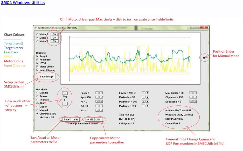

    9. Next download and run the Windows SMC3 Utility software attached below and make sure it communicates with your Arduino. Open the accompanying SMC3Utils.ini with notepad to change the comport if needed (see image below)
    10. Set Fpid to / 1. (If you experience motor twitching or other issues then try increasing it)
    11. Set Step to 100 and then set Kp, Ki, Kd, PWMmin, PWMmax, PWMrev to 0 (This will make sure the motors don’t move)
    12. Set Clip to 255 (you need to do this first) and Limit to 255 (This will give you plenty of margin if something goes wrong while setting up)
    13. Now click the -> M2 button to apply the same settings to motor 2 also
    14. Change Kp for motor 1 from 0 to about 400
    15. Set step back to 1
    16. Click the ON/OFF button for motor 1 to ON
    17. Now slowly, increase PWMmax… at some point the motor should start to move. When it does check the “Green” feedback line is moving toward the “Blue” target position.
      • If you are using a 2x60 and the motor doesn’t move, and assuming its wiring is correct, then its possible that your Sabertooths baud rate did not match what was expected when the sketch was run so it may not have autobauded. See the wiring diagram about setting jumpers to try a different baud rates.
    18. Set Step back to 100 and repeat steps #13, #14, #15, and #16 above for motor 2
    19. Motor driver setup is now complete but the PID controller will still need to be turned to work properly with your particular setup. This will be done later though and is not included in the scope of this tutorial

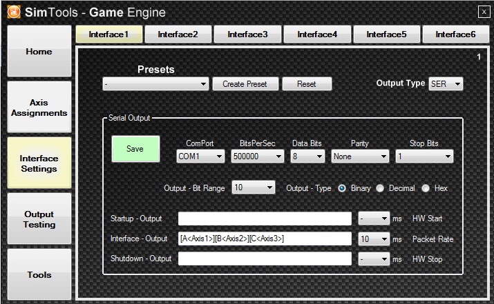

    20. Now start Simtools Game Engine (see image below)
    21. Open Interface Settings
    22. Now set up Interface1 as shown in the image below but substitute your arduino’s ComPort number if it is not on Com1.
    23. Click the SAVE button
    24. Simtools Game Engine Interface is now correctly configured to send data to the SPS motor driver sketch

    For further information regarding PID tuning and Windows SMC3 Utilities go here.
    SMC3 Arduino 3DOF Motor Driver and Windows Utilities

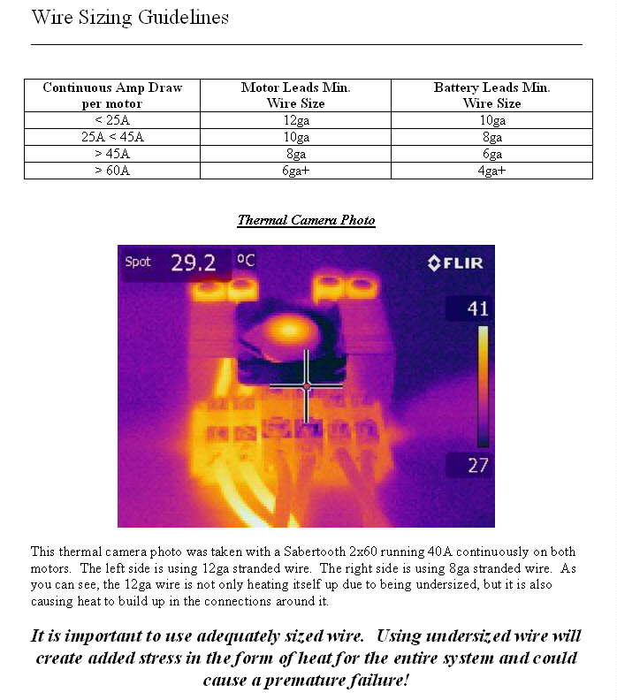

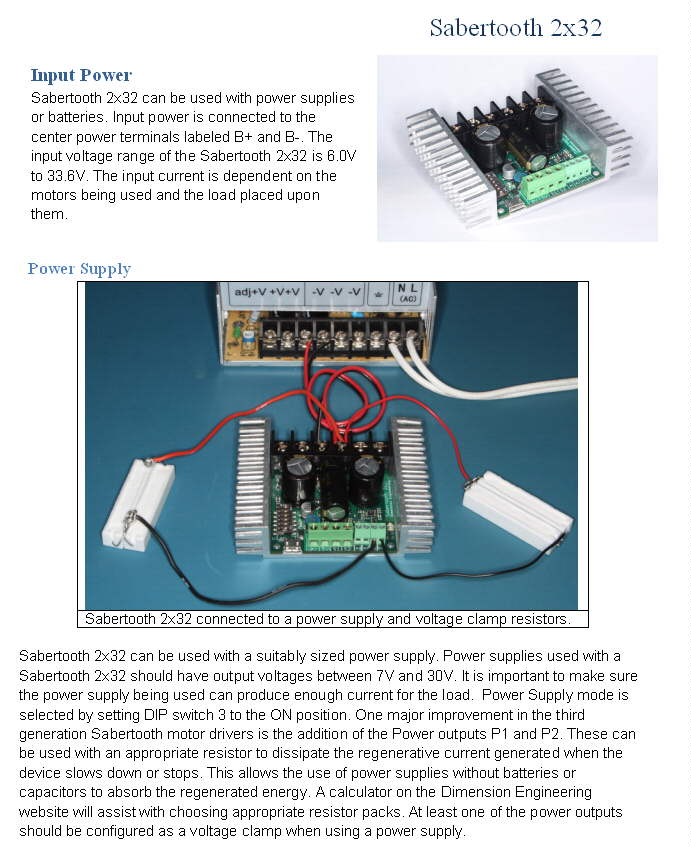

    Below is useful information regarding the Sabertooths power and wiring requirements
    The Dimension Engineering Resistor Calculator can be found here: https://www.dimensionengineering.com/calculators/power-resistor

    Are you using a mega or uno? Pit reported similar behavior when using his mega but he said changing 10ms to 1ms in Simtools interface fixed it. If that doesn't do it you can also try grounding pin 8 and reducing the baud from 500000 to 115000.

    SimTools = 500000
    Sabertooth = 115200
    Uno or Mega = 115200
    SimTools Paket Rate Uno = 10ms
    SimTools Paket Rate Mega = 1ms

    Ok I've tried changing the PacketRate and it makes the twitches more frequent at 1ms and if I put it higher than 10ms they do go away but the motion is jerky as hell. In fact the movement from simtools is terrible its jerking everywhere.
    I use SCM3 to move the actuators and they are as smooth as you like, I have no idea lol
  19. Pit
    3,012
    30,480Coins
    +3,097 / 31 / -0
    1ms is only MEGA compatible. Can you upload all your settings for once?
